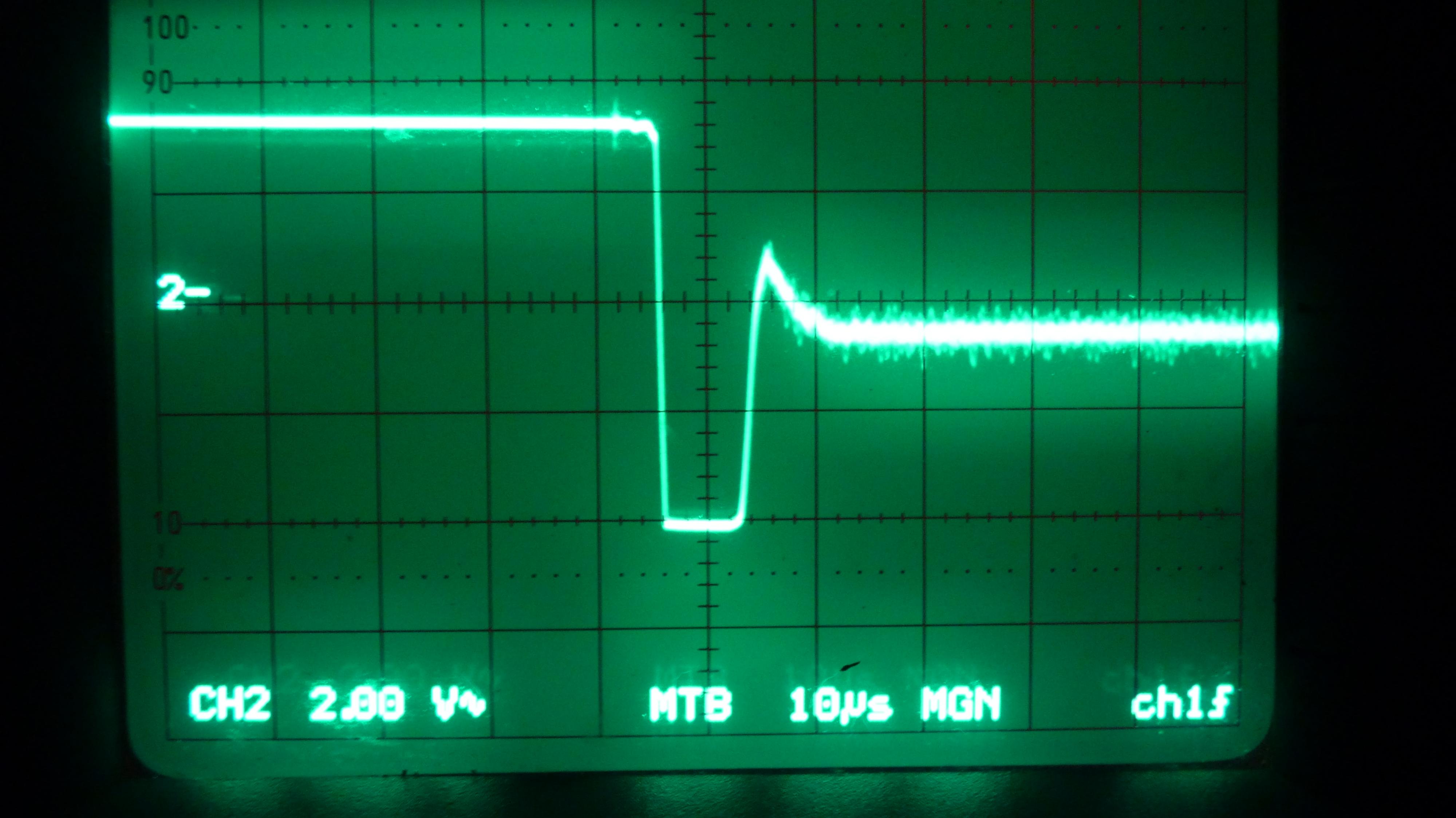

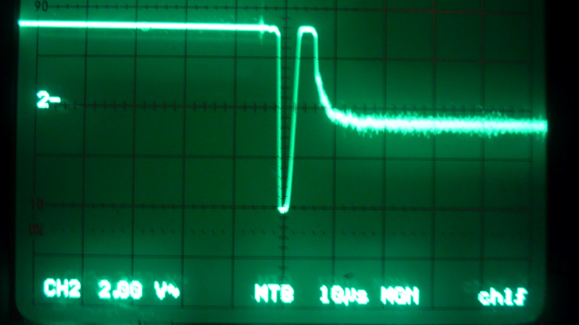

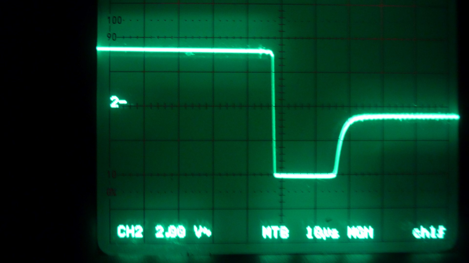

              • These are the waveforms on TP3, overdamped, underdamped and OK?
Name:	under (Large).JPG
Name:	over (Large).JPG
Name:	OK (Large).JPG
                • Originally posted by samsearcher View Post
                  [ATTACH]46350[/ATTACH]
                  [ATTACH]46351[/ATTACH]
                  [ATTACH]46352[/ATTACH]
                  The OK image is still slightly underdamped. When critically damped there should be no overshoot.
                  However, the detector will be a bit more sensitive with the OK setting, but have less stability in the threshold.
