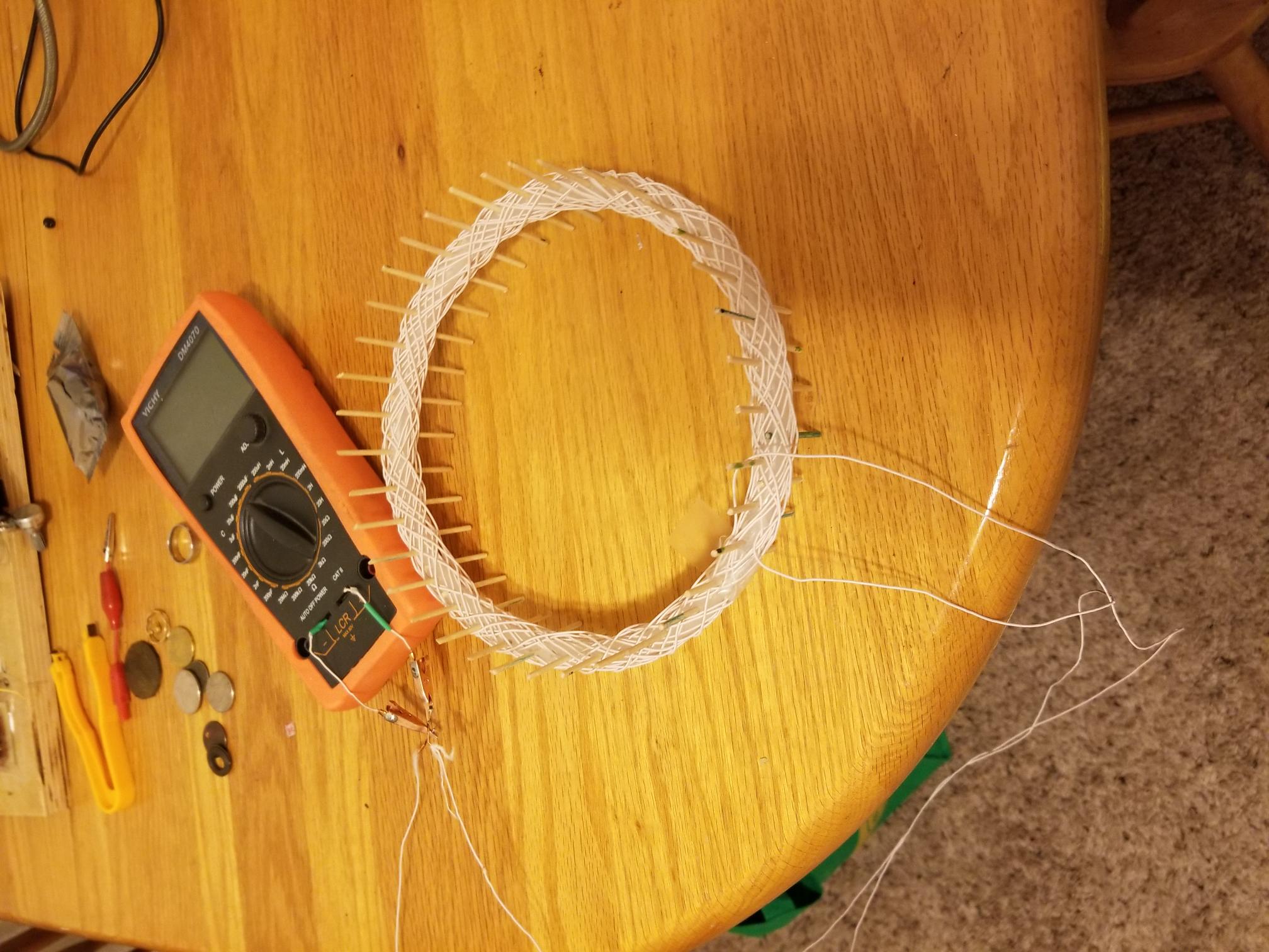

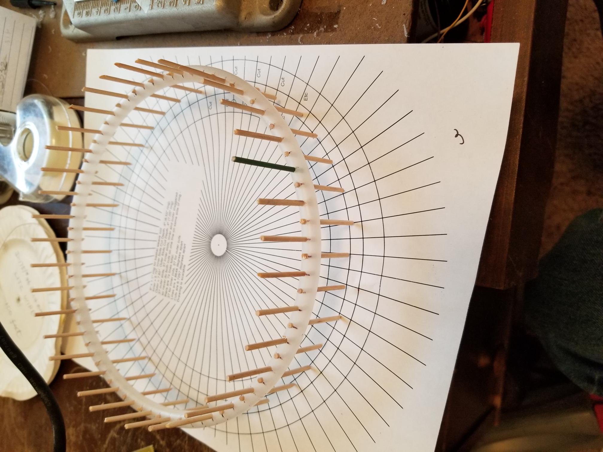

                  • #54
                    Hi Teleno,
                    Ive read allot of your posts over the years and am wondering if you would advise me on a coil type to get to sub 5us sampling.
                    Here are a couple pictures of the round core coil i was trying.
                    It is the same wrap as the 3dss coils but on a round form without slots.
                    My hope is that having the wires not alligned through slots but more randomly and with less sharp corners.
                    My wrap is clockwise but in a counterclockwise thread around the form. Dont know if this will do much but the litz is wraped right handed so I wraped the wire left handed.

                    Do you think this would be useful or would a simple spiral coil be better?
                    Thanks for any advice

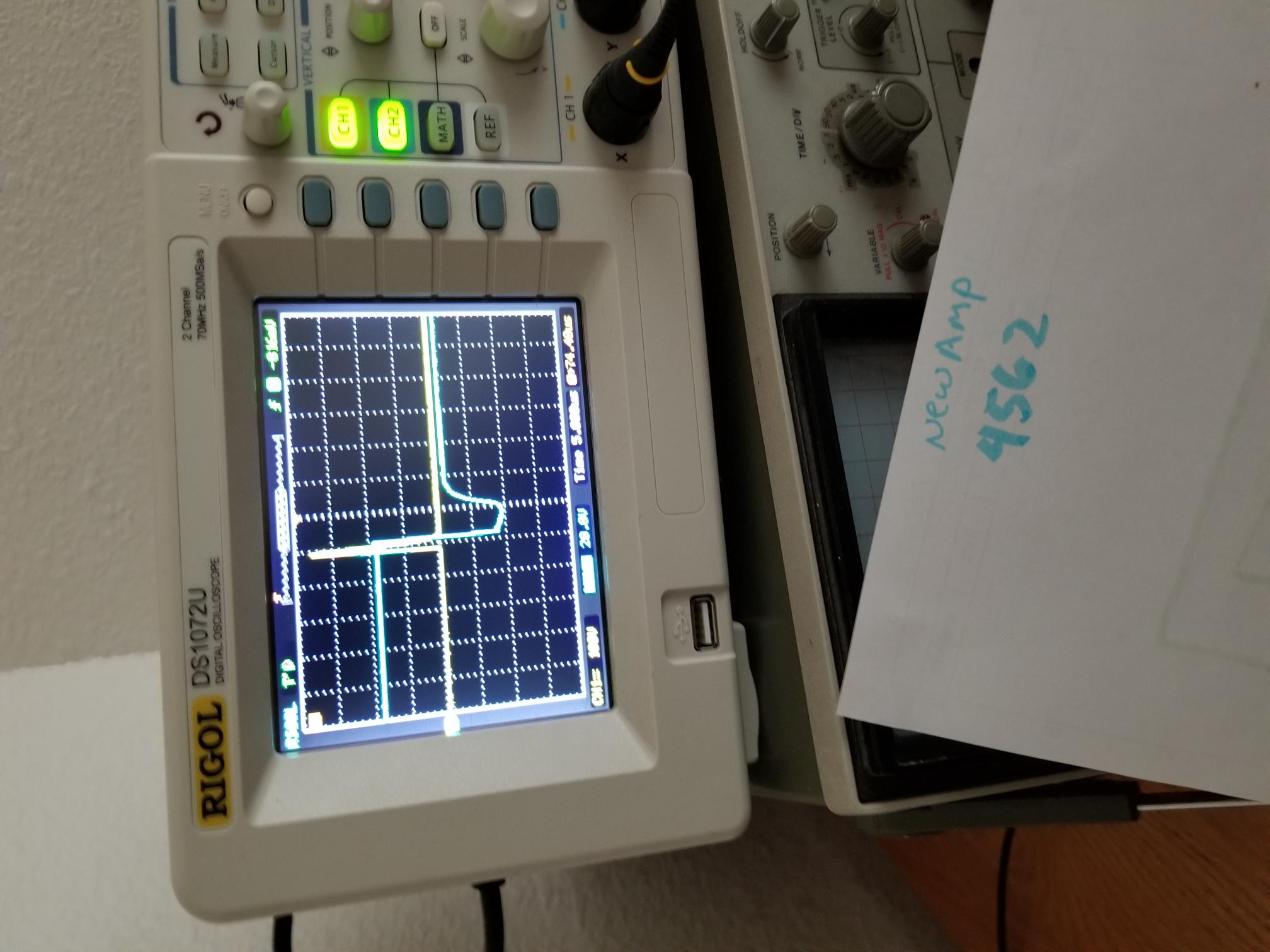

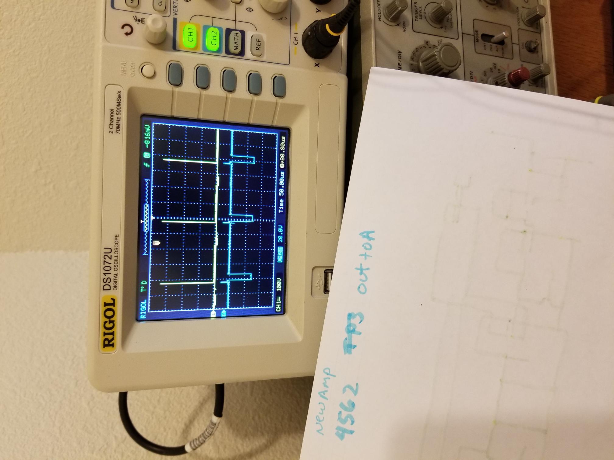

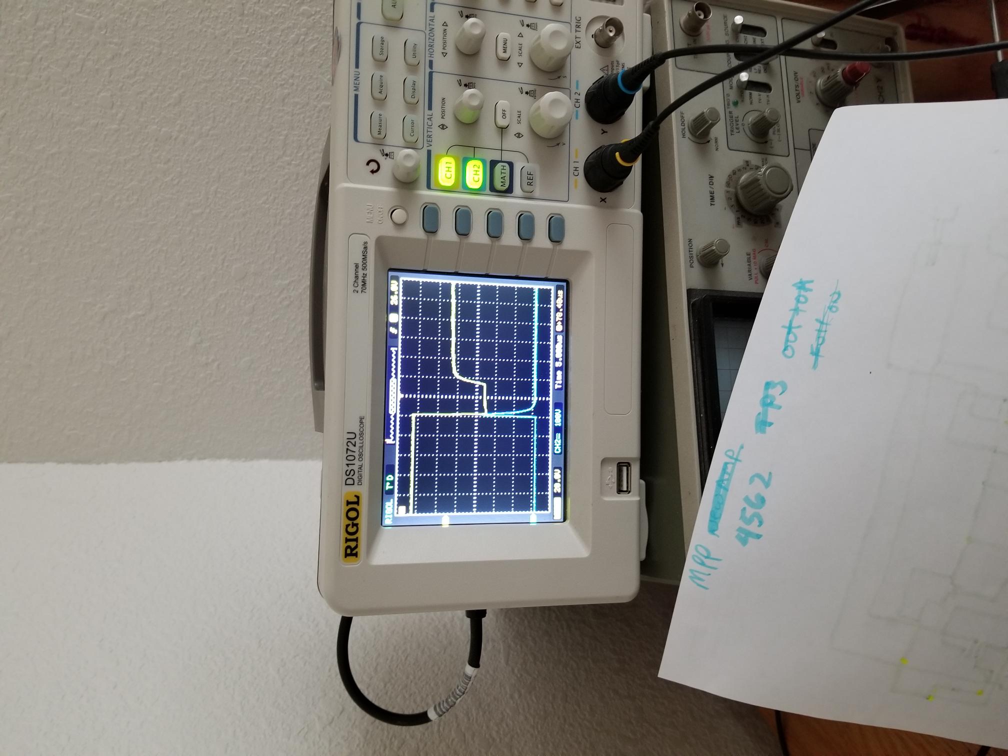

                        So I finally have the whole circut powered up.
                        I have two Rev d MPP set up the same way for comparison.
                        PPM 5000 period 74us
                        Coil is 288Uh at 2.1 ohms folded 8
                        Timing
                        1st sample spacing 5us
                        1st sample 20us
                        EFE spacing 71us
                        EFE width 21 us
                        Detector works pretty good with these settings I picked up a 1 ad 1/2 inch gain on my test nugget.
                        The square wave at the new test point #3 is wrong. Im not sure whats causing it yet but It carries through the whole integrator and is a constant tone in the speaker.
                        There is no detecton. or voltage drop at TP4 with the new preamp and integrator hooked up.
                        Im not sure if something is wrong with the board or the schematic itself. Everything looks good Ive checked and rechecked but that doesnt mean I didnt miss something.
                        here is a picture of the Amp at 5000pps
ID:	353682Click image for larger version
                        Here is the output signal of the new sample integrator, it should just be a steady voltage but the square wave is present there as well.
                        Any thoughts would be apreciated.
                        • #57
                          Timing
                          1st sample 20us
                          EFE spacing 71us
                          EFE width 21 us
                          [ATTACH]45830[/ATTACH][ATTACH]45831[/ATTACH]
                          [ATTACH]45832[/ATTACH]

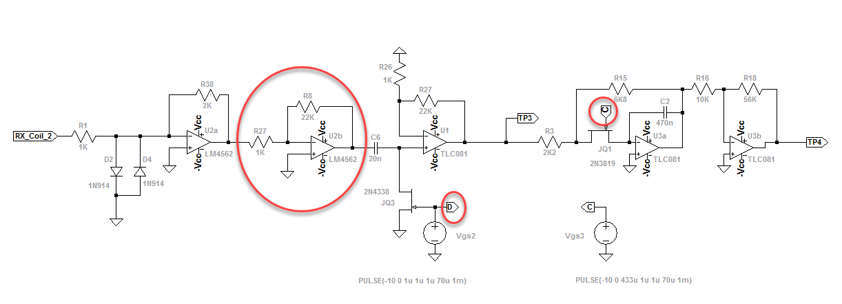

                            Try swapping signals "C' and "D" in my schematic. I believe the EF should be "D" and the main sample should be "C", it's the other way around in my schematic. I've made a silly mistake there.
                            • #59

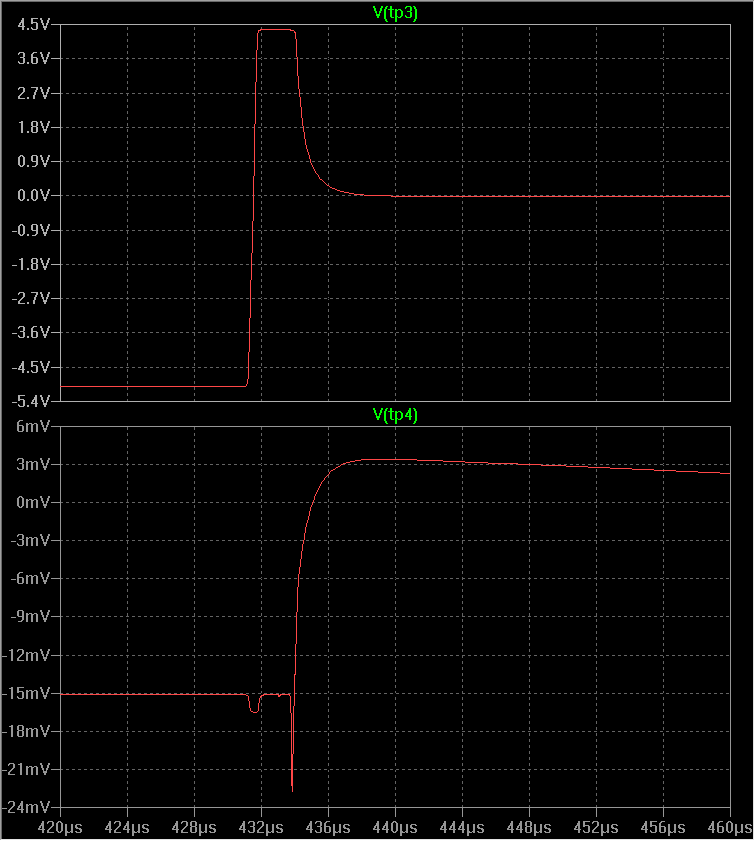

                              These are the corrections to make:
                              1. Signals "C" and "D" should be swapped. "C" is the target sample and "D" is the EF sample (offset correction). I got it the wrong way around.
                              2. U2b should be inverting as in post #3. Then the integrator's output at T4 increases when a target is placed near the coil, which is what the sound subcircuit expects.
                              Make sure you've modified the integrator as well: remove Q3, R13, R25, C6 and connect U3a pin 3 (+) to 0V. You can reuse Q3 and C6 for the preamp offset (EF) correction.
                              Now you shoud see a positive target signal at TP3 (opposite to the mormal MPP, which is negative.).
                              Because the offet is low, the preamp can now be DC-coupled to the integrator directly. Just bypass C4 and remove D3, D5, R2 and R12.
                              • #60
                                Another thing.
                                Because this mod doesn't use a differential integrator, the EF pulse "C" does not need to be of the same duration as the sampling pulse "D". It can be set much longer.
                                I'd recommend 100us so that the value of cap C6 can be larger (around 47n) for better offset correction (the charge-injection step when switching Q3 gets smaller for larger C6).
