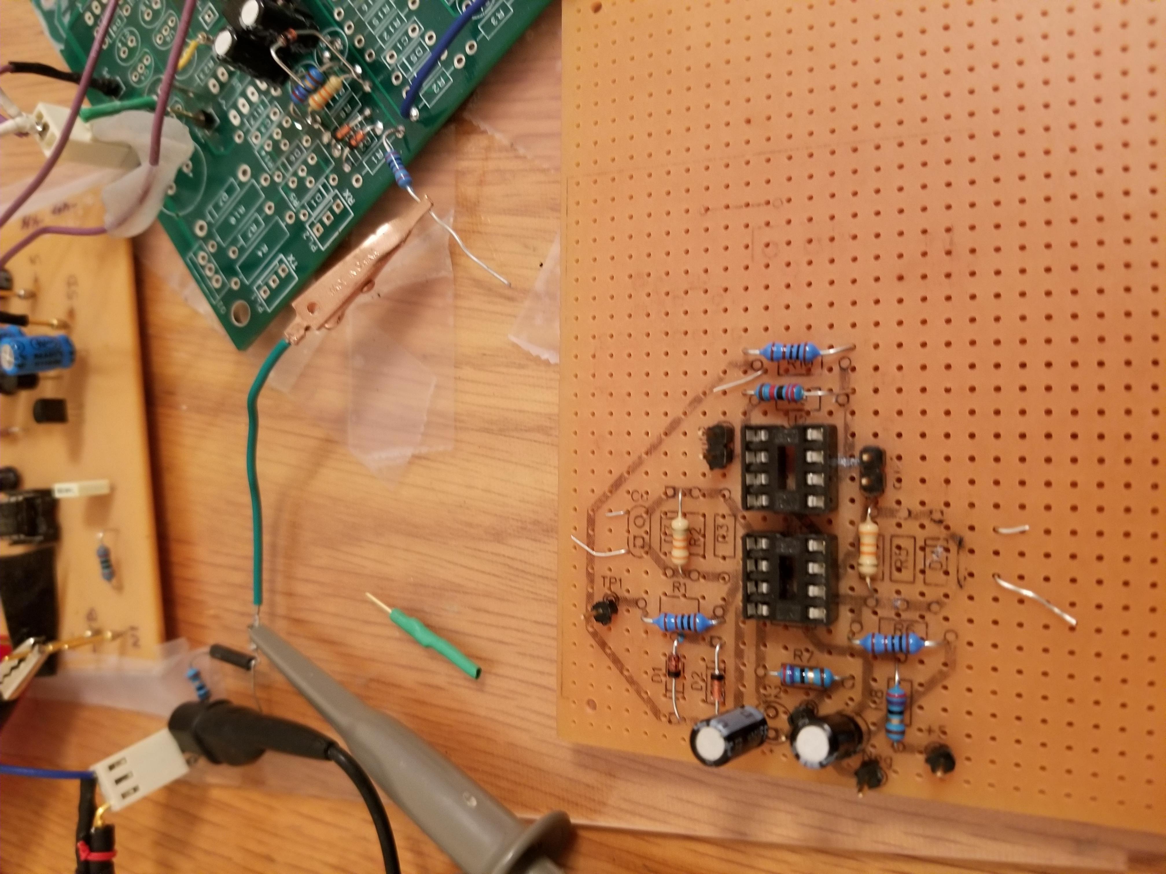

                        I finally was able to make a little progress with this at least the first design on post #3.
                        I did not do the integrator changes at least not yet.

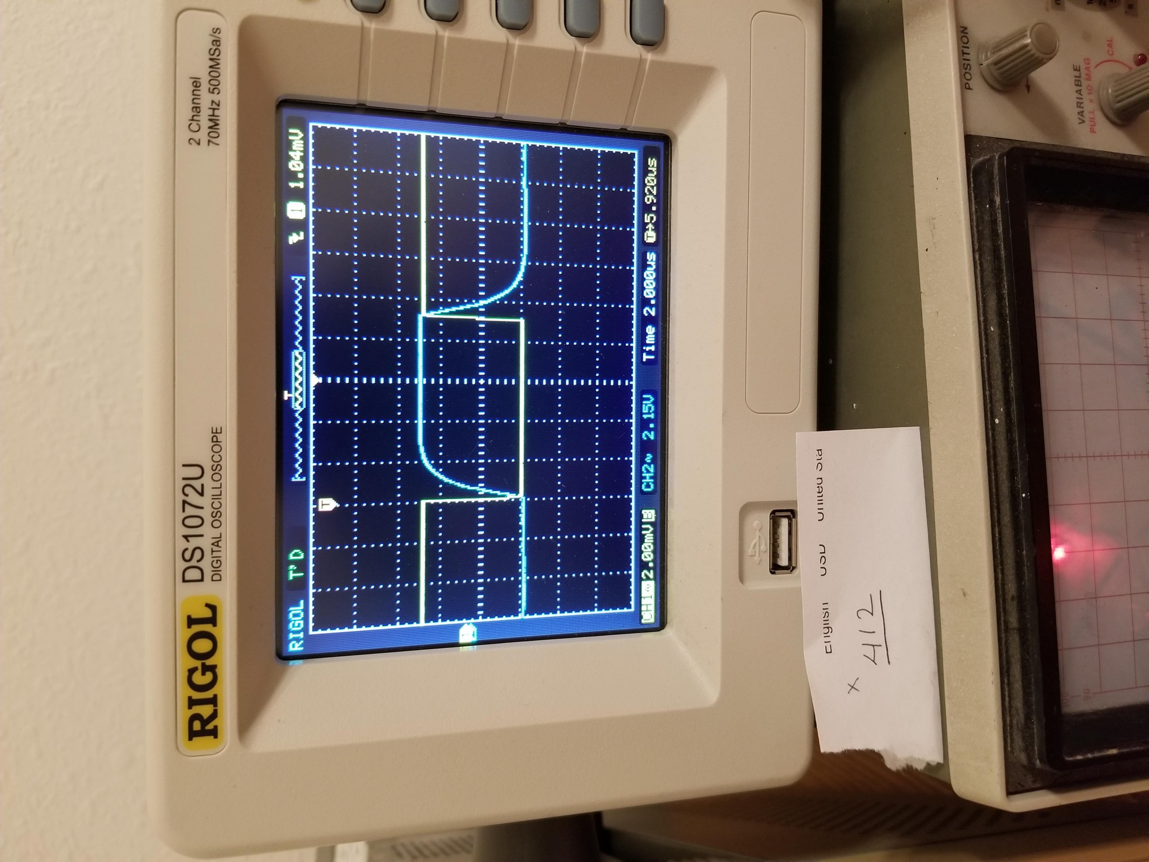

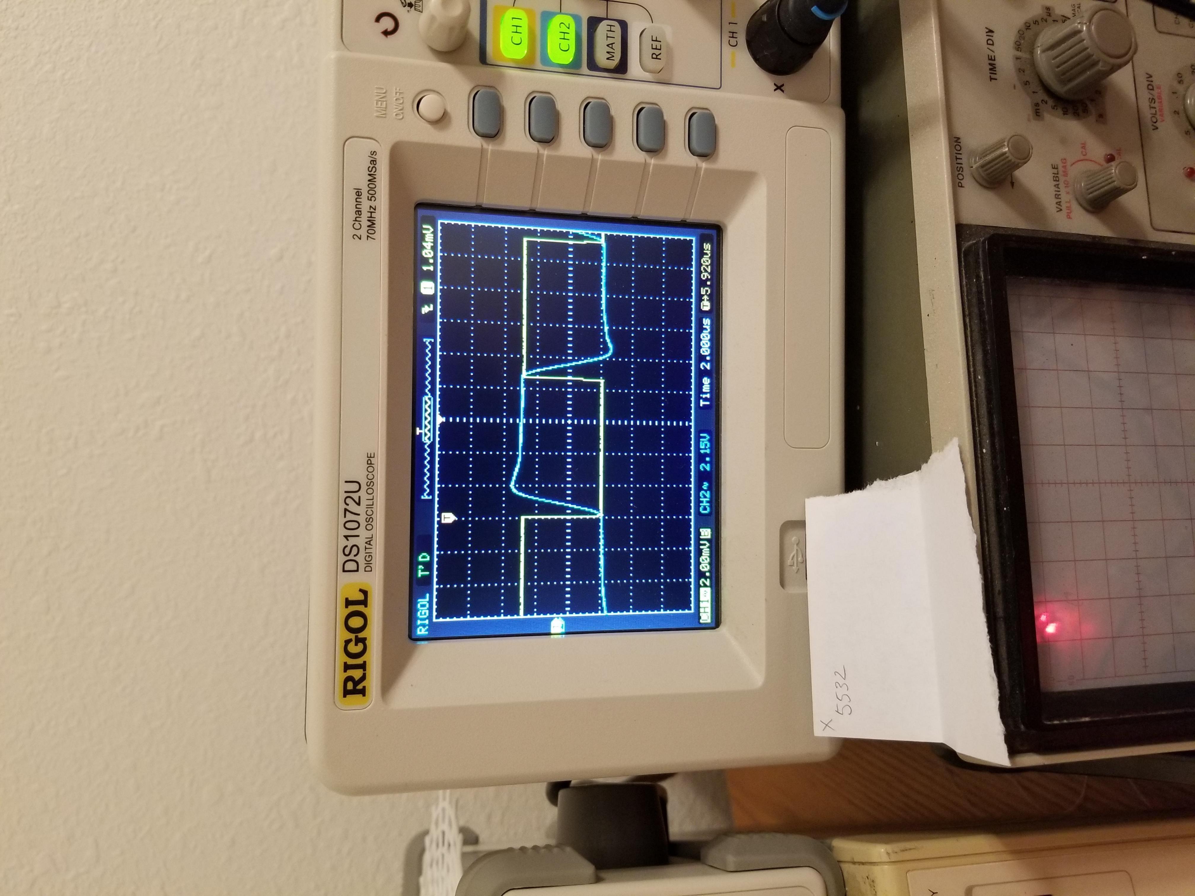

                        I built both a MPP rev e preamp as a stand alone and the three amp design for comparison.
                        Using the Mpp layout I added the third amp and used Teleno's recommendations for amps.

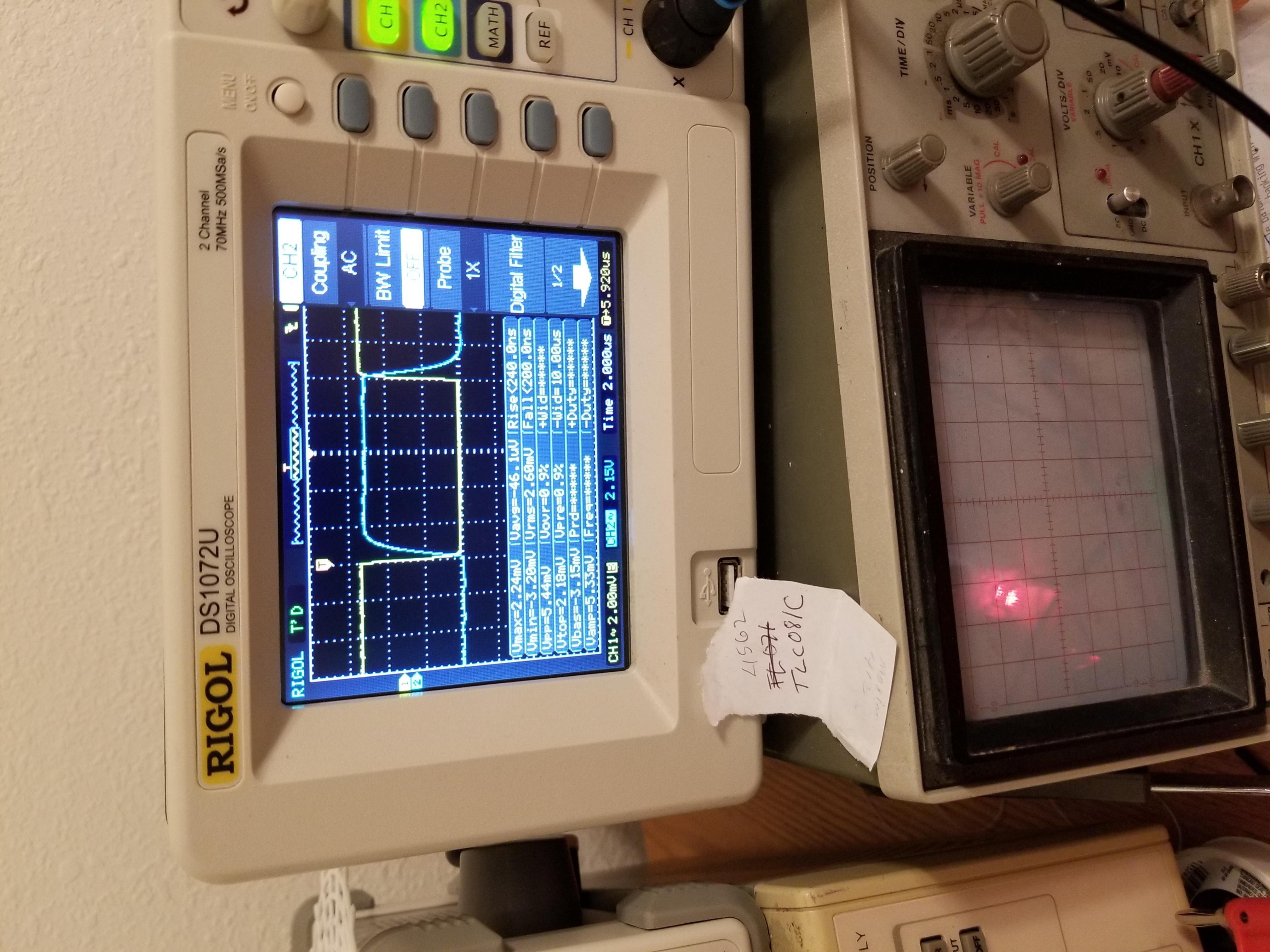

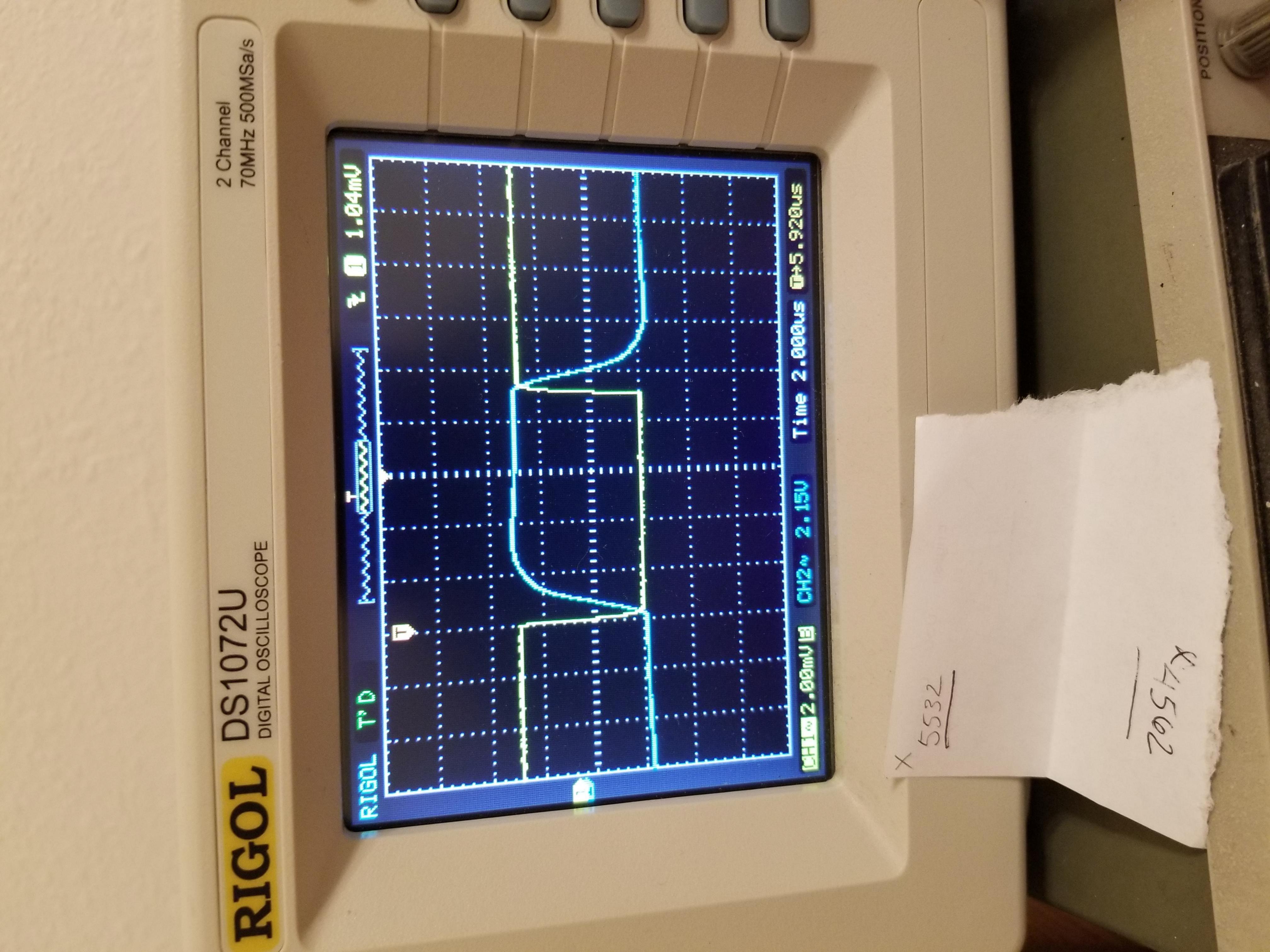

                        Testing the stock Mpp Pre amp with the 5532 time to 0v is about 3.5us and there is a little overshoot.

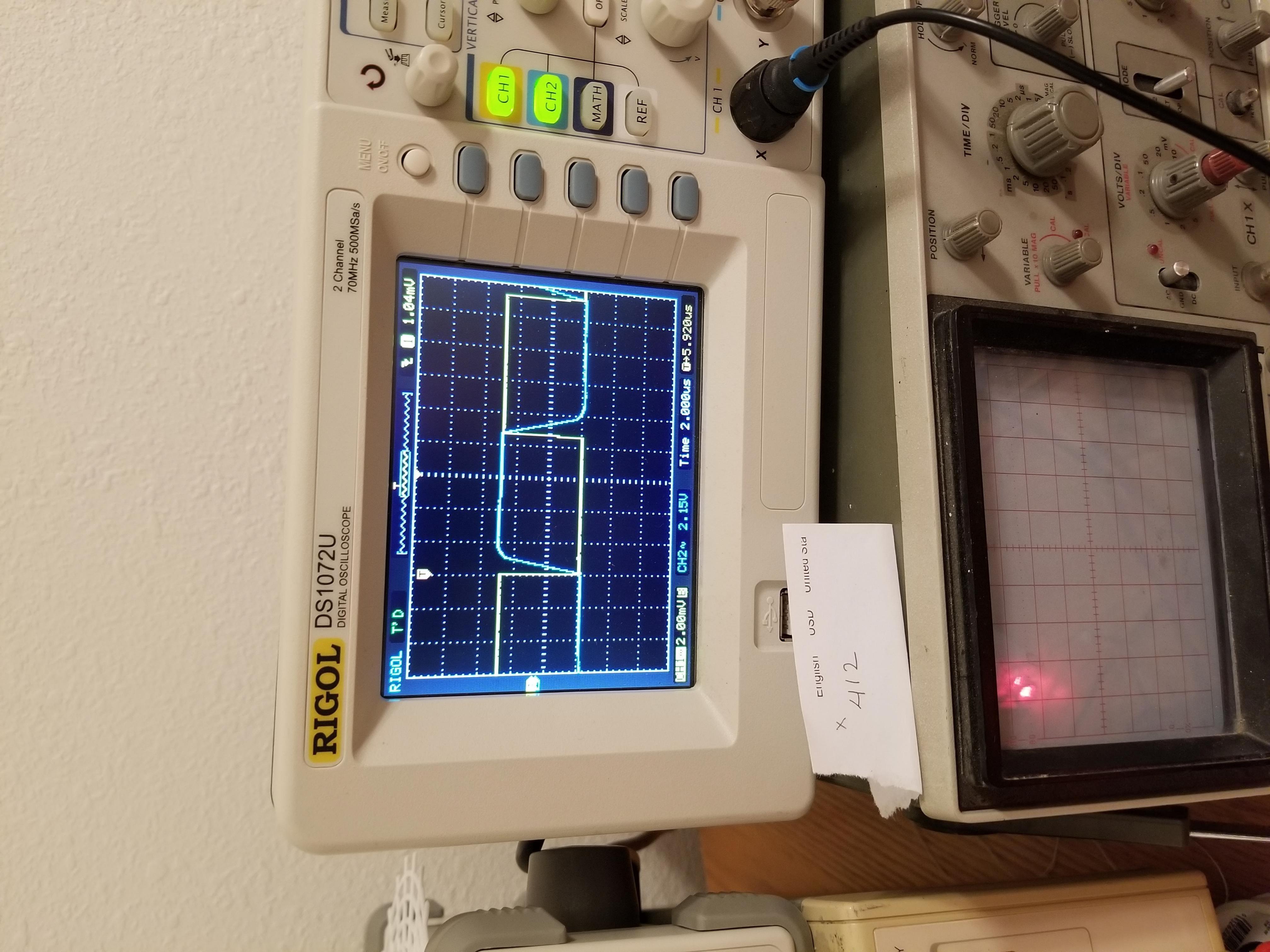

                        Swapping to 412 is not much better and the amp looks overcompensated.

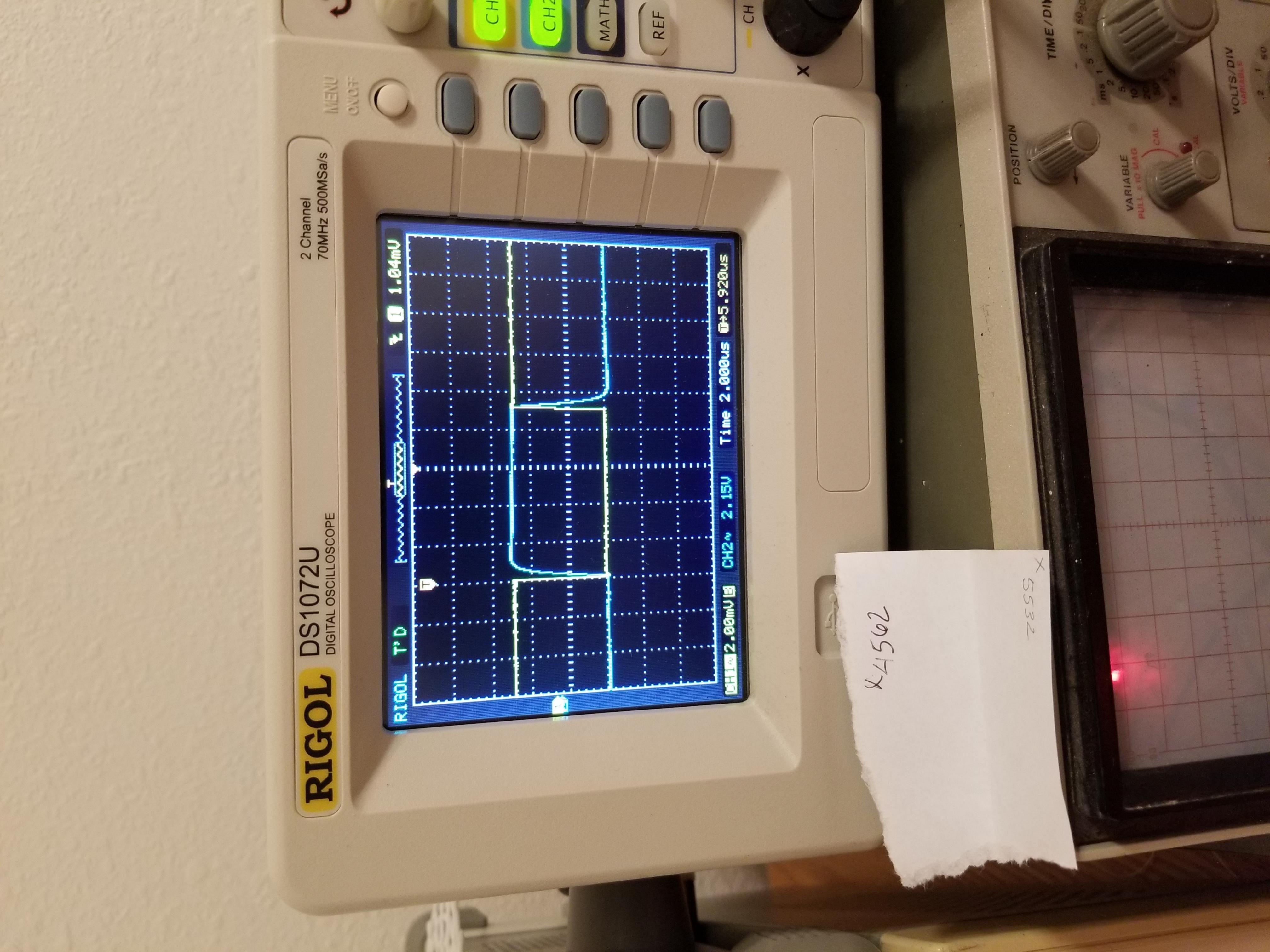

                        The 4562 is far superior at 2us to 0.
                        Stock Mpp Preamp
Name:	Mpp 5532 pre amp.jpg
Name:	Mpp 412 preamp.jpg
                        Three stage preamp First two stages only Mock MPP

Name:	Mock pre amp 4562.jpg
                        For some reason on my amp build the overshoot on the 5532 is worse. Other than that its a bit cleaner than the stock Mpp Preamp.
                        Here is the three amp set up.
                        I'm just including the 4562 in the tests from here on out as there is no reason to move forward with the other two.

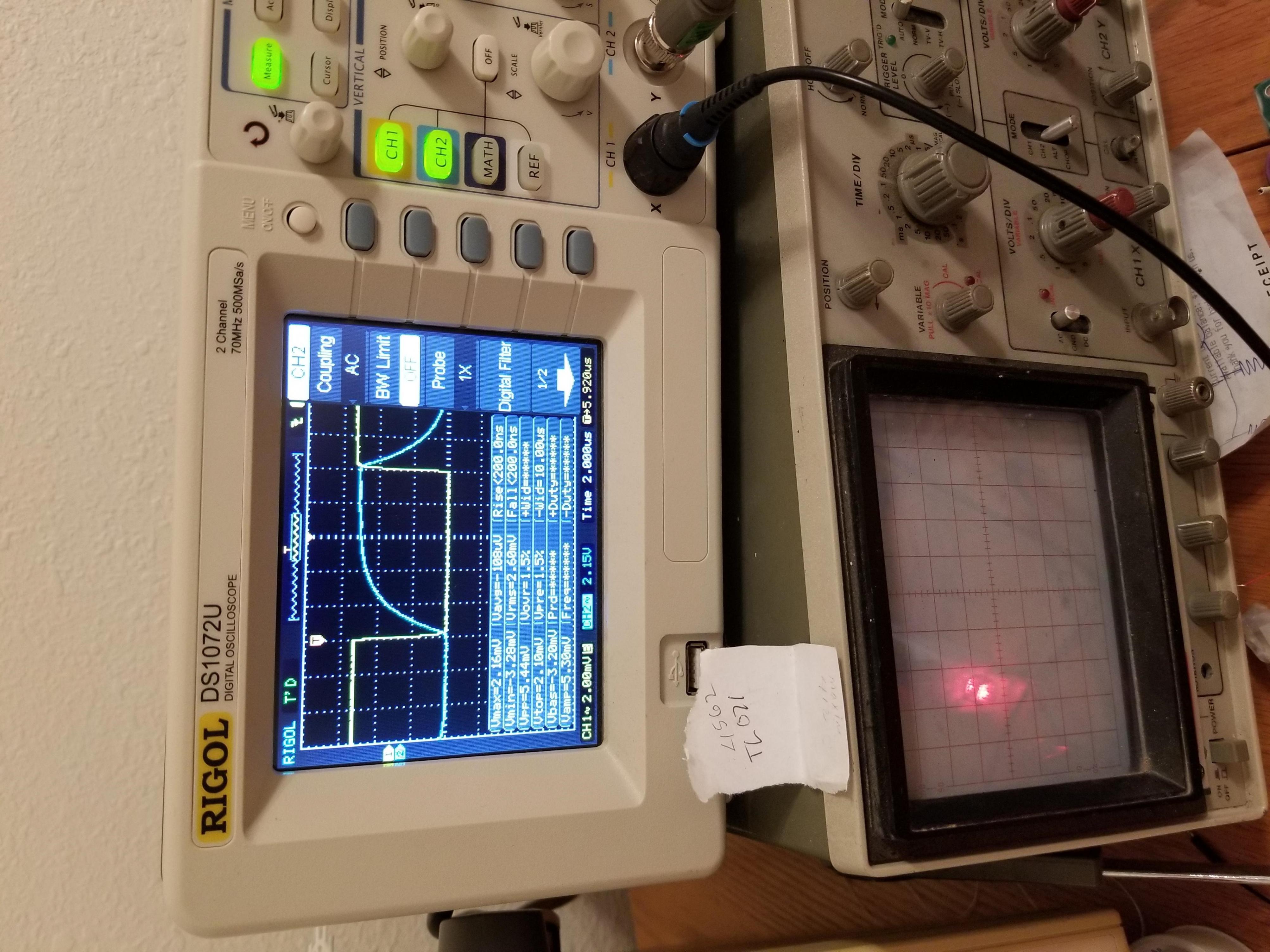

Name:	3 stage TL071.jpg
                        I tested a TL071 and TLC081 as the third amp and as you can see the 081 is a winner.
                        Teleno's third amp design is also a winner. Its still capable of 2 Us recovery time and should by cleaner as far as noise I would think, Plus the increase in bandwidth.
                        Seems the preamp is plenty fast at this point.
                        Any help and or thoughts in cleaning it up and or more testing anyone wants to see done I would appreciate the input.
