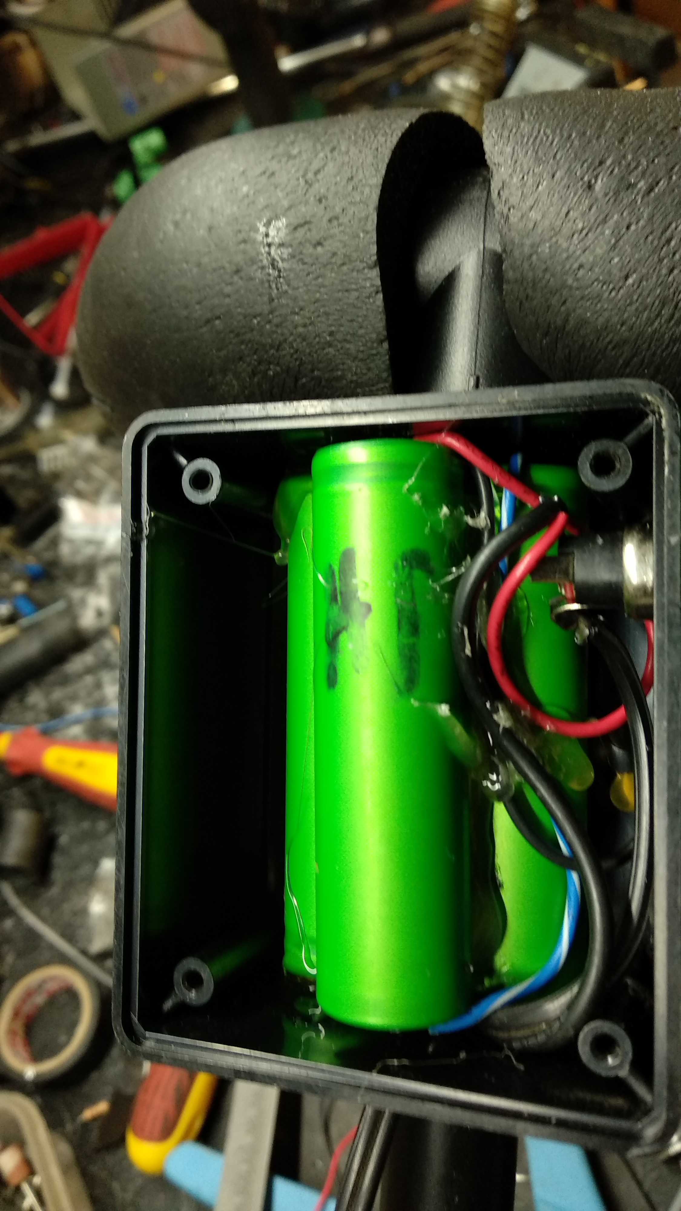

              • Loading 95% but still not finished...Remains coil critical damping on the detector and possibly another front panel i messed up..A little sneak peek please judge with generocity!
Name:	Battery Compartment.jpg
                Battery compartment with 3 x 18650 batteries with charging connector...Want to put a BMS inside for correct charging

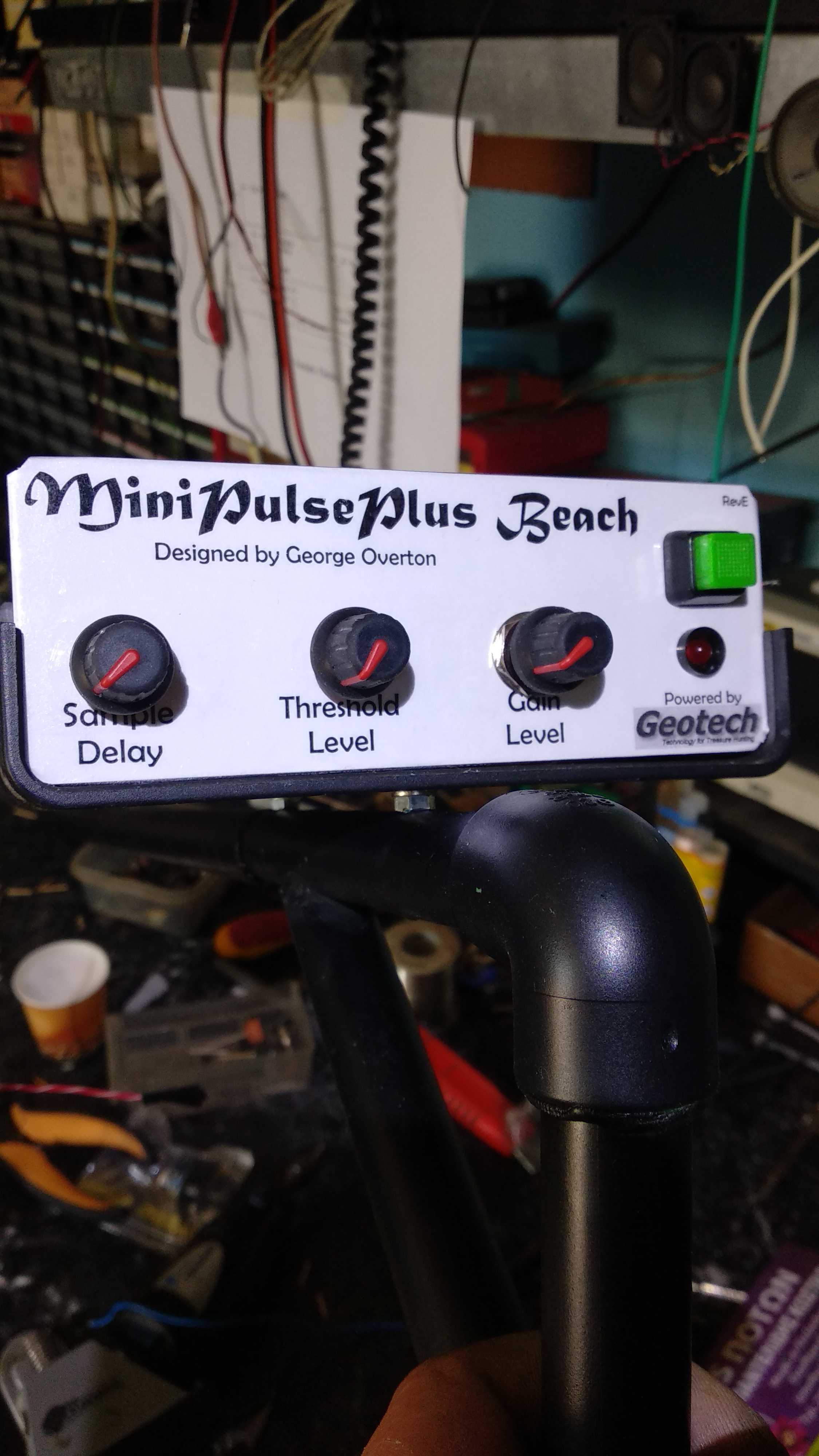

Name:	Front Panel.jpg
                Didnt have in mind the OD of the pot knobs...I hope the designer doesnt mind putting his name on it..

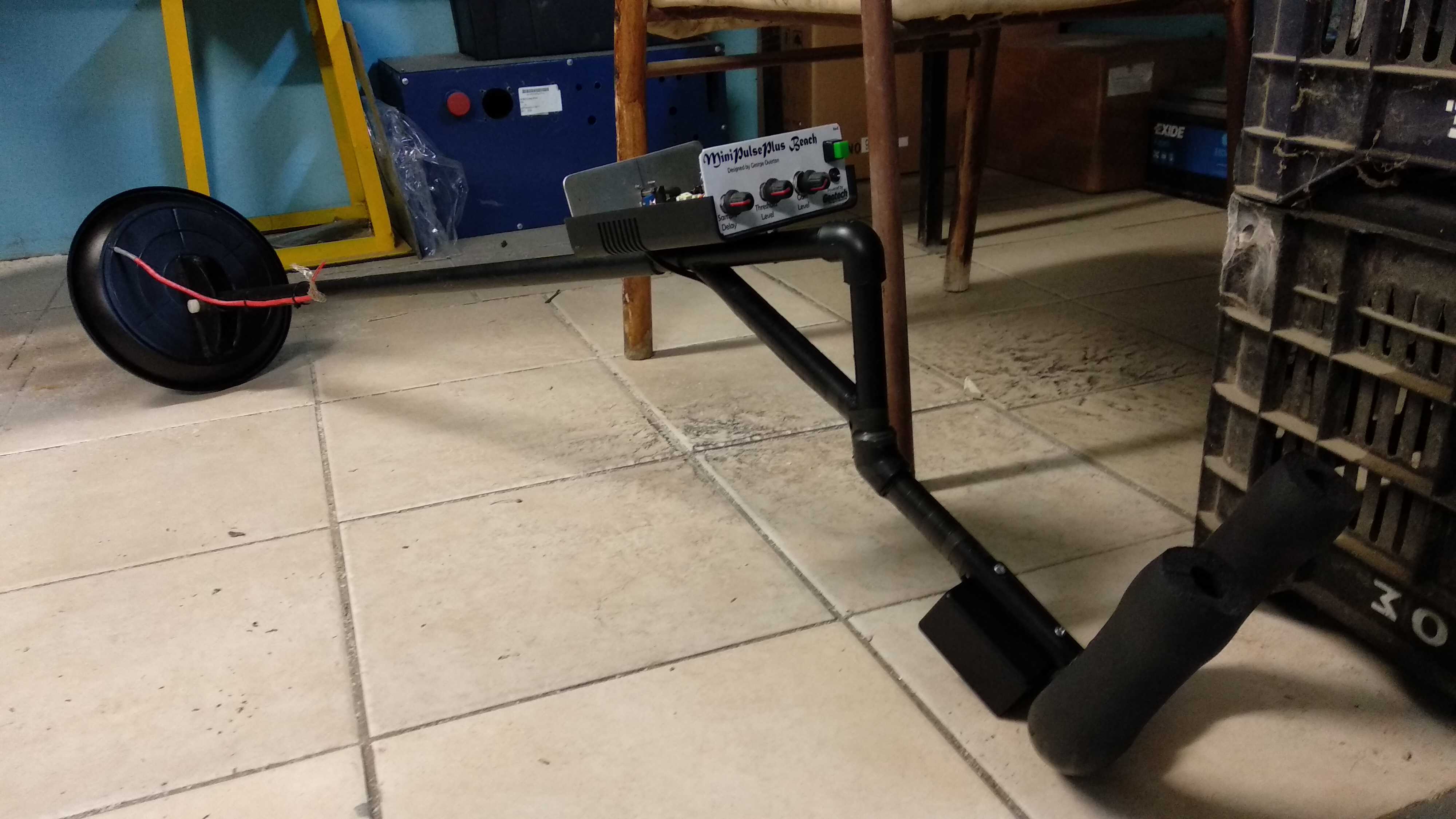

Name:	MPP Beach Rev My Time Has Come.jpg
                The build so far. A headphone connector must be placed with a pot....I hope tommorow i will have my fisrt findings!!
                • Looks good.
                  Do post pic of your first find.

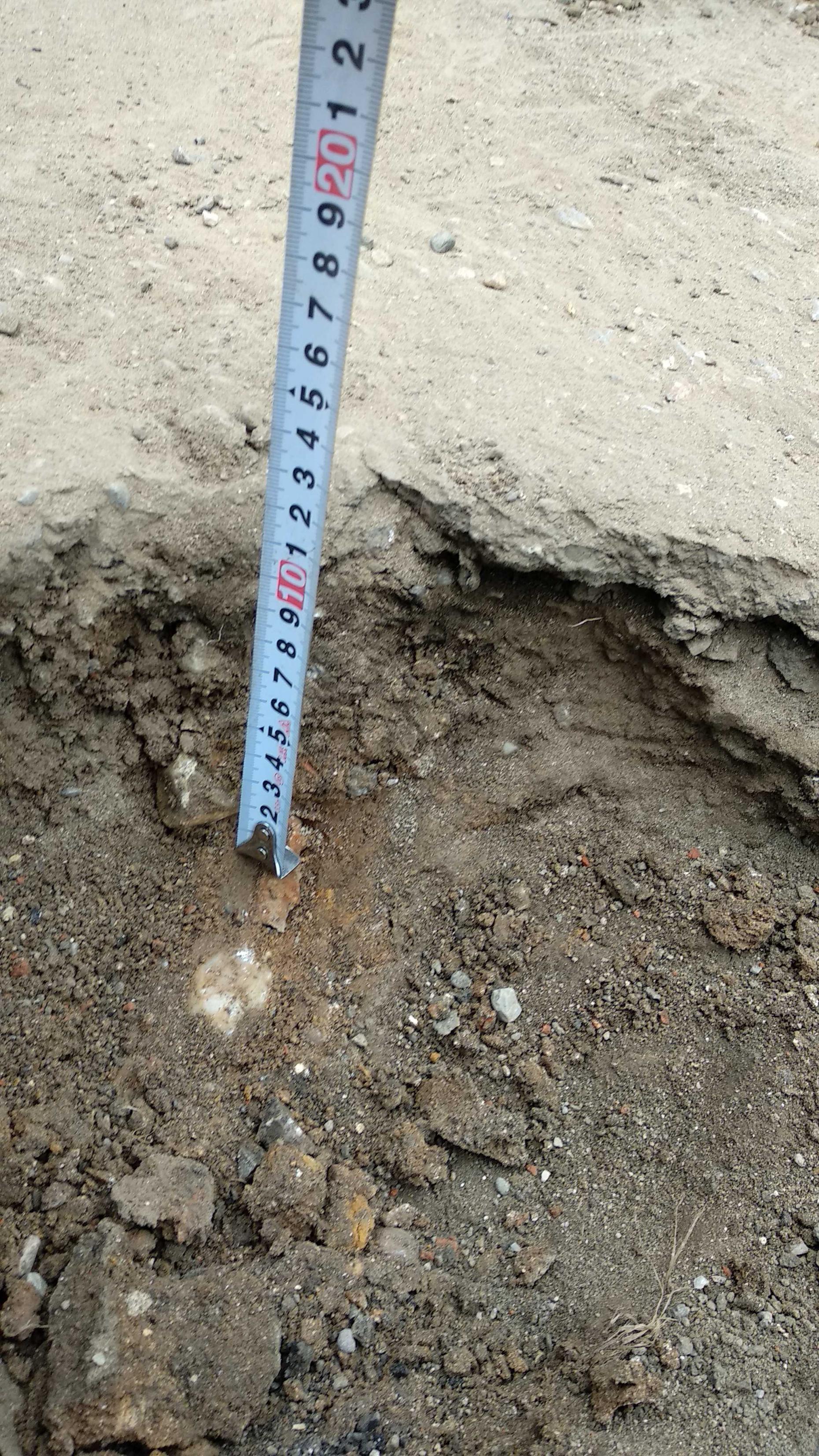

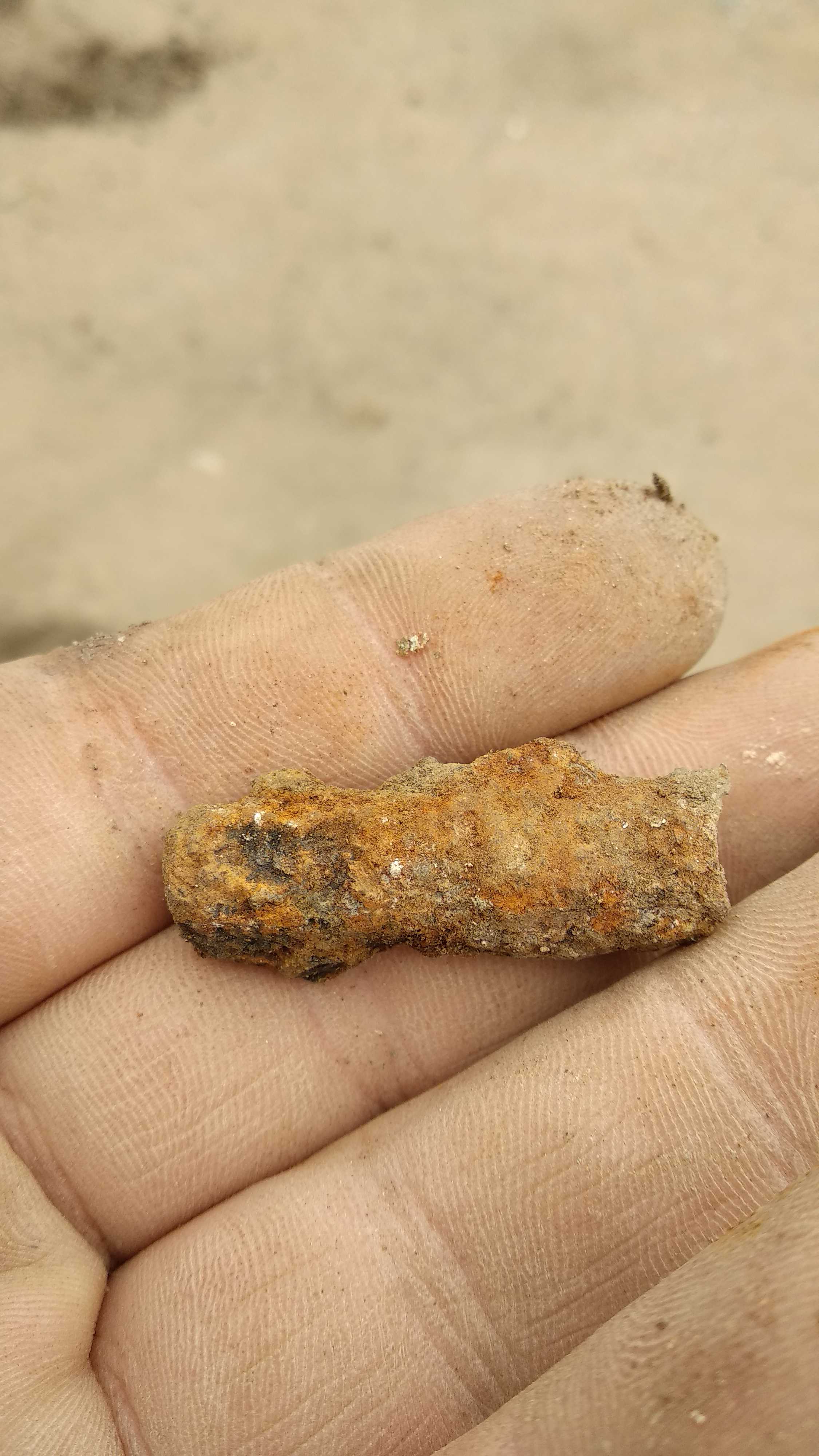

                  • Done some testing on my backyard,a very trashy environment due to lots of ironwork done there.I should get it out in to a "clean" environment for field testing..The detector is very sensitive and i believe thats because my 3dss coil is unshielded.Had to keep the coil at 10 cm above ground,gain at minimum threshold at almost minimum and delay early and narrow..The best delay with this setup is 8us (from end of tx pulse until negative curve comes to 0 at TP3). I attach 2 photos om my first find,i believe its a piece of rebar and the coil connector,a bnc T type were i can mount the damp resistor.
                    Your thoughts please

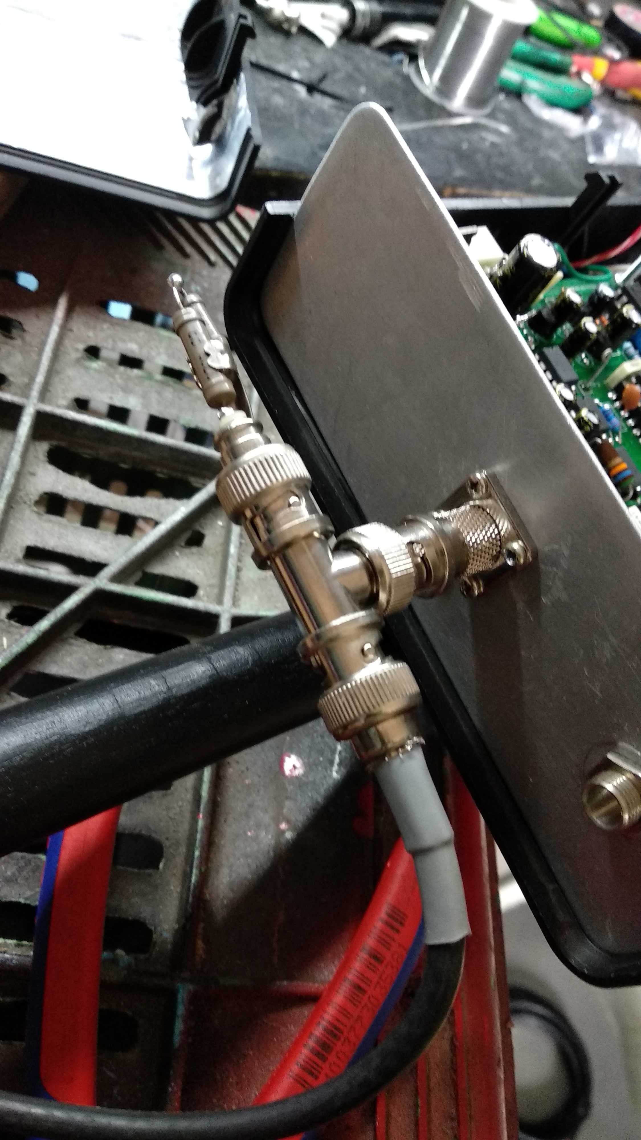

Name:	Damp Resistor.jpg
                    • You found something. I just call this 'a rusty thing' and always finds lots of them.
                      With actual field testing you get to tweak settings to find what works best.
                      Then is learning what different targets sounds like for a better guess of what they might be.
                      Interesting way to do the damping R.
