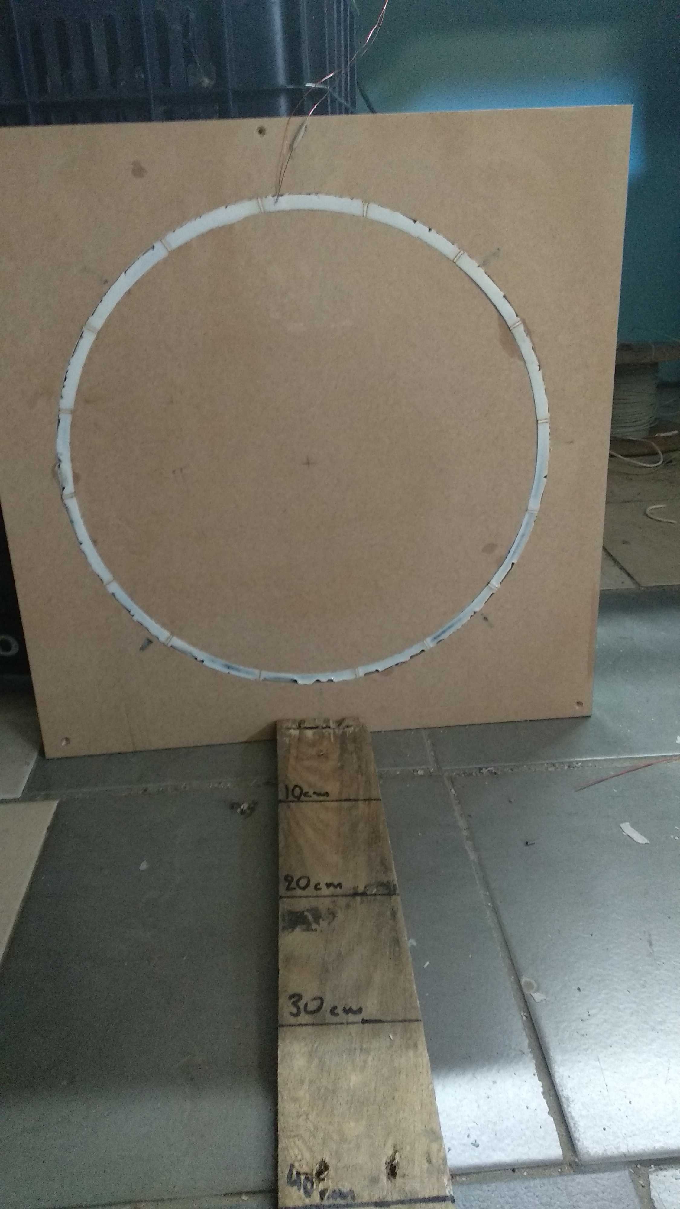

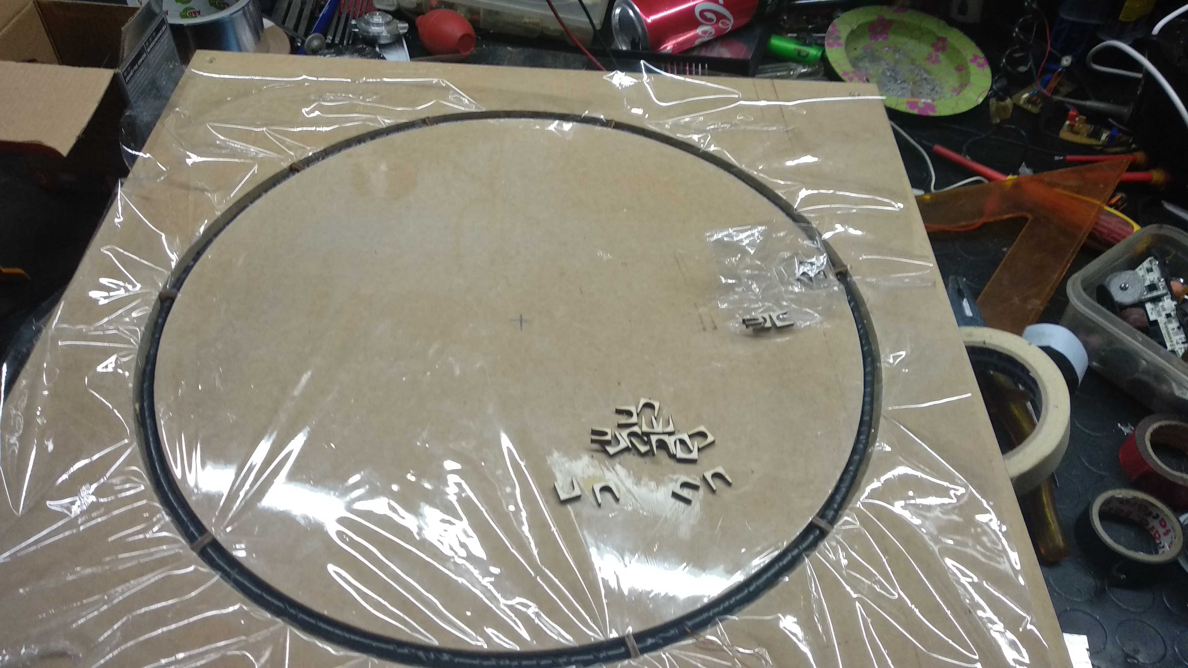

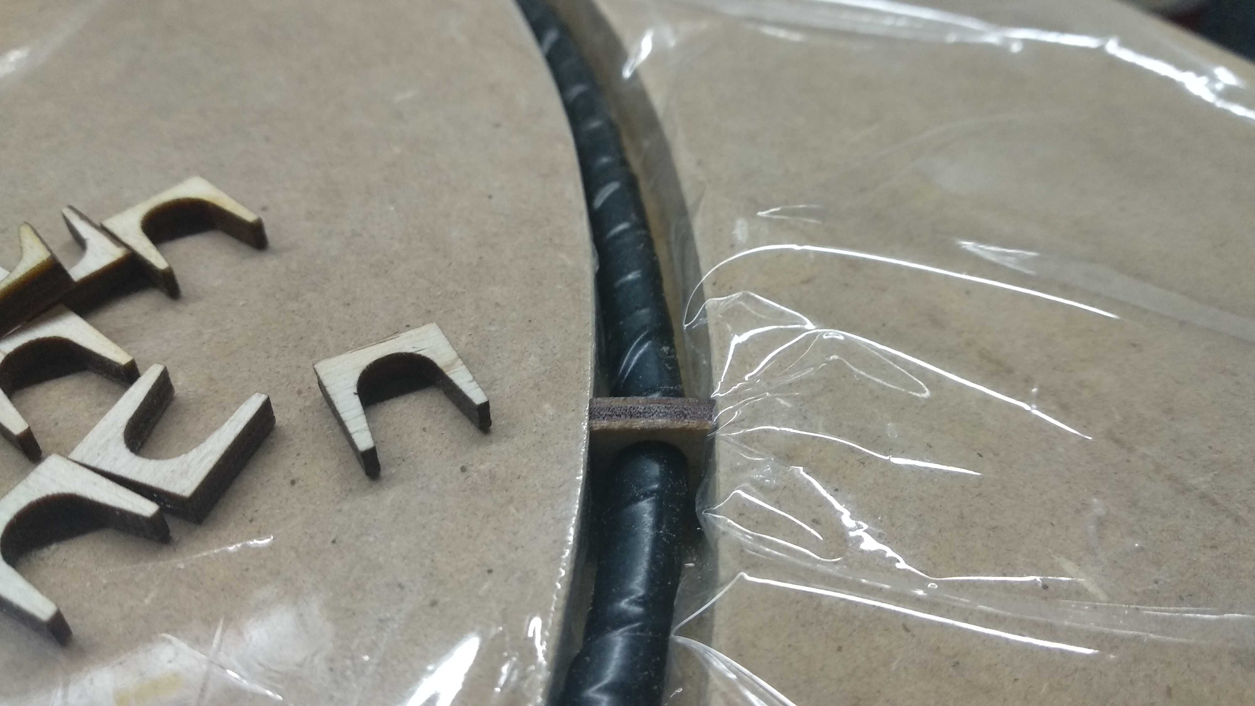

  • Went to my best friends router and engraved the coil patern 10mm deep and wide (The coil measures about 6mm OD).He blew my mind with these tinny wedges made with his laser cutter also from wood to keep coil parallel to the form sides so there is room for epoxy to fill it all the way through!Im worried about if the epoxied coil easilly will "go" out of the form.

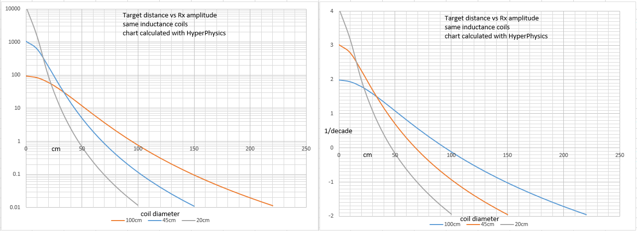

      Been following your thread. Been thinking of making a coil for larger targets with some AWG19 enamel coated wire I have. Including a chart I posted awhile back comparing signal strength vs distance with three different diameter coils assuming everything else remained the same. Wondering what needs to be done to make the MPP a good large target detector(learning exercise). What targets are you looking for? What is the largest coil you would like to use?
      • The wedges are actually ply wood, even the more impressive you coould not have done that with a router.

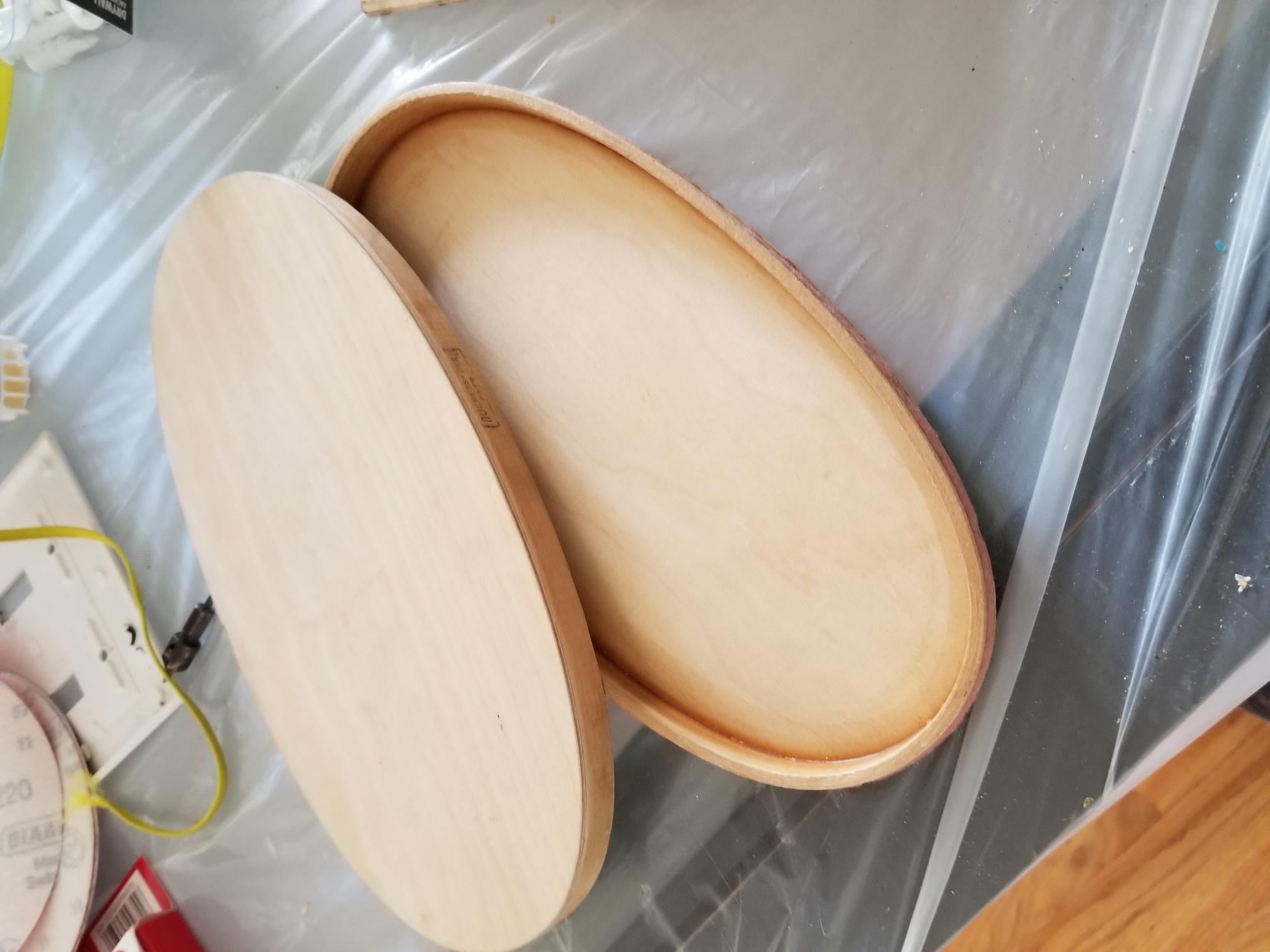

        How do you plan on sealing your MDf. If I may I would suggest a liquid thin epoxy Or a wood hardener used for restoring rotted wood.
        Pc Petrifier would work and is not that expensive. I have a wood shell and thats what I was going to use and then clear coat but mine is maple ply wood so I was going to make a woody style coil.

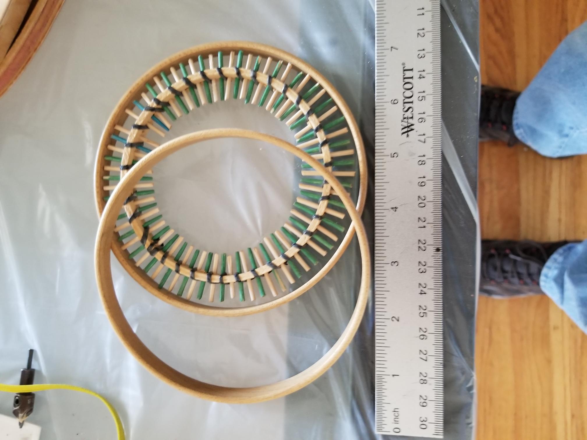

        This is a way you can do a easy form for that style of coil and that is to use a embrodrary hoop glue on 1/8 ply and you have a form for a laminate router.

          Been following your thread. Been thinking of making a coil for larger targets with some AWG19 enamel coated wire I have. Including a chart I posted awhile back comparing signal strength vs distance with three different diameter coils assuming everything else remained the same. Wondering what needs to be done to make the MPP a good large target detector(learning exercise).What targets are you looking for? What is the largest coil you would like to use?

          Tested the coil i made today with the MPP and noticed the following things (i didnt remove the coil from the MDF waiting for the epoxy to harden):
          1) Coil gained me a little detection range-distance on large items and lost a little at small.As it should.But in close proximity it still detects small items.For example with the 3dss an gold coin (22mm OD) was detected at 27-30cm) with this coil at 18-20cm.
          2) Larger coil should be more "slow".Damped around 2k it has a very nice curve and can sample at 9us.
          3) Watching the preamp output i was getting some noise that had period,moments it had a normal curve about 800mV and at other moments the noise went up to 2V.Some wird interference i cant explain
          4) Working too long with a coil at 500 pps and Tx pulse at 300us gave me a headache..

            Even can use them for the coil form itself. They are cheap in second hand stores and and they come pretty big.

              Hello godigit1 i potted it with epoxy hust to keep it steady and test it.If it works as i want i will vacuum form a coil housing..Also i thought a mix of wood glue fine wood dust and some varnish instead of epoxy
              • Forgot to mention that i think 3dss or spider coils are much easier and robust than the simple bundle monos...
                • This is true but require a thicker housing. Cool I like the vacumm forming and the way you chose to do it by putting the coil in a perminate form Good Idea!! I wouldnt use wood glue who knows what the dialectric properties really are.

                    My best friend is a carpenter (the guy who has the laser cutter and the wood router i build for him for wood engraving and cutting 2.5m x 1.4m) We made a simple table with 5mm holes..We use 2 vacuum cleaner (household) and the forming looks awesome,we dont use extra vacum tank with compressor some other guys on the internet use (its best but we didnt try it) because we use 2mm PE or PP and it comes out real good..We made tank side covers for a Yamaha DT200R we restored!
                    True that it didnt cross my mind..In fact ive just removed the casting from MDF and it has a little better range..

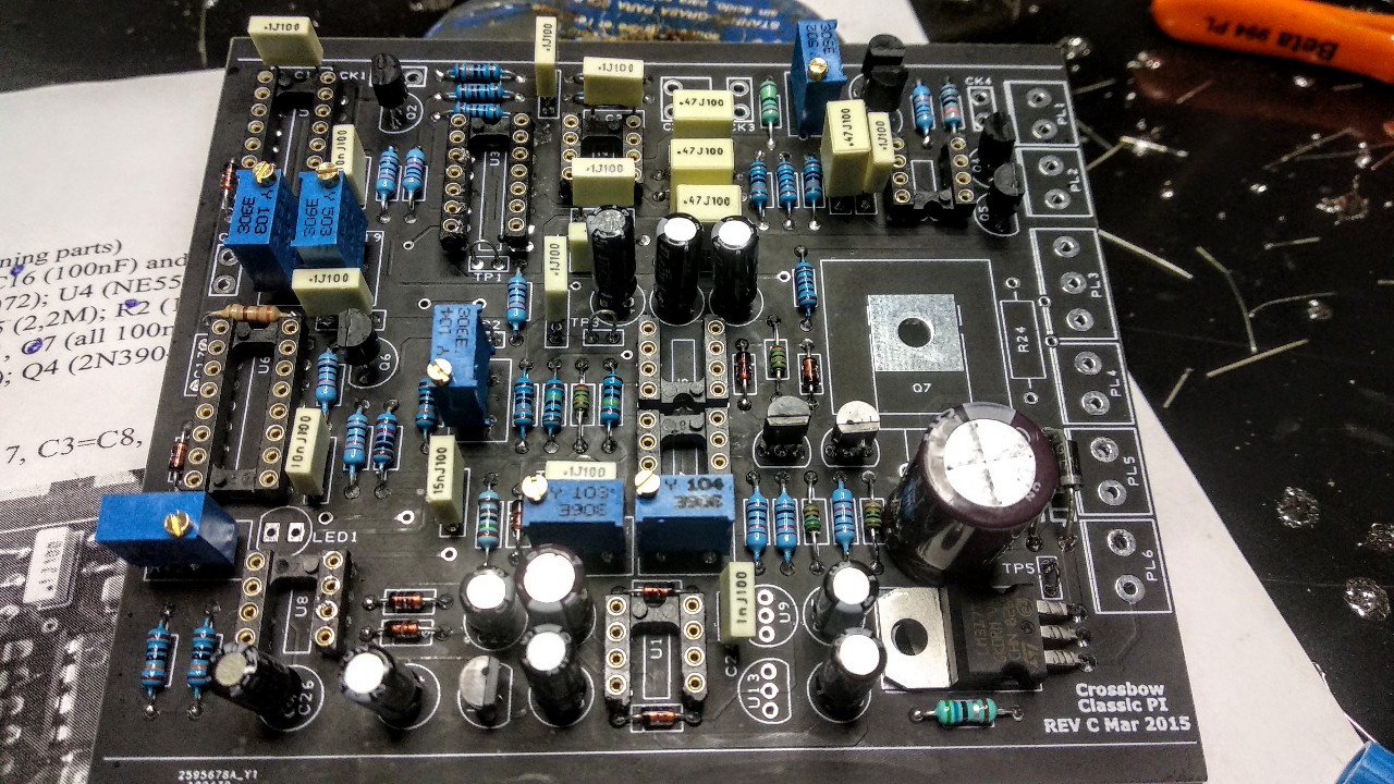

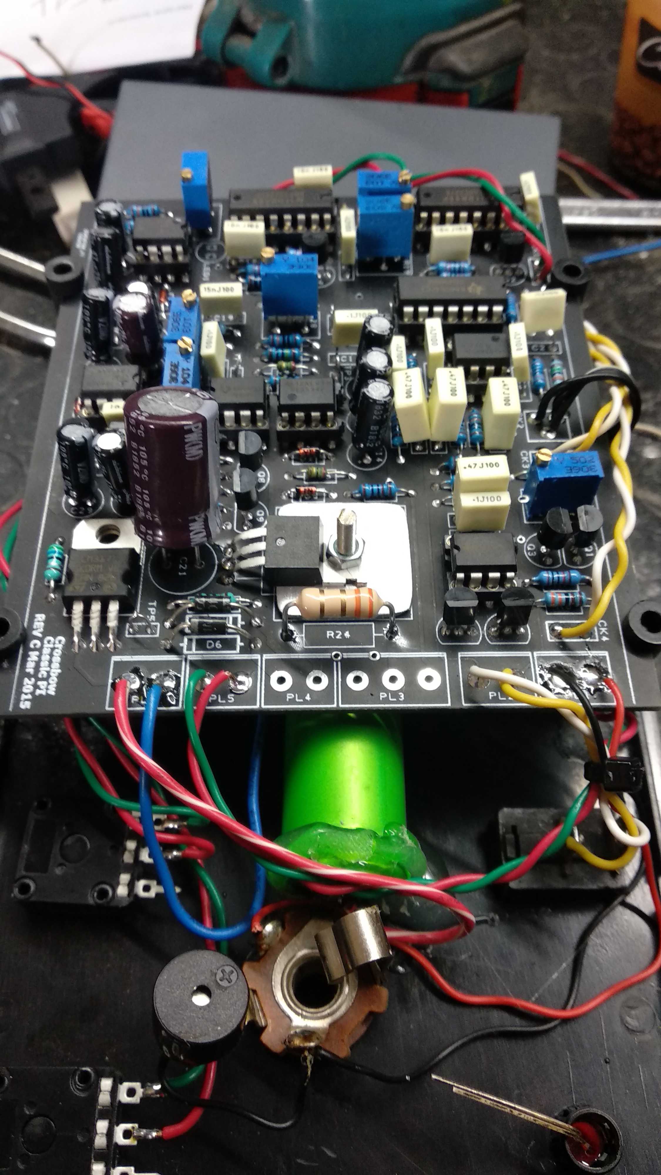

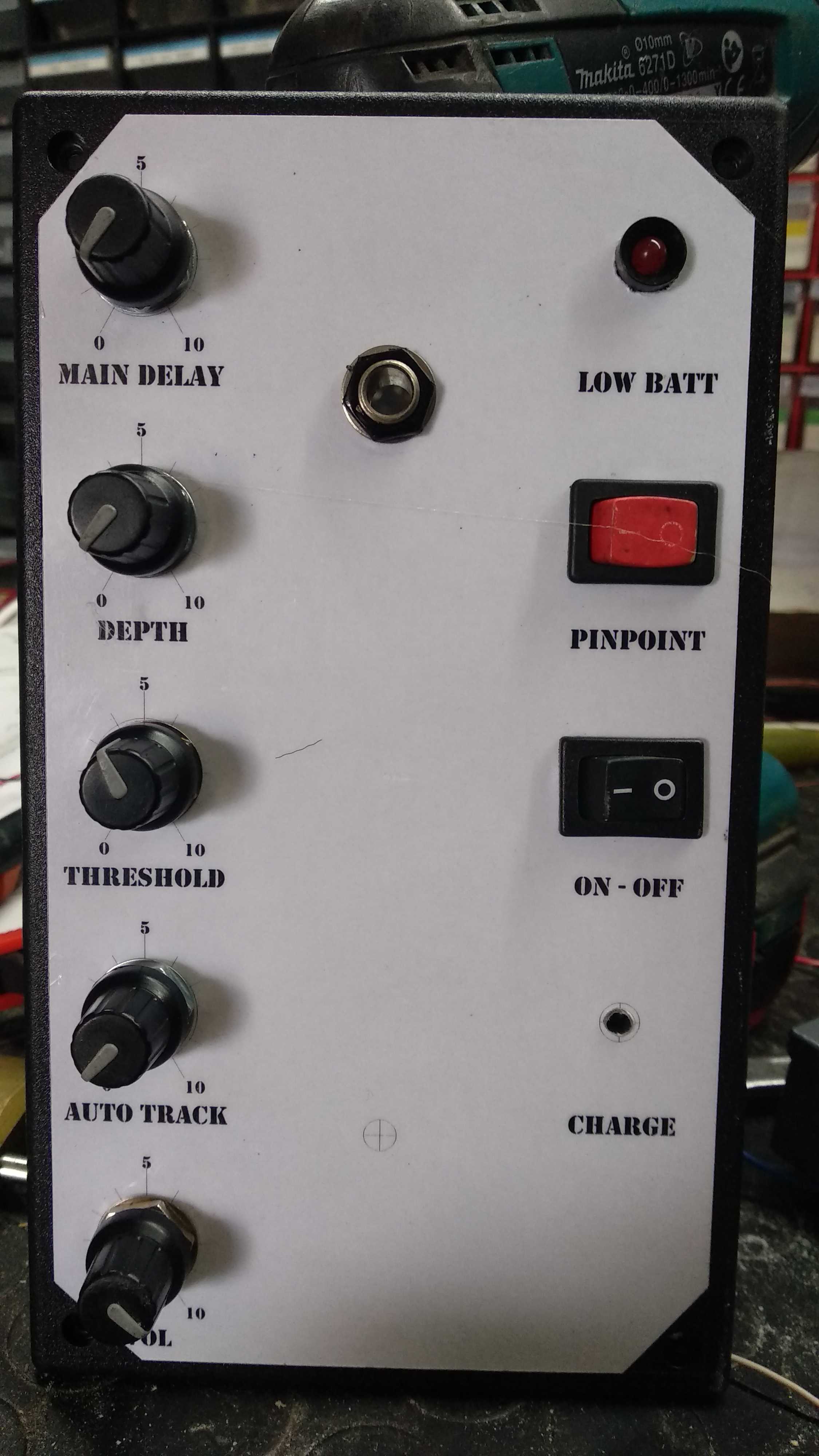

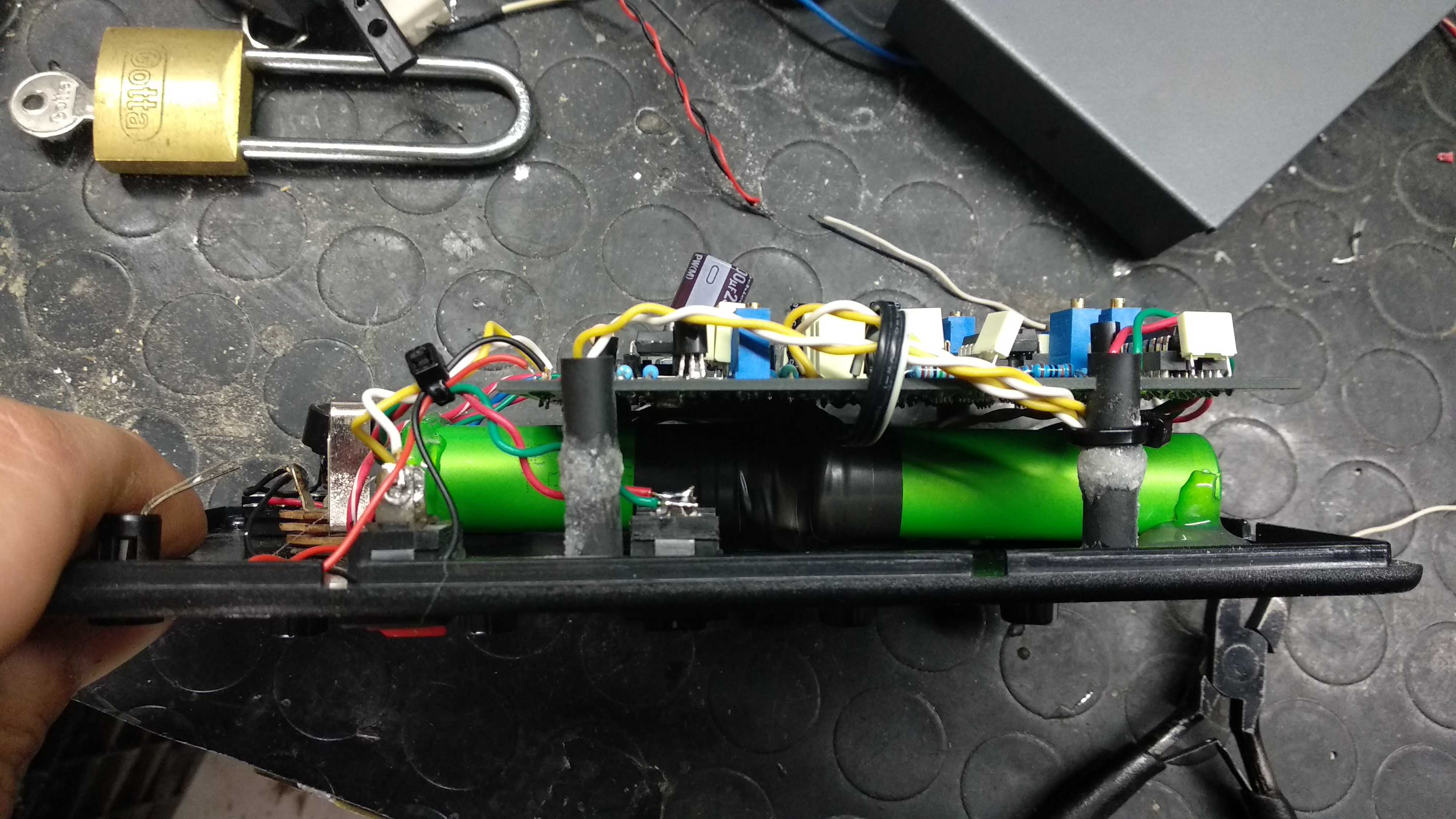

                              • Allmost finished the CrossBow (waiting for 5-pole connector for coil and the charging connector) and im really excited!!My first plan was to mount the detector as my MPP right down at the handle but i decided to mount on my belt via a belt clip since i dont have a proper mounting,there are lots of out there but they are pricy since a lot of custom fees and duty taxes are inolved,the housing is medium to large but managed to fit all parts in.I have to say its VCO audio is magical,nice and steady ticking adjustable as it has to be,little annoying on headphones because its too "mid-bass" for my hearing taste..A worry i have is the batteries (3x18650) is very close to PCB and somewhere i read something about 18650 and interferance.Also i will have to see the charging circuit because the original CB had NiMH battery pack.The Tx pulse is very steady (both pulse duration and frequency) and precisely adjustable.
                                I've also posted on area51 to hear from other guys built the CB and asking if there are some points to look after but i think the forum is nearly dead (no replies except Sven for a long time)..
