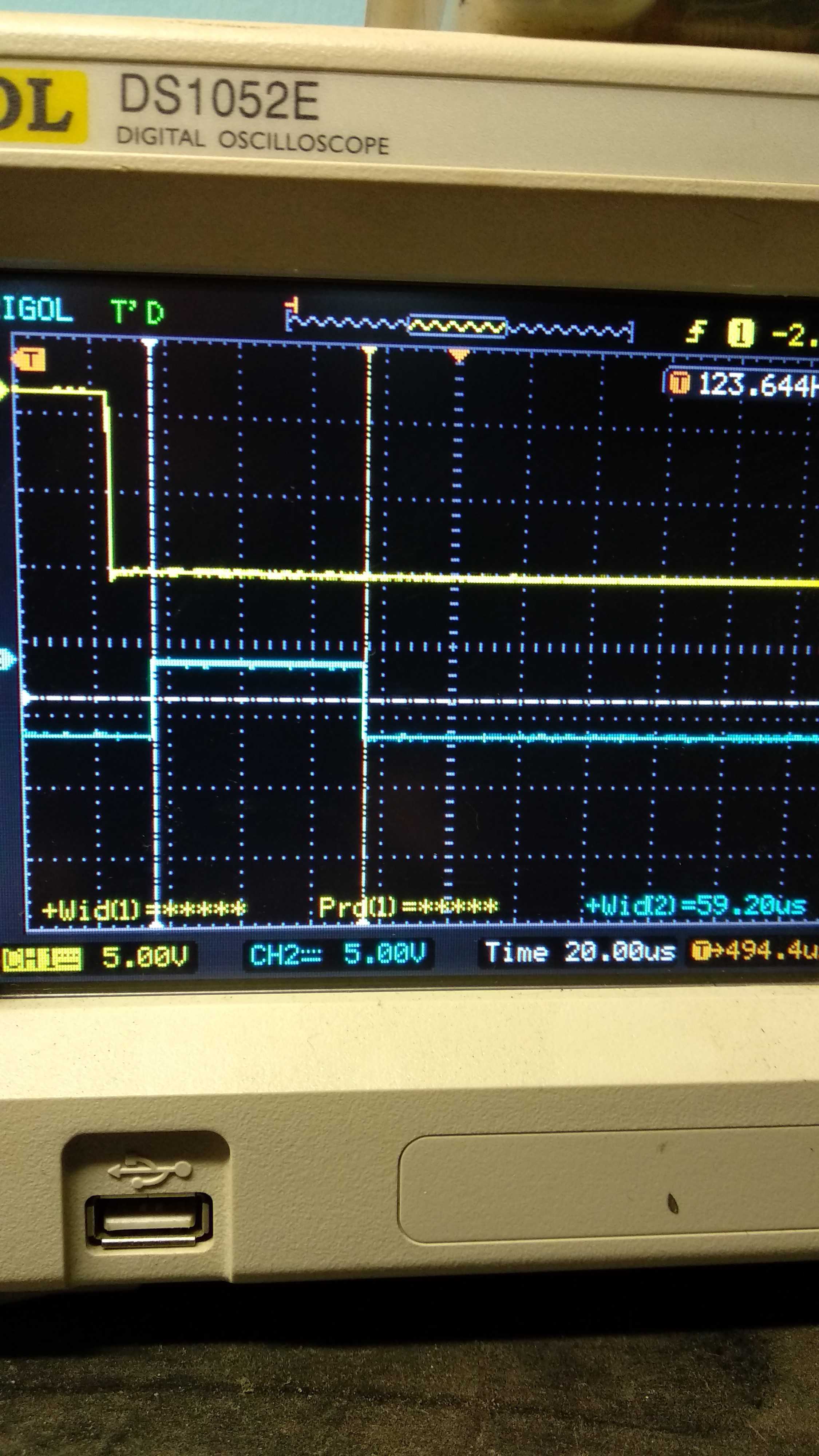

        Now,at Step 6 says 1ch at TP2 and 2ch at TP6.According to Fig.10 there should be a delay (Main Sample Delay) of 10us.As you see from the photo below the two curves have no delay between them...Thats probably why i dont sample gold right?
        [ATTACH]45909[/ATTACH]
        Totally misunderstood..The sample delay PULSE (TP6) is 10us,i was looking for 10usec delay between main pulse and sample delay pulse..
        Also between main pulse (TP2) and delay pulse EFE (TP there is a 10usec spacing.The thing i thought i was doing wrong was very clearly written on top of page 6 of instructios about rev e "EFE=100us+main sample delay" This correctly is 110us (i mseasure 116us where those 6us comes from..????)

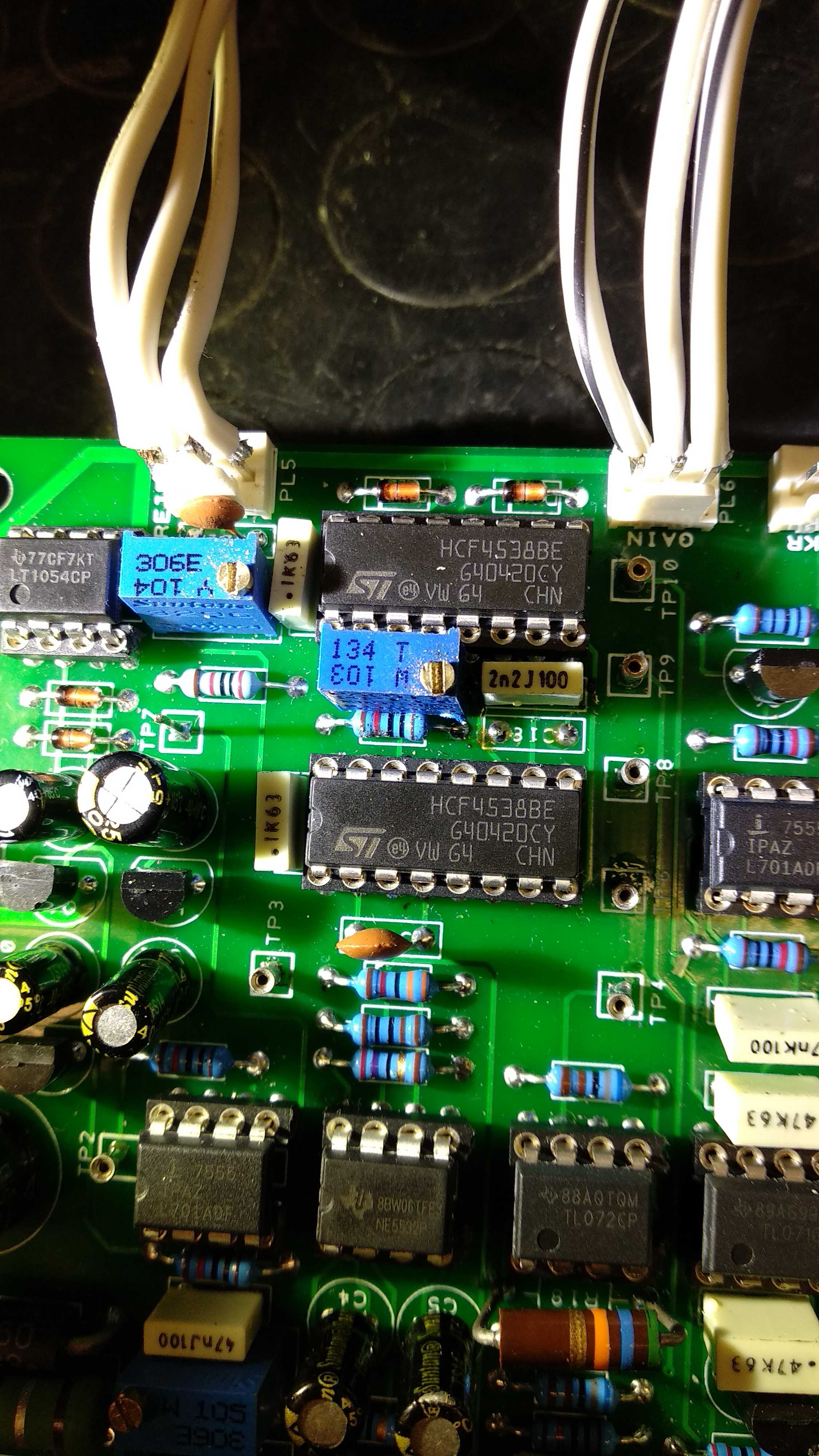

        My wrong measurment at TP9 corrected by replacing R35 with a fine 5k trimmer (i saw an older post George made such a suggestion),so my readings at TP9 and TP10 are identical 10us.

        The only thing thats left is that with the gain pot i go from 10us to nearly 30us not 52us as written on instructions,should i blame the coil??

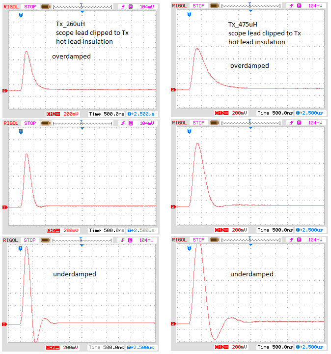

          You want to adjust your damping pot to you see the ringing then adjust it until the ringing just disappears.

            Yes exactly,I put the first resistor network (resistor parallel with resistor+pot in series) as I read with 1.2k resistors and I couldn't see it..So I put a 4.7 pot I had laying around and the ringing effect was clearly visible.If you find the video or if you have a thread in mind please post because as I see correct damping is 50% if the building success..
            As for the gain pot ,when I replaced the R35 with a fine trimmer I double checked the r32 c18 and c19 values are correct...I should look it up further..

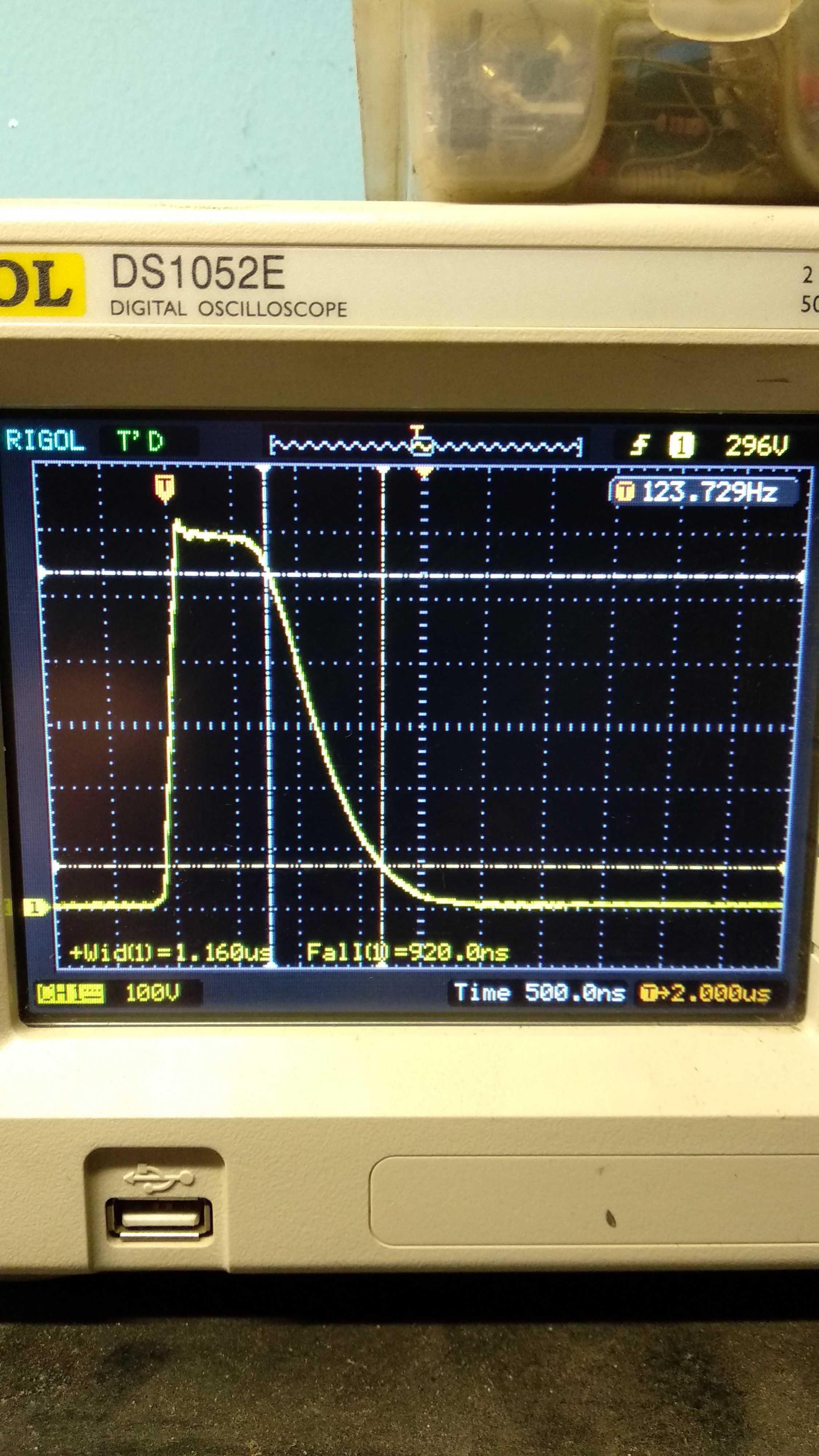

                Some scope pictures adjusting damping. Two different Tx coils, scope lead clipped to Tx hot lead insulation.
                  Thanks green for the usefull info.I used TP3 (I think) for the damping procedure,my waveform looks mostly like the o e down at right...
                  Tommorow I will try to dump again and measure from the "Hotpoint" of the resistor...Thanks again for your response!Do you think with better coil I can achieve more precise timmings?

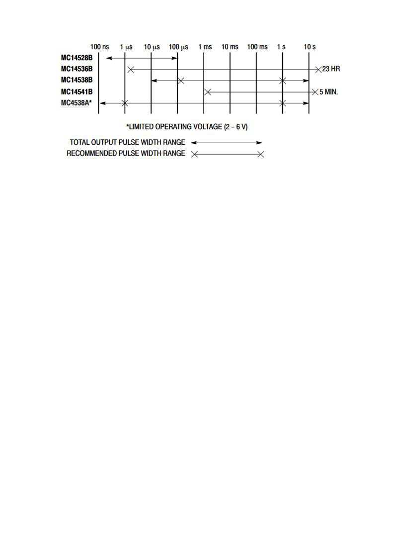

                    Just out of curiosity, which 4538 chips did you use? I mean the whole name. The small discrepancies could be result of which type used.
                    CD4538, hcf4538, rca4538, mc14538 etc, then bp, bcp, etc. Don't know for sure, but try swapping out for different manufacturers if you have any in stock.

                      Thanks dbanner for your reply,currently I'm at work tommorow I ll be at my homeshop and I will look it for sure.I bought the kit (pcb+parts) from diydetectors cause TME was out of stock to some parts..I also believe that timmings issues are due to ic quality..We should use cmos ic's ...I've checked on arrival all parts except the ic..
                          Thanks godigit1,took me sometime,learned a lot of things and come down to some conlcusions.As for ringing the only time i saw on the scope "ringing" i was monitoring TP3,a very helpfull image on green's post took measurments at hot side of the coil.

                          Happy happy happy!!!!!!!!!!!!I dont know if it is correct but i cut one side of the pot and bang!
                            Unfortunatelly i dont have stocked another 4538...Mine is the HFC type by St came from diydetectors.co.uk within the kit.

                            As i see from image below its a "faster" type than MC14538BCP ..

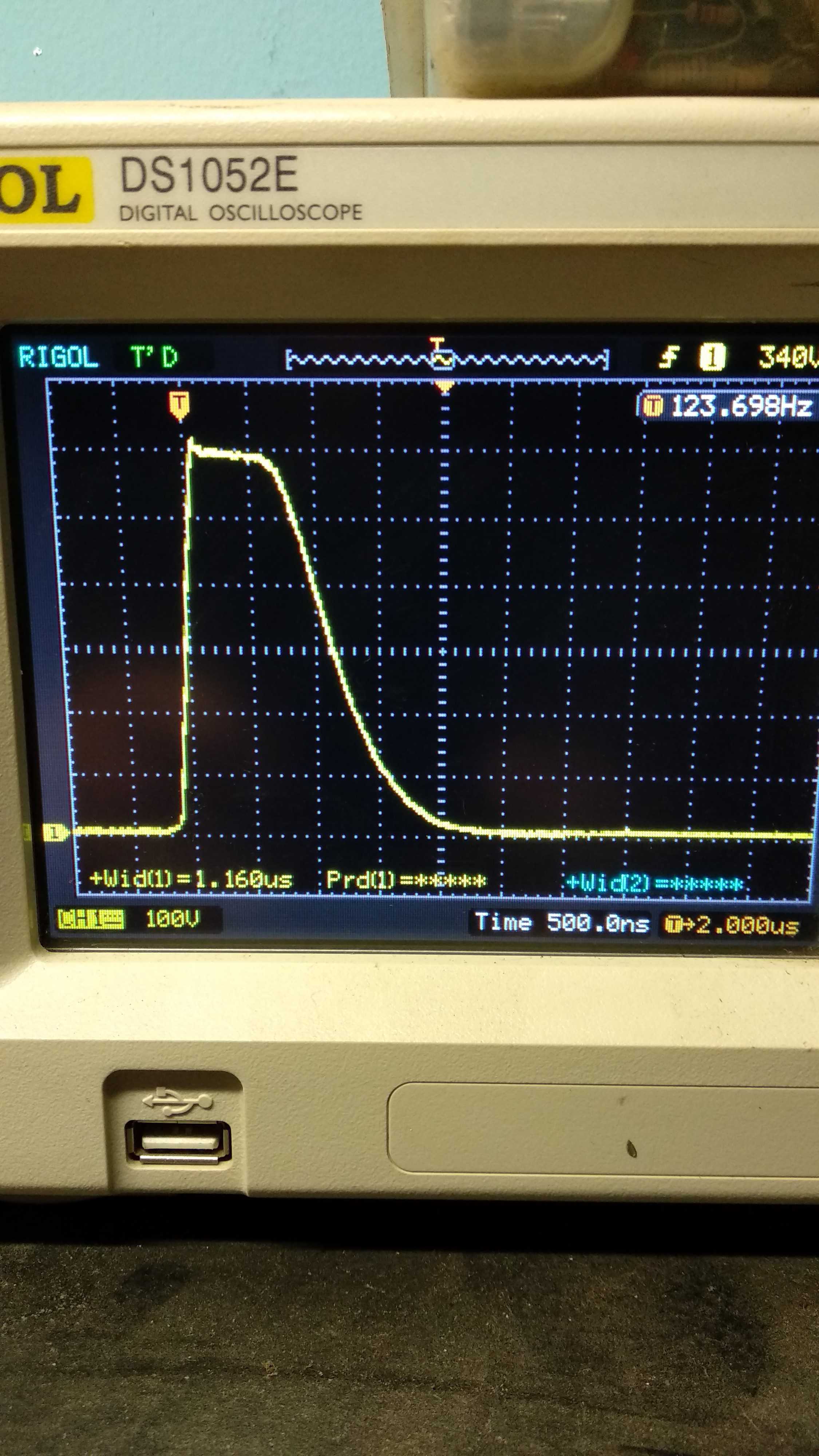

                              Well here are mine readings (this time dumping resistor 1610Ohms)

                              How do they look??Comparing to the photo you've sent me mine has a steep rising edge with something weird on the top left edge..
