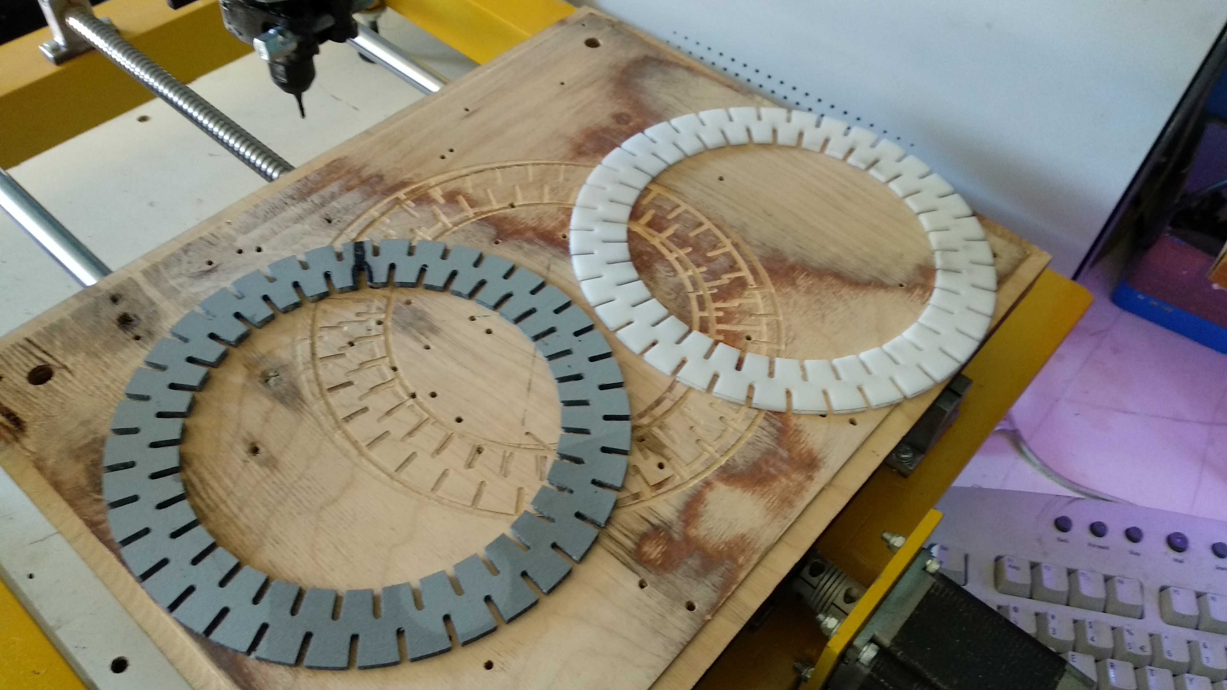

    After some quallity time with Autocad and my cnc i finally have the coil cores made from PE plastic..My concern at this moment is that the core is 2,5mm thick not 0,7-1,5mm as instructions,i couldnt find at local market PE this thin...Hope it all works out well

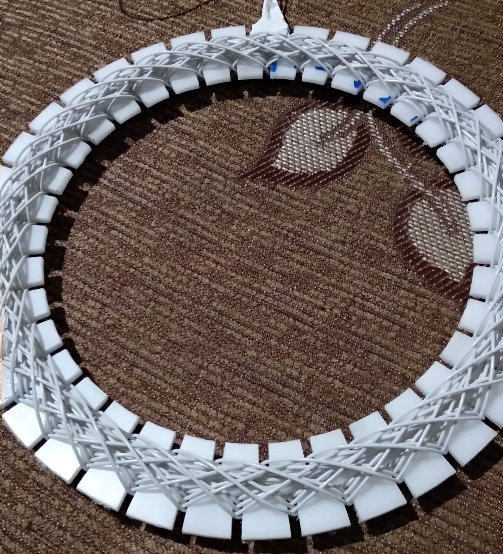

        Something is wrong

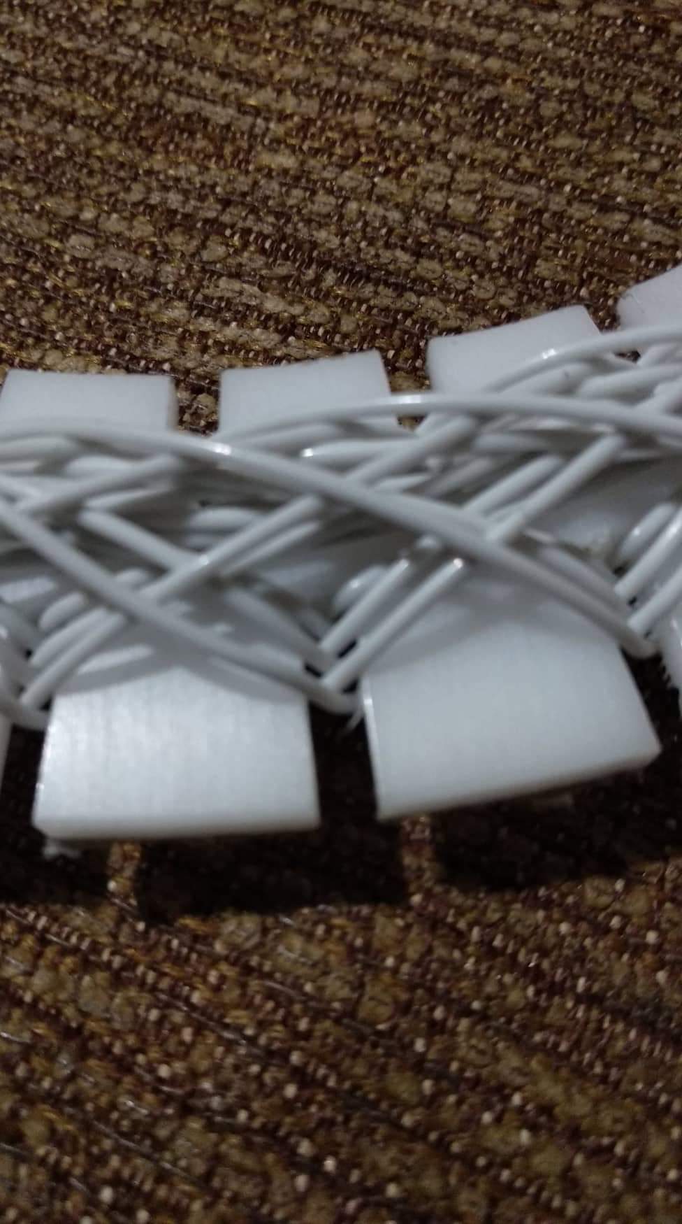

        I've started winding at inner slot,3 out 3 in,after 5 full turns i entered again from the slot i began,moved 4 upper slots and so..

          read my comments https://www.geotech1.com/forums/show...l-for-baracuda
          you must do A TRANSFER STEP after every one layer.
          • #50
            Sorry,my bad,i did not transfer 1 slot every 5 turns...grrrrrrrrrrrrrrrrr...I hope it worth it

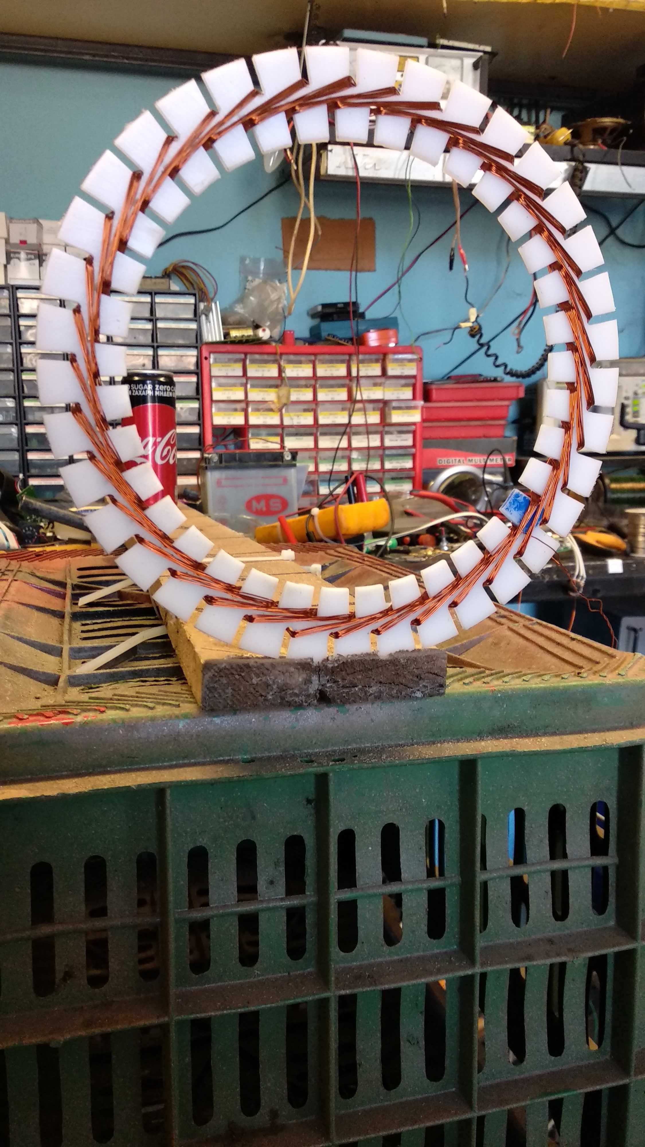

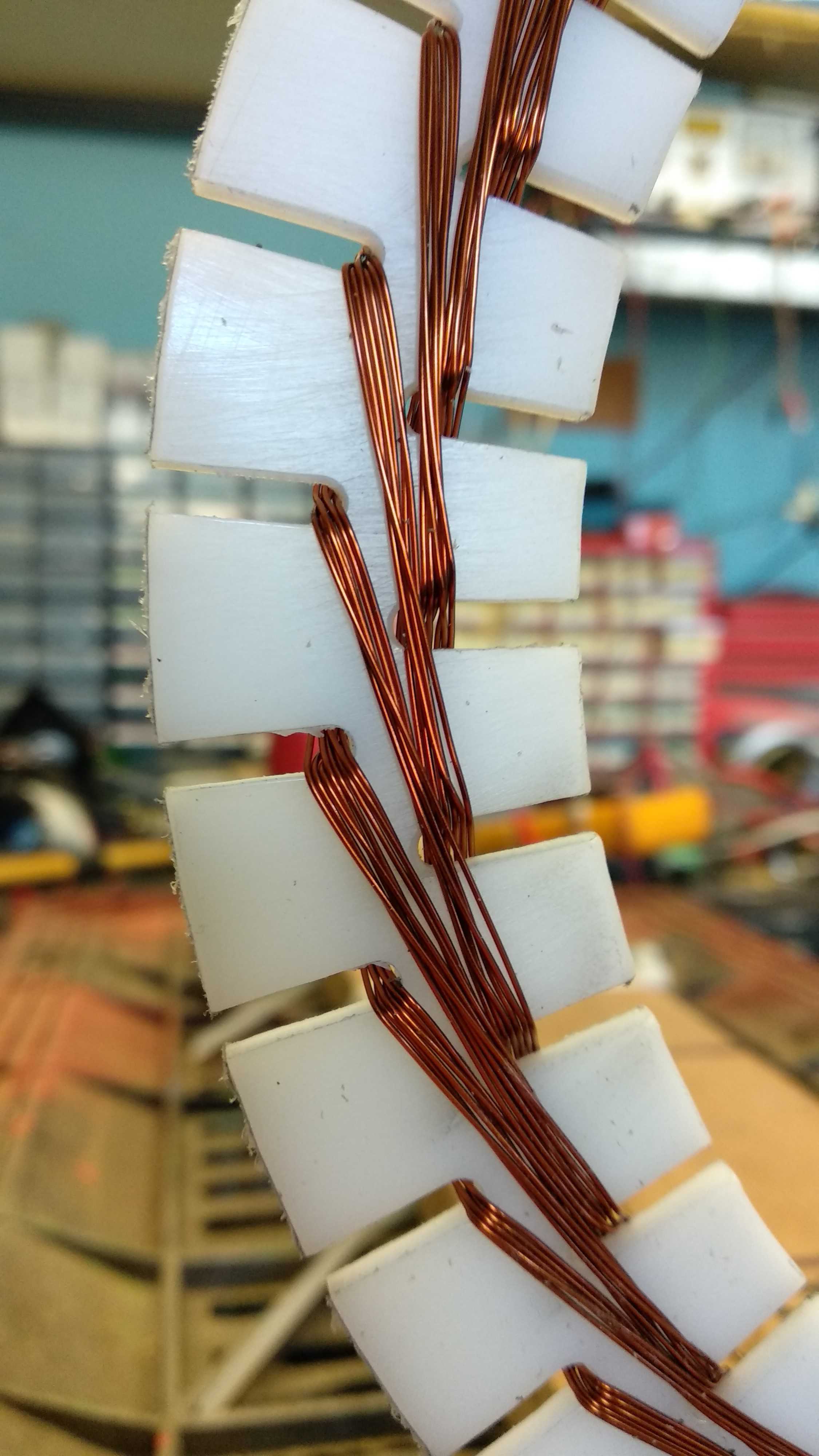

                    It is my first time to such complex coil build,didn't notice little crucial detail such the one slot moving after 5 turns each time...At 25 turn I still moved one slot forward,instructions said front or back...ETFE cable 0.64mm I think.Im going to test it on Saturday,hope I nailed it!

                    • #55
                      That looks really good. Now you know why I stay away from such coils.

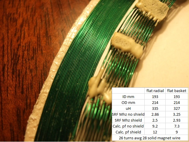

                            Flat spiral and flat basket I posted awhile back. Coil capacitance less than 1foot of lead wire. Don't seem to need spacing between wire wraps to reduce coil capacitance. Maybe another reason to space wraps?
                                Thanks green for your reply!
                                So spacing between the wraps won't reduce capacitance?Did the coil you show work well?
