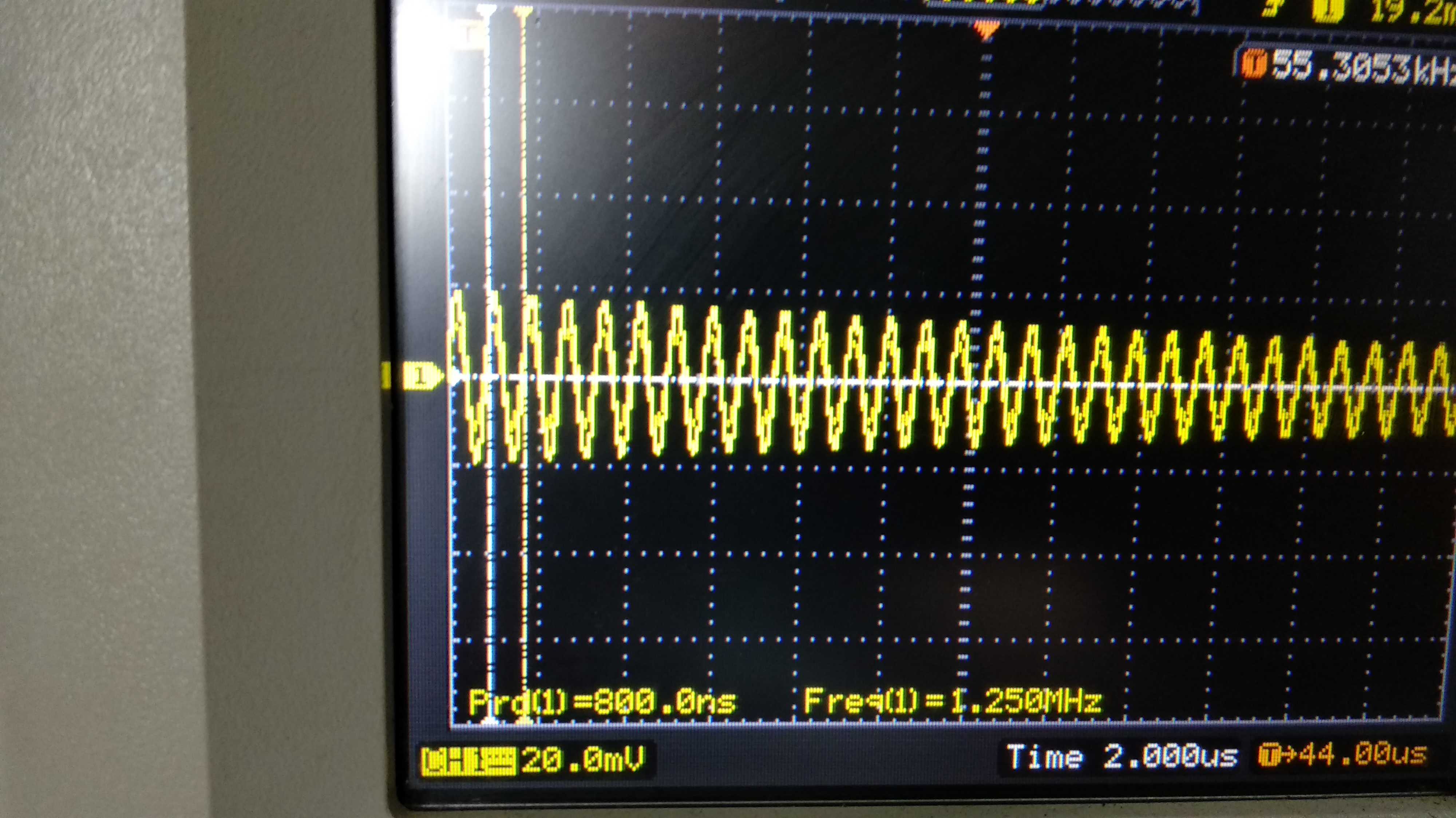

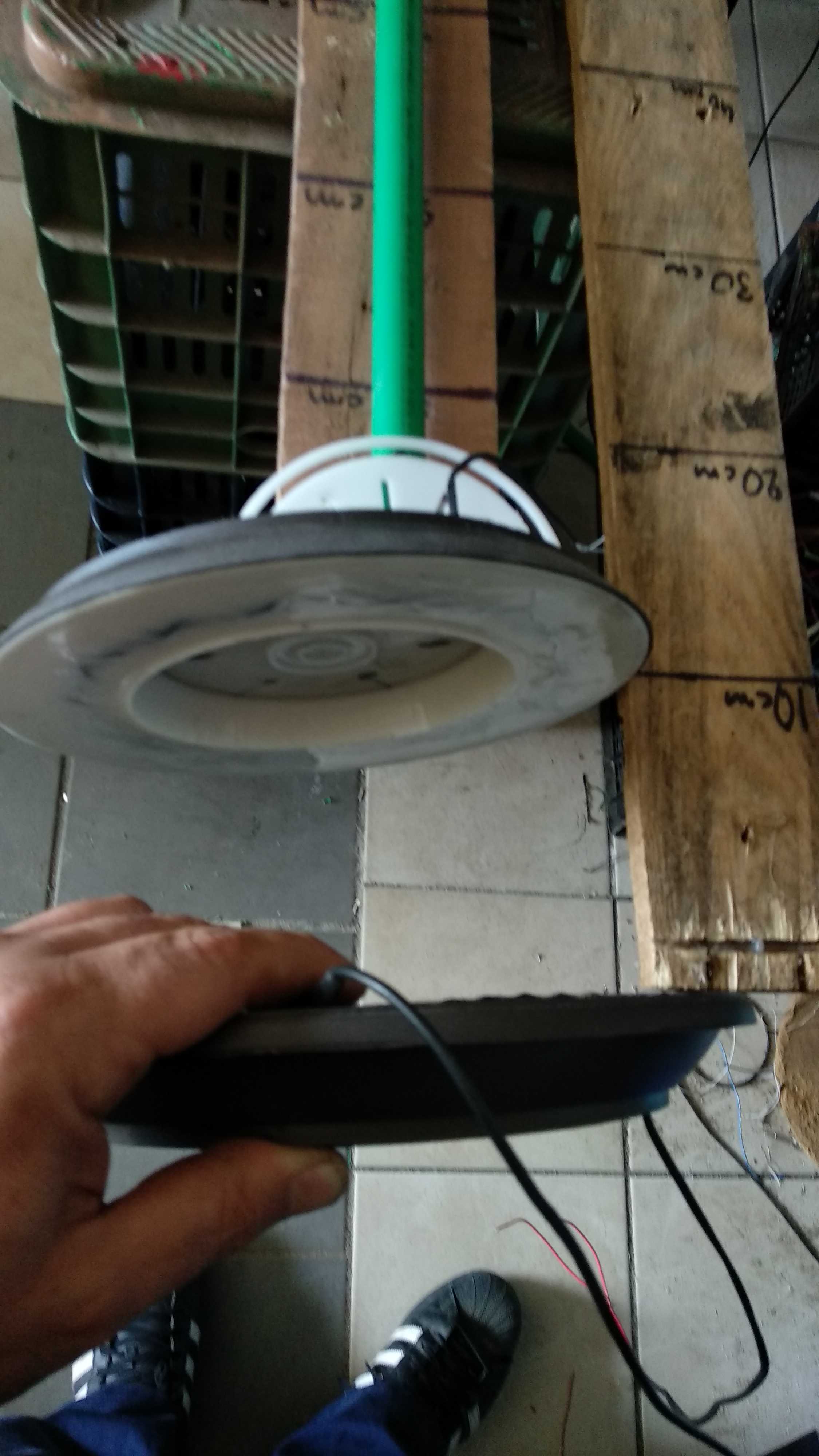

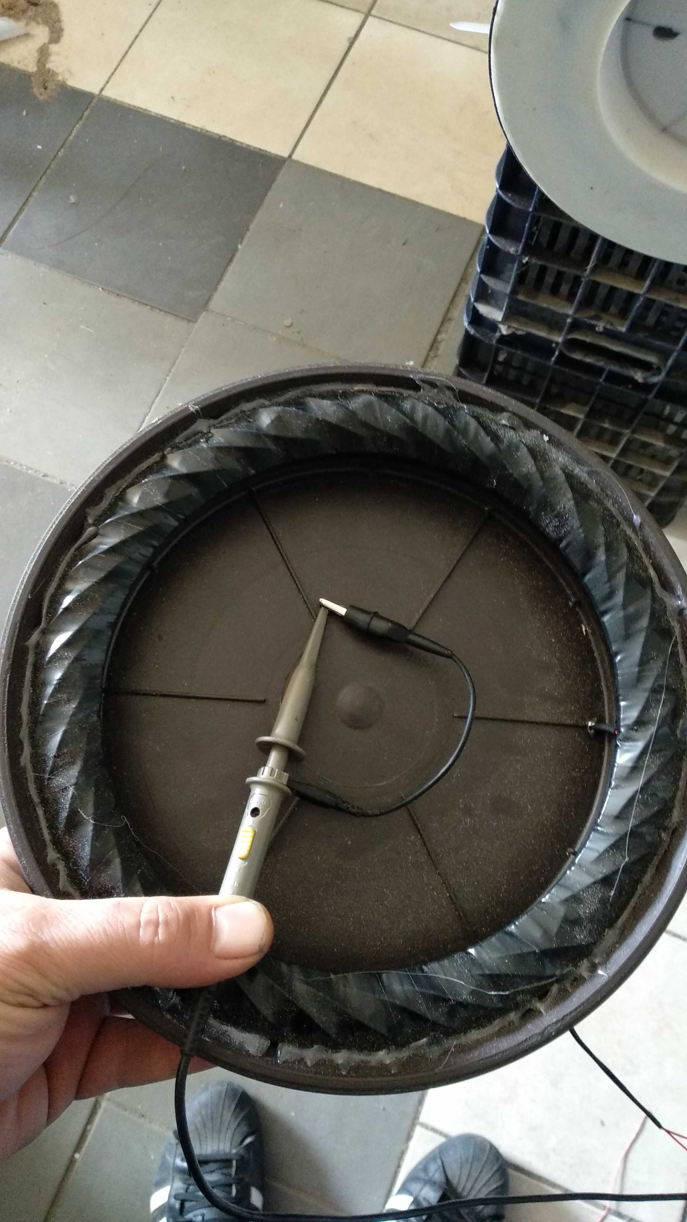

              Clip the scope lead to it's ground lead making a loop. Lay the loop on the test coil and position the test coil near a operating PI coil to get a good scope reading of resonant decay(scope 5mV or 10mV/div). Record SRF.

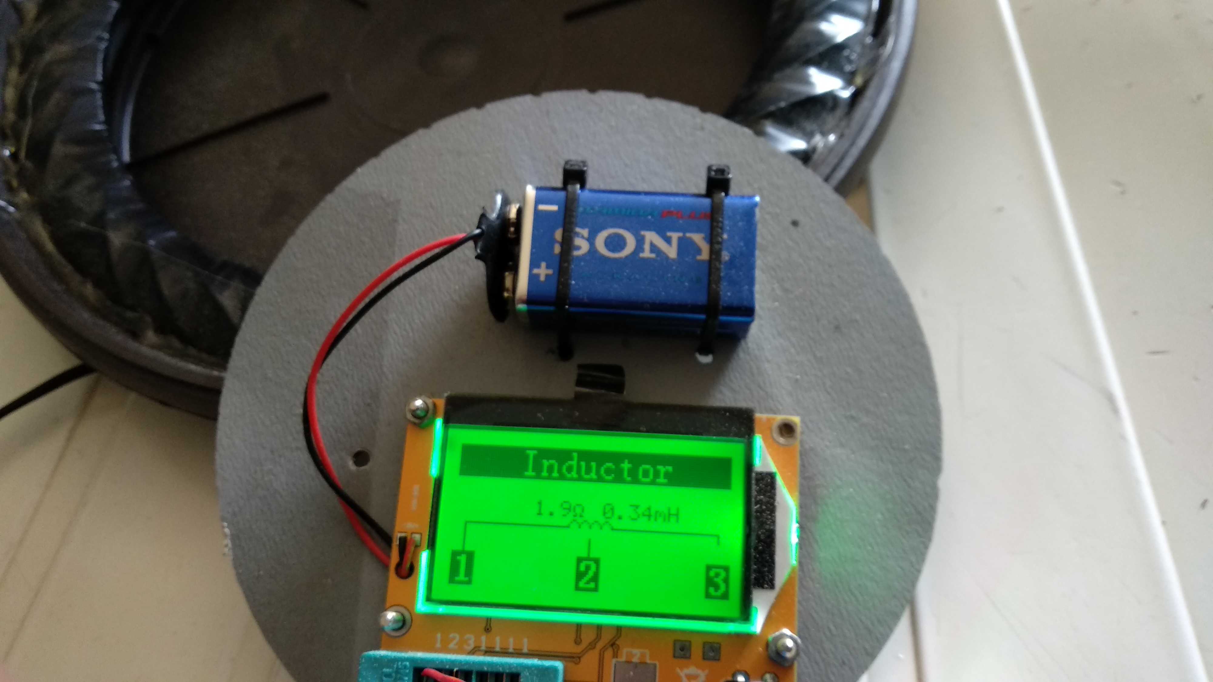

              The test coil leads are open right? I have another 3dss waiting (340uH 1.9 Ohms made from PTFE 24AWG silver plated)

              I will lay on it the loop i made from oscope + and gnd and how close should i put it near the working coil of my MPP...Put the oscope dc coupling and 10mV/div...

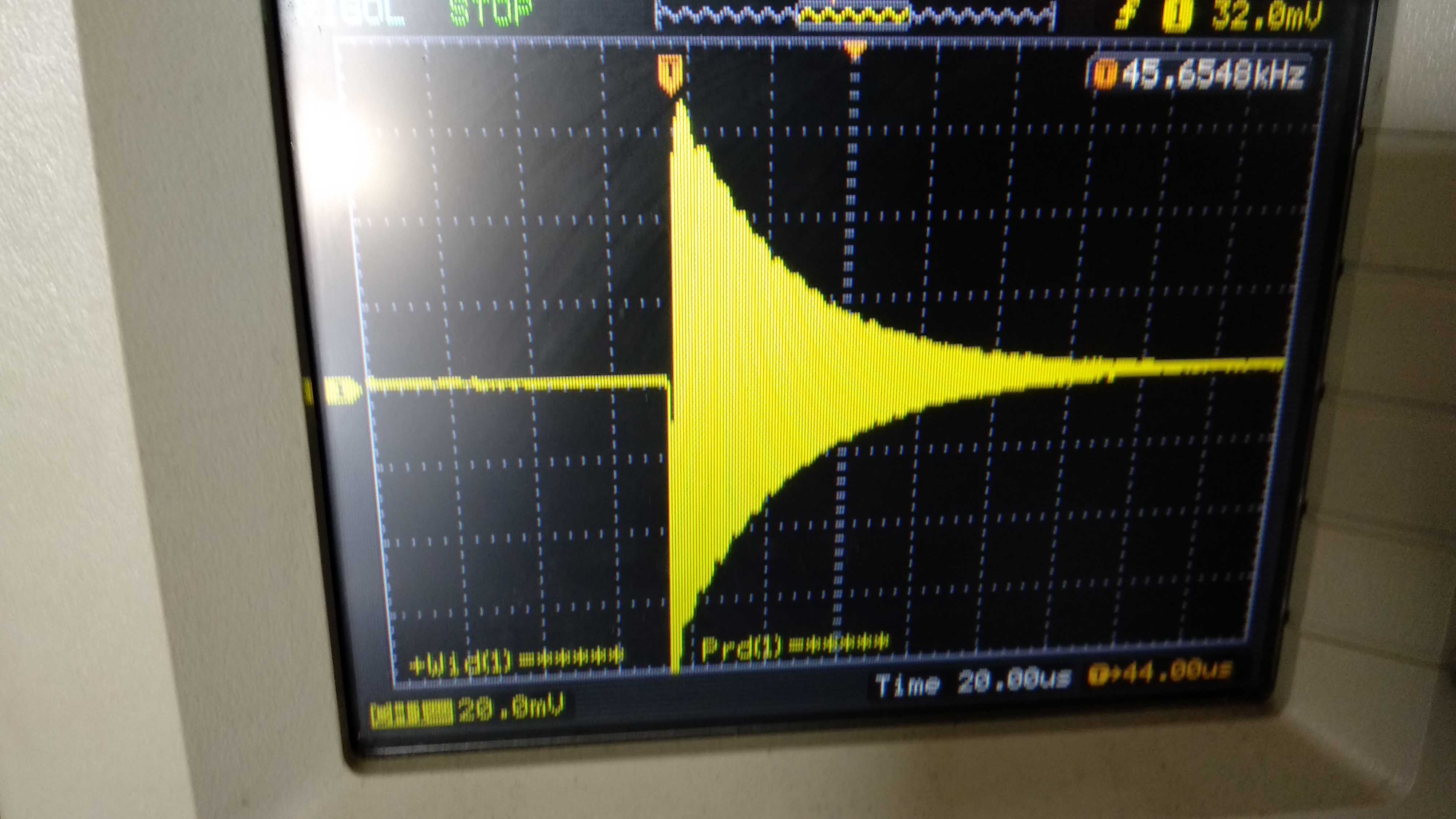

              What did i measure in this precedure??

                Nice decaying oscillation-perfect.
                Decrease the scope's time base, maybe 2usec/div, to see and measure the time between oscillations (period of oscillation). divide into 1 (1/t) to get the SRF in Hz.
                • Looks like your scope can display frequency. Set scope to display frequency and do what waltr suggested, change time base until you get a good reading. Adding a scope picture I posted awhile back.
                      Here it is
Name:	Oscope Output Period and Frequency.jpg
                      So Rd=pi*L*SRF --> Rd=3.14*0.00034*1250000=1334.5 Ohms.
                      So this coil when it will be attached to a PI detector should damp at 1.33 Kilo Ohms ????
                      I noticed that distance between testing and working coil had to do with signal amplitude not frequency..
                      Yes my oscope measures lots of stuff,trully value for money...I cant understand what is the trigger freq in the upper right of the photo..
                      Now Rd*Rd= L / 4*C --> C= L / Rd*Rd*4 --> C= 0.00034 / 1334.5*1334.5*4 -->C= 0.00034/7123561 --> C= 4.77 e-11 ...what is that now

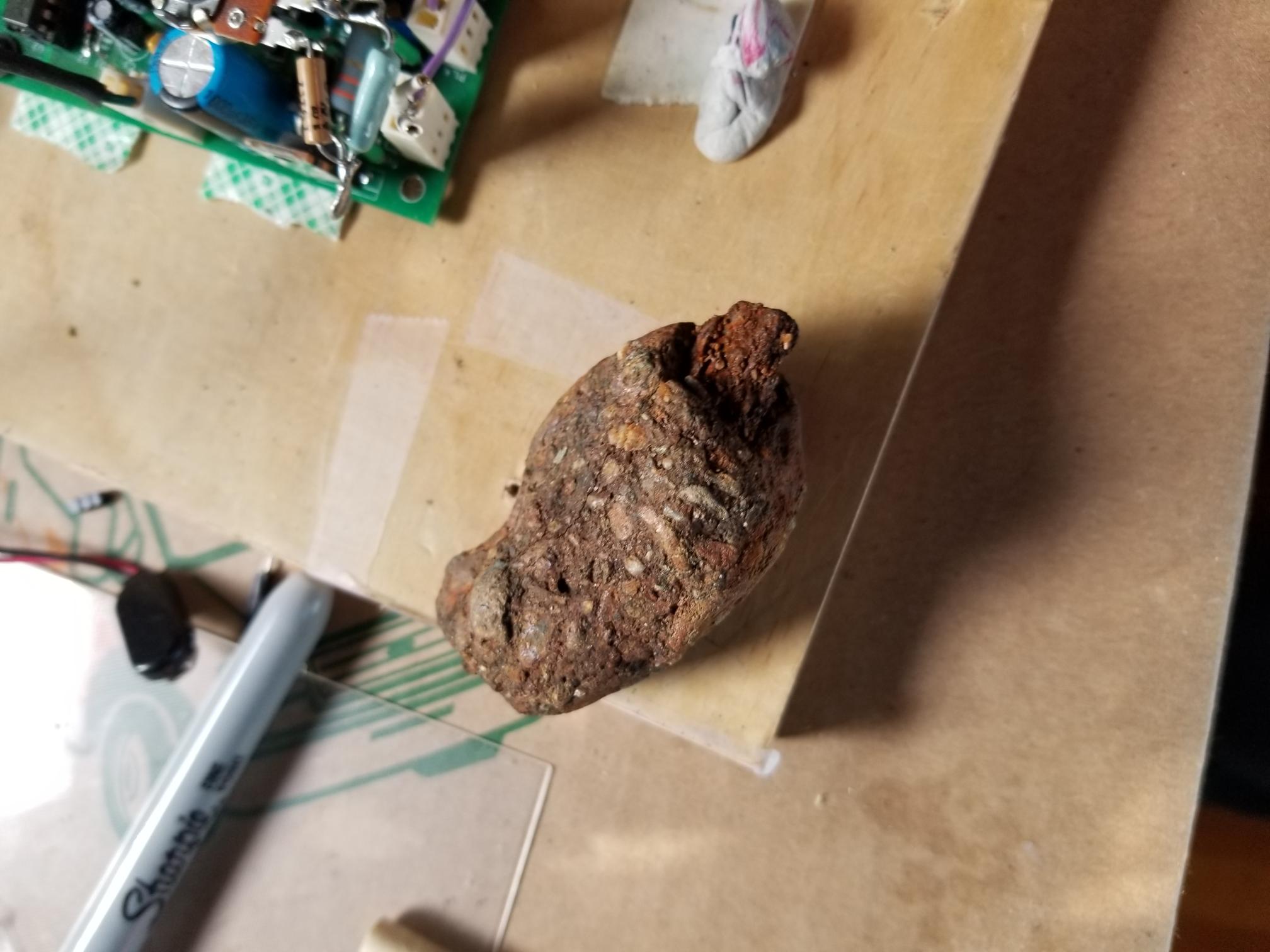

                      • And the Amador nail recently found on a expidition to recover hot rock samples.
                        Incased in a conglomerate surly it must be thousands of years old

                          1335ohms should be close if the mosfet capacitance is isolated from the coil during discharge with the MUR460 diode. Lot lower resistance without the diode. Don't know if scope reads frequency better if display shows 5 or 25 cycles, I usually adjust time base for 5 to 10 cycles. Maybe someone knows if should be different.
                          I use a different formula for calculating C if I know SRF and inductance. C=1/(2pi*2pi*L*SRF*SRF). Calculates the same 47.7pf you got. Total parallel coil capacitance including lead capacitance. Fast coil, one reason easy to get mosfet avalanche. Parallel capacitance stores little energy at Tx off so 1A peak at Tx off would cause about 570V with Rin=1k and Rd=1335
