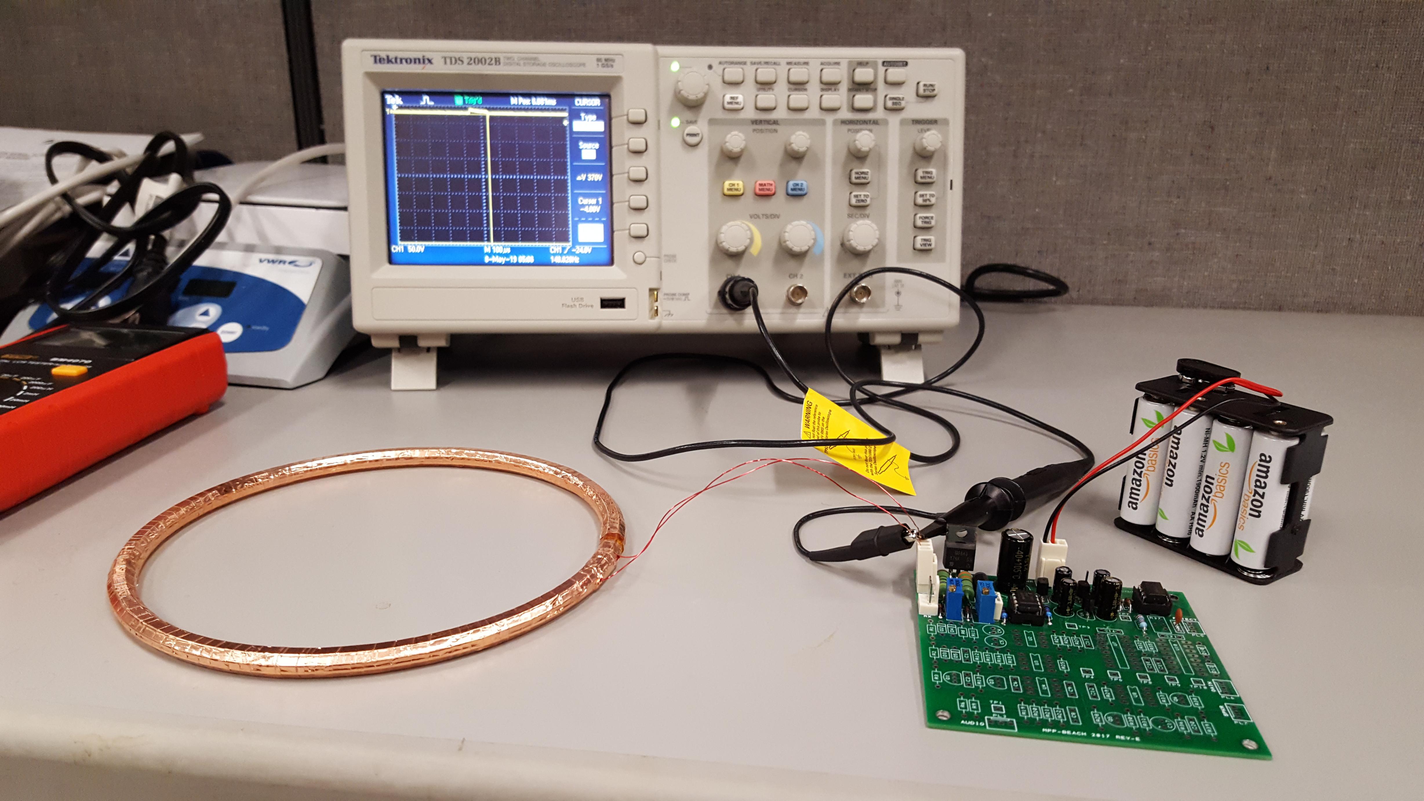

    Hi All, my first post, been lurking for a week waiting for my MPP kit to arrive!
    After contacting Sven about his Mirage project, he pointed me to this site, the diy detector site and suggested I start with the MPP Beach. I just received the board and parts kit, a Whites space saver rod kit (very nice for the price), fiber bolt, 100' 24 AWG enamel wire, thin copper EMI tape and a Proster LCR meter (works pretty well).
    I built my first ever coil by 3D printing a 170mm wide 8mm octagon with a hollow cavity for the wire and a slit on the outer perimeter to feed the wire in. I used the coil calculator to target 325 uH using 26 turns. The LCR meter reads it at ~328 uH, resistance right at 2 ohms, resonance at ~864 kHz with copper shielding in place and no lead wire. I am very happy with this first attempt even if the coil is a bit on the slow side. The 3D printed "donut" holds the coil together and provides a spacer between the coil and the copper shield. I think the dielectric constant of PLA is about 3.5. The calculated capacitance is about 103 pf.
    Question:
    I am looking through the build manual and see on step 4, that you measure the flyback voltage across the damping resistor which should be in the neighborhood of 350 V. My scope has a input limit of 300 V, will this be safe to measure with a 10X probe? If not, what do you suggest I do to measure this.
    Jamie

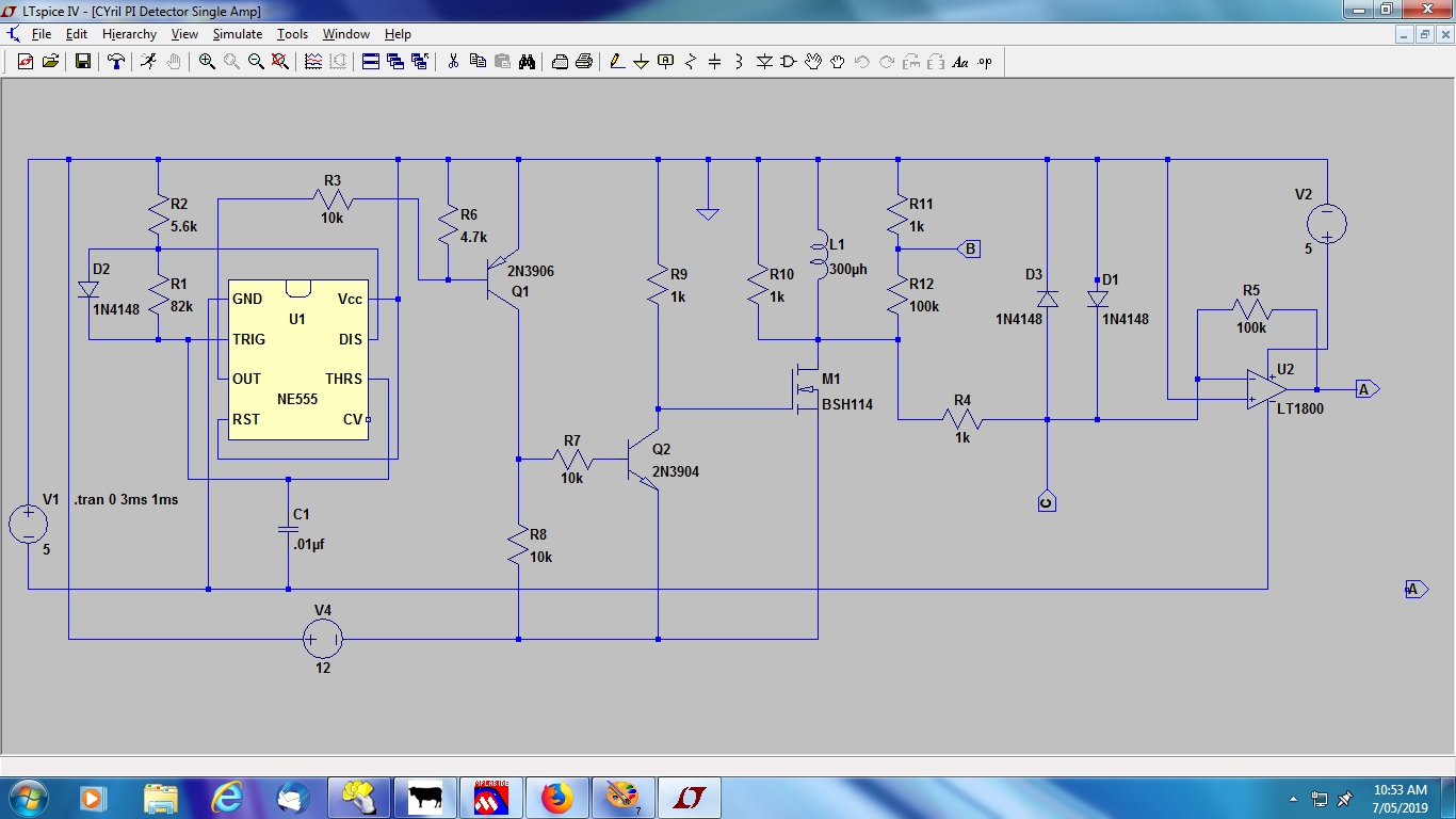

            guys do suggestion of Eric where he wrote to put a resistor 1Ohm in serial to coil and look a picture on it.
            thats enough and you do not need setting x10. just read all that Eric had wrote.

                  flyback voltage is almost sure same. you will see a current. put a resistor between the coil and +9V. put gnd cold end of the probe on +9V, hot end on the
                  joint resistor-coil.
                    Oh, I understand what you mean, measure the smaller voltage across the series resistor, thanks.

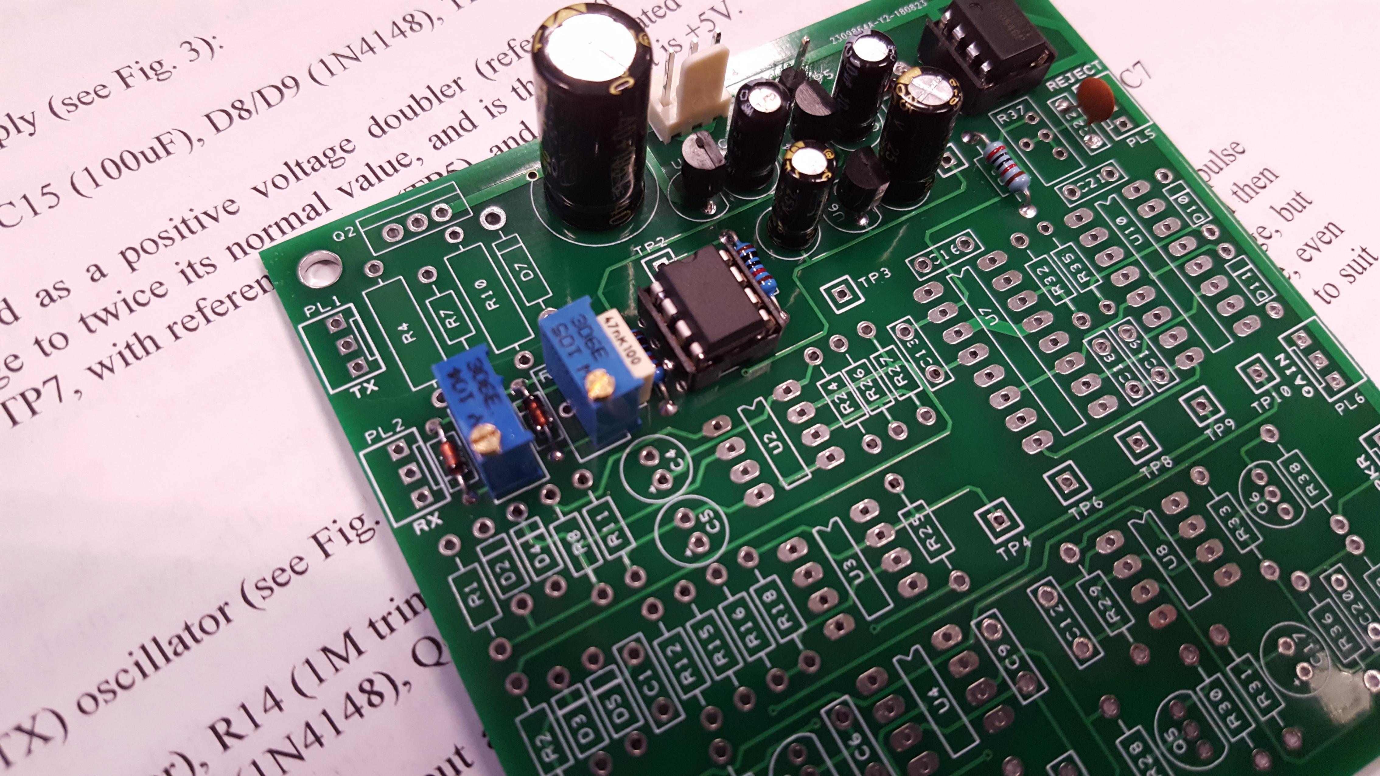

                        On stage 3, while installing components
                        1. C22 is ceramic disk vs. little white box type, not trying to nitpick, just want to verify substitution is OK
                        On stage 3, while adjusting TX pulse period and width, are these normal expected observations
                        1. set pulse period first, while setting pulse width observed that pulse period is also changing (settings are interacting)
                        2. pulse period is not completely stable (varying at a relatively slow rate (slow period jitter)
                          OK, I am passing stage 4
                          Flyback well over 350V, hard to measure but probably around 450V. Still have an intermittent jitter on TX oscillator period.

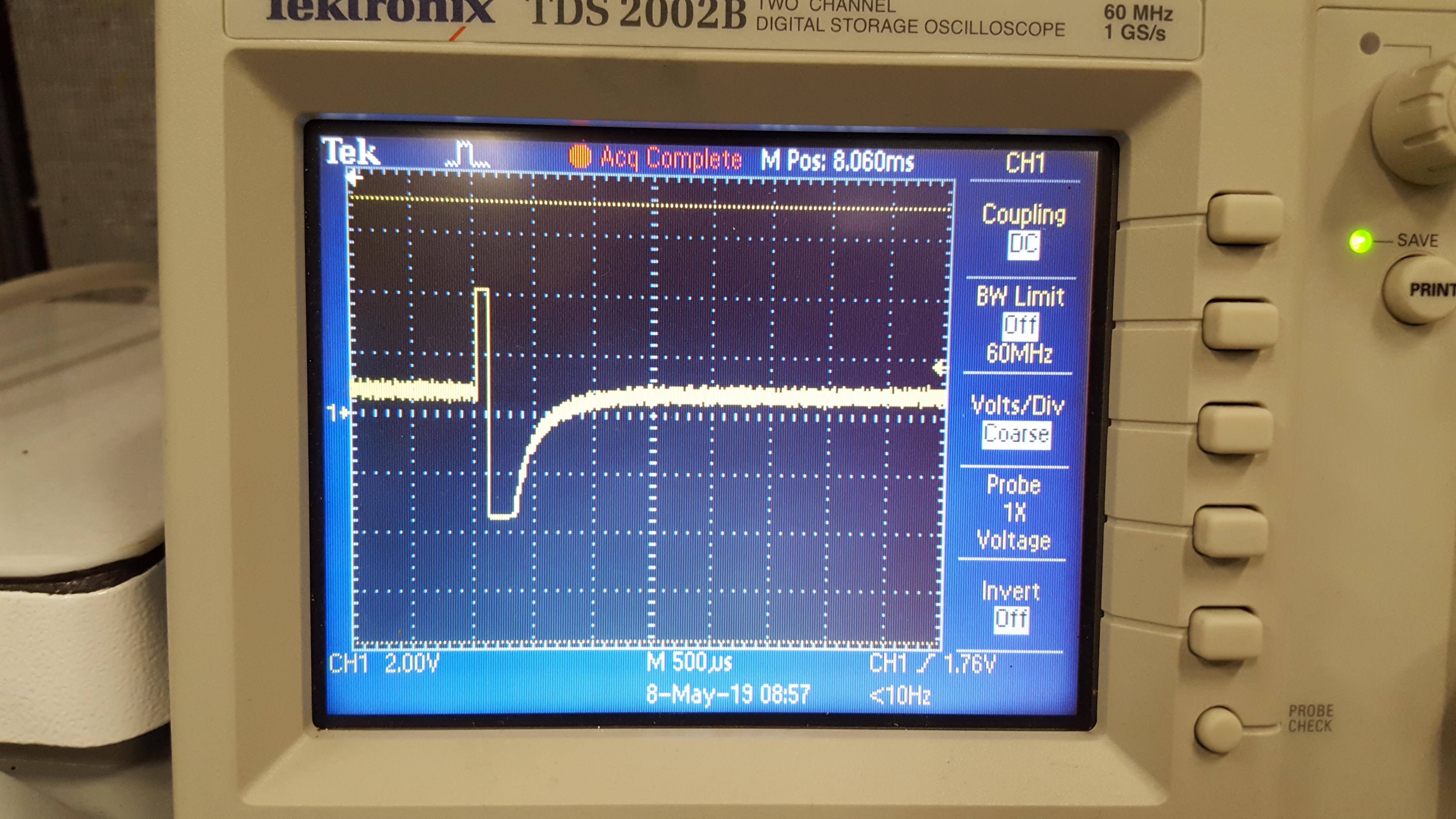

                            Stage 5 waveform at TP3, does the noise level look normal?
                              The noise level looks ok. If you change the orientation of the coil you should see the noise level change, indicating that it's externally generated.
