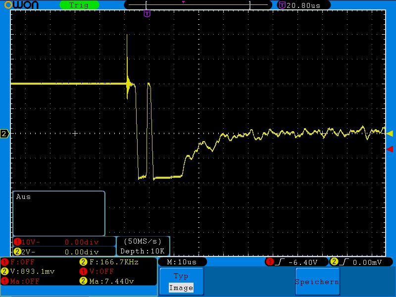

            Hello,
            i have measure now between Coil TX and TP5 and i have ajust the Dumping resistor.
            It?s this curve corect?
            The value of the damping resistor are 424ohm...

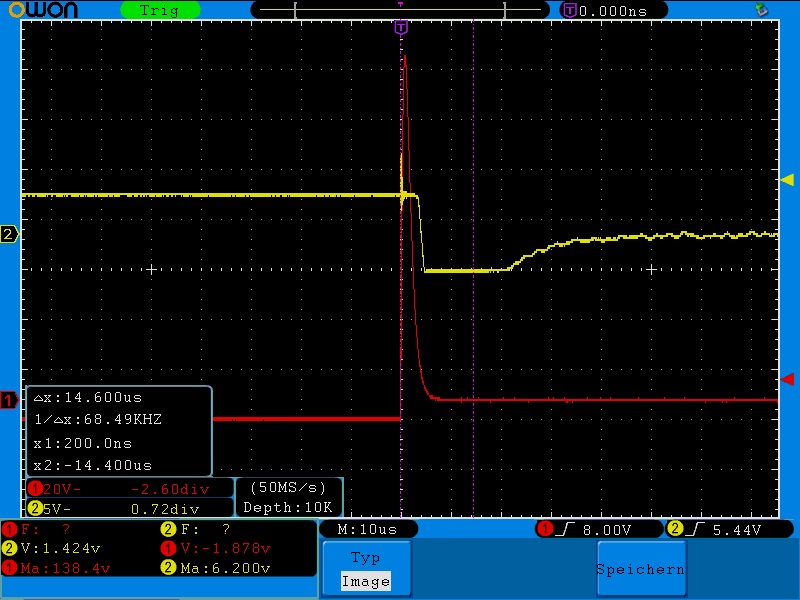

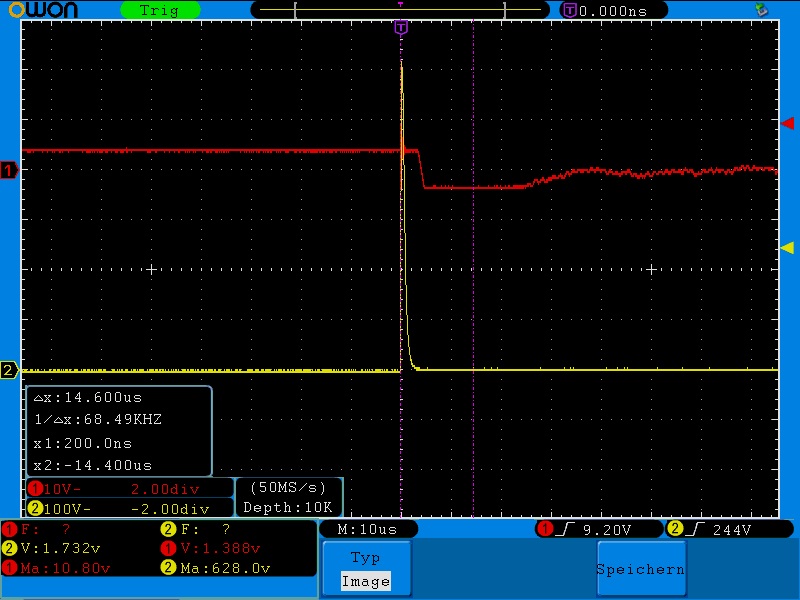

              Now i have measurte between TP5 and TP3 and i have now this Signal.
              The Damping resistor i have mountet now on the coil directly and have 424ohm.
              Bud this signal are not how im expectet. What i have worng?
              The coil are 380?H and have ~10ohm
                Sorry it was my fail.
                I dont know why. But the right value are 320ohm.
                It?s the signal now right or?

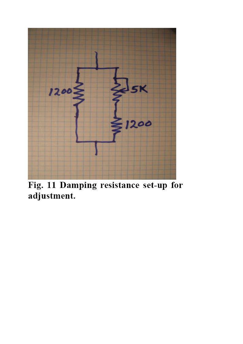

                  Try use something like this to achieve critical damping

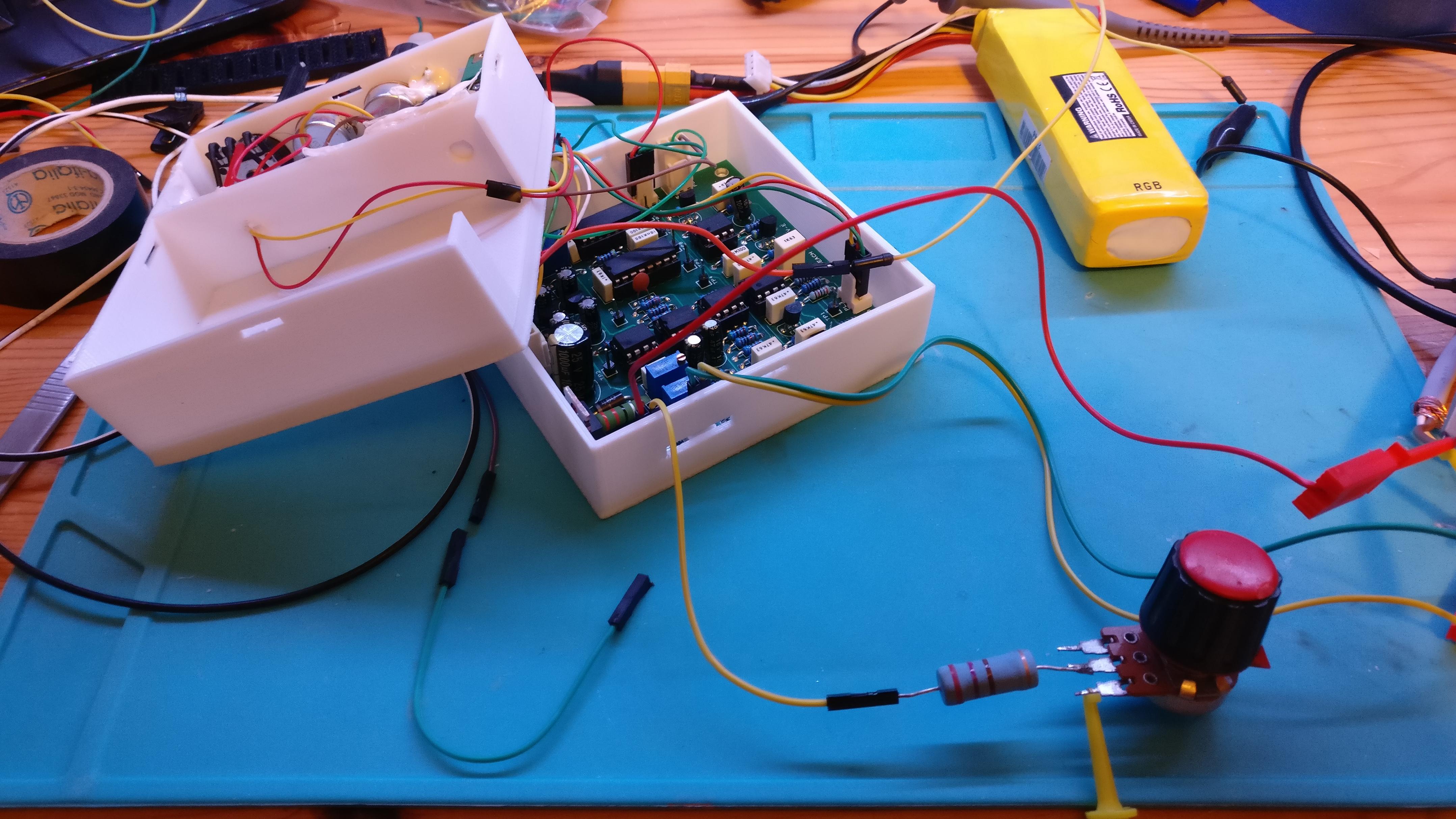

                    I have used a 220ohm and a pots in line du setting up the damping resistor. My question is if the signal what I have made with the oscilloscope looks ok?
                      O'scope trace look ok.

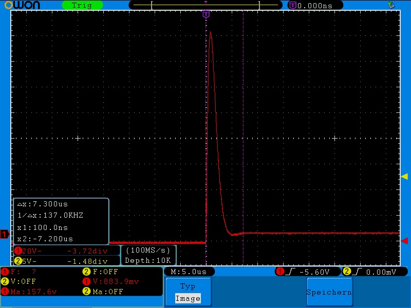

                            First i have controllet the schematic and i have see that the are the R10 with 3,3ohm to protect the IRF840.
                            I have in my Hobby room WS2812 LED strippe. They beginn to flickering when i switch the MPP on. The flyback voltage are about 650V.
                            The coil are working but the R10, D7 and IRF840 beginns to ged warm.
                            So what resistanze are recomandet for the coil? Can i use a resistor in line with the coil to incrase the resistanz and protect the componets from the MPP?
                              Yes, some series resistance with the coil will decrease the fly-back Voltage.
                              You must experiment to find an optional value.
