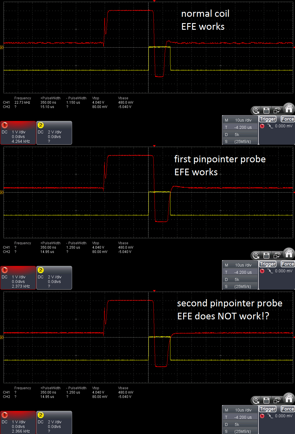

          Here are the oscilloscope pics of the decay curve of my MPP coil, pinpointer probe 1 and pinpointer probe 2.
          The pinpointer probe 2 is the one that is so sensitive to magnetic fields.
          Varying the damping resistance from 200 Ohms thru to 1200 Ohms didn't change anything respective to magnetic sensitivity of probe 2.
          I did notice that probe number one got slightly sensitive to the EF simulation magnet when strongly over-damped (200 Ohms-ish).
          Still wondering and will be poking around more tomorrow.

            What is the yellow trace on the scope?
            Only difference I see is that the coil and PP1 has a rise above zero after decay whereas PP2 does not. Seems maybe PP2 is damped more than coil or PP1.
            What is the timing on the EFE sampling?
            Interesting problem that I have no idea why.

              Maybe the problem is associated with the second sample (EFE) pulse rather than the main sample.
              Can you post scope shots of the whole cycle?

                      The yellow trace is the main sample delay.
                      Timings:
                      Pulse Width: 31us
                      Main Sample Delay: 15us
                      Sample width 1: 16.5us
                      Pause Width: 111us (this one starts at same position as sample width1 - not consecutive)
                      Sample width2: 16.5us
