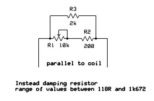

    You should build this circuit and attach it temporarily in place of R4 to determine the best damping resistor value for your coil

      Yes, best way to find correct damping resistor value.

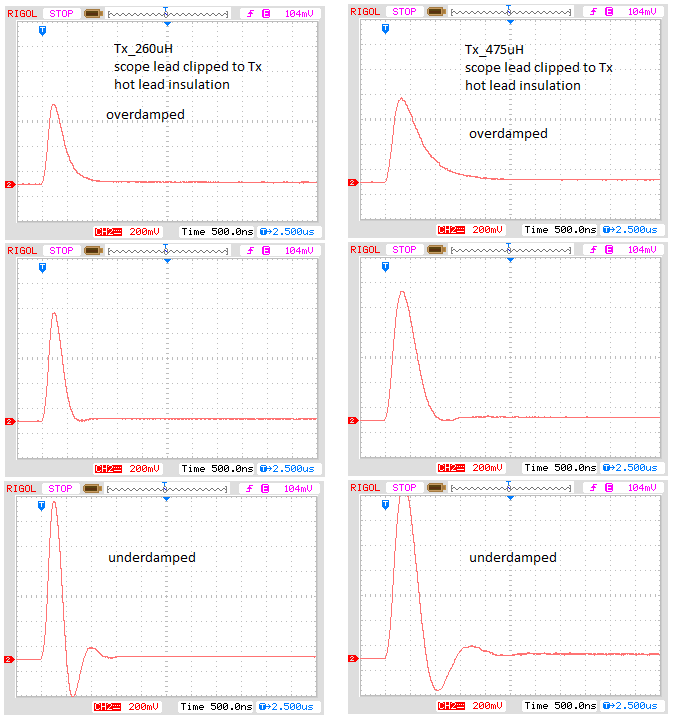

              Anyone have a picture of the optimum critically damped wave?
                Originally posted by SaltyDog View Post
                Ha ha ... very good ... I will buy it ...
                scope pictures, middle picture slightly underdamped

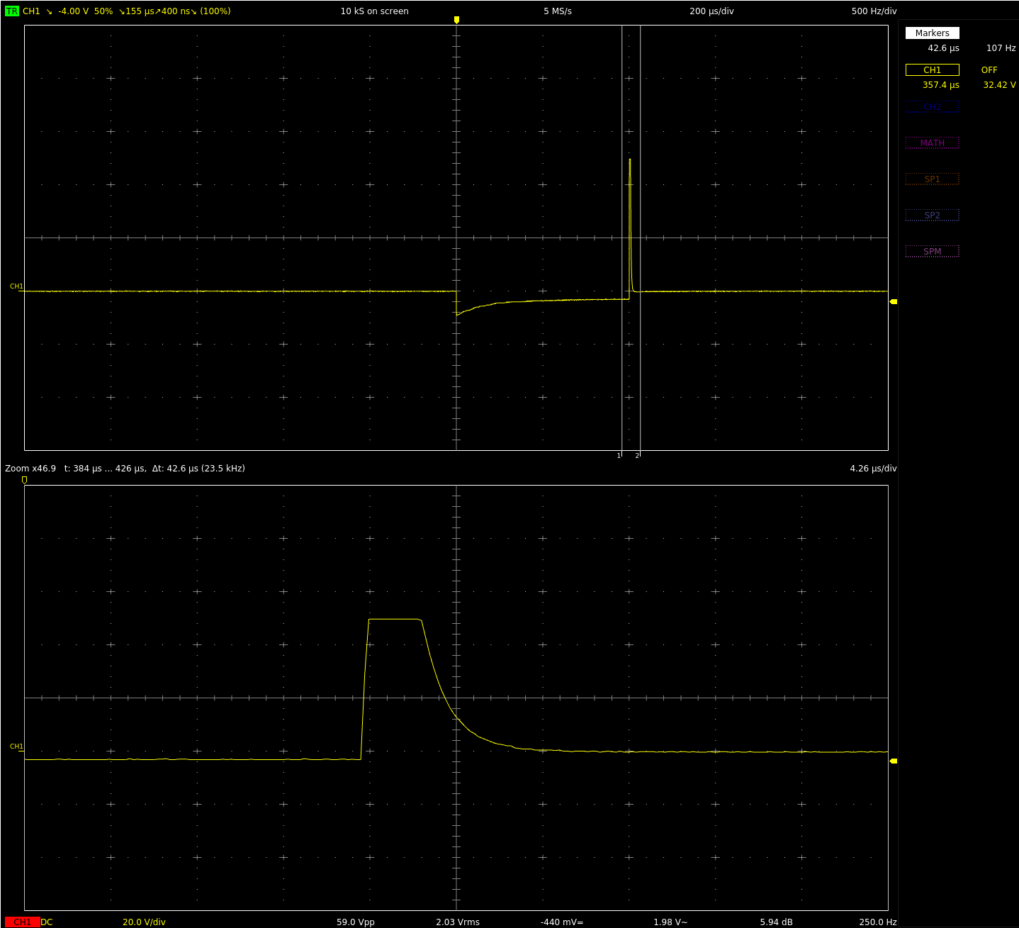

                  Here is what I have across R4 ..
                    It looks like the damping resistor can be increase a little to get closer to a slight underdamping. The flyback is being limited by the Mosfet avalanche, so to get a higher flyback you will need a higher voltage Mosfet.

                      Hi Carl,
                      I am doing exactly as instructed in the documentation, is states to set pulse width to 400us ... at 125hz rate ..I am also using the FET that came with the kit .. are you saying this info is incorrect?
                      (Doesn't seem right that the FET would avalanche at 60v .. EDIT: IRF840 is rated min 500V)
                      Cheer
                      EDIT: It seems my scope only has input = 5V, so with a 10:1 probe was clipping at 50v .. I have measured with a 100:1 probe and I am getting slight clipping at 500v(might be scope or avalanche), so all good on that front ..
                      I have also pushed back the FET on time to 200us .. my pulse delay is now approx 12us, I think that is the best I can do with this cheap coil ... I will build a better basket-weave one .

                        From the scope image, it looks like the amplitude of the flyback is 50V.
                        Perhaps your scope probe is set to the x10 setting?
                          OK, that explains the early clipping. 450uH is a bit on the high side for fast sampling, try 300uH. You may not need to basket-weave.
