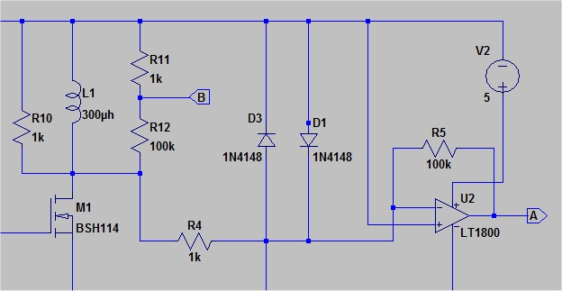

MPP revE need help
    Your coil is a mono coil, which means that the same coil is used for both transmit and receive. There is not one wire designated TX and the other RX, as shown in your diagram.
    The damping resistor goes between PL1 pin2 and PL1 pin1 (or pin3).
    For Tx and Rx i think I understood. In my scheme i have two wire for TX and RX because of my connecting cable between PCB and coil are made to be adaptable for all mono and dual coil. I solder RX and TX pin on the coil connector for my mono coil.
    My mistake is the connection of damping tool i have to connect the 0V with RX or TX cable (RX and TX are the same because of my mono coil)

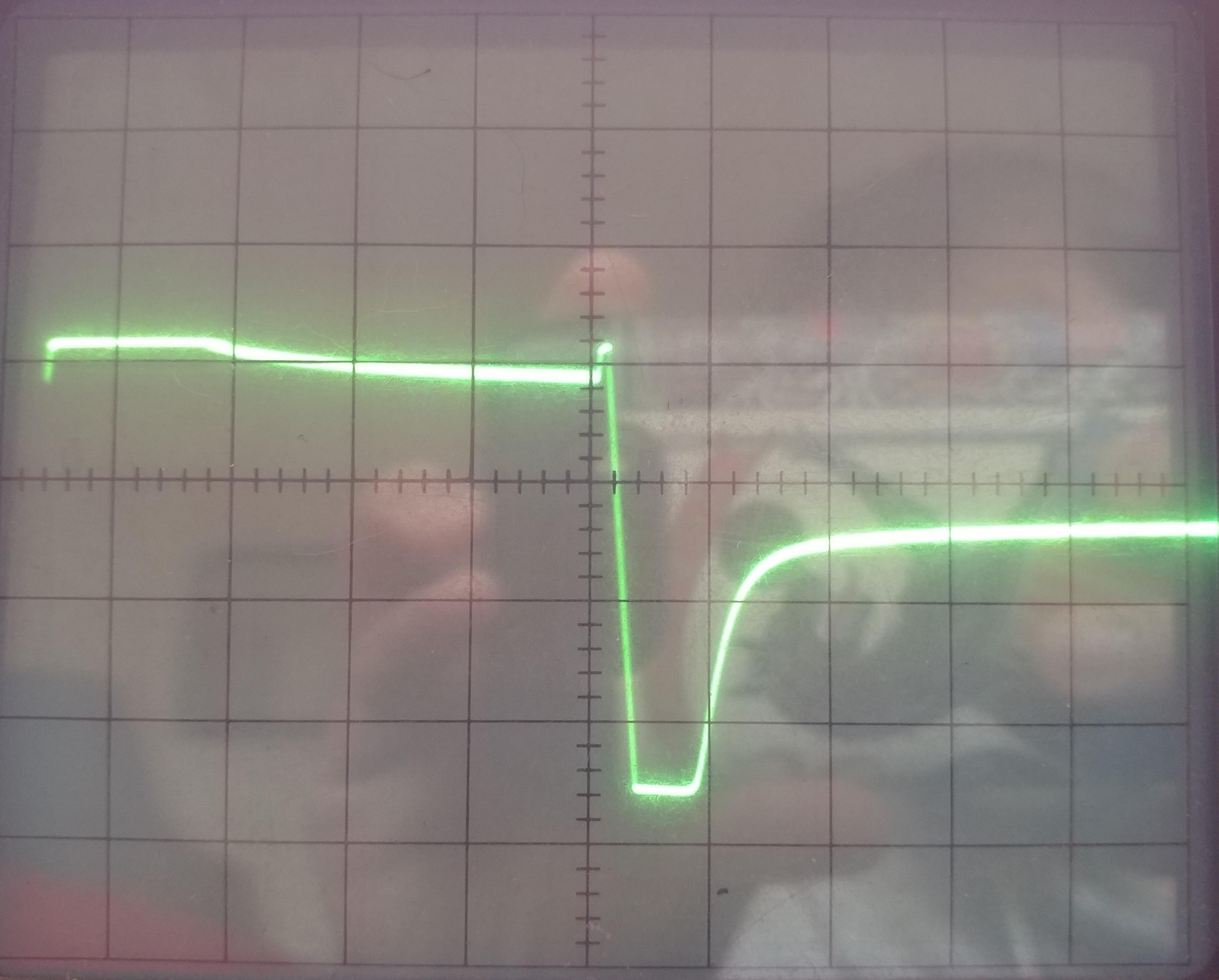

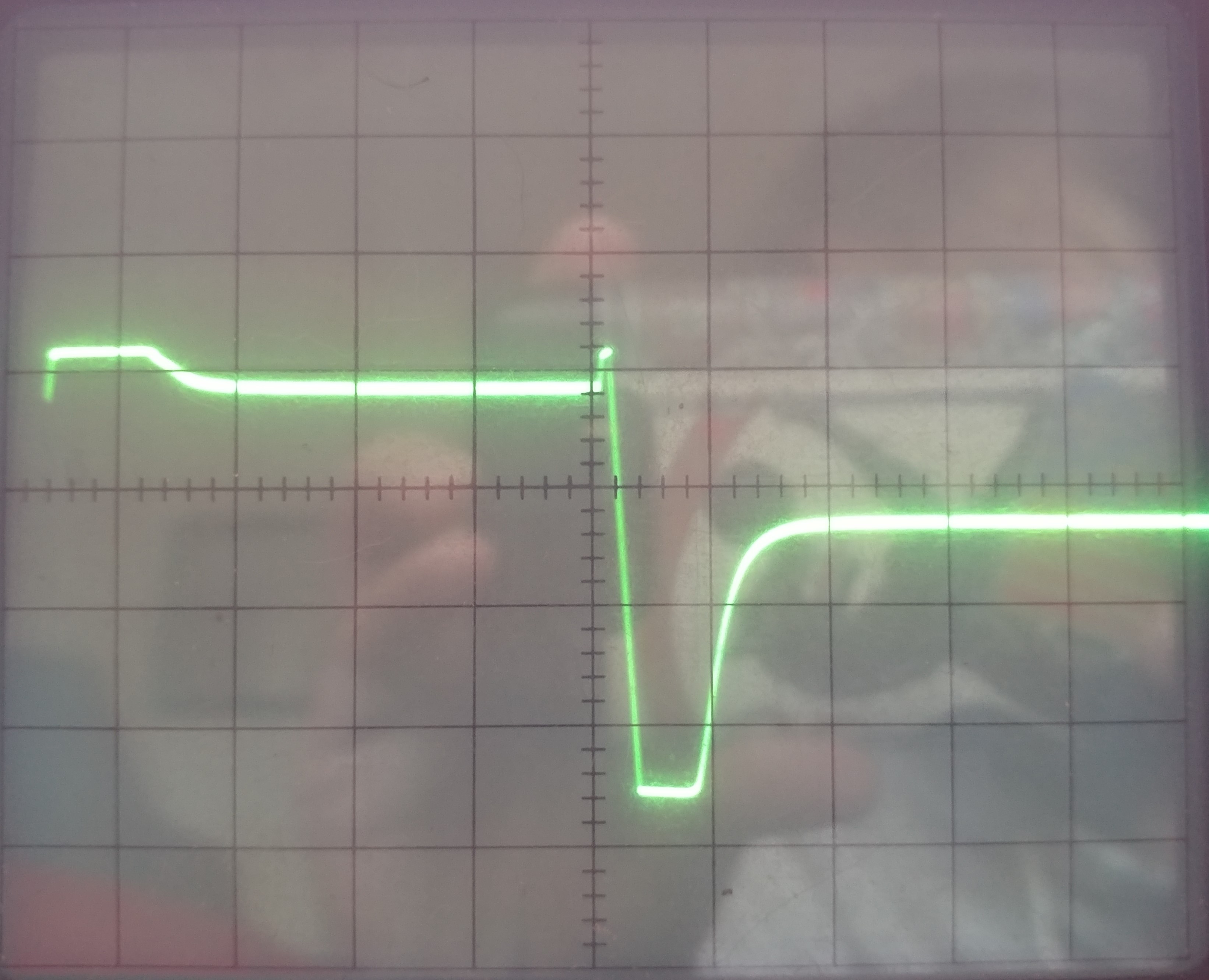

      Hello I did a new test today with my new coil and my 680ohm potentiometer used as damping resistor.I know it is not a good idea but I have nothing else to do it….
      I bought resistors online yesterday with a new o'scope and a 100x probe but I have more than a month to be delivered….
      So I will try like that and if it burns it doesn't matter.
      So I read my signal in TP3 with a can of soda and that's what I see at 0.2 V / div (10x probe) and 20us time / div.
      Can you please confirm that the signal corresponds to what is expected ?

Name:	TP3 without anything.jpg
Name:	TP3 with cola can.jpg

        Hello,
        You mention that you have a new coil. What are the specifications of the new coil? Thanks.
          The coil is a mono coil with 25 turn of 1mm coper enameled wire witha a radius of 125mm.
          That give me a 413uH with the coil calculator.

              So as you can see my signal is not really similar i don't know why ... I finished all the step and my detector work but not really good. I need to shield my coil and adjust my damping resistor.
              Please can someone explain me why my signal is different than surfdetector signal ?

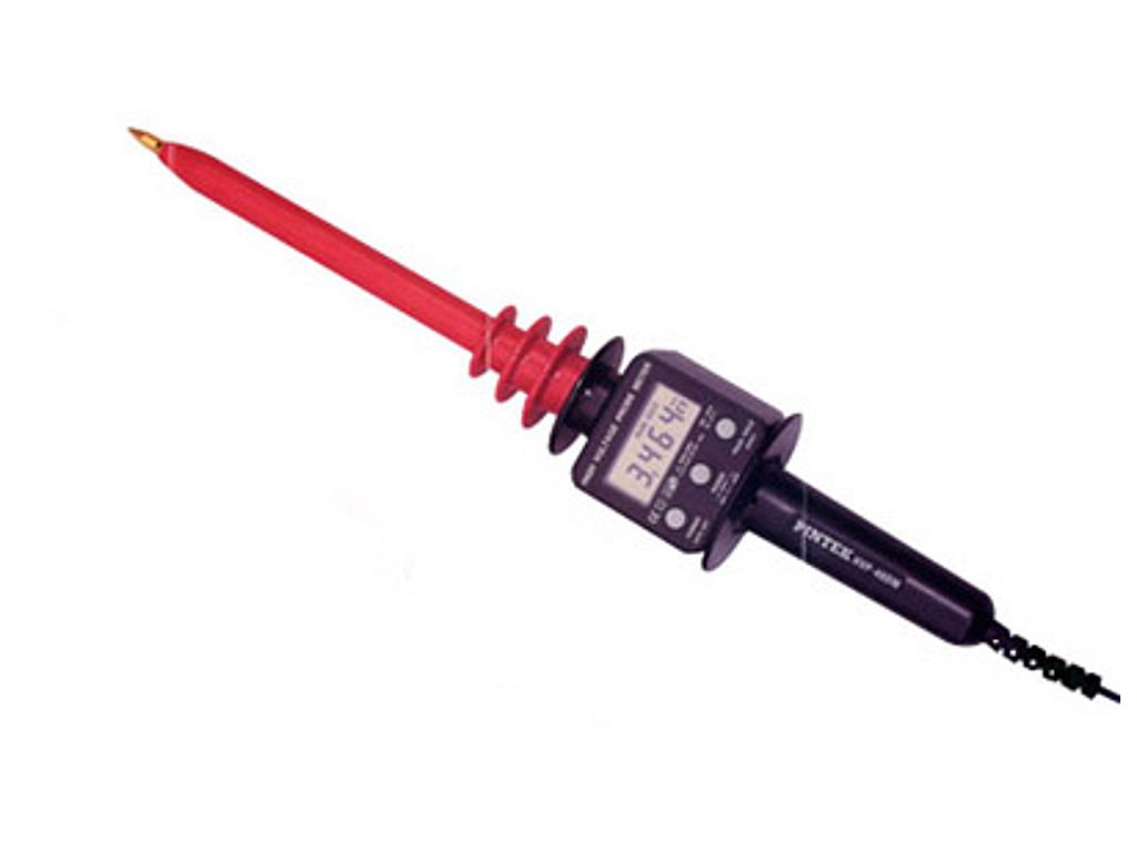

                      I often wondered if there was a quick and easy way to check the flyback voltage without having to use an oscilloscope with a high voltage probe.
                      Then I remembered TV repair tech guys using a gizmo to measure the high voltage on a TV bulb (CRT).
                      Maybe a similar thing could be used without much hassle.
                      A high voltage probe project would be nice for diy's.

                            Those high voltage probes are about worthless for measuring the flyback Voltage since they will only work for DC (or AC IF low freq (50-60Hz and Sinusoid).
                            A scope is required to measure the PEAK flyback Voltage since this only lasts for usec and repeats at higher frequency than an AC rms meter can measure. A simple resistor Voltage divider and O'scope works fine.
                                Yes, I saw that the flyback voltage on the old TV's were rectified, so it's DC. Those probes would indeed be useless.
                                And since the peak only lasts for a few microseconds, then an O'scope is necessary.
