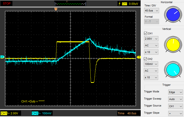

          So this step is good with the shunt between TX and R1 I think the tx pad was damaged when I changed the pin. What ever now my TP3 signal is good noisy but looks like normal !!
          [ATTACH]50139[/ATTACH]

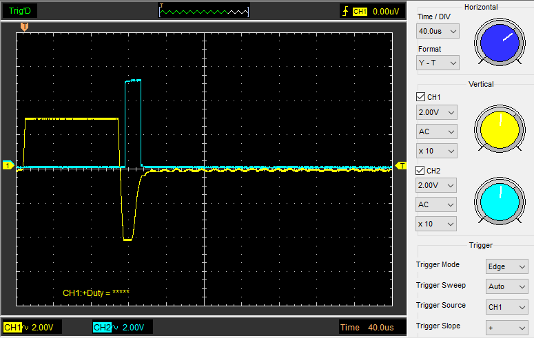

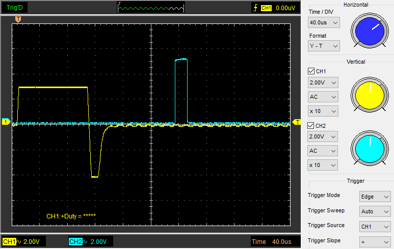

          Next I adjusted R37 to have a minimum sample delay of 10us as you can see on TP6.
          [ATTACH]50133[/ATTACH]
          On the next step something differ from what is expected.

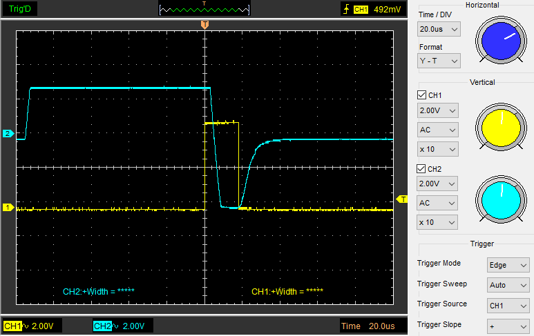

          -EFE delay pulse width is expected to be approximately 100us but it is 118us as you can see here.[ATTACH]50135[/ATTACH]. I'm no worry about it but it is close to 20% difeerence.
          -Pulse width at both TP9 (sample pulse width) and TP10 (EFE pulse width) is expected to be approximately 10us but I measure 17.6us that i think is more anoying because it's 76% more than expected....
          [ATTACH]50136[/ATTACH][ATTACH]50137[/ATTACH]

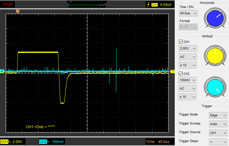

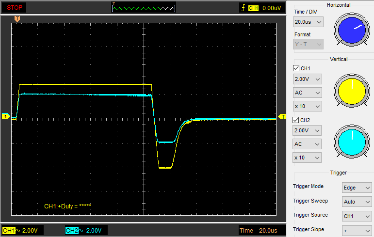

                Ok so I did some tests and I still did not find the problem. All my pin connections was great and replacing my TL072CP by a new TCE2072 did not change anything.
                So I checked my JFETs with scope but I do not know what is expected.
                I took some screen shot if you want take a look on it
                Thanks.
Name:	CH1_TP3 CH2_Q1-D.PNG
ID:	357277 Click image for larger version
Name:	CH1_TP3 CH2_Q1-G.PNG
ID:	357278 Click image for larger version
Name:	CH1_TP3 CH2_Q1-S 100mV.PNG
Name:	CH1_TP3 CH2_Q3-D.PNG
ID:	357280 Click image for larger version
Name:	CH1_TP3 CH2_Q3-G.PNG
ID:	357281 Click image for larger version
Name:	CH1_TP3 CH2_Q3-S 100mV.PNG
                I see a difference between Q1 and Q3 on S pin :
                On Q1 signal go down when a target is near the coil nothing happen on Q3 I think is because Q1 is for sampling and Q3 for EFE but i'm not sure.

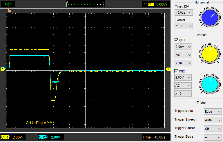

                                And the winner is sample delay !! I uped sample delay from 10 to 18us Click image for larger version
Name:	minimum sample pulse delay set up to 18us.PNG
ID:	357298 and now all it's right !!!!
                                The anoying point is that I think 18us saturation is high for a 0.33mH coil.
                                I added a 10ohm resistor to up the resistance to 11.6ohm with coaxial cable. Now my Time Constant is near 33us 3 times less than Tx pulse width.
                                Last thing is to find the good damping resistor but this step get me crazy. I did not see any flyback voltage anything .... I received my 100X probe yersteday I probed on Tx Rx and ground pin and nothing.... on the damping resistor connection nothing on the coil wire insulation nothing.
                                My probe is working properly I calibrated it with oscope signal.
                                I will try to measure SRF to find Damping resistor value by calculation.
                                Have you ever see that ?
                                PS: I will replace R35 from 4k7ohm to 2k4ohm to get a minimum sample delay of 10usec
