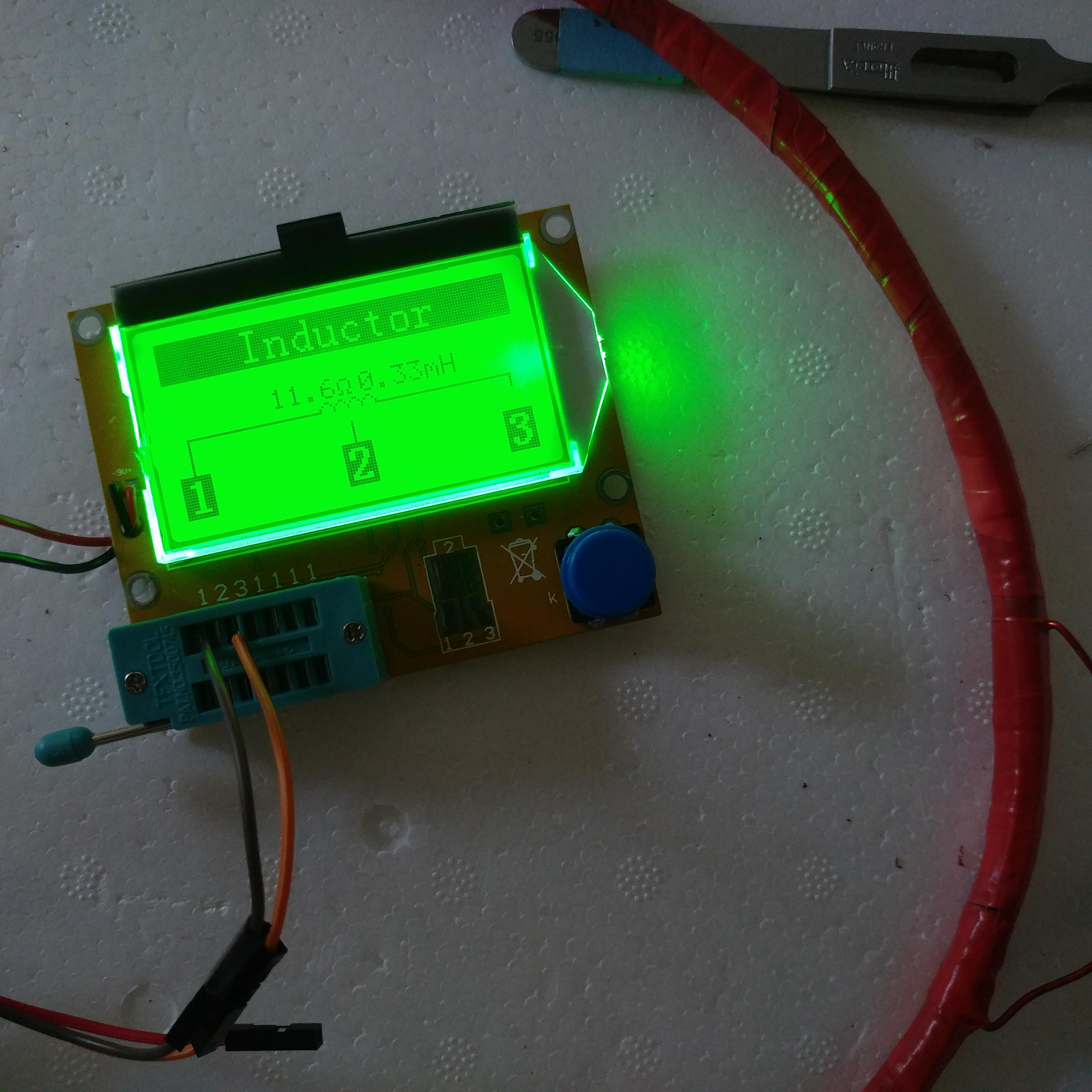

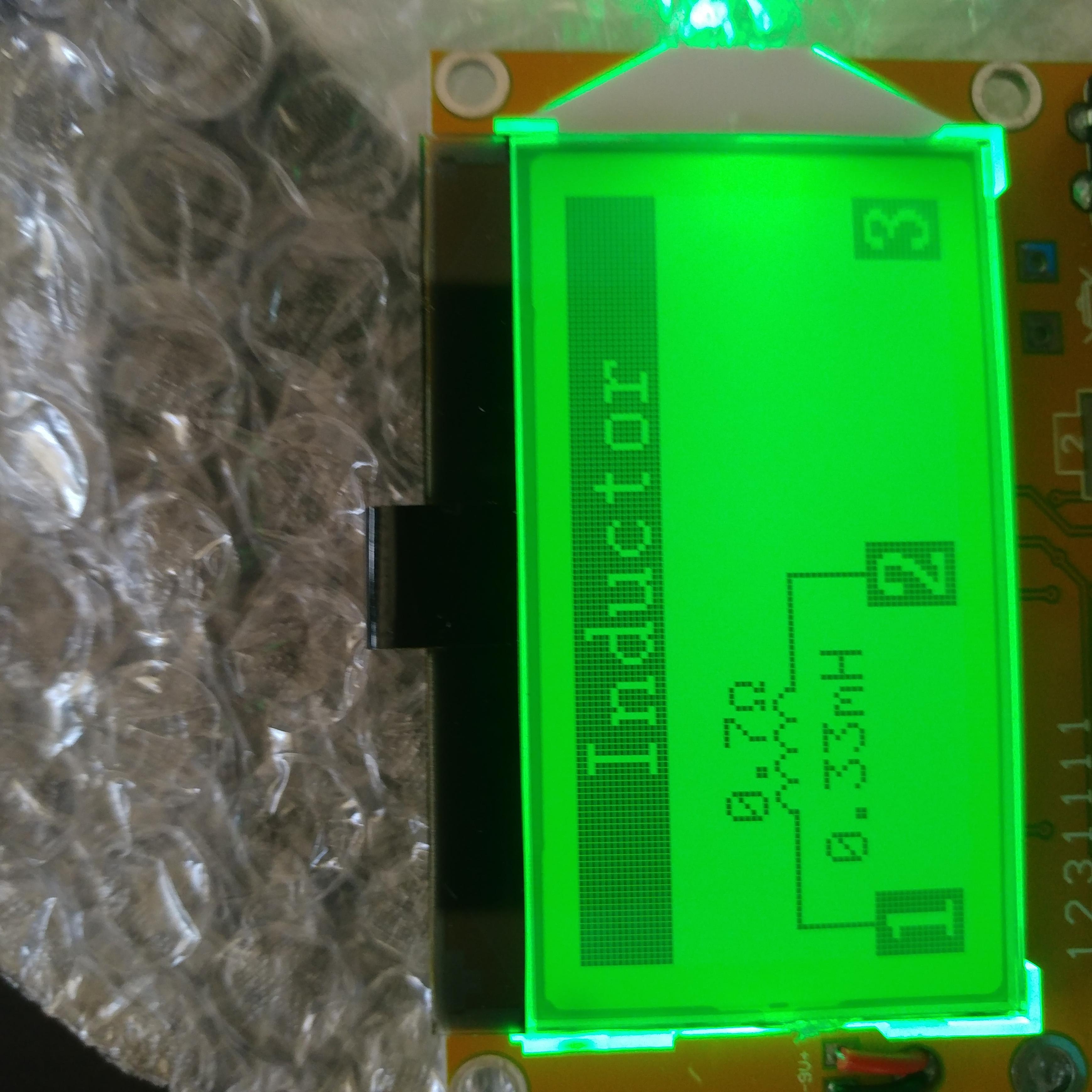

          Disconnect your coil and get an ohm reading on it. It is sounding like you have an open on the coil
          • #80
            I did it with my component tester i received this week and it's all right as you can see here with the coaxial cable. Click image for larger version
            And here for my second coil alone. Click image for larger version
            Here you can find link to videos when I tryed to probe flyback voltage. My probes are ground conected to TP5 on first and third video. TP3 is on CH1 as control for coil connection on the three videos and CH2 is connected to damping resistor (R4) on videos 1 and 2 and to coil plug solder pins on video 3.
            https://drive.google.com/file/d/1S-H...sp=sharing,%20
            https://drive.google.com/file/d/1a1P...sp=sharing,%20
            https://drive.google.com/file/d/1ek8...ew?usp=sharing
            I do not understand what I did wrong....
