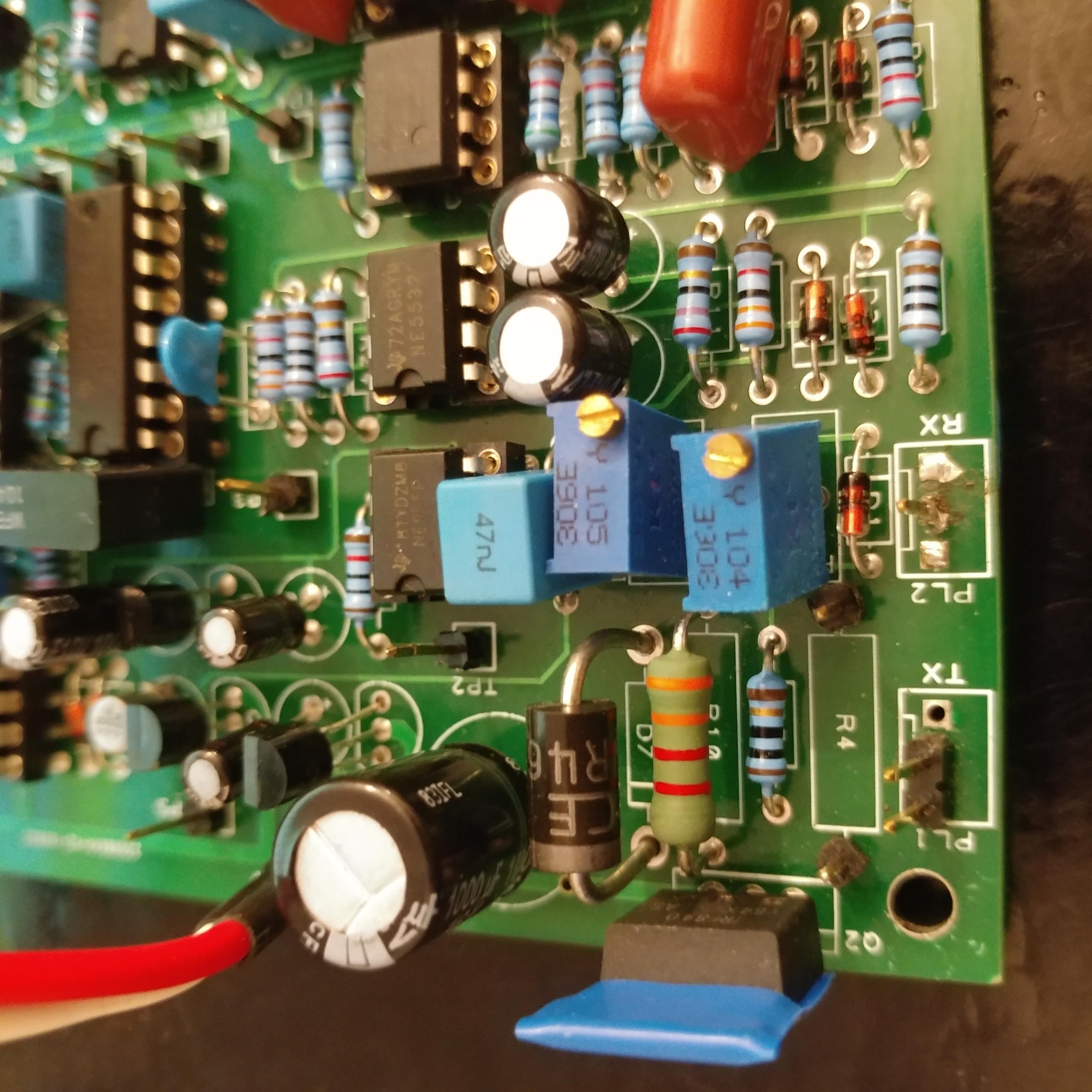

      The TX circuit is pretty straightforward. You've got the drive pulse to the gate of the MOSFET and then you've got your diode and coil and damping resistor.That's it. So not much to check by way of troubleshooting.So you can recheck everything, make sure the mur460 diode is good and correct orientation.Recheck the mosfet is good, etc.
      Check the board connections are good.
      I checked the board many times the components are in the right place I took a new picture Click image for larger version
ID:	357337. I checked conductivity of TX and RX pin to ground an i have no short. R10 is 3k3 ohm R7 is 10ohms. I noticed a 1M ohm resistance between the MUR460 in the otherside there are infinity resistance as expected.

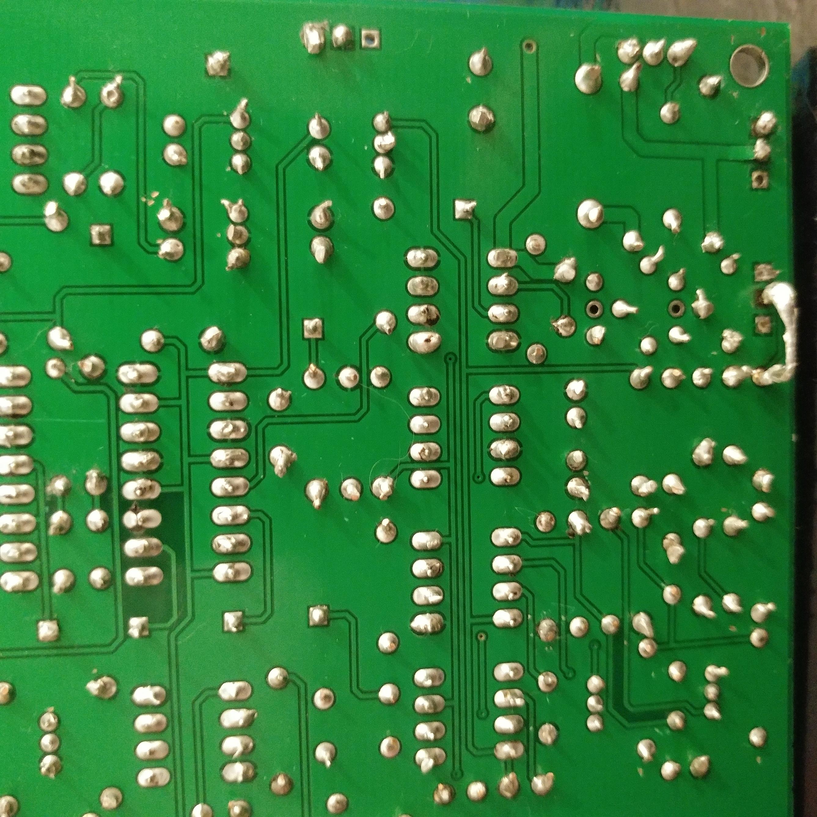

      Hi you can see the solder side Click image for larger version
ID:	357338. The copper layer is a bit unstick on TX pin but i checked connectivity with R10 and R4 and it's good. No connectivity between TX and ground too.

      • Did you actually read the part in the Build Documents were it says:
        "Please do not proceed to the next step until you have solved any problems encountered in the current step. If you get stuck at any stage during the build, then seek help in the Geotech forums before moving on. Do not simply populate the whole board; discover it doesn't work (which will be the most likely result) and then post in the forums: “I've built the Minipulse Plus, and it's not working. What's wrong?” …. as you will receive little sympathy from other Geotech members."
        I ask this because it looks to me like you've populated the whole board.
        Also, looking at the underside of the PCB, I can see several pads that appear to be shorted to the ground plane. It might be a good idea to tidy up the soldering.
          I read the document and I follow all the instructions. I just past the damping step because I was waiting for resistors and pot to do the damping resistor tool.
          All the steps are working and the only problem I have is that I could measure the flyback voltage anywhere.
          I know my soldering is not very good but I checked with multimeter the pads until the pre-amp stage and I get no shorts to the ground.

          • Albdelafar, in my components parts list R10 should be 3.3 Ohms NOT 3300 Ohms like you have! No wonder you are not getting much flyback.
                Solder side, I agree with Qiaozhi - what solder are you using?
                Well spotted!
                You can actually see the resistor is a 3k3 (instead of 3R3) from the photo of the board.
                • Well done Polymer
                  • Damn I really need glasses I readed K instead of R....
                    Thanks Polymer for this !! I think all be better with the good resistor value. I will try to replace it by 4 parrallel resistors 0.5w 3X 12R and 1X 20R to see if I can have a flyback voltage now.

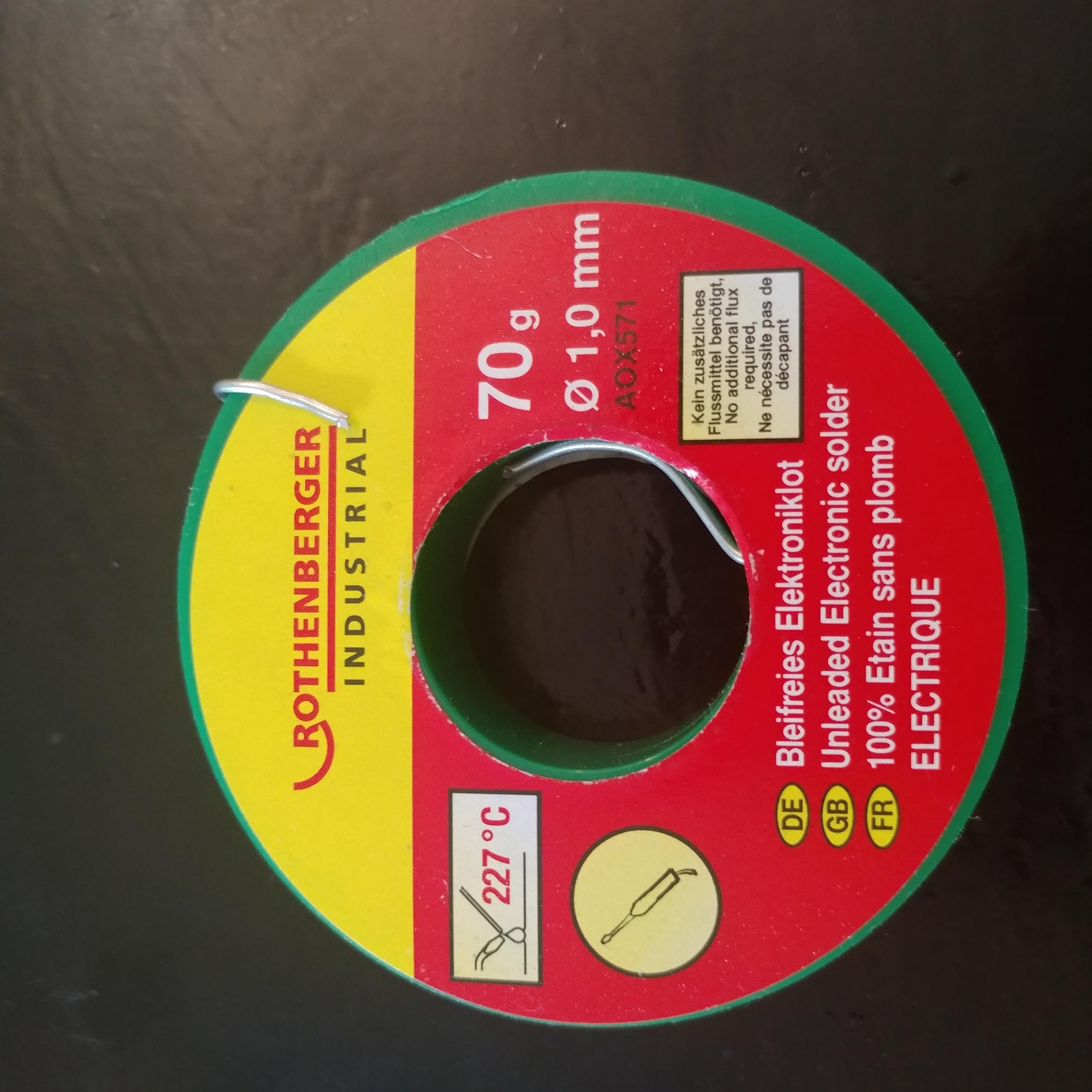

                          You are welcome! I mean what solder wire do you use. Leaded/Unleaded, brand name or chinese boat?
                            Oh Lord, I waited so long to see that flyback pulse, please let me see it before I die from flybat virus.
                            Amen.
                            No more than me I have just finished the work, your relief is near !!
                            Polymer I use this one Click image for larger version
                            Is a bit thick but they had not thinner wire at store.

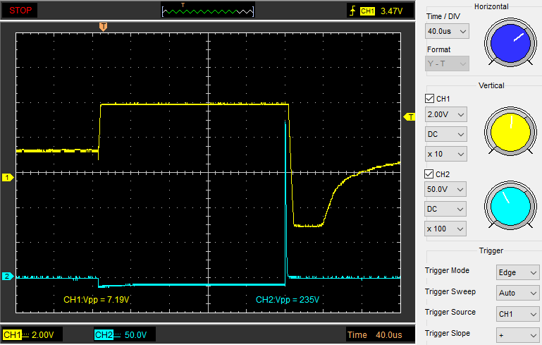

                            • And TADA Click image for larger version
                              Big thank you to all of you for your help and your time !! My bad for this stupid mistake.
