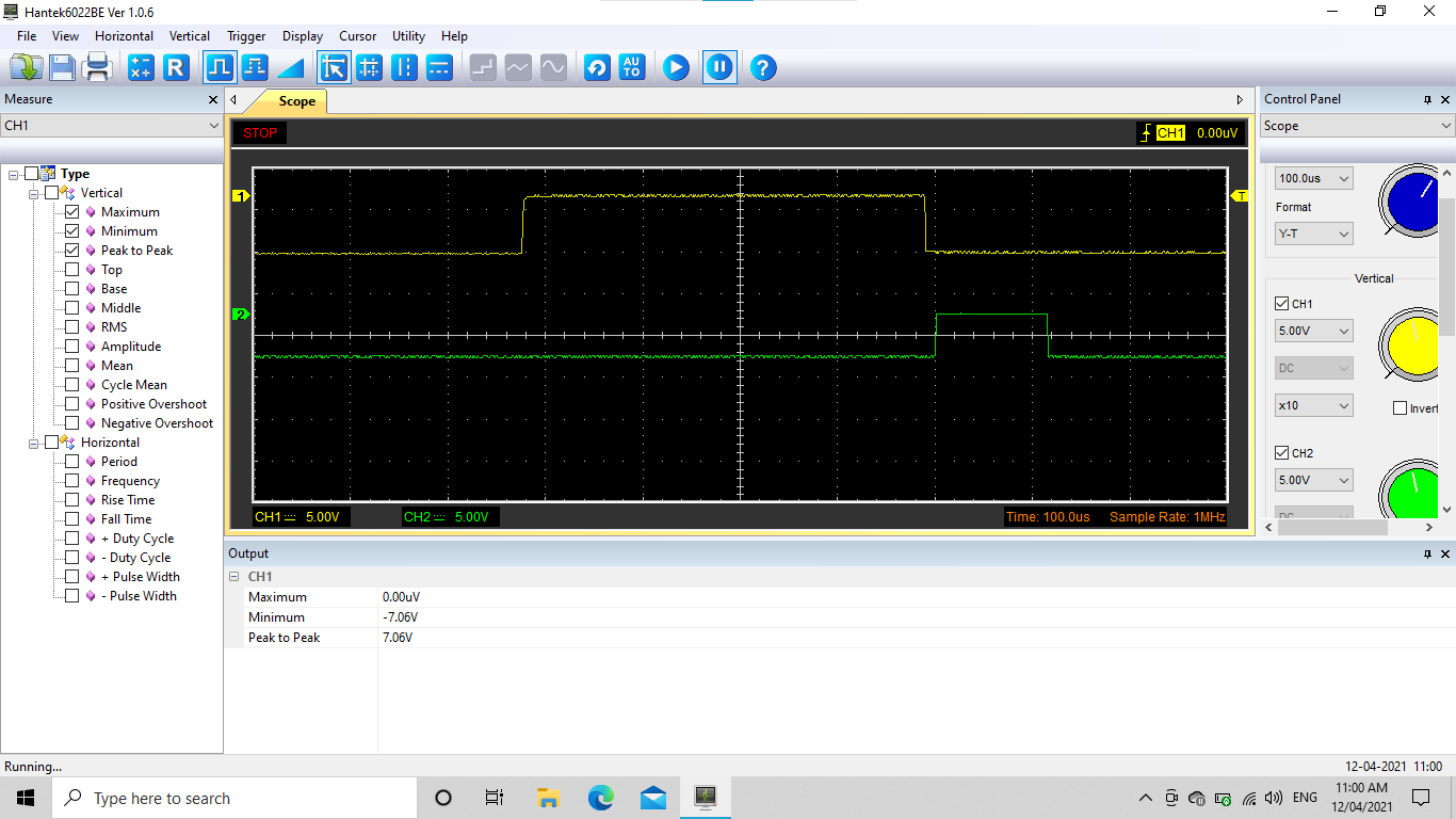

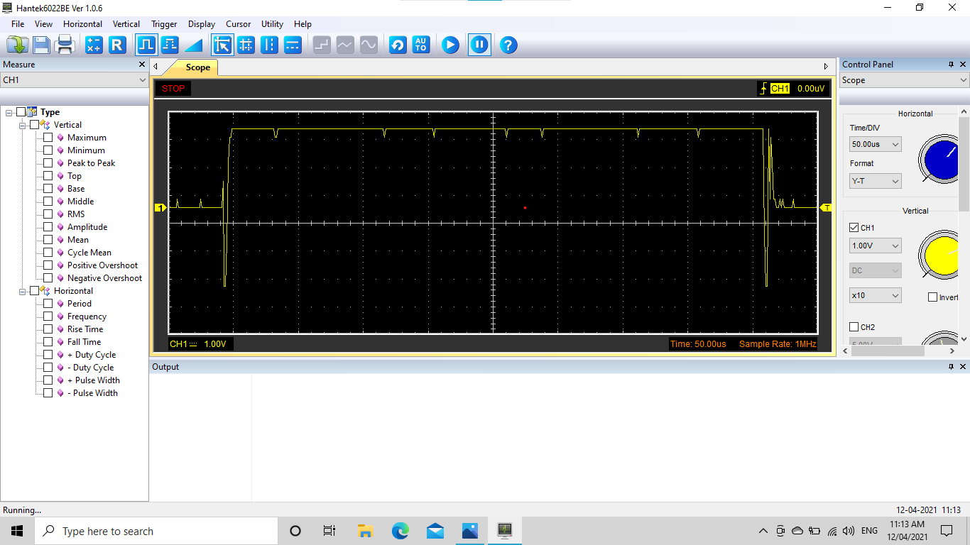

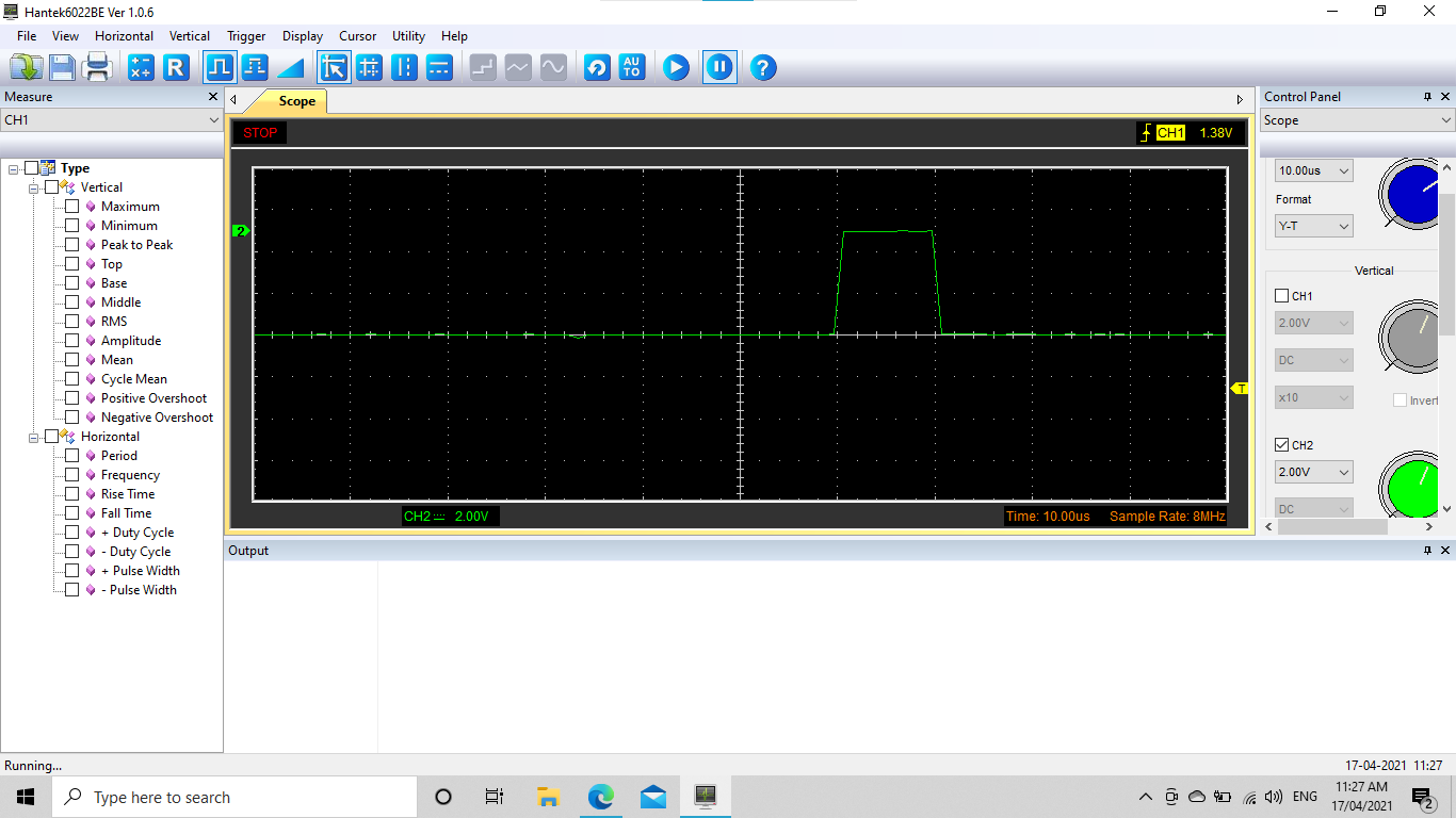

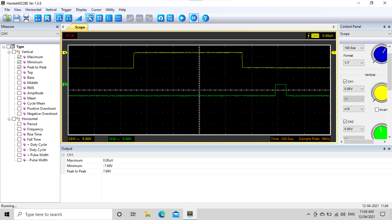

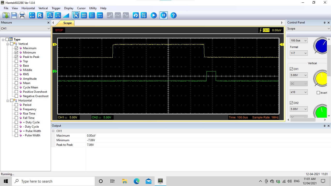

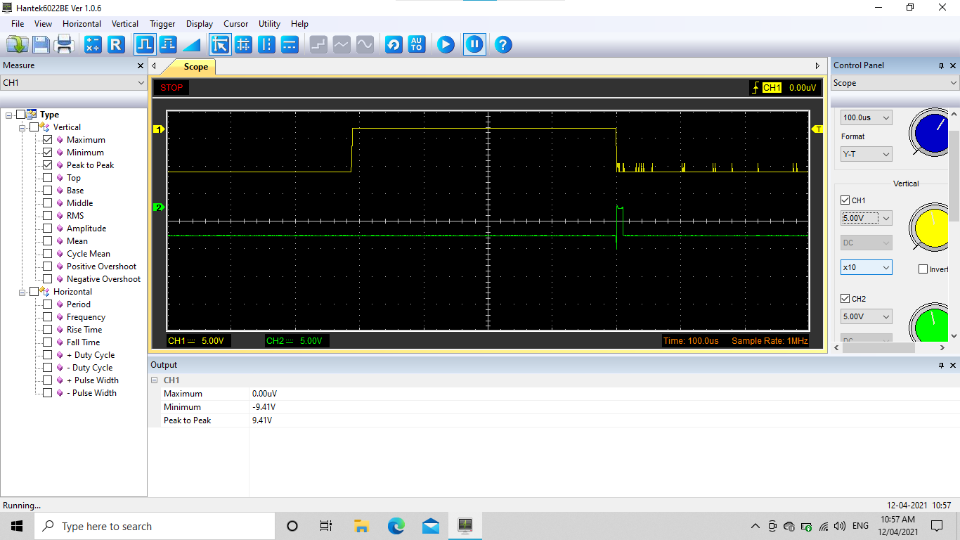

      Got some screen shots captured of my laptop via usb oscilloscope hope this helps Graham

      Seems like its not amplified or pre amped enough if i new what part was faulty i would try replace it Graham
        It may be an operational amplifier that is not of good quality.

                Take a picture of TP3 versus TP6 and post it.
                That is the pre-amp output and the main sample pulse.
                What are your coil specifications and what are you using for a damping resistor?

                    It would be helpful to see a single screen shot of TP3 and TP6 rather than having to toggle between your previously posted separate shots.
                    That said, it looks like you have quite a bit of ringing going on, your damping resistor is not correct.
                      TP3 Screen Shot Click image for larger version

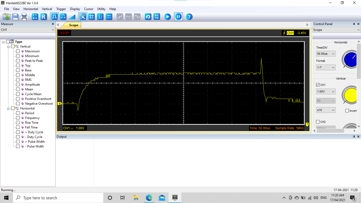

                      TP6 Screen Shot Click image for larger version

                          What did your flyback look like on Step #4?
                          The pre-amp signal does not look correct TP3
                            You were right the pre-amp wasn't correct after carefully looking in this area found an incorrect capacitor in C8 replace for correct 1uF, then i found missing small capacitor C13 220pF purchased and fitted then re adjusted settings now working approx 8 to 10 inches on different coins thank you for all your help now i just have to work out a coil cover and control box for pcb and pots. Graham
