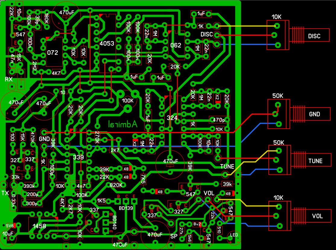

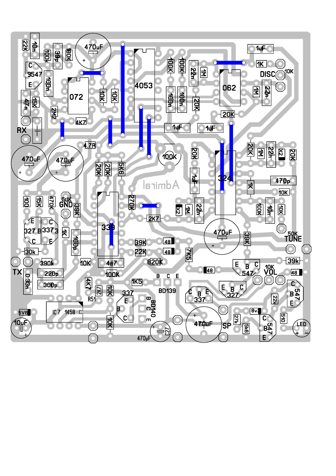

          • I'm using this PCB, if there is an error please help
            • PCB is correct my first Admiral is made with this PCB

                  • tx rx firenkas tx rx firenkas are the same my coils are different tx 50 volt vpp rx tl072 1 pin 250milivolt vpp pcb index according to the schematic
