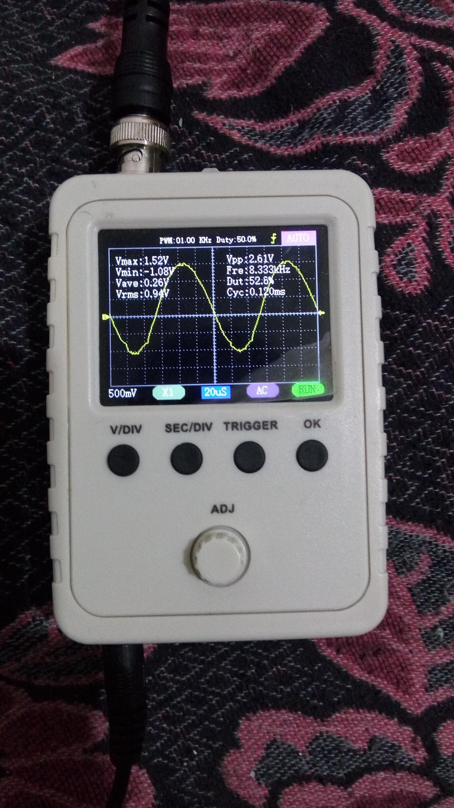

      I do the same like you but I can't measure less than this one in rx preamp .
      I try 27k instead 15k resistance it drops to 1.6vpp but not good sin wave. what can you say?
      I see one of your video that you get about 0.300vpp I try but nothing.
      • What searching coil are you using? I guess it's not nulling properly. place a coin on top of searching coil and shifted until you have what nulling you want. Other problem can be coils shield as well. Return 15k resistor the problem is nor from him

            Can you tell me where did you attach the minus of the both coils
            • On minus on PCB but more important is how you connect the shield of the coils. I guest that is the problem. Better got to my Youtube channel I have a lot videos about Admiral
              • Originally posted by bonchev2 View Post
                I don't know how but I get the lowest mesurment less than 0.200vpp .
                I soldr wires in their places I don't use the line form pin 1 of 1458 it's not working with me and I connect the shild of rx with (-) tx that's it
                Iam confused!
                Yes I bend the both DD little bit the straight side.
