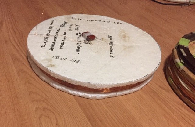

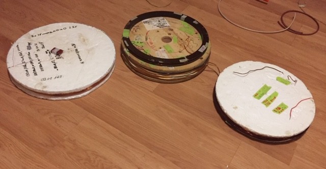

      @ivconic
      Before inserting the wire into the pipe, make a mold from Styrofoam, practice with different wires and the number of turns, and then insert the wire into the pipe, applying some grease ( Wire Pulling Lubricant )
      ​ and using fishing method ( you not only push the wire but also pull it ) you can fill up the pipe to about 80%.
      Click image for larger version  Name:	thumbnail_IMG_1702.jpg Views:	0 Size:	59.2 KB ID:	417382Click image for larger version  Name:	thumbnail_IMG_1701.jpg Views:	0 Size:	50.3 KB ID:	417383Click image for larger version  Name:	Unknown.jpg Views:	0 Size:	12.3 KB ID:	417384
