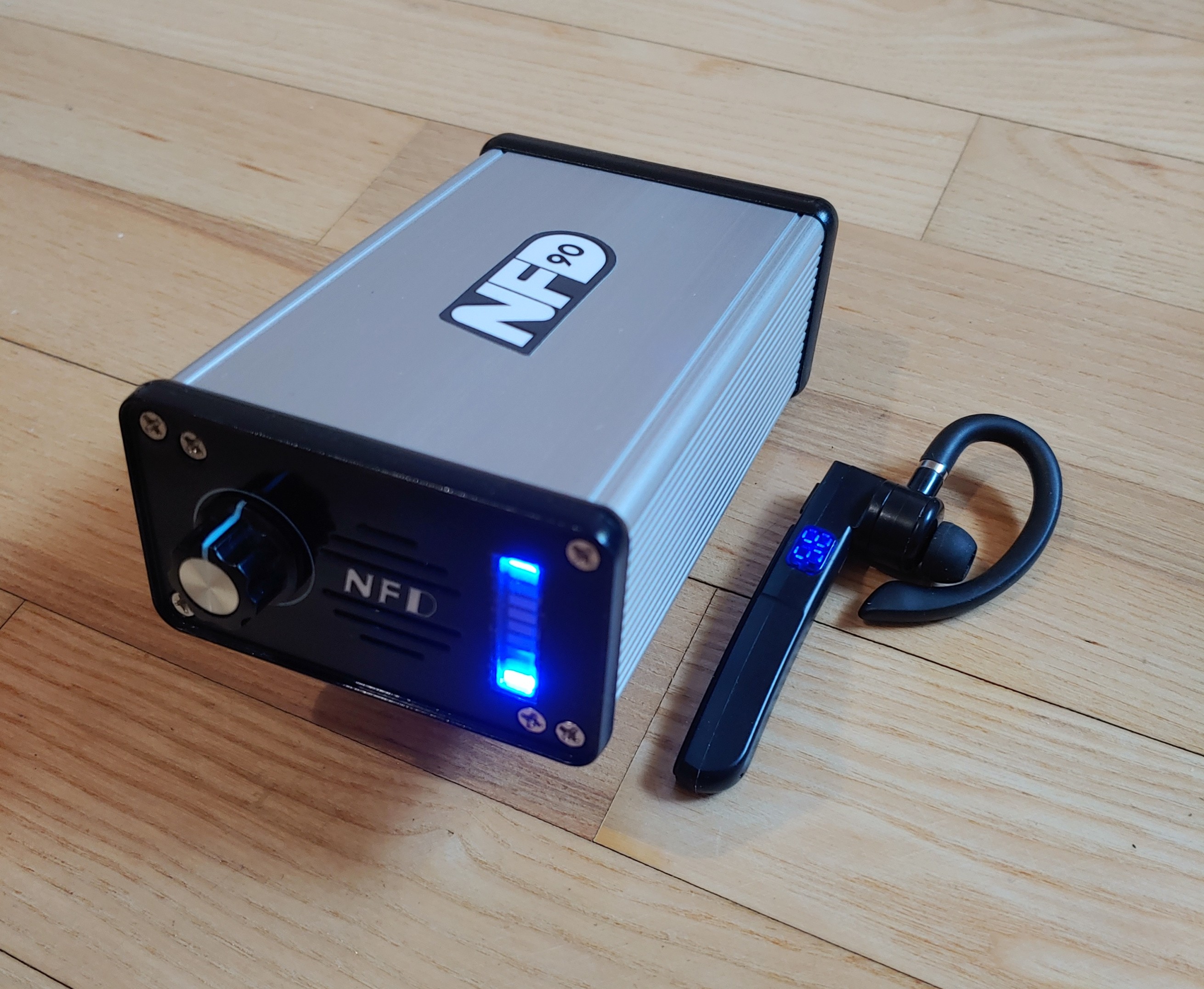

              More you dig in trash more understand that dual tone just distracs. NFD 90 works different so you need to rethink old experience. About VDI or pitch... that don't work on trashy areas (iron changes signal alot) so you will miss low conductors and even bigger targets. It can be done but in other model with other tasks. If there many small iron in the ground Disc becomes blindness in most MDs... You can find something but mosly high conducted or big coins. Separation in that places is not what we think in our heads there is 3D dependence...

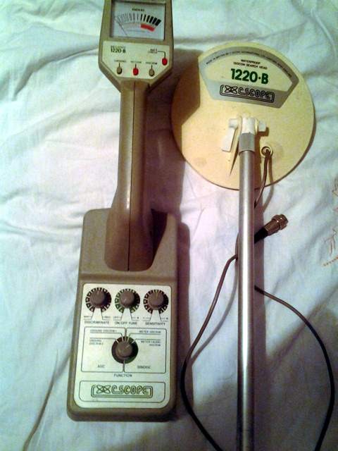

                      I keep mentioning the Cscope 1220B because I've worked with it for a long time, had a lot of success (and failure), and it's in my blood.
                      So I thought I'd revisit that schematic and do the same with it as I did with the IGSL.
                      Because that detector has everything solved as far as conductivity-based audio pitch is concerned.
                      I don't need to reinvent the wheel, I just need to use good solutions from that design.
                      The problem is that I don't have a completely readable schematic. I have a blurry version with a lot of unrecognizable details. Big chance for error.

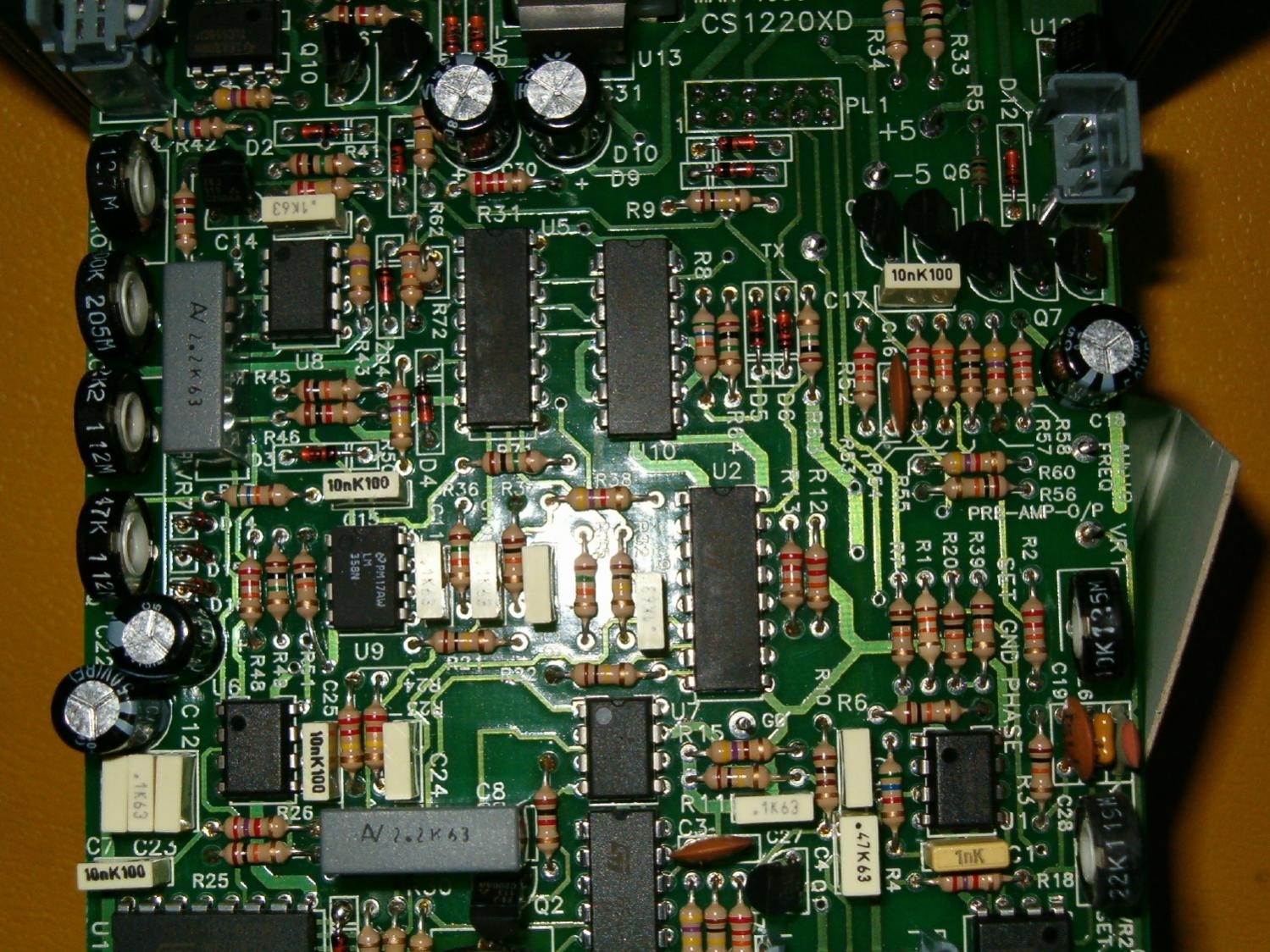

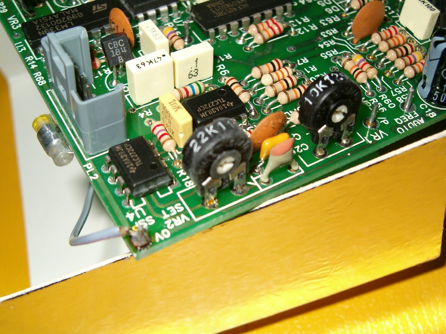

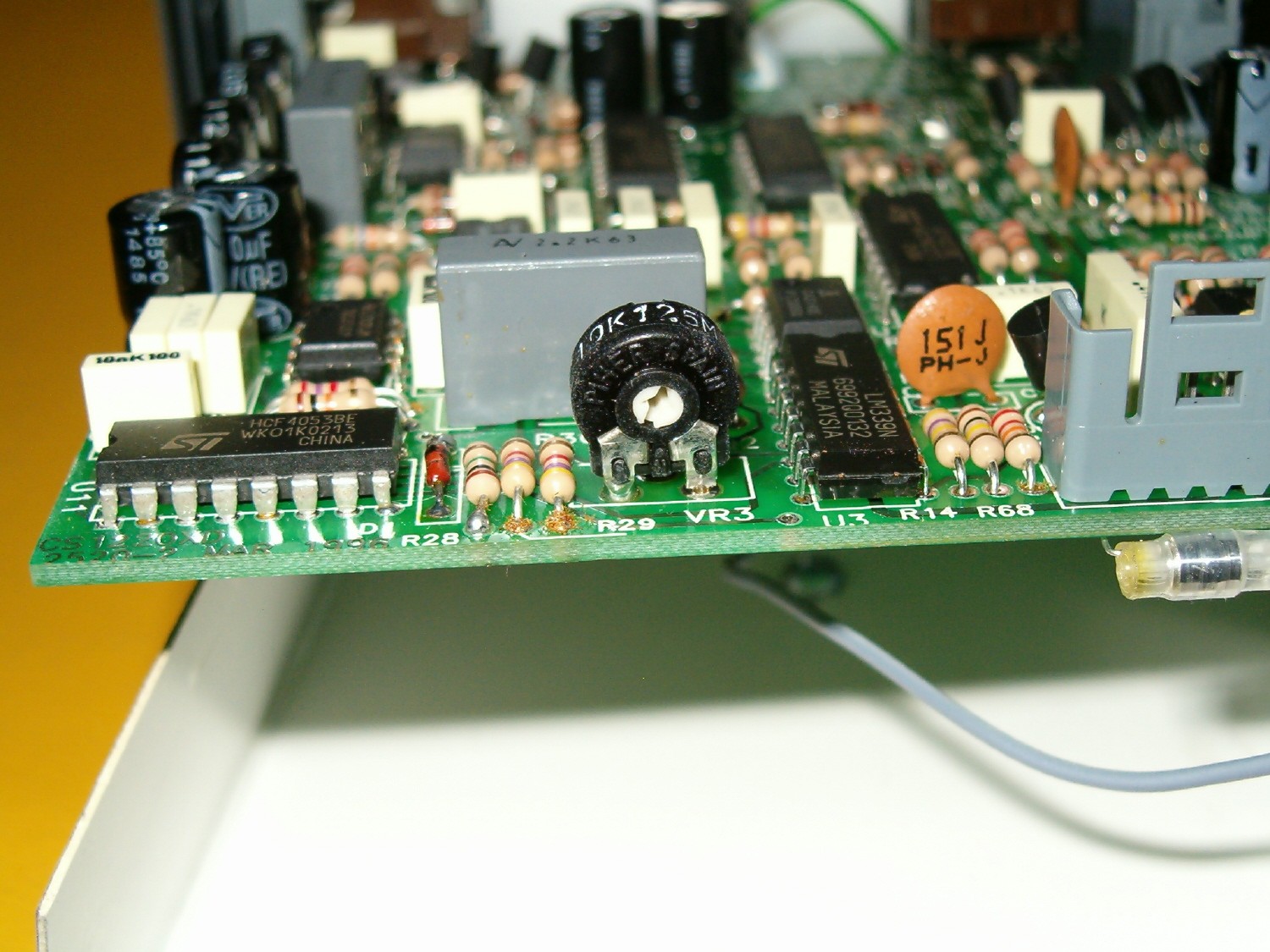

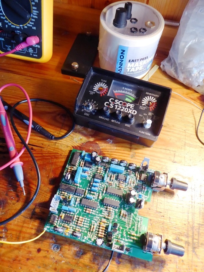

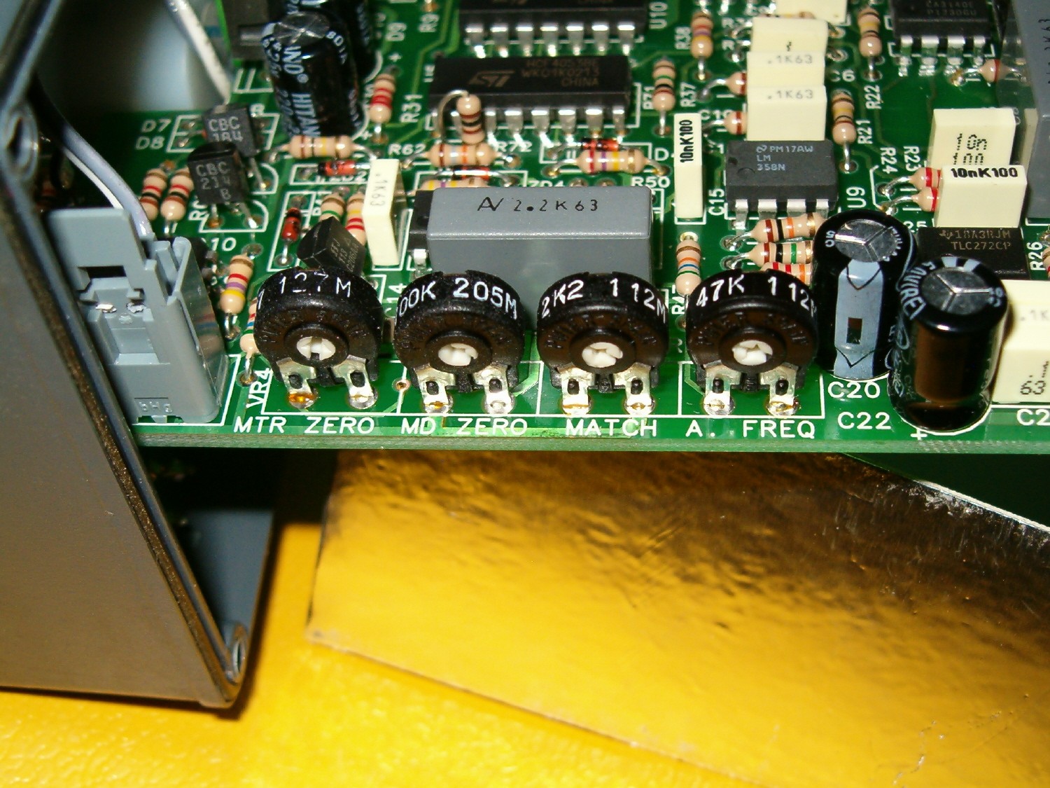

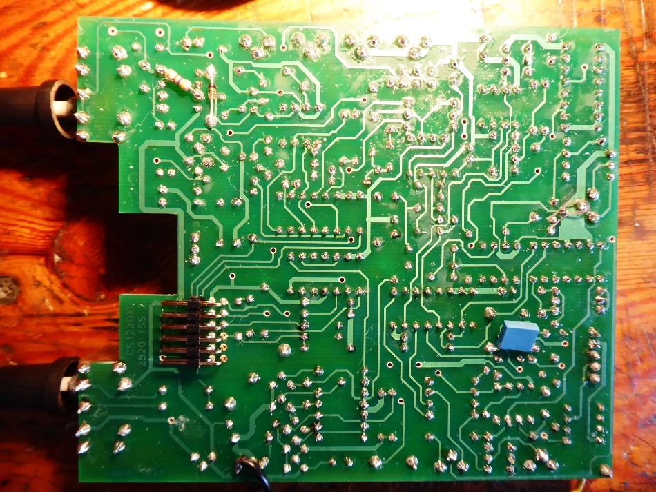

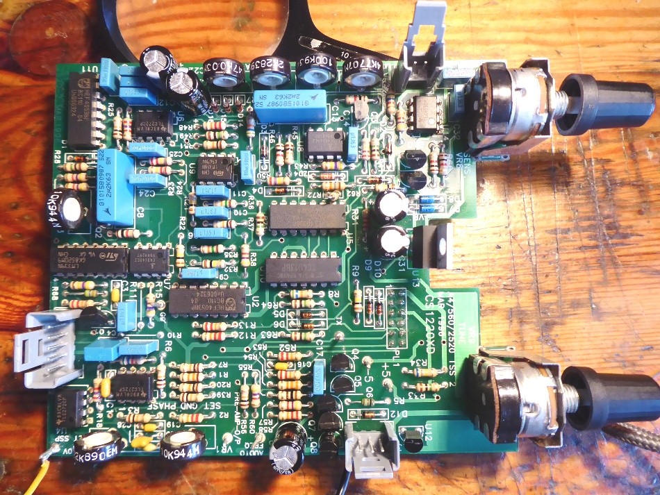

                          Cscope 1220XD is one of the models whose schematic I would like to have.
                          Or at least detailed photos of the pcb, good enough; so that accurate documentation could be reproduced with the help of those.
                          When I watch video demonstrations on Youtube; it seems to me that this detector is exactly what I would like to have, when it comes to a non-motion detector.
                          It has everything such a detector should have.
                          I don't know the current situation Cscope is in.
                          How is that company doing?
                          Does it survive.
                          Here I mean the hobby division first.
                          Because the industrial division should be doing well, they have top utility detectors and cover a good part of the industrial equipment and tools market.
                          1220XD is already an "old" detector today.
                          I don't think we would have done any damage to that company if we had done the reverse engineering and created the complete documentation.
                          If someone hasn't already done so.
                          If anyone has anything to contribute on that topic; here you go.
                            for you​
ID:	417782 Click image for larger version
ID:	417785 Click image for larger version
ID:	417787 Click image for larger version
ID:	417786 Click image for larger version
ID:	417783 Click image for larger version
ID:	417781 Click image for larger version
ID:	417784​ Click image for larger version
                              1220B Repair manual
                                I have all these for quite some time.
                                Thanks anyway!
