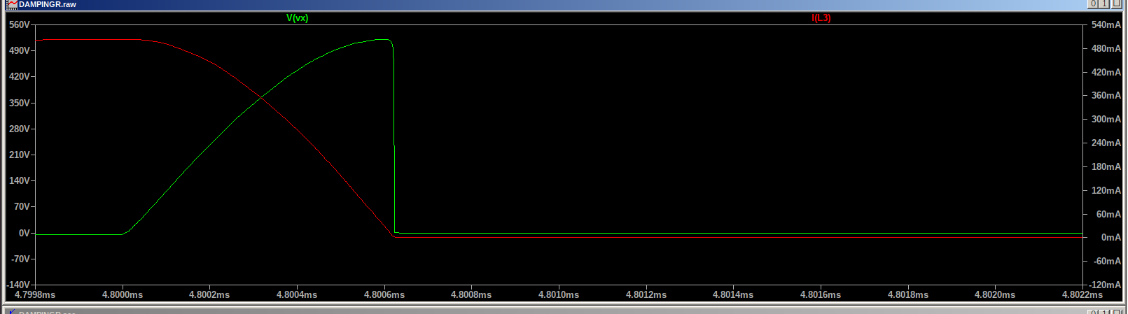

                            There is a fundamental priniciple at the heart of ( most ) PI technology and that is the damping of the coil.
                            I have seen almost endless discussion on how to improve it ... but what is it really ?
                            "That's easy" some will be saying .. you just calculate your critical damping resistance and off you go. .... well yessss ...
                            but what if I told you there is further improvement to be made ??
                            This is not a another PI circuit ... its the fundamental mathematics.
                            THE CHALLENGE .... What is the missing damping formula below ??? Its a a straight up formula that holds for all cases that the "classical" damping resistor holds for.
                            Its a much better damping method.
                            The trace for the standard damping is in top pane and the new formulat damping is in the lower trace pane.
                            Its not a trick question ... standard LTSPICE modelling.​

                            Are these supposed to be on the same horizontal axis , thats not possible with this pulse setting ?
                            Why are the flyback voltages different for the same coil ?
                              Yes they are on the same axis.
                              Coil voltage is proportional to di/dt ... for the same coil and starting current .. if the you damp the coil faster the current drops faster so the di/dt is greater thus the voltage is higher.
