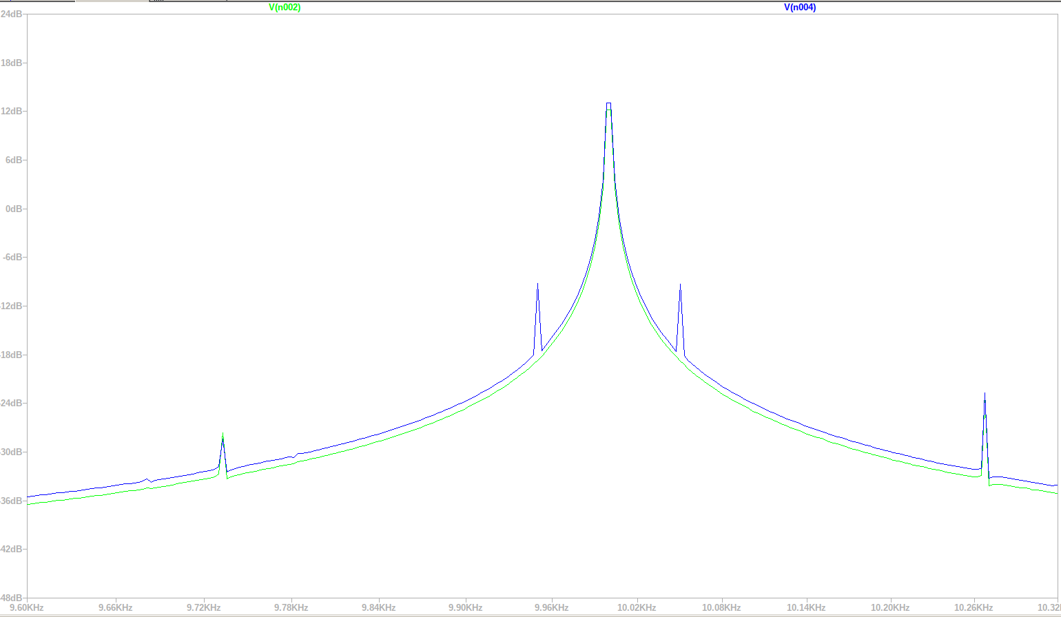

    ..and not only that ... but you dont get a set of free steak knives BUT the intermod distortion caused by the mains signal on the TX signal is also resolved. ( this PI is operating at 10 KHZ ).
    Green is the new preamp.
    With apologies to Detectorist#1 who does not like sims - thought I dont know any engineers who dont use sims nowadays.

      As an RF guy, you removed the sidebands, but we all know of a couple of manufactures that would benefit greatly from attenuating 50/60 Hz getting into the domain of the golden goose.

          Here you go ... this was made for a 14 KHz PI.
          Click image for larger version  Name:	image.png Views:	0 Size:	28.3 KB ID:	421794

            So where would you put the filter breakpoints, f/2 and 2f perhaps?
            • #51
              The breakpoints should be at f and as high as the bandwith of your opamp will go but less than the SRF ( self resonant frequency ) of your coil
              In my previous post above I said 14 Khz for the bode plot ... but it should have been 1.4 Khz.
              You want to pass the primary f and odd harmonics ideally up to f9 ( f f3 f5 f7 f9 ).
              If you go much below f ( fundamental ) then you are liffing the skirt of the LF rolloff and degrading the LF rejection.
              Heres a qeustion ... why is the phase response flat in the LF rolloff shown above in post #49 ?
