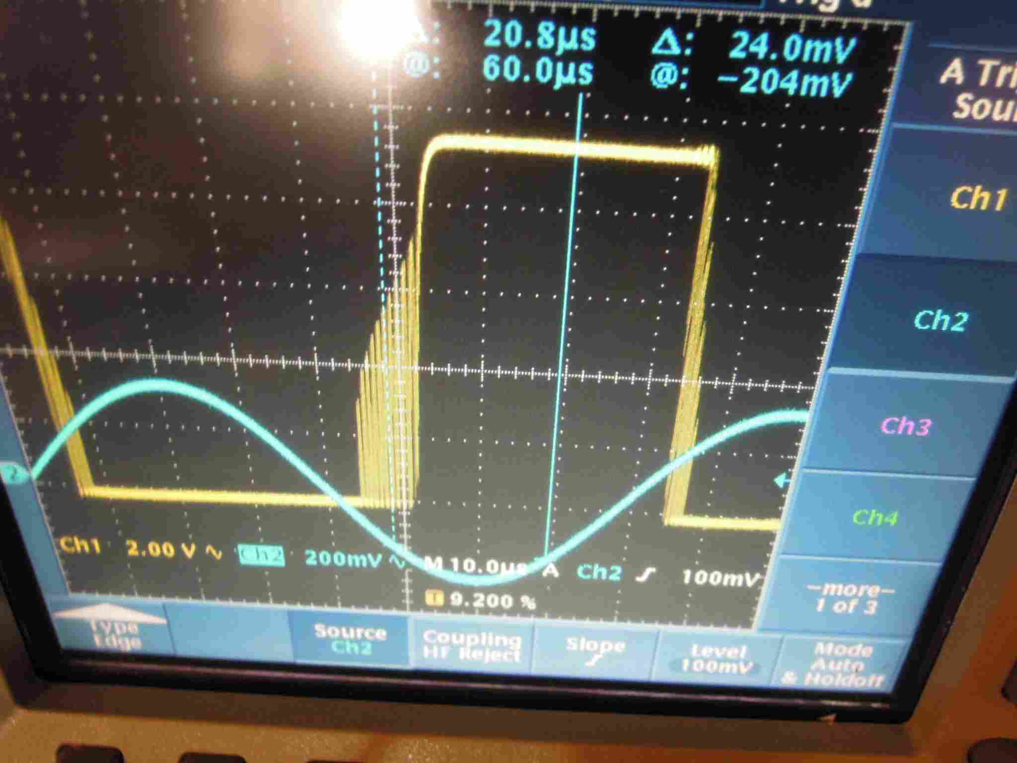

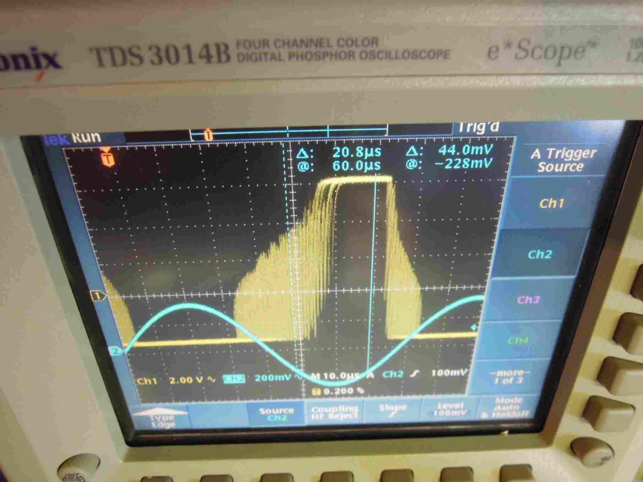

                    • Still some trouble with oscillations. I changes the 220 ohms to 1K and took some pics;
                      Not too bad but a little messy. So I added the 5pf and 1M's and it got worst;
                      I have a .1 and .01 right on the power pins of the chip and 20uf and 1uf and .1's on the power supply.
                      The chip is in a socket. It's a machined pin gold plated socket but maybe it's corodded inside the holes?
                      • I see the comparator output is about 10V. What kind of stabilisation is there? The comparators are supposed to be supplied from 8V stabilised and a signal ground - not minus 5 volts. Negative supply is not required for them as switchers are 4053 that have Vss and Vee pins and support a shifted level switching. I have no idea what would happen if the comparator supplies 4053 with levels below 0. Only Vee of 4053 is supposed to go to minus 5V.
                        This oscillation business makes very little sense, but heck, it is going somewhere. Did you change 100n to 22n as well? Both 220ohm and 100n must be replaced to keep the same phase constellation.
                        A positive feedback was supposed to wipe oscillations, and not promote them, so please check if maybe the feedback was connected to the non-inverting input by mistake. Such connection would surely make it oscillate.
                        In case there is some external pickup of these oscillations, it is OK to place a 47pF capacitor between the inverting and a non-inverting input of a comparator. It would shift phase for additional 3° or so - no big deal.
                        I guess there is a problem with lead lengths in the phasing network. It is spring and it means I may reach my lab hut and try something. If you observe the top of the comparator output (logical 1), you'll notice a small "hairy" patch in a middle which is a consequence of the other channel going through transition(s) and that happens regardless of decoupling and becomes very bad if there is no decoupling. You can move the hairy patch left and right by shifting the potentiometer of the other channel. There is no way of making it disappear completely regardless of decoupling, but it is not a problem.
                        • Well I'm using +-9V temporarily. The comparitor is wired to +9 and gnd. I did notice the inputs
                          to the comparitor were centered on ground (IE going above and below ground). I thought they
                          were at +4.5V before - I'll have to double check that.
                          I'm still using a LM393 and attached the 5pf and 1Meg to pins 1 and 2 and to pins 6 and 7.
                          I didn't change the 100n's yet, I'll try that tonight...
                          I didn't attempt to make the leads short but they are not super long either. Yes it's a strange
                          problem.
                          • OK, one problem is solved then. Feedback must go between 1 and 3 and also 5 and 7. You are after a positive feedback which in this case turns into hysteresis and makes oscillations go away.
                            If there will be any wander (jitter) in comparators output left after this feedback thing is applied, I'll see to increase amplitude even further, but I doubt it will be necessary.
                            • One more thing ... the comparators inputs are seeing impedances in a range of ~20kohm and input signal is not too high. In case there is any conductivity in between the pins at all, say in vicinity of 1Mohm, and because the inverting inputs are next to the outputs, you'd have a negative feedback path and oscillations as a consequence.
                              Gary (Chemelec) often warns about this conduction problem, and his solution is using a water soluble flux cored solder (!) and he washes his boards in water. I tend to prefer resin flux (smells better too ) and rub the critical parts with alcohol. It is very bad to use a water soluble flux and leave it there because it is conductive.
                              Either way, I believe the hysteresis will fix this.
                              • Well some success today. The bare boards I use come coated in flux to solder easily.
                                I tried to remove the flux with alcohol and scraping with an exacto but wasn't sure how
                                clean it was so I brought it to work where we have flux-off and some ultrasonic cleaners.
                                I cleaned the board and retested;
                                Maybe a little better? Then I added the hysterisis R+C;
                                One looks good the other is ok in the middle of the pot but
                                oscillates at each end. I haven't changed the 100n caps yet
                                I'll try that next...
