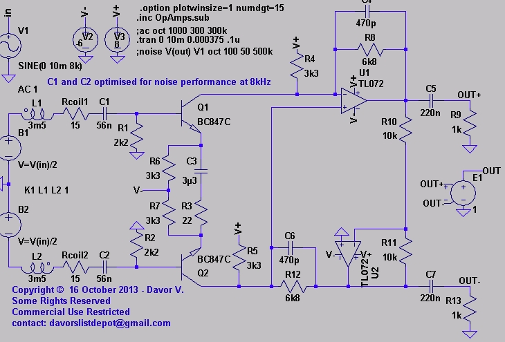

      On a different note, I wound a new TX today and am going to try running at 12.5 Khz. I was planning on using
      this preamp, would I need to tweak those input caps for the higher frequency? I wasn't able to figure how
      they are tuned for the noise at 8 Khz....
      I am going to try a 34.4 mh centertapped RX with the 12.5 Khz TX
      • #63
        If you mean C1 R1 you can get the -3dB point using 1/ (2 PI CR) Hz - this high pass topology may accept higher frequency too things like the HF band and up.
        S
        • #64
          I calculated it to 1.29 khz but don't know how that works for a 8 khz TX...
          Series LC = 11368 hz maybe resonant tuning?

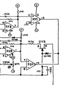

            One bit Im unsure about is the cmos switch on the comparator output - this will be gated with up to +8volts - is that ok?
            S
            • #66
              Yes, everthing above ~1.5kHz would get to the transistor, So no need to retune. The Rx coil and cap form a reasonable band accept filter.
              What was the deal with the cmos gate on the comparator - I realise it would require less time to activate it, as no CR delay like the original.
              it may also be on for a very short time too! I modded the original cap on mine to 10n and made it snappy but with useful tone duration.
              I did model that bit around the comparators with the feedback diode - but never understood hoe it worked Im ashamed to say.
              i often threatened to do that stage in real logic. but never did.
              If I get a rich handout Ill stop mucking around with this old toot and get a few Deus machines and have done with it !
              S
              • #67
                Your right the biasing on the 4053 switch at the comparitors might need looking at. They use Gnd to +8V and that comparitor
                stays at -6V a lot. I found that on an old Compass schematic as a FET (see below). It's supposed to modulate the audio a bit to
                help with IDing. I think the diode there keeps the 358 from seeing the rail (as it doesn't like that) you can put a resistor there
                instead.

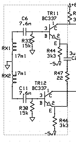

                • #68
                  Maybe something like this? 7.6n for 13960 hz resonance and 15k for 1.4 khz filter?
                  I'm just not sure what I did to the input impediance...
                  • #69
                    Apologies I misread the original schematic. The cap and the coil series resonate, The R takes the base to approx 0v . The emitter is negative wrt to base at 0 to bias it on. Looks good.

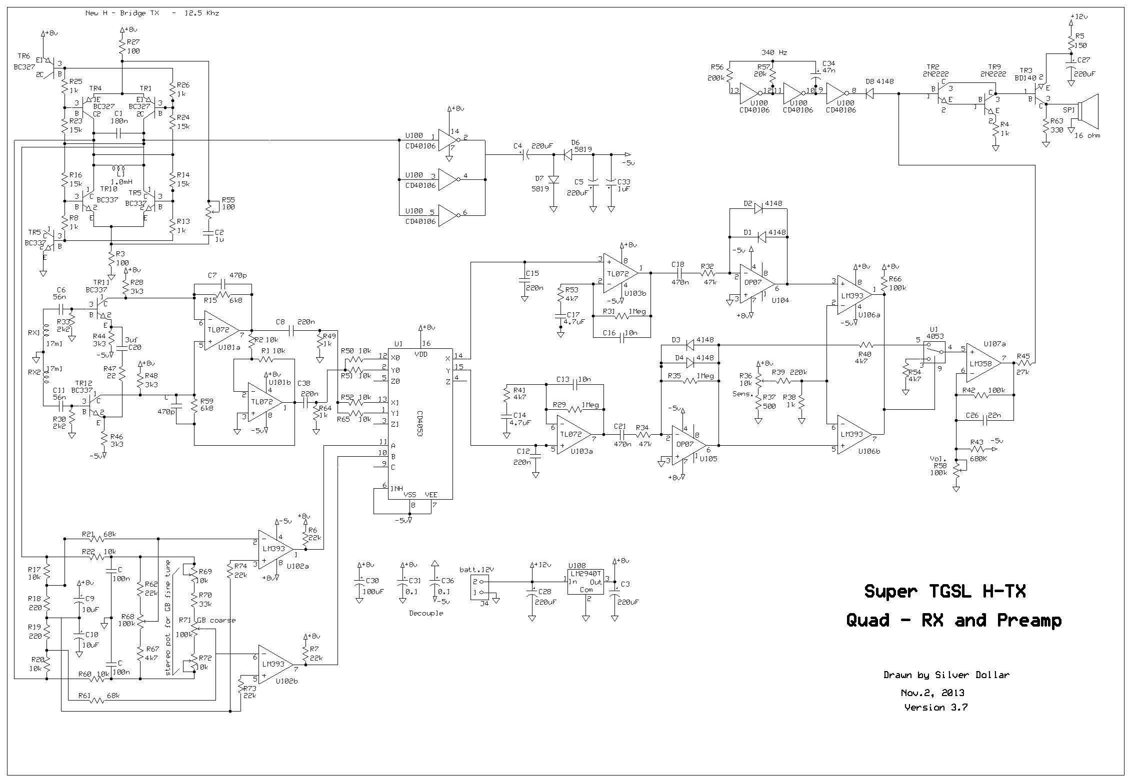

                      I tested the new H bridge with a different cap and my new 1.0 mh Tx coil/
                      I got 12.5 Khz and 17V! Looks good. Now to layout that preamp mod...
                      Oh here is the current schematic. I tried simulating the 4024 mod and it wouldn't
                      drive the push pull transistors. So I went back to my first inclination and paralleled
                      the gates. The sim says it works and can put out 5 ma. I hope that is enough!

                          • #73
                            This preamp is very different from a common detuned parallel tank, and it operates at resonance. So for a coil with 34mH and operating Tx frequency at 12kHz, the best values are 10nF each.
                            Detuning is necessary only for parallel tank front ends, and only because phase transition at resonance is very wild and difficult to tune. Those achieve low noise by transforming action, and with this preamp we go there directly. The equivalent noise source resistor of this preamp is ~100ohm or less, so there is no real need for transformer action.

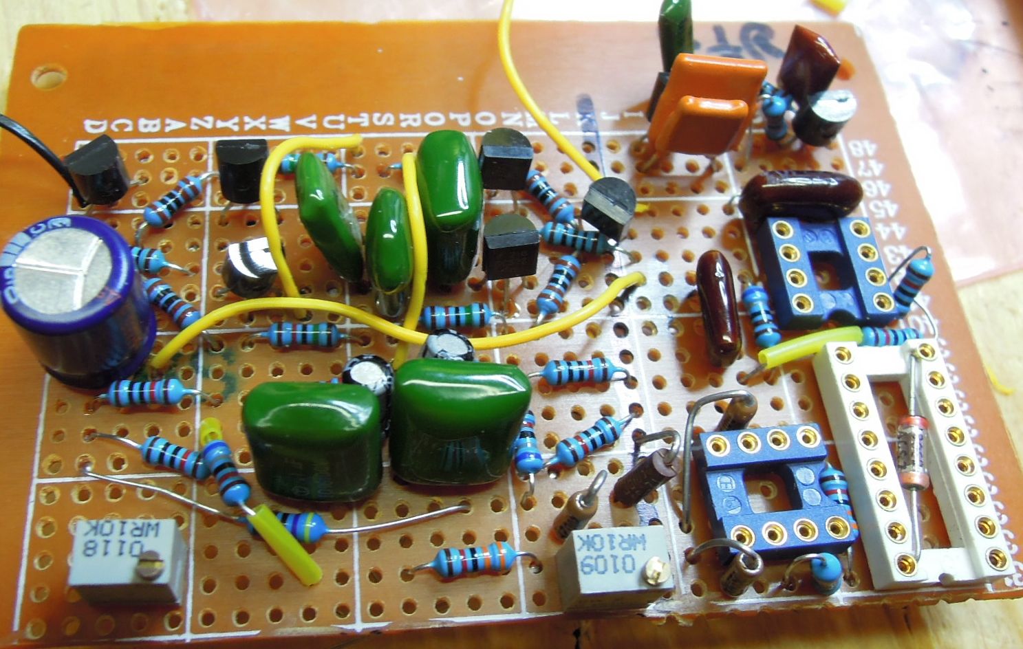

                            • #74
                              Nearly done wiring. Most of the mods fit on one PCB about 2.5" x 3". I'm not
                              sure about noise and cross talk. I just have to finish up the power connections
                              and wire the pots. Maybe tomorrow we can try it out!
