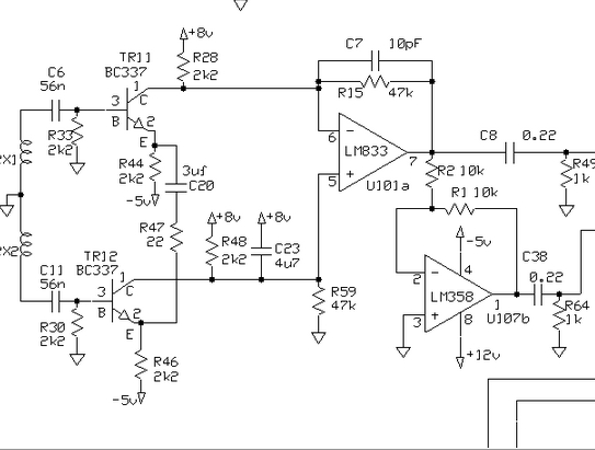

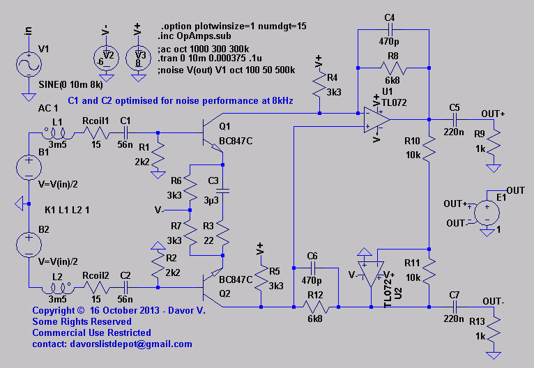

        Hi Davor / SD I was looking at the schematic earlier and I see C23 on preamp - it looks a little odd there is that a typo? S
        • #79

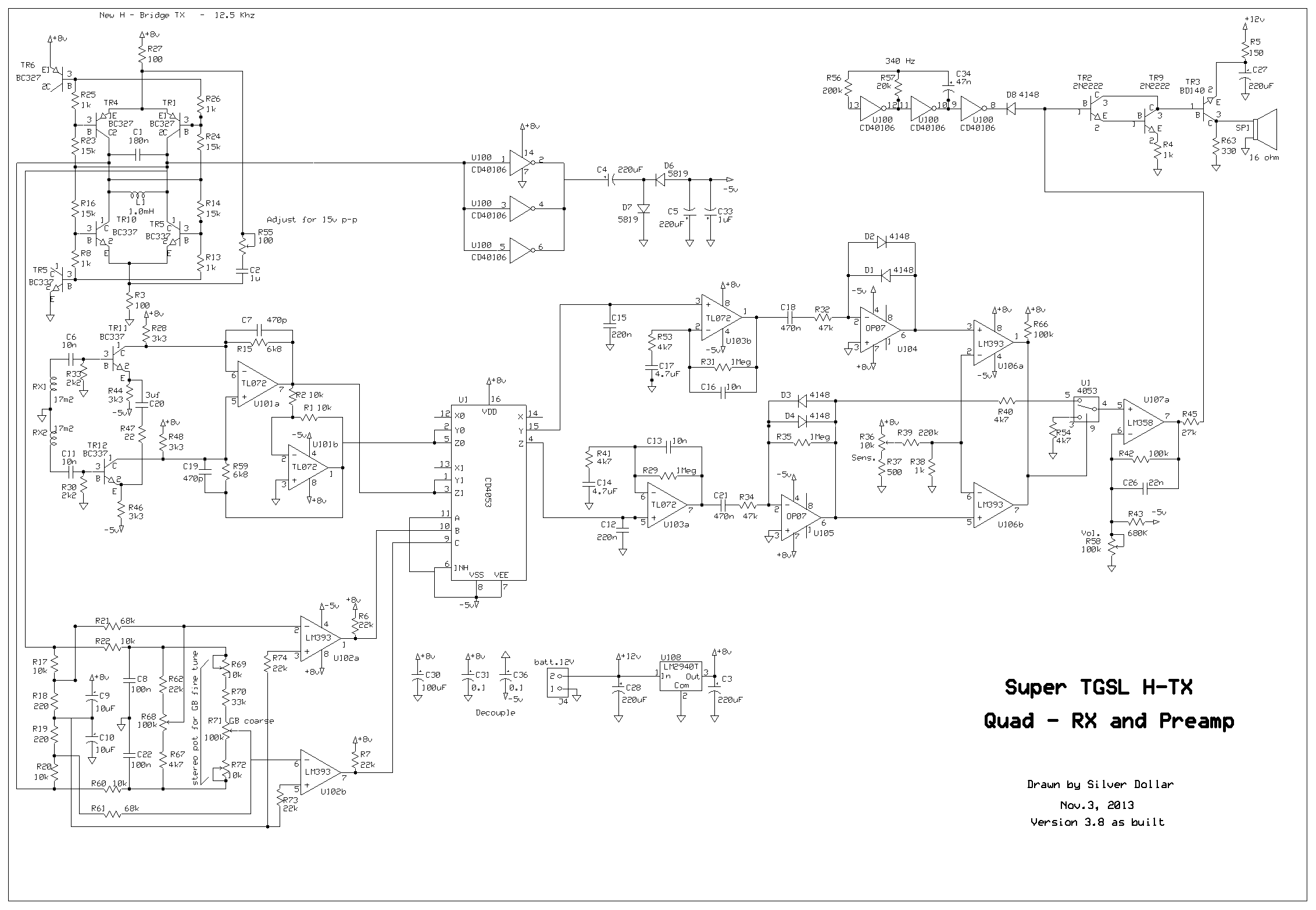

          I found out what you were talking about. There was a change from the original preamp with the
          quad addon to a new slightly different one see the images below;
          I also included the most up to date schematic...

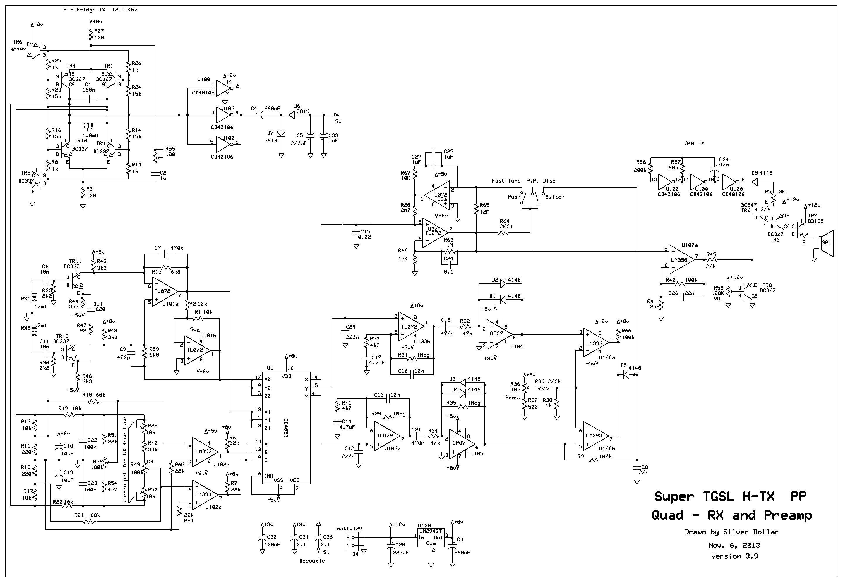

          • #80
            I decided to add pinpointer mode and tweaked the audio a little. Here's the schematic;
            • #81
              I'm afraid your tweak will make audio very binary, and IMHO that's not a very good idea.
              Since you've put the slow channel, it would be very opportune to enable it's full potential, leave it connected to the GEB phase, but the discrimination "ferrite chanel" put to a separate fixed ferrite channel. It would make it a whole class better than the rest of the crowd. I can tweak the phase shifter to provide a ferrite channel, and also pre-shift the other two channels so that a whole contraption happily accepts different coils.
