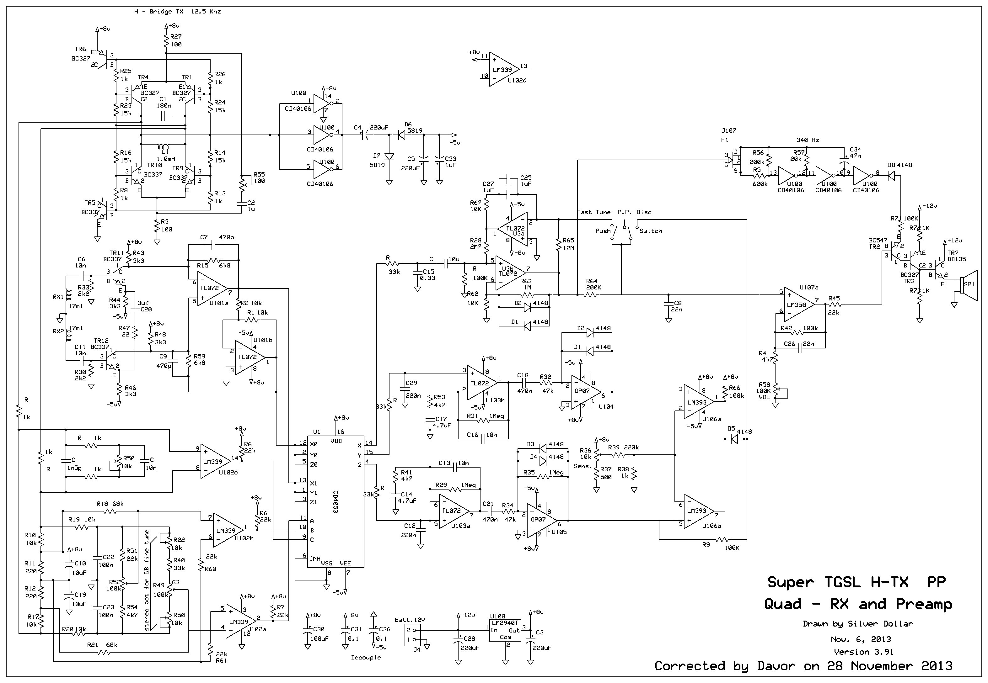

            I made some changes ...finally.
            1. I've put some resistors to soften the audio. I didn't simulate it so proper values might be somewhat different. It may need some extra care.
            2. I added a pre-shifter that corrects the Rx to Tx phase to 0° shift, or better say a ferrite shift. It translates all phases equally. It is also used as a fixed "all metal" reference for discrimination in order to maintain good discrimination even at severe GEB shifts.
            3. As I needed an extra comparator I simply replaced a dual with quad - it is cheaper than introducing a LM311.
            4. I corrected negative supplies for 4053 and the phase shifting comparators. They all use GND as negative rail, but 4053 has Vee pin connected to -5V to be able to cope with negative signal.

              I'm going to have trouble fitting the extra comparator on my board. Maybe I can piggyback the 393...
              I still want to tweak the audio a bit. Volume changes might make us loose deep signals so maybe a
              slight frequency change to indicate amplitude of the GEB channel? I'm not sure about biasing but
              perhaps a FET fed from the GEB signal that parallels a resistor across the oscillator R?
              Something like this?

                  Well, if there must be a VCO, it should be hooked to pin 7 of U3.
                  Also I'm not entirely happy with PP circuitry. Something is wrong with input. It should be DC isolated from a mixer, and it must be referenced to signal ground. The mixer presents itself as a low impedance DC source (air signal x GB phase) to the PP circuit, so the servo (U3a) can't do much about it.
                  I suggest the changes as in the attached correction. Values might be a little bit off.

                    • I also have a request, Could we see an image file, I cannot see .SCH files.
                      • Try this.
                        • Just a tip - when you wish to save a drawing or a diagram with only a few colours, such as a desktop, use .gif or even .png, but not jpeg. This whole image could have fit into less than 1/10 of this size AND without any loss in quality. Jpeg is good for photos, but sucks for everything else.
                          For reading .sch files go to http://www.expresspcb.com/ and download a free software. It is far from the best software around, but due to a very limited number of options you learn it in an hour. For this reason many people use it for sharing schematics.

                            • Thanks for the help on the schematics. I'm more of a technician than an engineer!
                              I realized the FET to tweak the oscillator frequency should go on the other resistor.
                              Here are the schematic and a PNG of the change. I'm calling this Version 4.0.
