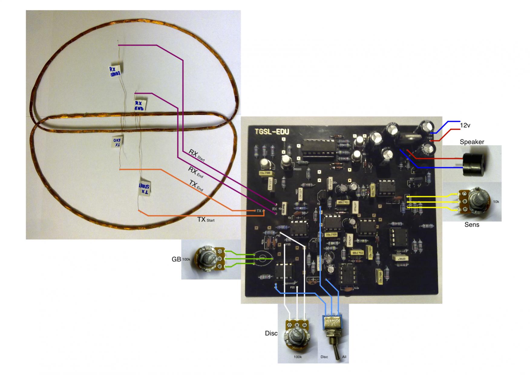

    Description of my problem with the TGSL circuit.
    http://www.youtube.com/watch?v=K_mXZCPOCh0
    When I try to "null" the coils and the RX singal is nearly 0 volts, the system start to swing around 2-3Hz after a piece of metal is moved in the near of the coils. I try out anything, but nothing helps. When the system is swinging the circuit don't react for ANY adjustment of GB, Sense or Disc. It's just beep beep beep..... arrrg.

        So, I followed your adwise but my problem is still present.
        At first, my equipment is a voltage meter, a frequency meter and a double channel scope.
        I exactly checked all cable configurations (TX, RX, both shields and all pot's connection's).
        Equal what I tried, nothing has an influance of my problem.
        My perceptions are:
        -shields / no shields: nothing changed
        +/- 5 windings: the same behavior
        checked all power supply voltages (12v, 8v, -5v): in order
        The pot's are working, but if the system shows the problem, I can turn the pot's in any directions but nothing changed.
        After I performed setting of the coils to a minimum of 5 mv on RX with overlapping the coils, a ferrite is recognised. But i can't set the GB pot if the ferrite is rejected.
        The most important notice of my test is, the system react on metal, but after a while it's starts to chattering by themself without any movement over the coils.
        Further when i disconnect the RX coil during a tryout the system still beep beep beep... without the RX coil??? (sounds like video)
        When I cut the power supply and reconnect, the circuit quiet a while and a few seconds later the problem starts again!!!
        Maybe someone has an equal problem, or know an answer of my request, so please give adwise!

                  When I try to null the coils, for example with a multimeter, like page 12 of
                  (http://silverdog.co.uk/shop/image/da...CoilMaking.pdf),
                  the circuit already starts to swinging.
                  But even without a connected rx coil.
                  Should this be so?
                  http://www.youtube.com/watch?v=EaI6eXReI3Q
                  If not, what could be my error?
                  Disc and shielding are not even involved at this time, I think.
                  An error in my setup?
Name:	TGSL setup.jpg
                  I am thankful for all advice.
