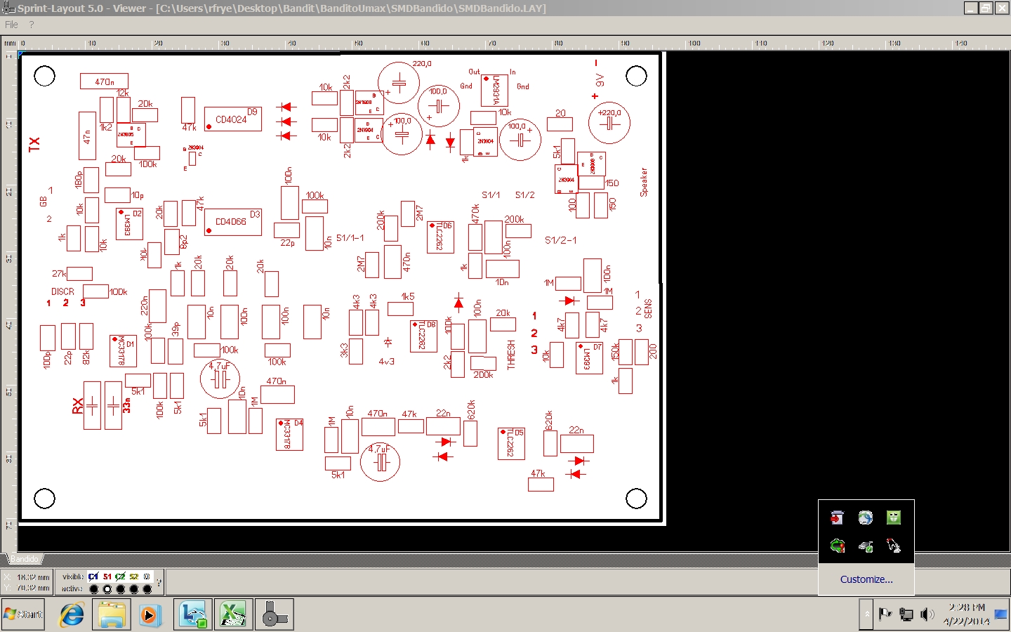

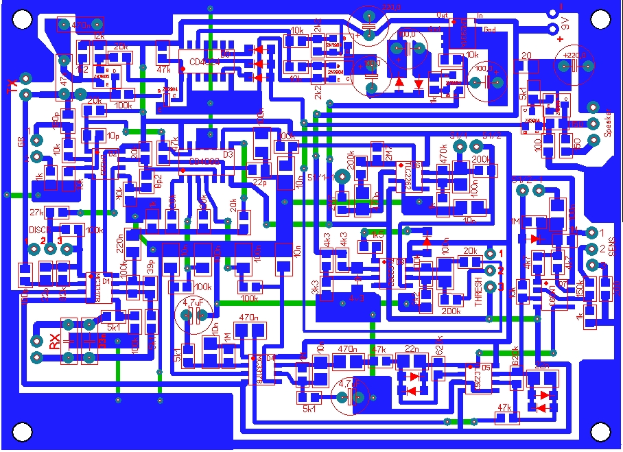

    Here's some info on the SMT Bandito board;
    The layout files as JPG's and a viewer to look at the
    Sprint? original file
    Here's the lay file in a zip;

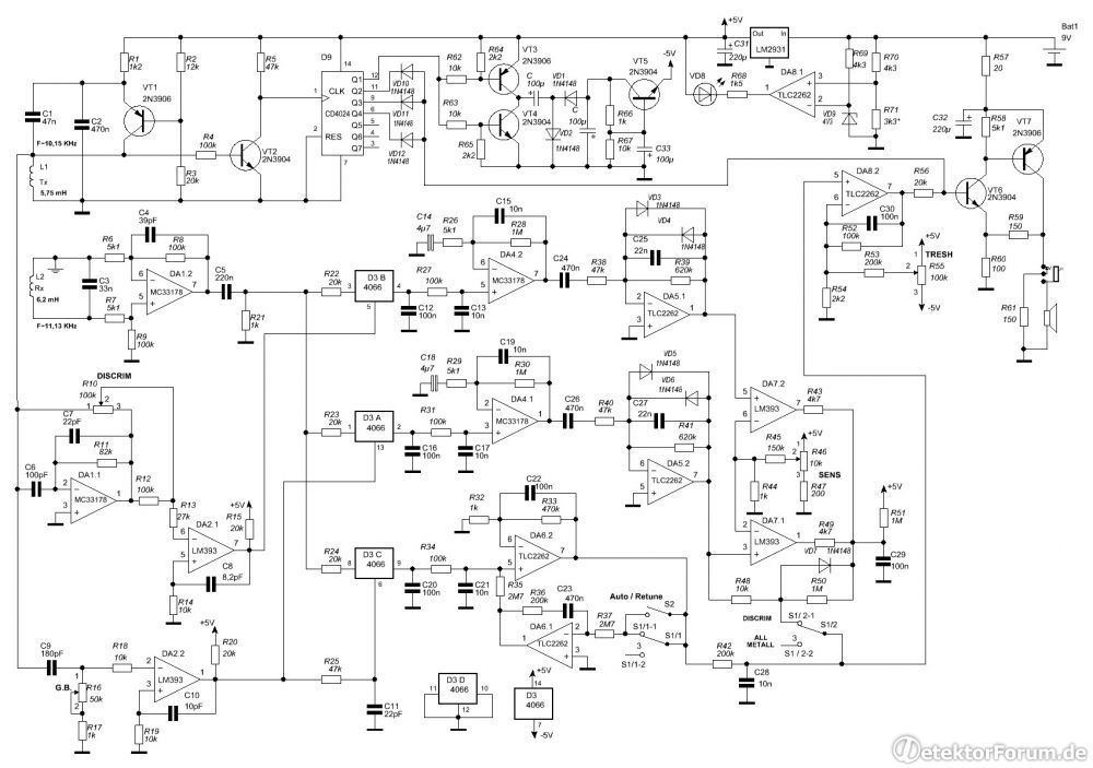

                      which schematic we are working to. I found a German schematic this morning that uses the battery
                      check circuit that's in the layout. It's different from the original Carl one and Chemelec's.

                      Here's that schematic;

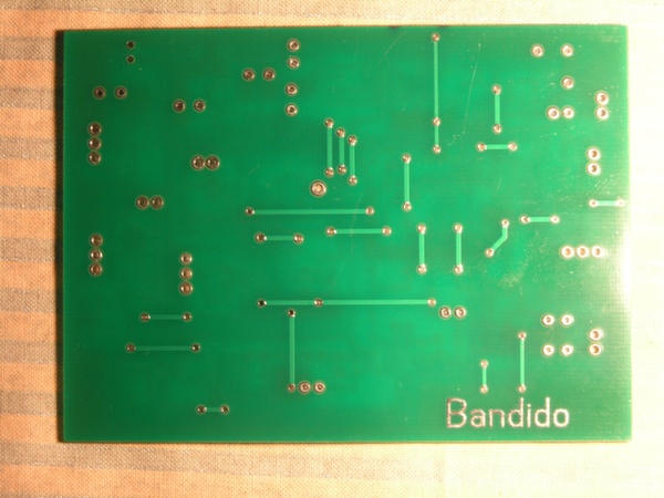

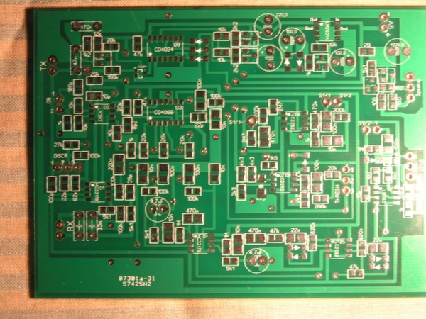

                        Yes I have the silverdog PCB looks very good and much better than trying to etch my own.
                        Can take some better photos in daylight if you need them
                        97.5mm x 71mm
                        pads 3mm x 1.5mm approx for resistors
                        4.4mm x 2.1mm approx for caps

                            Those photo's are good. I was just checking to make sure my docs matched. It looks like the circuit
                            matches the last schematic I attached. It uses a slightly different battery monitor.
                            For the components I have found some values are not easy to find in some sizes. The caps seem to
                            be different sizes depending on value. I have different sizes / values available at work so I can "try
                            before I buy" to make sure to order the correct ones. It's hard to tell from the pictures but the pads
                            seem larger to me. A too big component can be used but is hard to solder as the pads are underneath it.
                            Here's a link on pad sizes; http://en.wikipedia.org/wiki/Surface-mount_technology
                            Looks like 3mm x 1.5mm = 1206 for resistors
                            4.4mm x 2.1mm =1806 for caps
                            So 1206 should work for both
