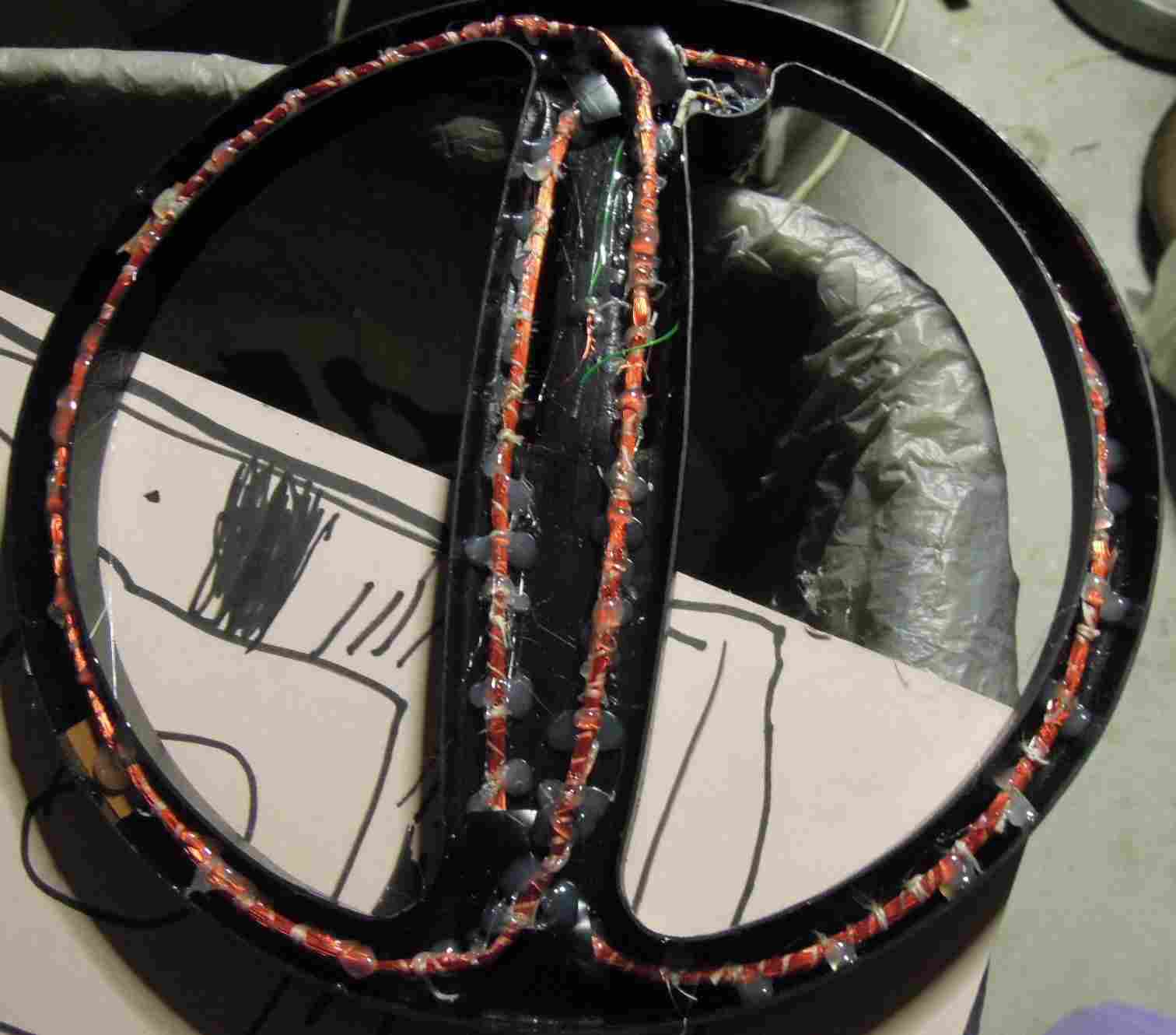

        With the new 9" DD coil I just made;
        10" - 11" Gold
        11" - 12" Silver
        9" - 10" all Coins
        The new coil is a 6.0 mh TX and 6.5 mh RX center tapped with no shielding. Some random beeps were
        apparent. Here's a picture;
        The null was around 200 mv at pin 7 of the first opamp but went way up while the hot melt was applied
        then back down to 73 mv after it cooled. That might be too low. We are aiming for 4 mv at the coil which
        should be 200 mv at the output of the first opamp. I saw 500 mv with the original coil...

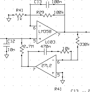

                        I can try a 27L7 or LM358 as I have those in SMT... I wanted to try the original filter
                        setup anyway. That uses a servo like filter with a 358 and 27L2...
                        • Well I tried the servo filter but the board didn't work well. So I tried the LM358
                          in the original circuit but less depth. So I put the MC33178 back in. Then it
                          worked as before but with weak sound. I get a bit of chatters too forcing me
                          to use low sensitivity. The average noise looks OK (40 mv peak to peak at last
                          LM393) but occasional big hits come through on a random basis.
