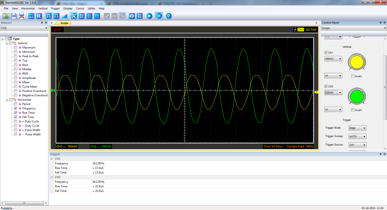

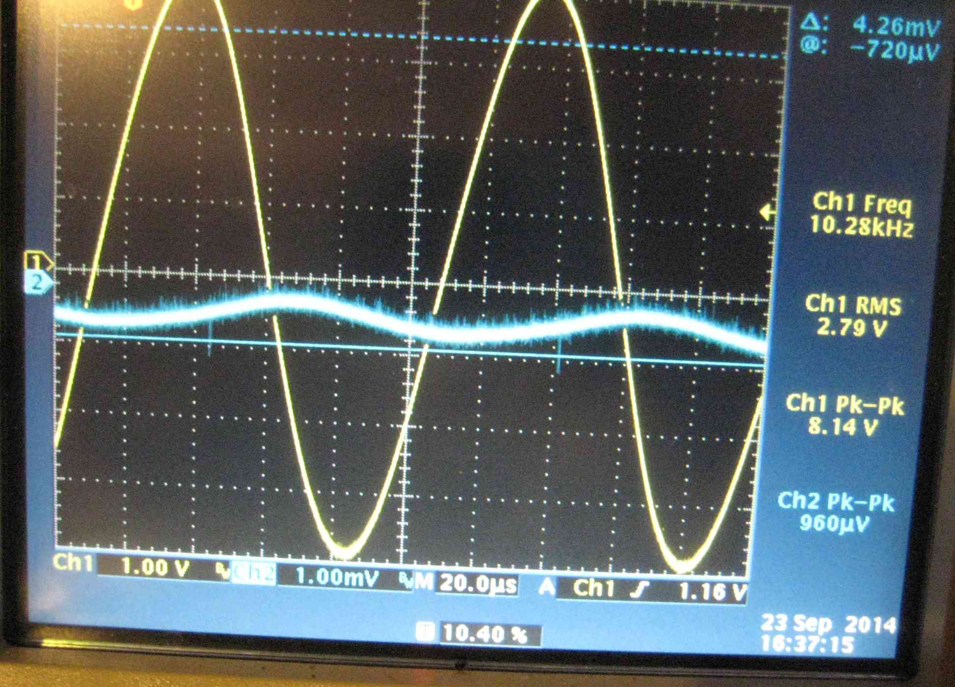

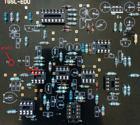

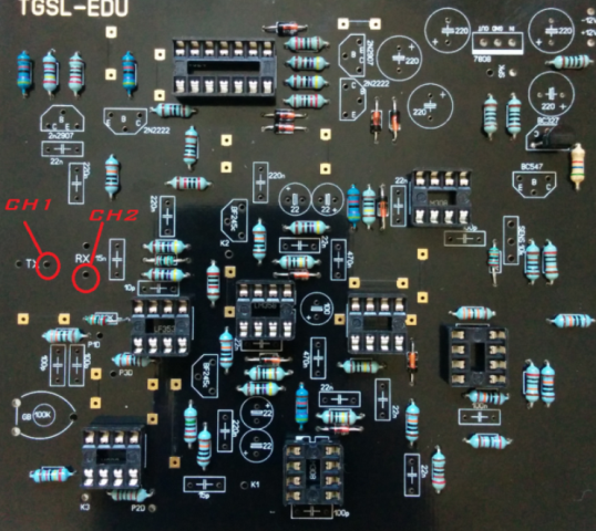

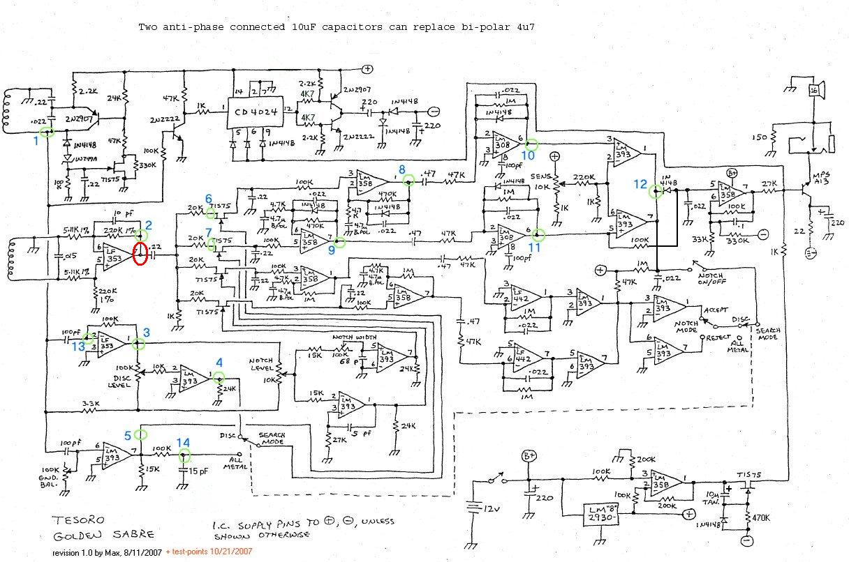

    I test my TGSL-EDU with the Hantek 6022 and got these values: See pics. In pic #2 you can see where i put the probes.
    I really dont know what to measure, so please, give me a hint where to put my probes, and what numbers
    i should aim on.

      Well channel 2 should be after the preamp;
      The level should be 4 mv at the coil so 4 * preamp gain at preamp out.
      Looks like the gain is X20 so 80 mv at the preamp out.
      You have to be on the correct side of the null though. I think you can tell
      by waving a piece of ferrite. It will have a favorite side where it will gain in
      amplitude only. I think you want to be on the other side so waving ferrite will
      cause a phase shift to the favorite side before amplitude gain. Waving silver
      (like a silver dollar) will cause an amplitude gain only as it likes our null side.
      So you want to be 4 mv on the silver side for best operation. This is all easier
      to see on a concentric. A "DD" is too sensitive to make the tiny changes needed
      to see this... (at least mine is)

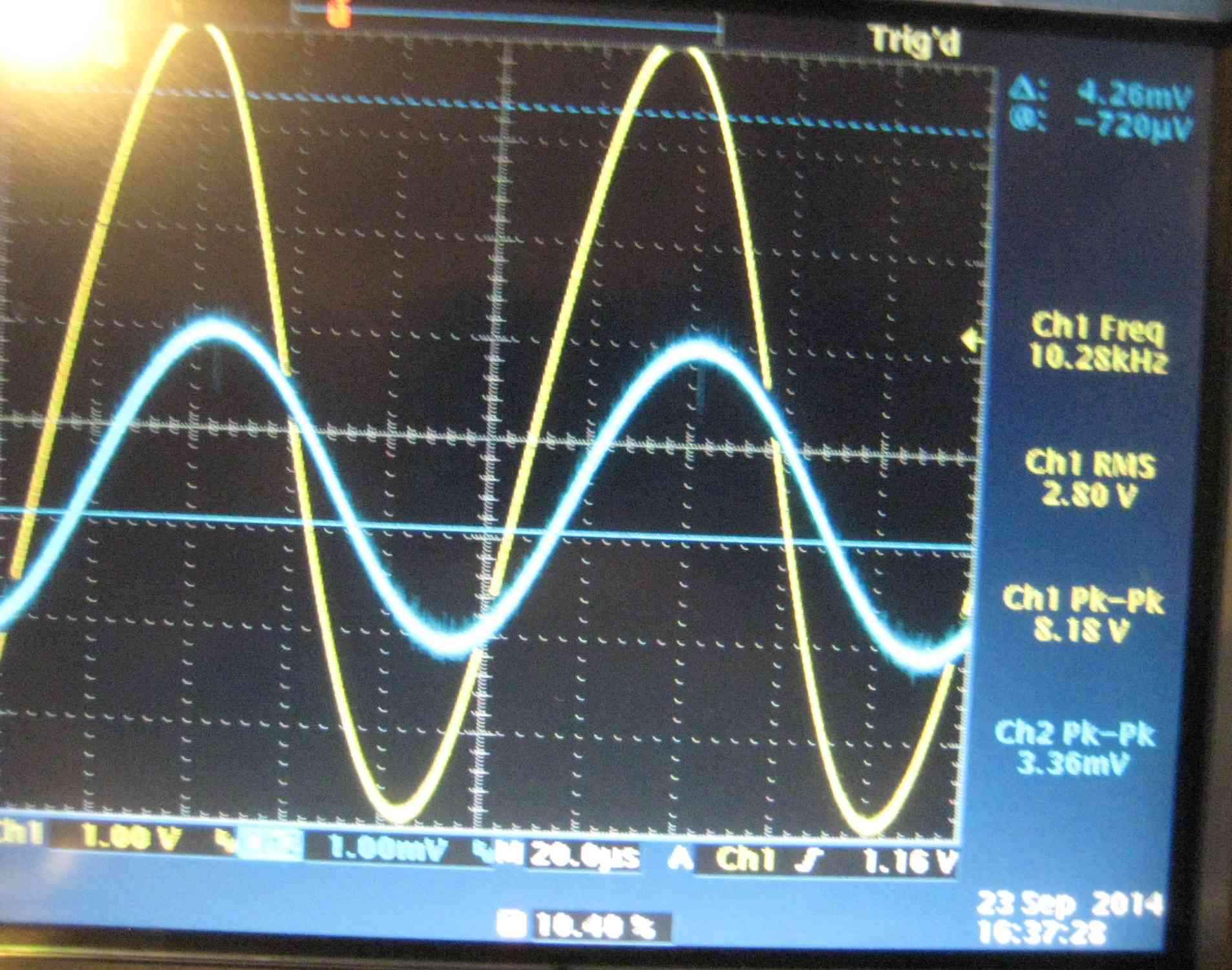

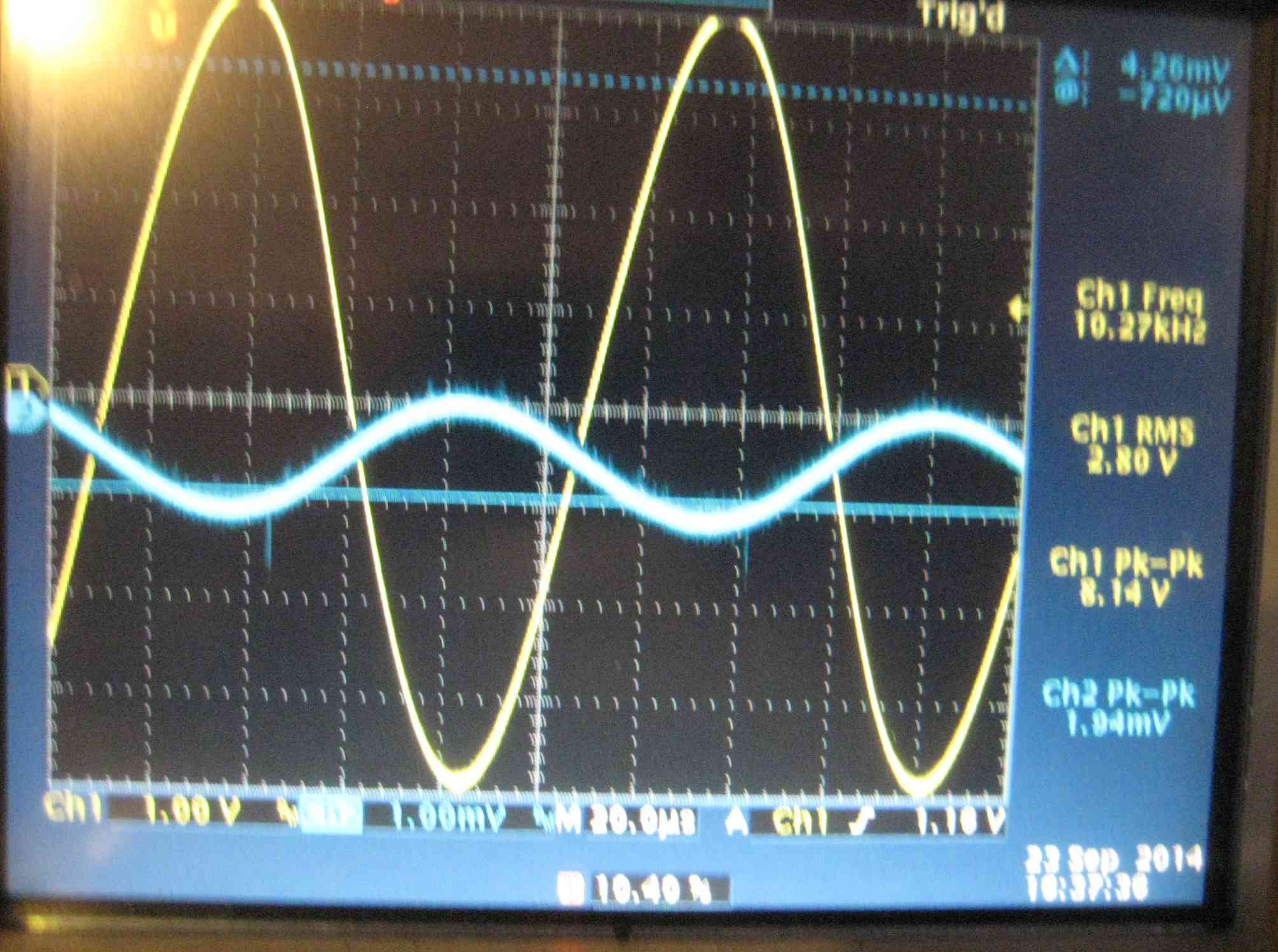

      Here's some pictures of a concentric I did a few days ago;
      Nulled
      Ferrite
      Silver

                  On the scope it looks that phase shift is just aproxx 20 degree, ,should be DD coil 20 degree and concenteic 200 degree(2 hundred) degree?
