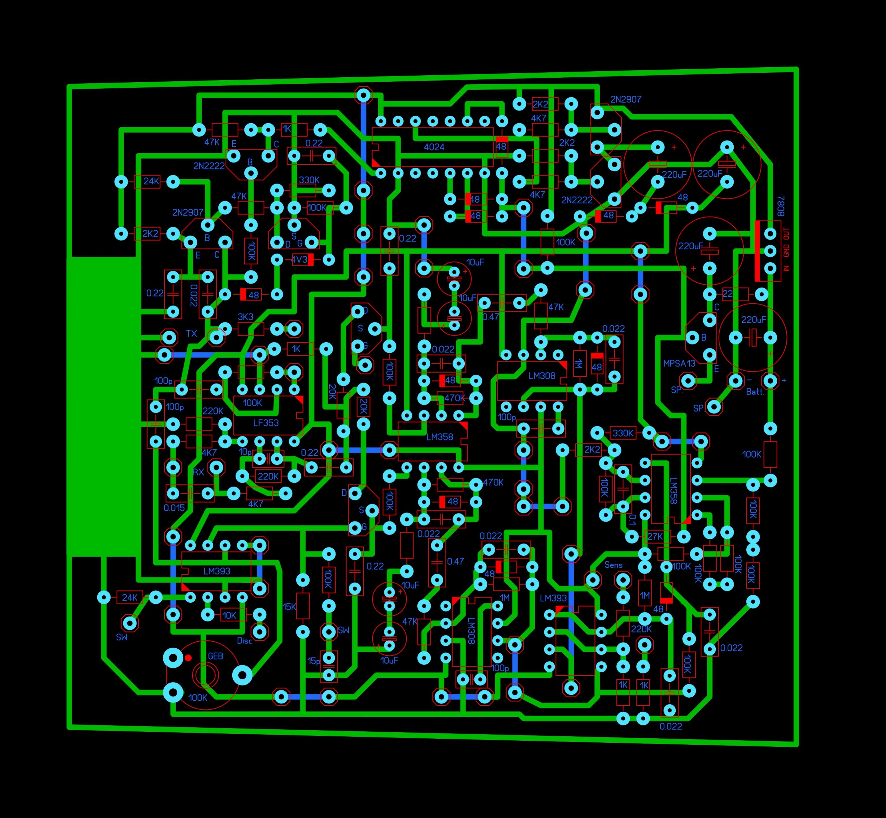

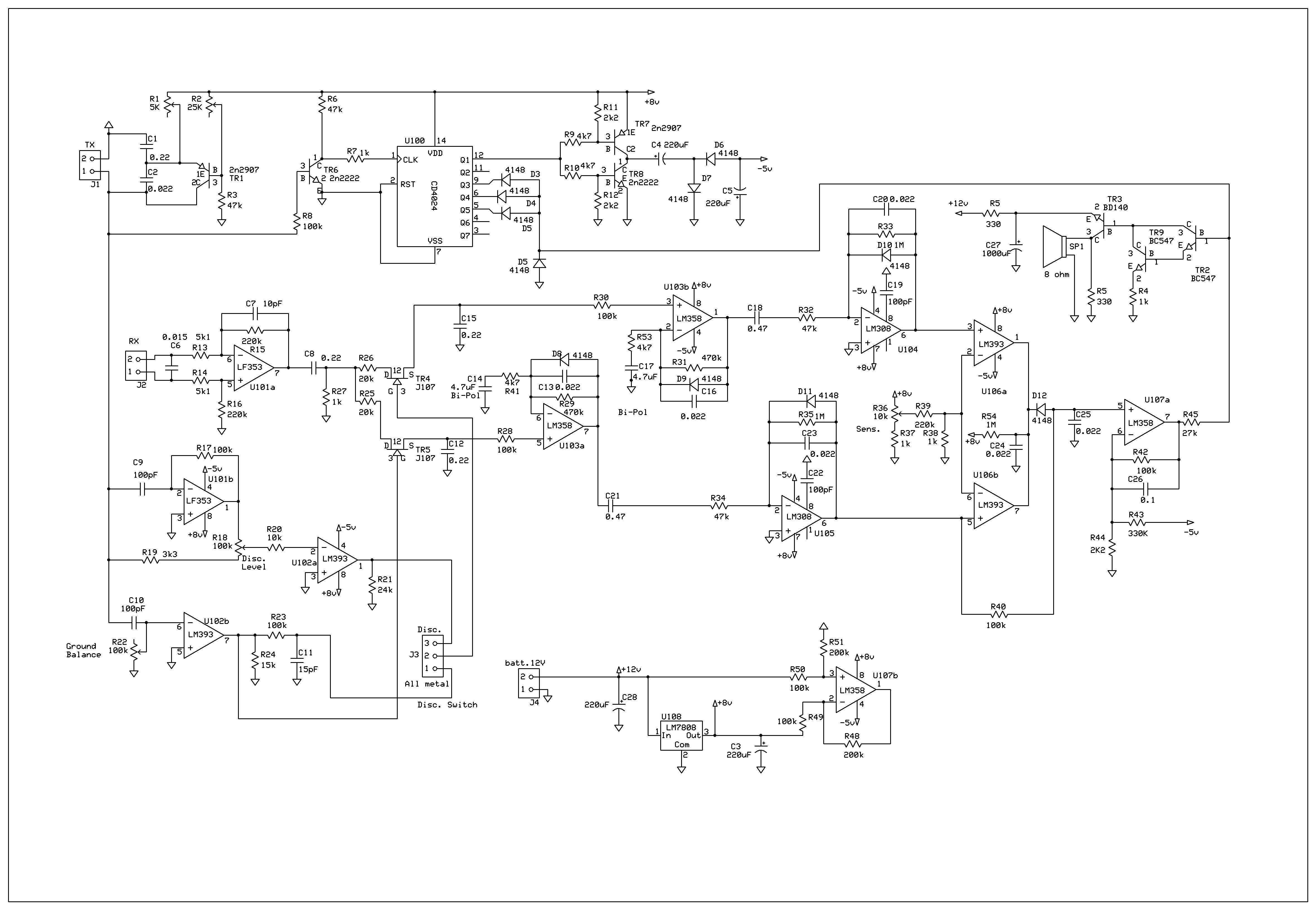

    A member from forum asked me about dimensions of pcb.
    Last and best working TGSL configuration for me is this one, i made over the 30 units according to it.
    Some people don't have Sprint Layout, so here it is in PDF format too:

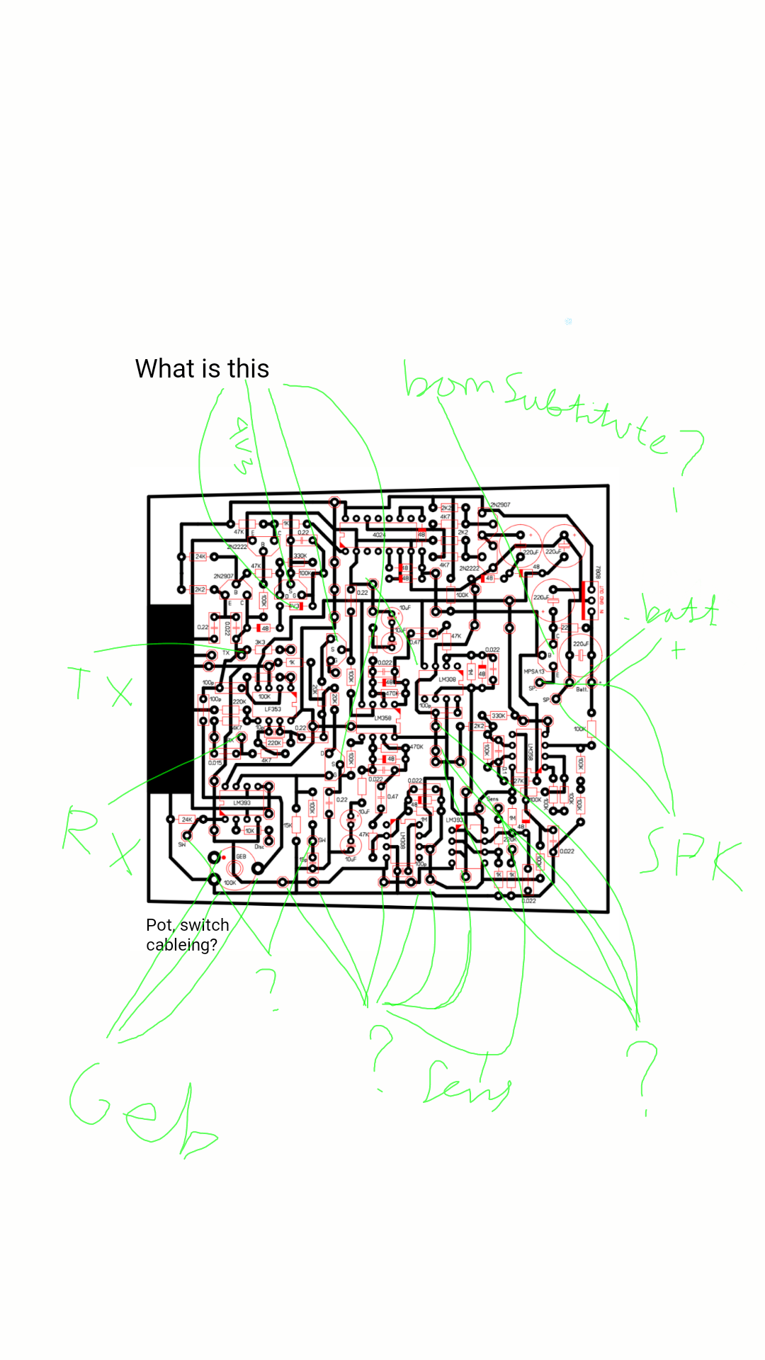

    Ivconic sir, thanks for the sharing, but i cant find post about your cableing, pot,sw,etc here, and some part is different with sticky thread by Qiaozi, sorry for the trouble.
      If you follow the schematic carefully; you can recognize all the components and cabling points.
      Those fets are J107 or BF245 (with reversed pinouts).

          Schematic :

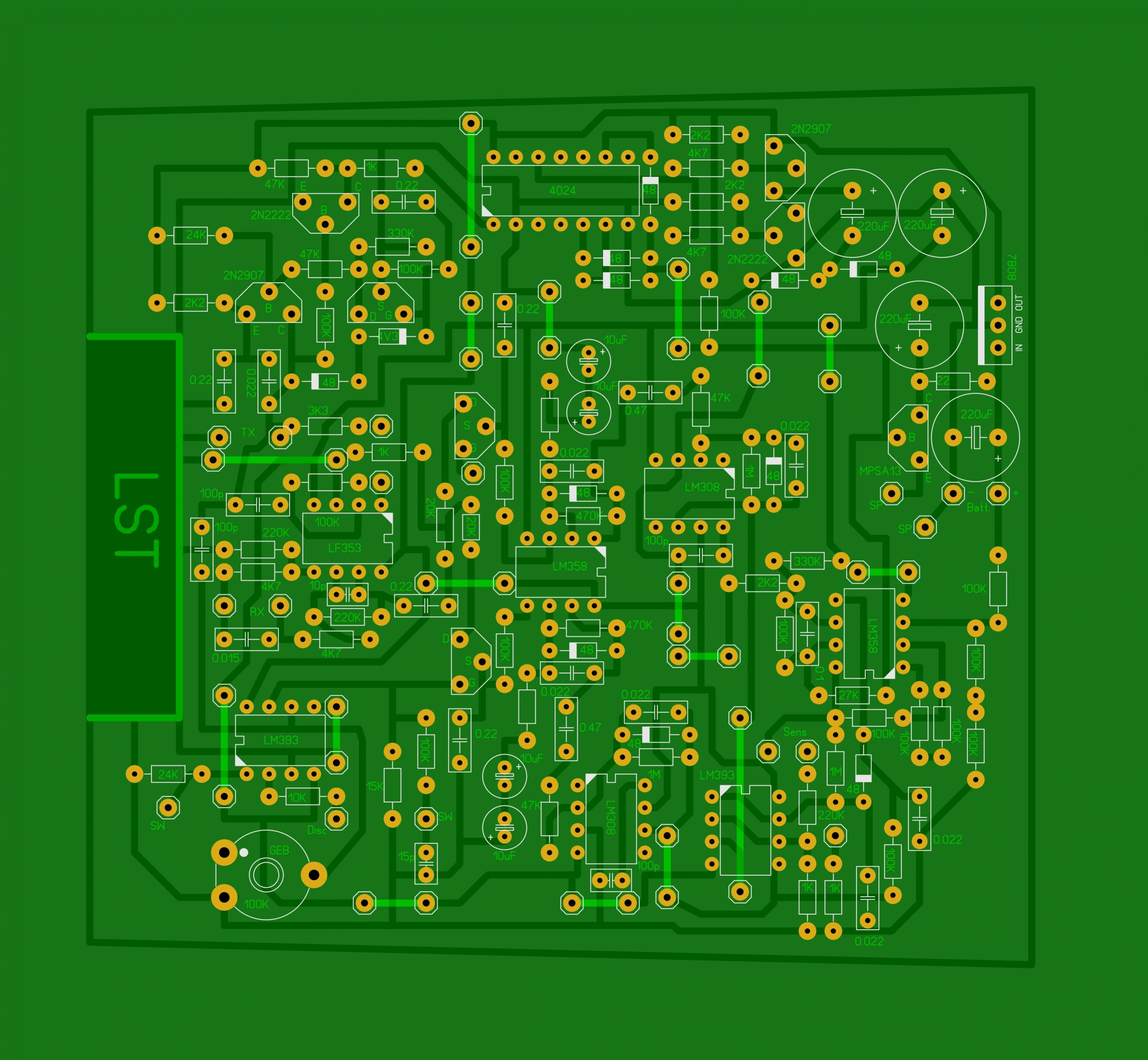

            PCB photo view :

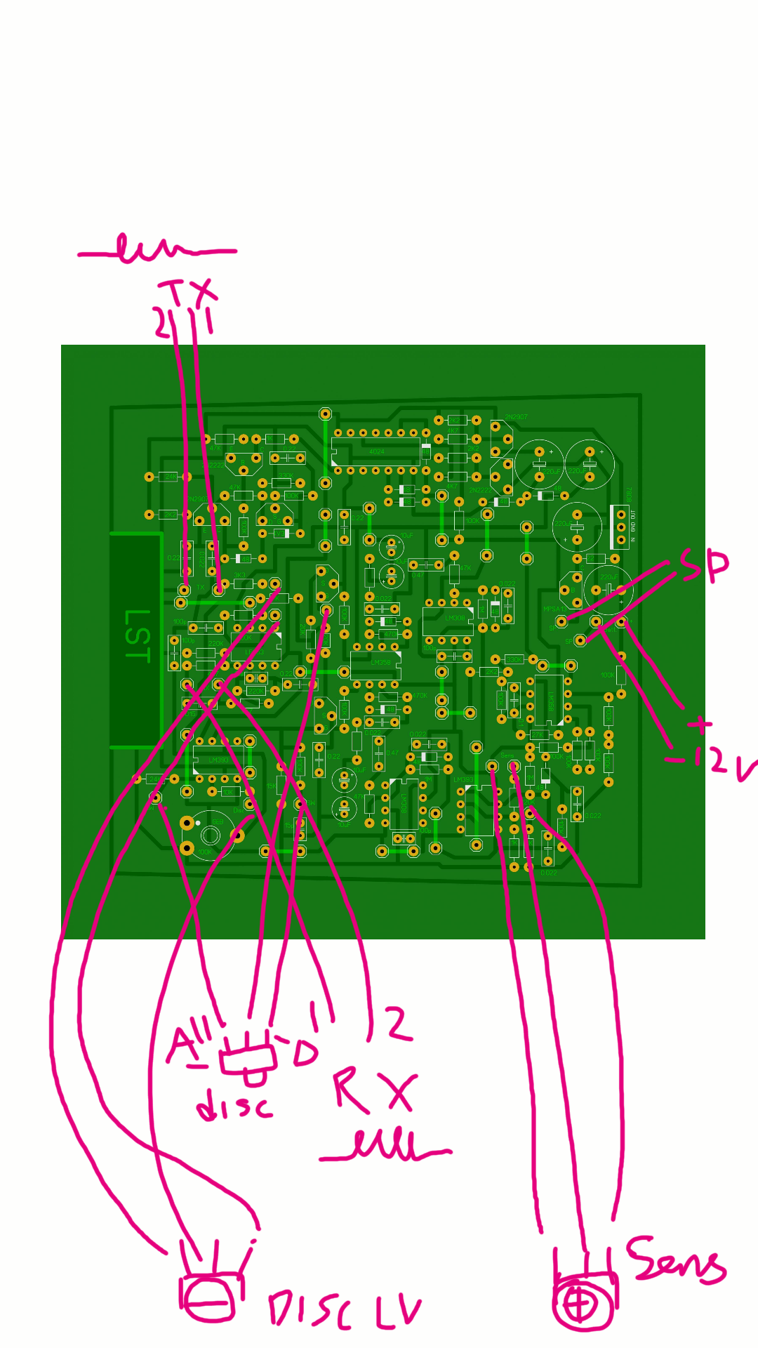

              I see, let me try.... will report here after got a clue....
                I think this is all ....
                Switch+pot

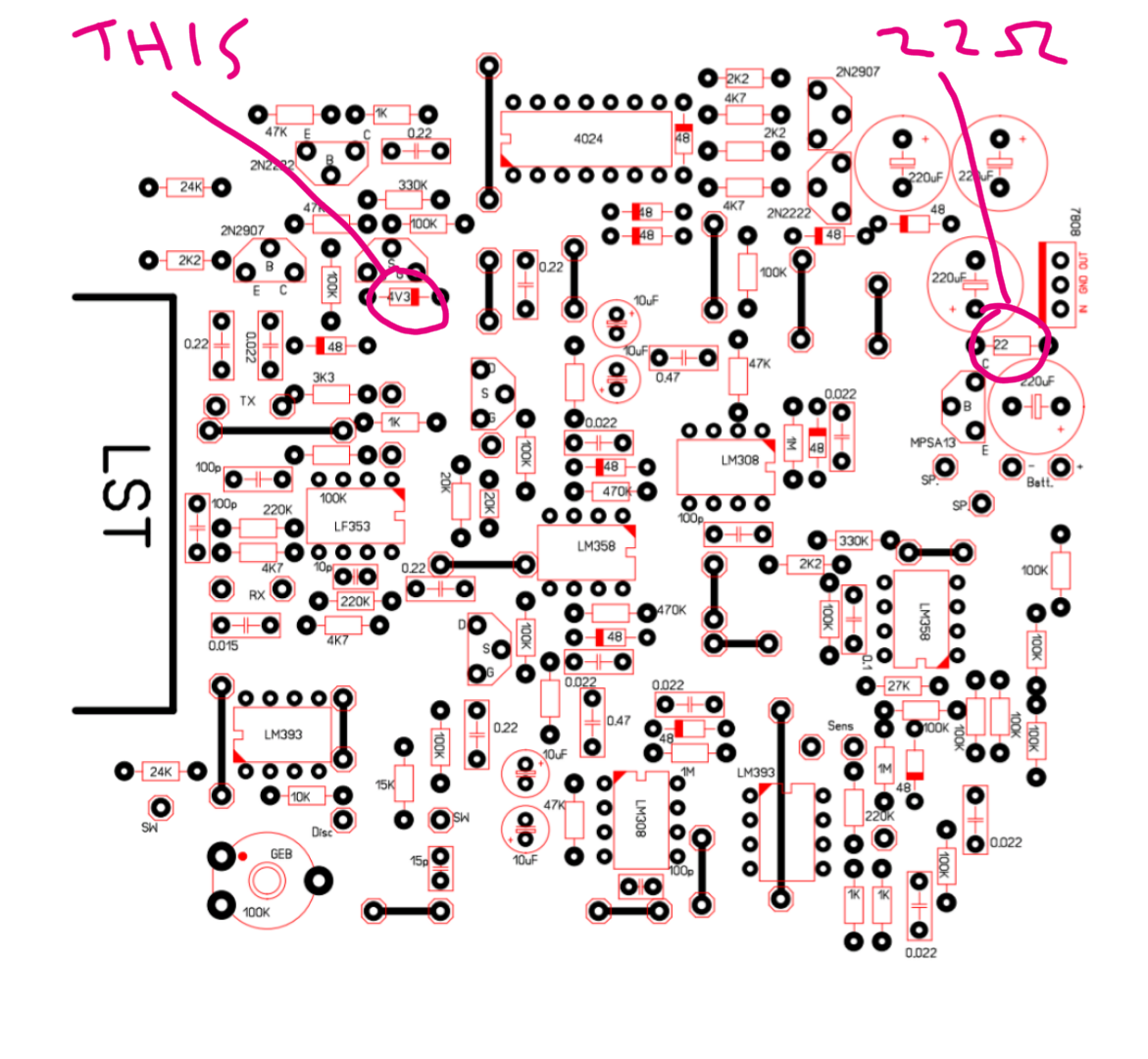

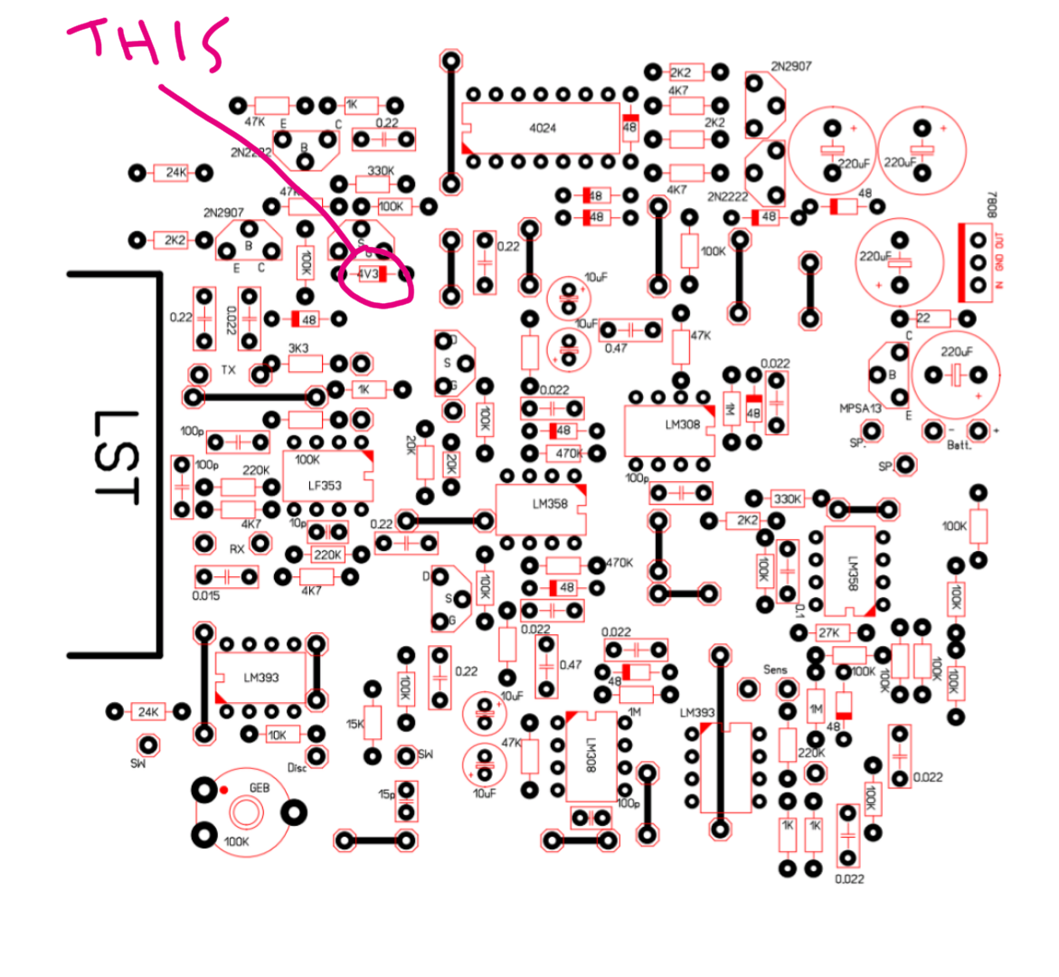

                        Thanks sir, I will put all the remaining parts and buy the missing part, just to make sure about 22ohm resistor and one voltage diode 4v3 is not a wrong value of IN4148? Thanks before
                        This
                          This
                          [ATTACH]36733[/ATTACH]
                          Those are correct.
