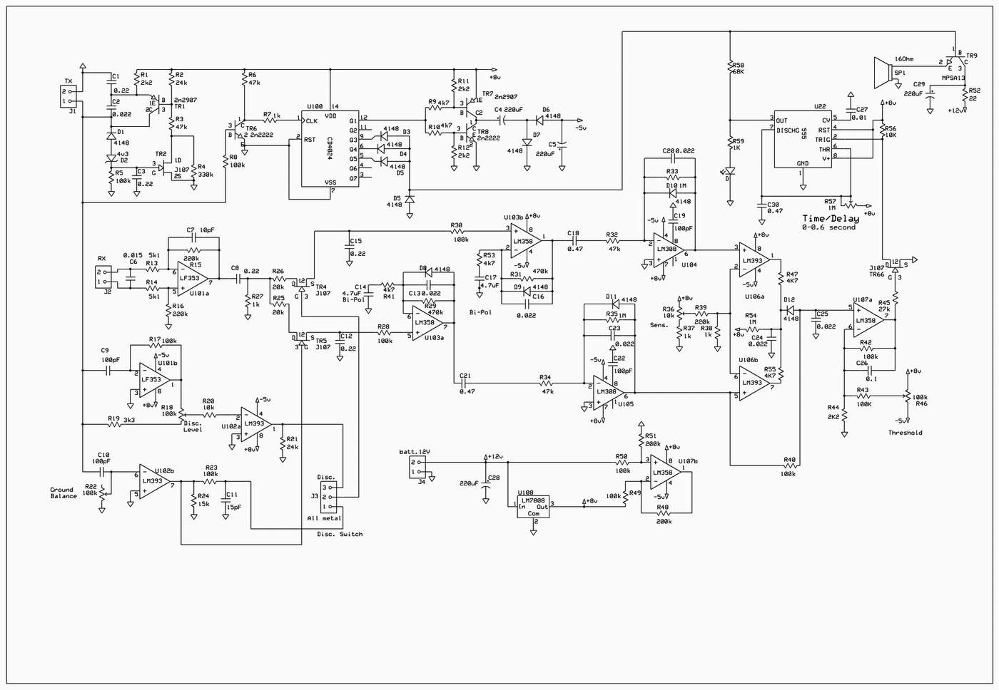

          Because this schematic

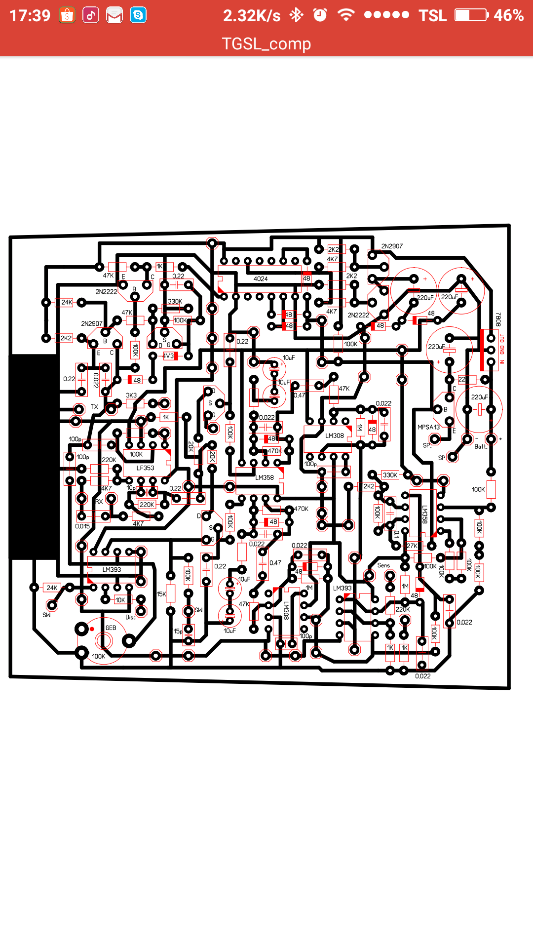

          Have some different with the pcb
          Let me change 2n2222 like the schematic.

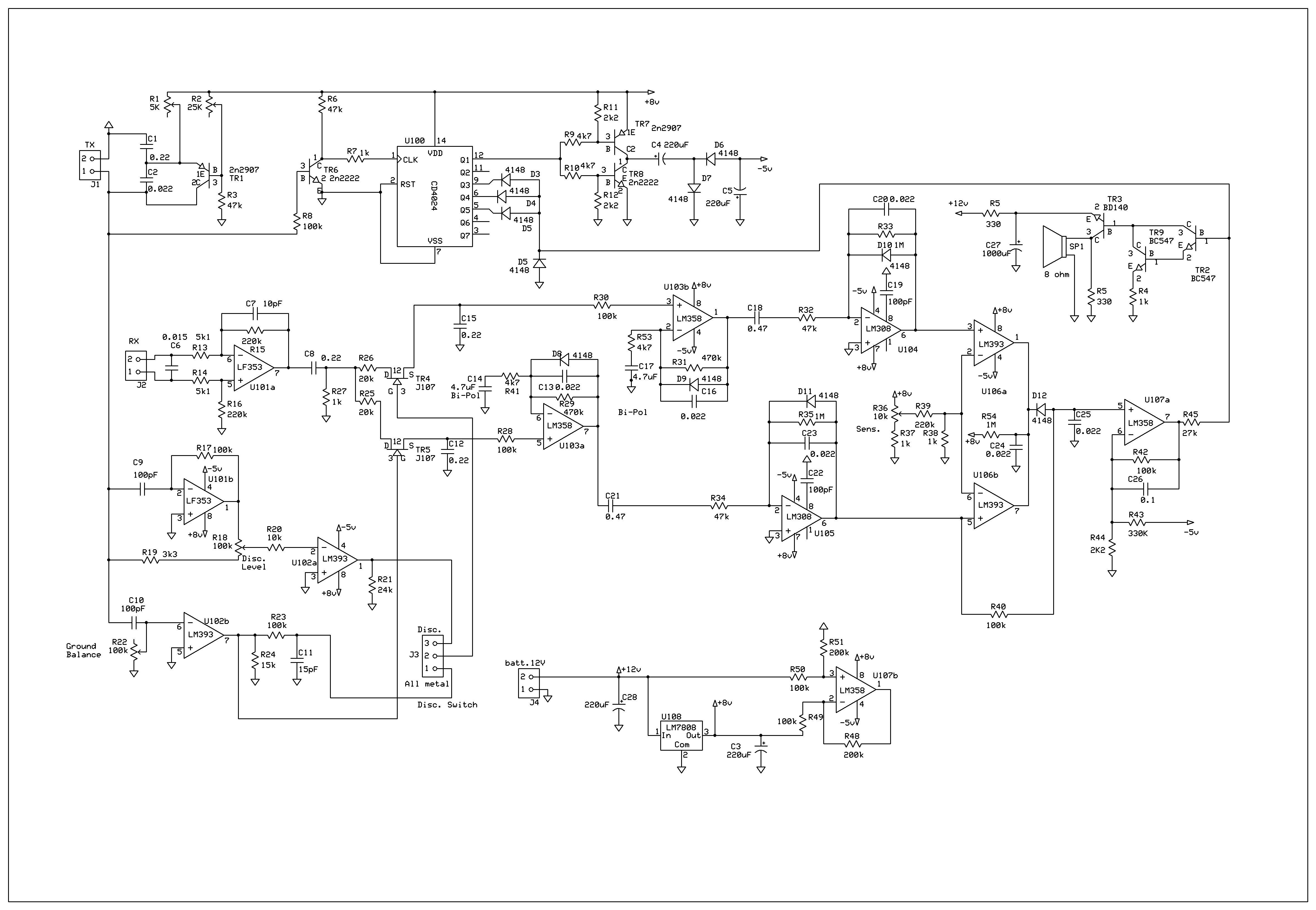

              My bad... wrong upload same folder, i mean this scheme

              I follow all parts acording to pcb pic, not the schematic

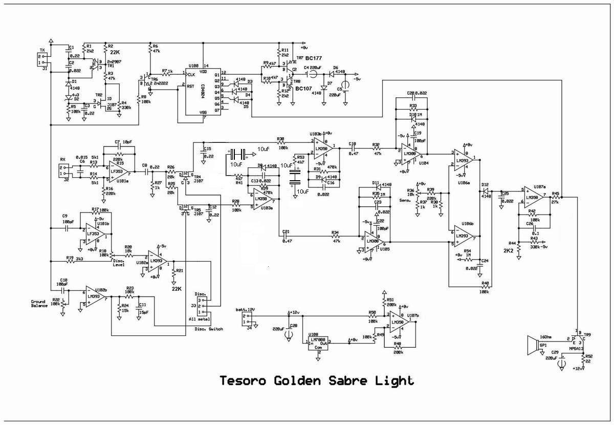

                      This is schematic with mpsa13 audio transistor.

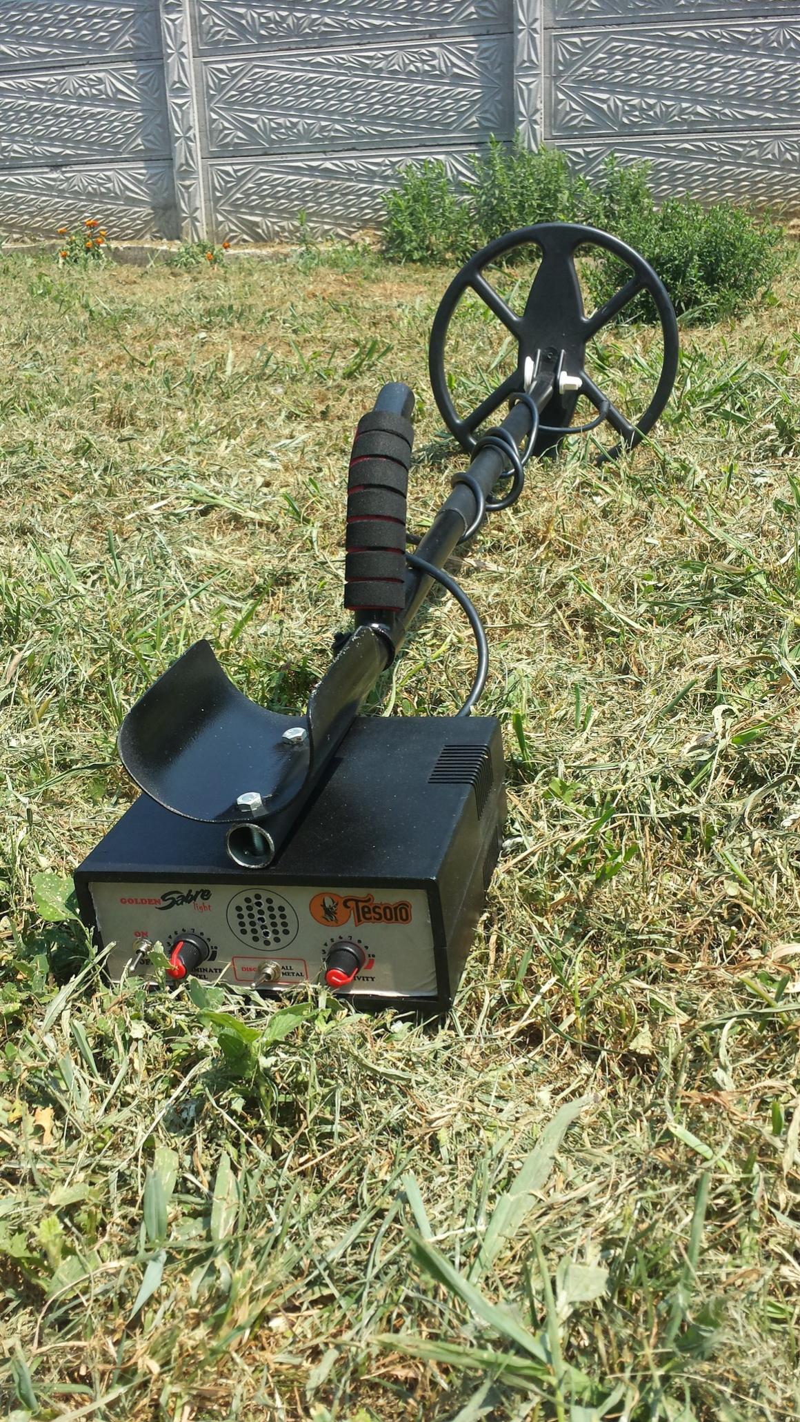

                      Also, this is my TGSL build:

                        • #42
                          Looks factory built to me, is your coil housing a home made? I try to make one and fail til now, no faccum work, just resin.
                          Is there a way to nulling with analog multimeter
                          • #43
                            Not factory made, but my personal work. Coil housing are directly from Bularia, u can find them on ebay, panel screen is also my creation mixed from several pictures from net, maked in adobe photoshop. I dont know for analog, if u have ac range in milivolt, why not.
