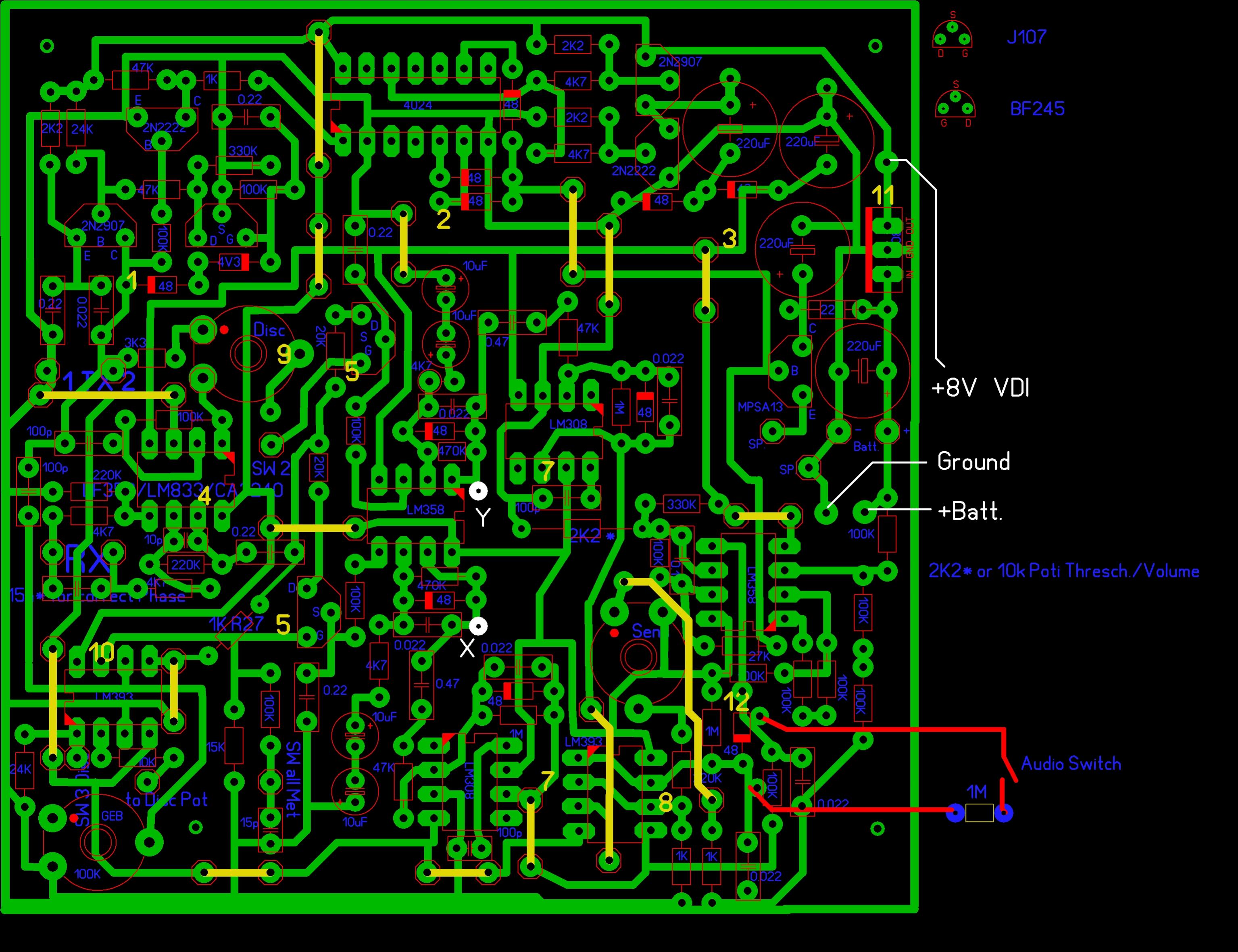

                          Maybe someone is interested, this is my Sprint-Layout5 version, which I've builded and is working well. I think it is also TGSL1265 from Ivconic, first post in this thread, but I made the plate a bit smaller by moving some components.
                          Also I added Sens and Disc trimmer, for temporary purposes to adjusting TGSL, because I don't like too much wires on the board while experimenting..
                          The yellow numbers are the oscilloscope testing points, in accordance to the introduction TGSL_101_PART1 from Don Bowers, it was a very helpful document for me.
                          And the white marks X;Y;+8V;Batt.;Ground are the connections for VDI by Whites IDX from Eduardo.
                          The audio switch I've not used, instead of this switch, I've used the fixed 1M resistior. As I remember right, it gives more audio volume, while using loudspeaker.
                          Well, I know there are many different versions of this project and maybe people are confused about it...
Name:	TGSL with some mods.jpg
                          Sorry, but I can not upload the file, can someone explain, how to do that!

                                I think you need to buy an oscilloscope, it seems to me, that you has made the same version like me. Without oscilloscope I was not able to check all testing points and to get the best wave forms, point by point. Also for coil nulling process, it was much easier for me.
