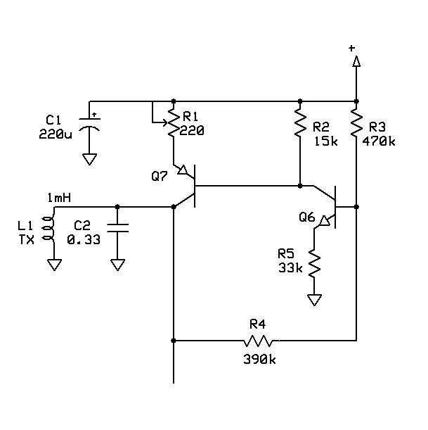

        Would be nice to make Musketeer oscilator for Blobber version, like IGSL. I think it's more sensitive cause that osc. is stronger.
        Mm..I could try on bread board first. It gives more p-p? I have now 16,5 V and while I reduced R1, it was 21V, with bad wave form, same current consumtion, but without more distance my test coin. But I will give him a chance.
        • Originally posted by blobber View Post
          You can pump gain by increasing R29 and R31 from 470K to 1M.
          Also, here is Musky example...

          • Thank you CDI, I will try your suggestions today or tomorrow.

              Well, I builded the musketeer osc. on bread board, also the osc. from S.M.W. detector. I adapted LC circuit with 22 nF for 14,5 kHz, but the wave forms are not realy different.
              Anyway I am satisfied with my one transistor osc. in pcb, I changed R1 from 2k2 to 1k and R3 to 51K7 (47 and 4k7), now I have 20V p-p and a nice wave form.
              Also I increased R29 and R31 from 470K to 1M and I was realy surprised, now detection is increased about 4-5 cm. So time for me, to put all in my homemade plastic box and hope, to test soon in the field.

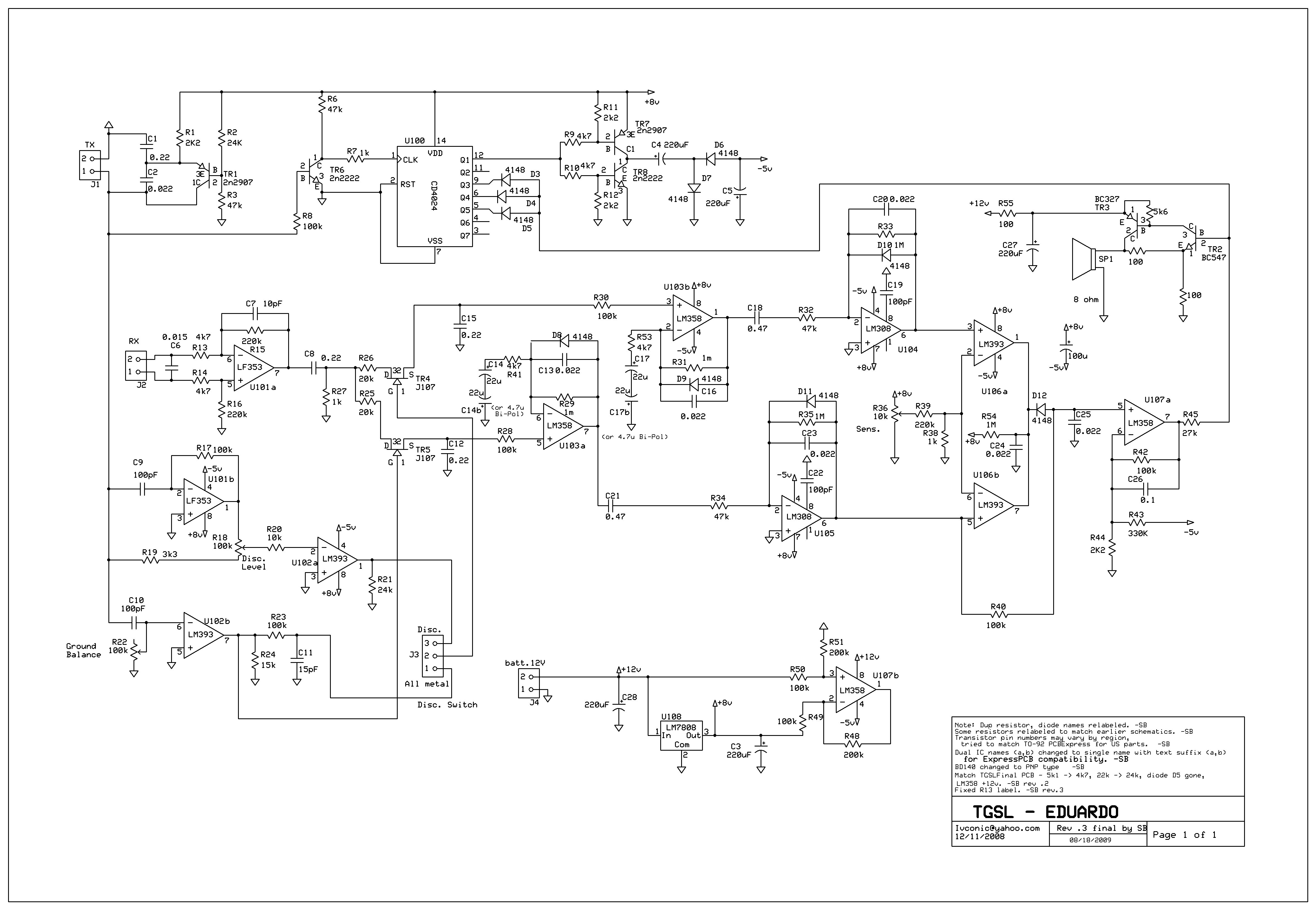

                Well, i'm glad that my suggestion works good, but field. Now your detection distance for coins should be 45 cm for 1 euro coin size? I remember last time u said it was 40.
                Here is litle more what u can try... Look at schematic, this is Eduardo1979 version, TGSL EDU. Some things are changed, 10 uF elco's to 22, R48 and R51 from 220K to 200K.
                But, here is one machine which is very similiar to TGSL but a bit stronger, Tesoro Bandido.If u are good on conversion from smt to dip, should be nice for experimenting. I had one factory model many years ago, it was real beast if u pump voltage and make bigger coil. Without any changes, u can go more than 35 cm with 8" polo coil.
                Here is EDU schematic...

                • Right, now I have 45 cm in air for 1€, I hope in soil it will be fine too. Thank you for your suggestions CDI.
                  I realy like to make some experiments, by changing parts, to see what happens. So I will try your last suggestions too.
                  Btw, SMT I realy like, also without professionel equipment, you can get a good result, if you use parts not smaller than size 0805.
