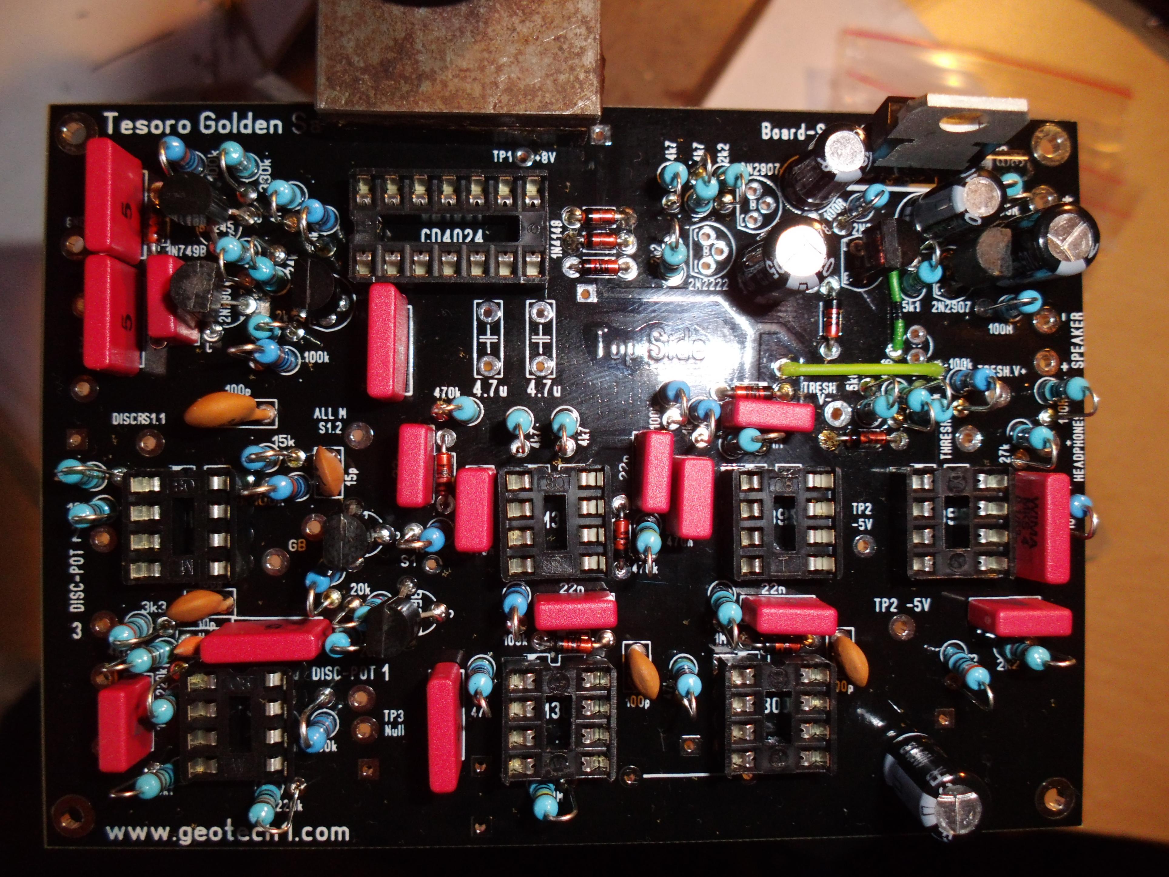

    Todays progress:
    Im not sure with the 2N2222/2N2907 in the minus voltage generator. Should i change them with 2N3906/2N3904 for better Results?
    I still need to wait for my china pots. :-(

        Thanks! My Potentiometer are here. I have one question:
        Is VD 14 (between Pin1 LM358 and 2k Resistor) a normal 1N4148 Diode?
        I see an additional Zener Diode in the Schematic. I dont have it in my layout.
        • #49
          VD14 is an LED, but on pin 2 LM358 is a zener diode.
          Both are for battery control.
          • #50
            I had -6 Volts without ICs. Now i have mounted all the ICs and i only have 0.7V. Even without the 1N4148 where the LED needs to be.
            I have 7.5V where the led is. Which LED do i need to use there? Can the 1N4148 destroy anything in the minus voltage generator circuit?
            I dont think so, the 1N4148 should work the same way or not?. And i don't think that the ICs cause the problem. I have used 2N3906 and 2N3904 as suggested in a russian forum because they work better. But i think they work the same but not better.
            I had +8.1V and -6V before. OP07 instead of the LM308 and i removed the ceramic 100pf for it. LF412 and TL081, LM358 Audio.
            I have also mounted the LM833.
            I hope its not a circuit problem.
            • #51
              Hope you installed sockets for the ICs. Just pop the new Ic's out one at a time and test the Voltages.
              The last one out that fixes the Voltages is either bad or has a different pin-out then what the circuit is wired for.
              Also ensure didoes and LEDs are not back-wards.

                  • #54
                    I use sockets everywhere. I dont think that a bad ic could cause this problem because the minus voltage is generated indepentent from the other circuit parts.
                    I followed Nandors suggestions for ic replacements and used an LF353 instead of an LM358. I didnt knew that LF353 is a replacement for LM358 before.
                    I had the same problem with my other TGSL and it was one transistor in the -5 circuit.
                    • #55
                      I removed all ICs and i still have not the -5V only 0.3V. This means that something destroyed a part in the minus voltage circuit.
                      I will fix the problem in the minus cirucit and try it again one ic after the other from left to the right.

                        • #57
                          Charge Pumps can get tricky and temperamental.
                          Check the Clock to this and the transistors are properly switching.
                          Diode and caps ok?
                          • #58
                            It was my bad. I dont have negative voltage without coil. :-D
                            • #59
                              Ahhh... yes, of course, since the coil is part of the tank circuit oscillator which then produces the clock to the charge pump.
                              • #60
