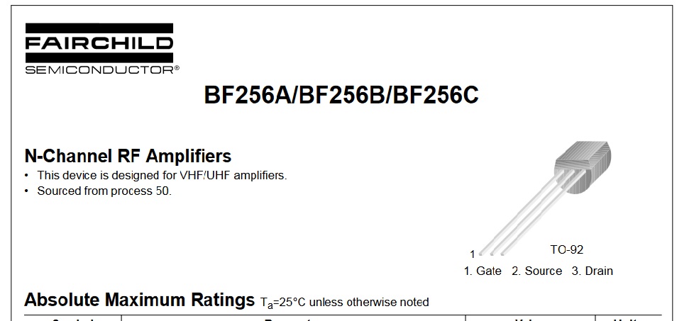

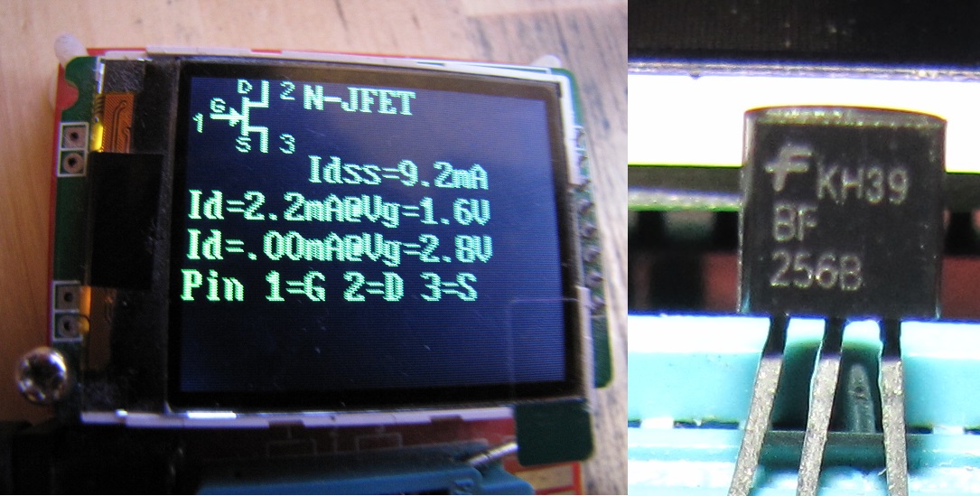

  • Here the photo, just in case it may help someone.

    • Yes, this is well known problem. Cause major headache in the past.
