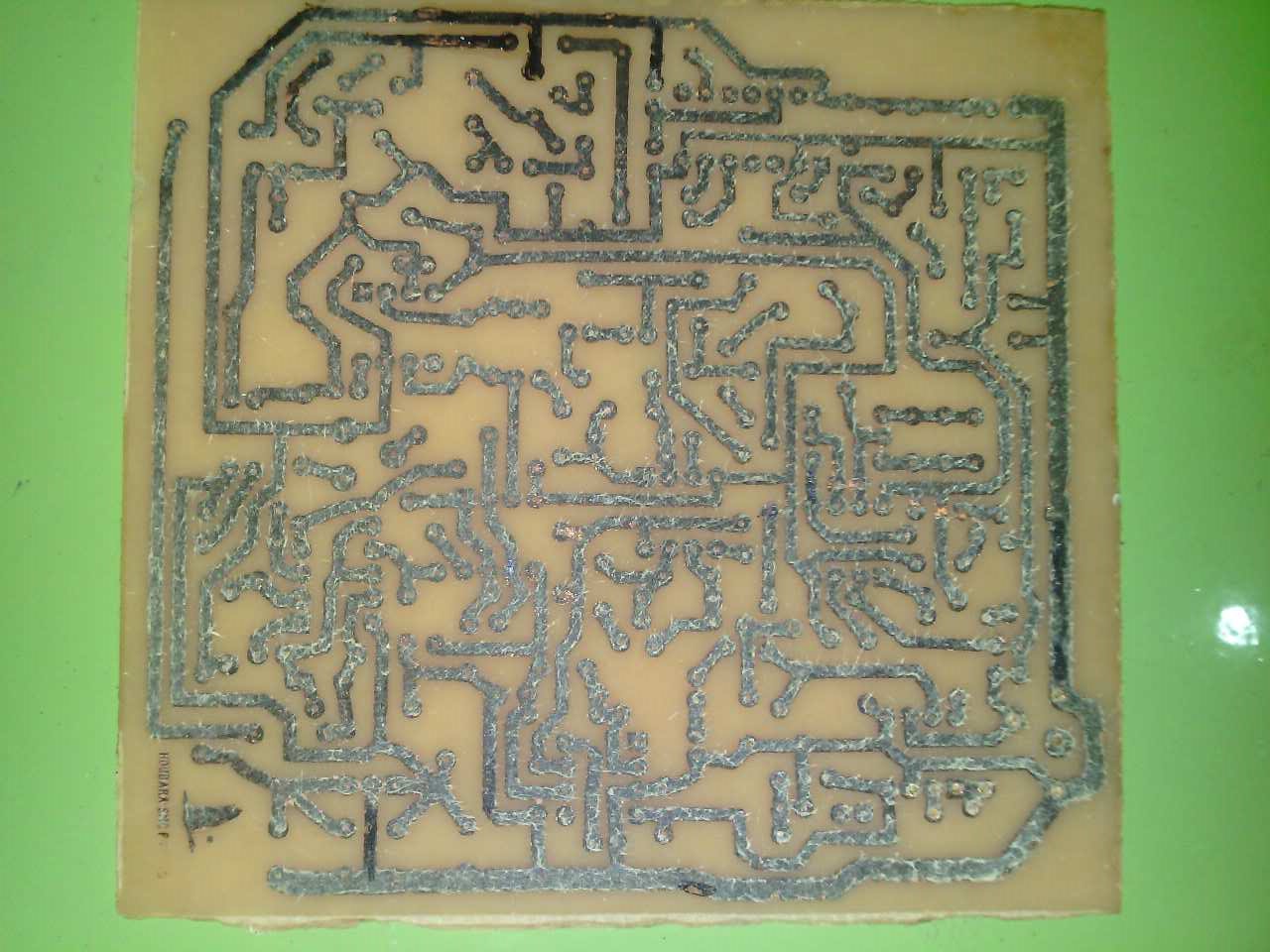

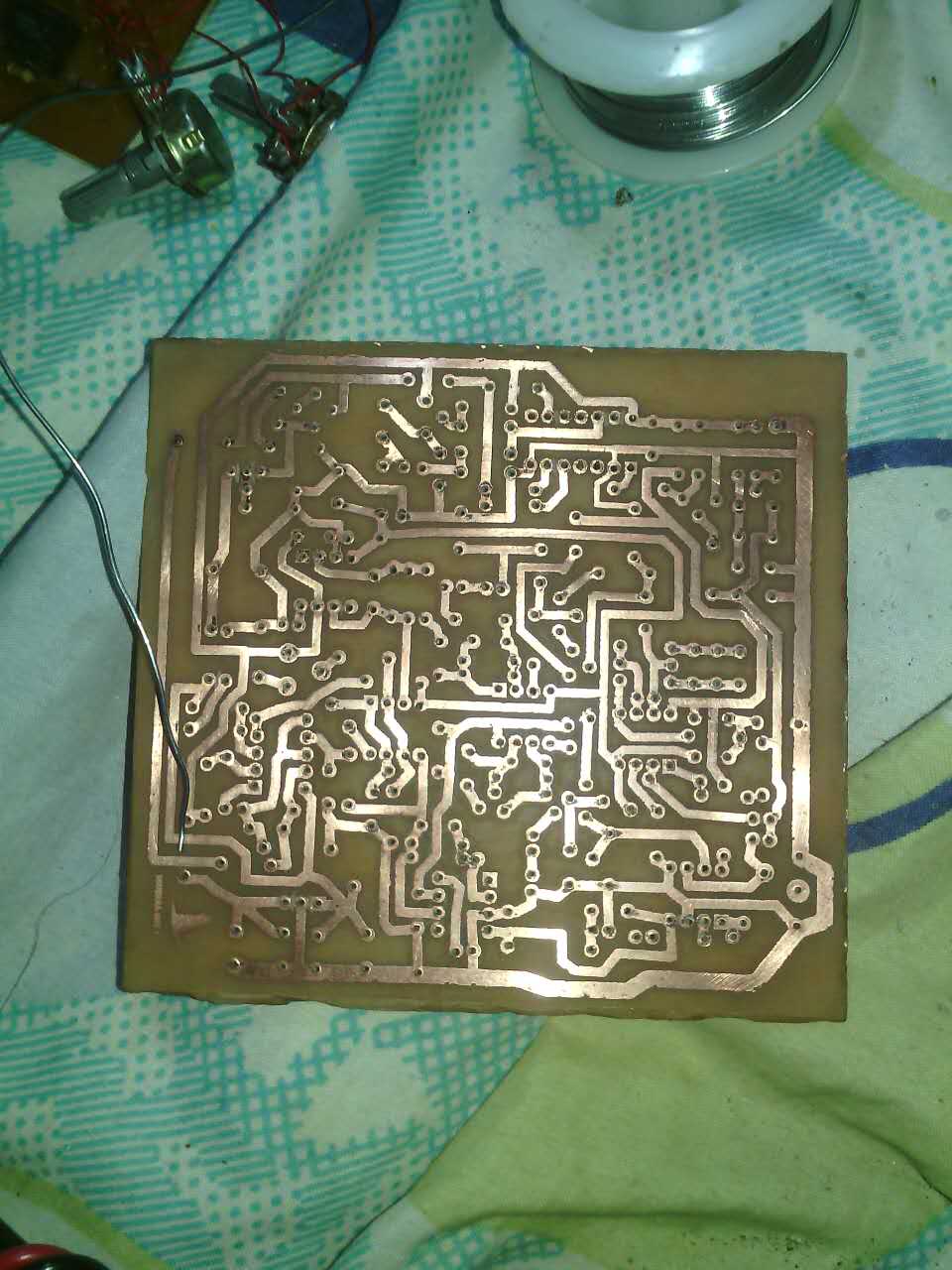

      Chemical transfer experience was good. I used home printer papers, mixed ordinary petrol from my bike with ordinary methylated spirit and olive oil (it did not fully dissolve) in prescribed ratio. I could not wait drying so i used hot iron to press for 20 seconds. This produced strong adhesion. I soaked the board in 30*C water (its 40*C+ here) for 3 minutes and scrapped the wet paper off with toothbrush. The toner was baked to beautiful blue and looked so nice on yellow copper board. I used ferric chloride to complete the procedure of making. I attempted same transfer method for silkscreen but it did not workout well as expected.

      ...........You used method of chemical transfer of print onto copper board, yes? Can you say how your experience was with this method.

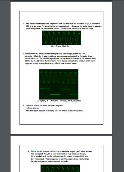

                Put any value of inductor on tx connection, its should make a beep when the board is normal.

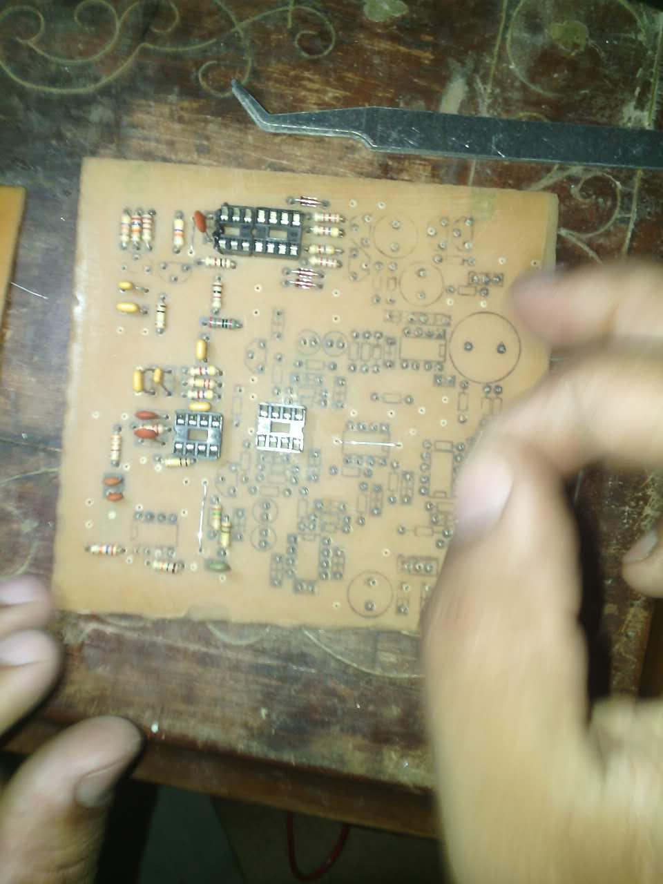

                  My TGSL was not making much noise so i looked into The C27 1000uf and it transpired it was taking too long to recharge (almost 100 seconds/V) and my attention went to a 330K resistor connected with it and this got me very confused with schematic and BOM. The schematic shows R55 as 330 ohm but there is no such part as R55 330 Ohm in BOM. I changed this 330k to 330 Ohm and now the speaker is totally silent and -5V at pin 4 of lm358 is also gone.

                                connect a coil 1-6mH value ANY COIL! to transmitter output. just then you will get the negative voltage. LOOK ON THE SCHEMATIC!!!
                                without the coil YOU DO NOT GET NEGATIVE VOLTAGE!!!!
