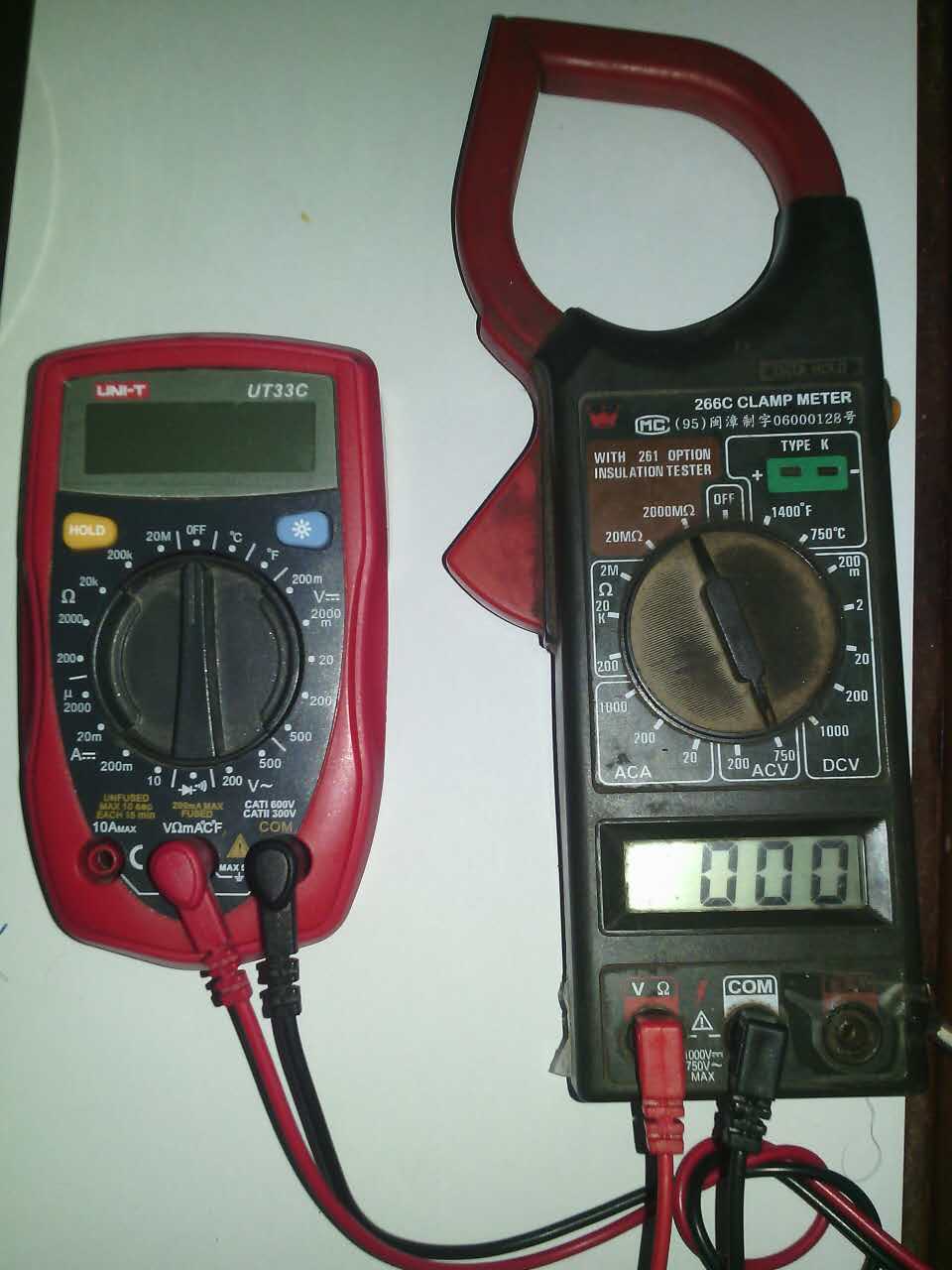

            i have multimeters and analog oscilloscope only

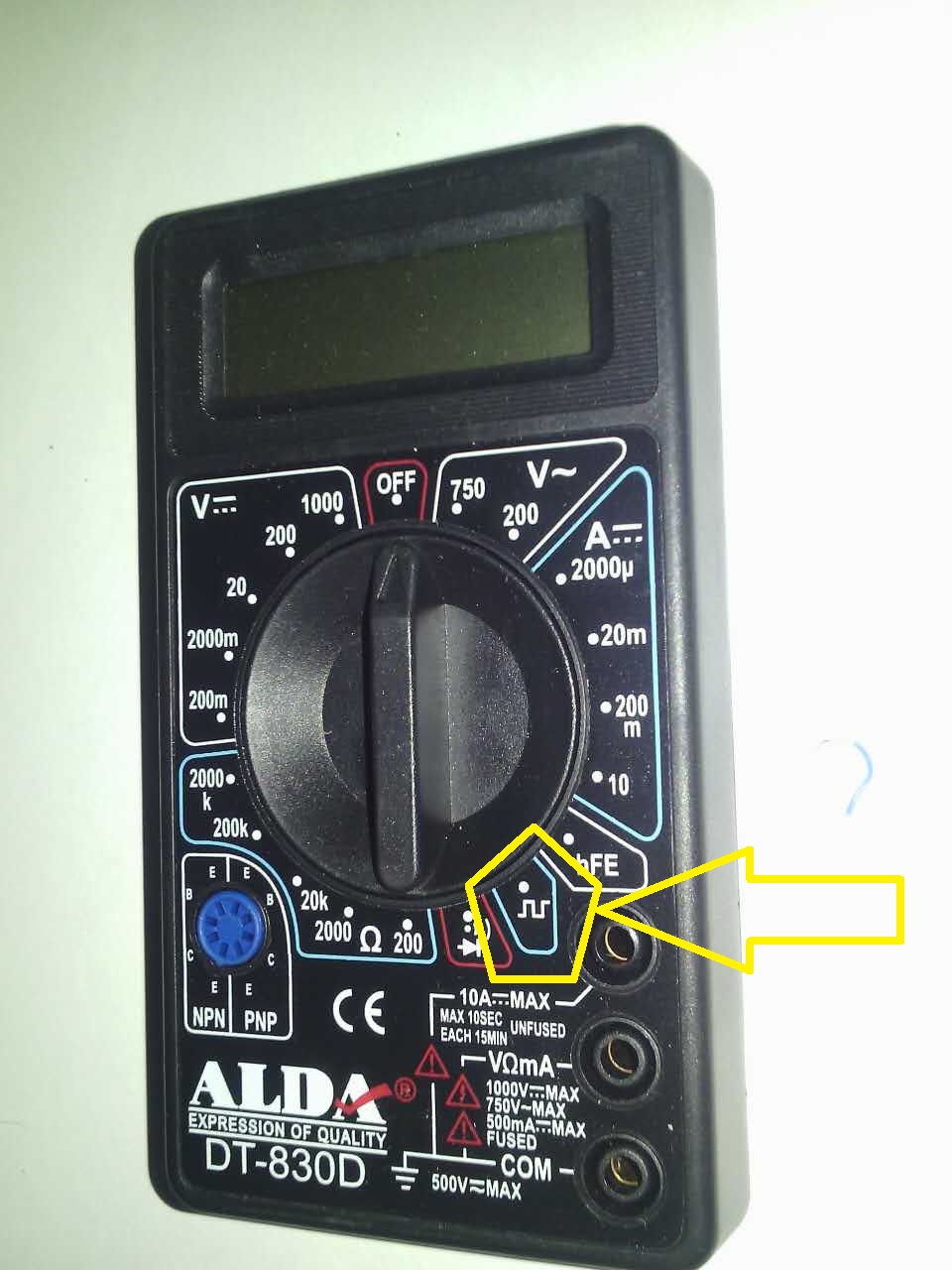

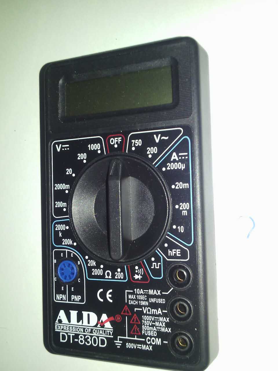

                I also have this multimeter and it is having a signal generator function. Can this assist the scope?
                  No.
