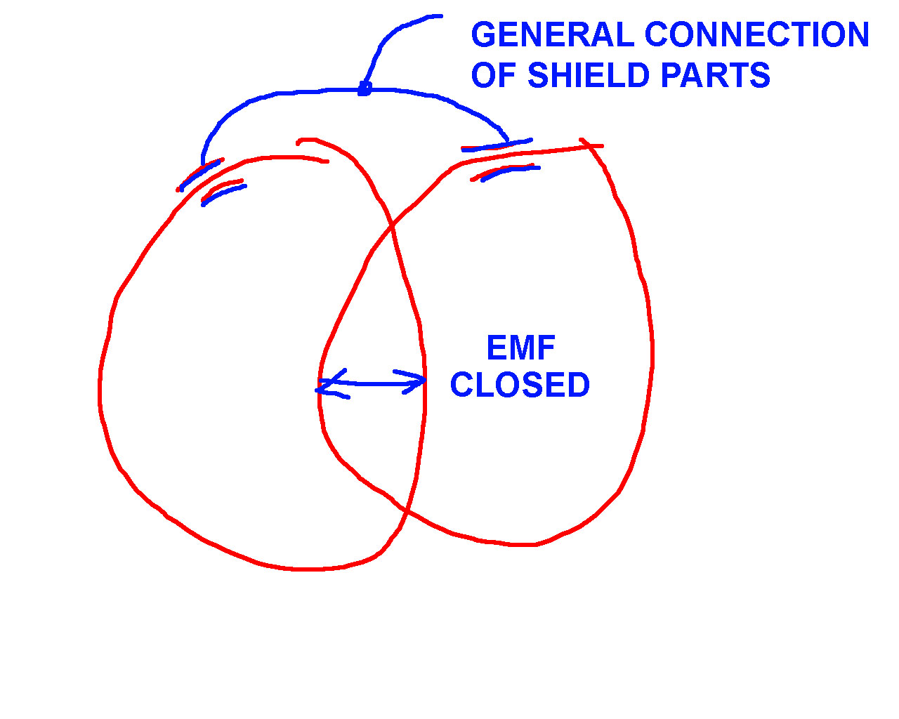

                  • I'm curious to ask sth, what if I didn't shield my coil,what would happen?, I got a good results without shielding but when I wrap a tape around the coils I don't reach a good nulling, most of my search will be on a drying ground and far away from buildings. I just want to know what is the main purpose of the shielding.
                    • Shielding is Electrostatic. One thing that can happen without is it will False when the coil changes distance from fround or when brushed across grass.
                      Dry conditions tend to be worse on producing electrostatic fields. Why static electric shocks are worse in winter than summer here (winters are drier).
                      Did wrapping with tape change the Inductance?
                      • you got closed circuit for electromagnetic field because your tape is foil, clear conductor.
                        • It's normal electrical tape, and I can't check inductance if it changes or not because uni is closed now for two weeks because of Corona Virus :/

                            • look on the pic. do resume and change your shielding on standart graphite powder cover.
                              • Kt315 So what do you recommend?, and waltr even the frequency I check it at uni also, I only have multimeter for AC and DC voltage I check nulling on it.
