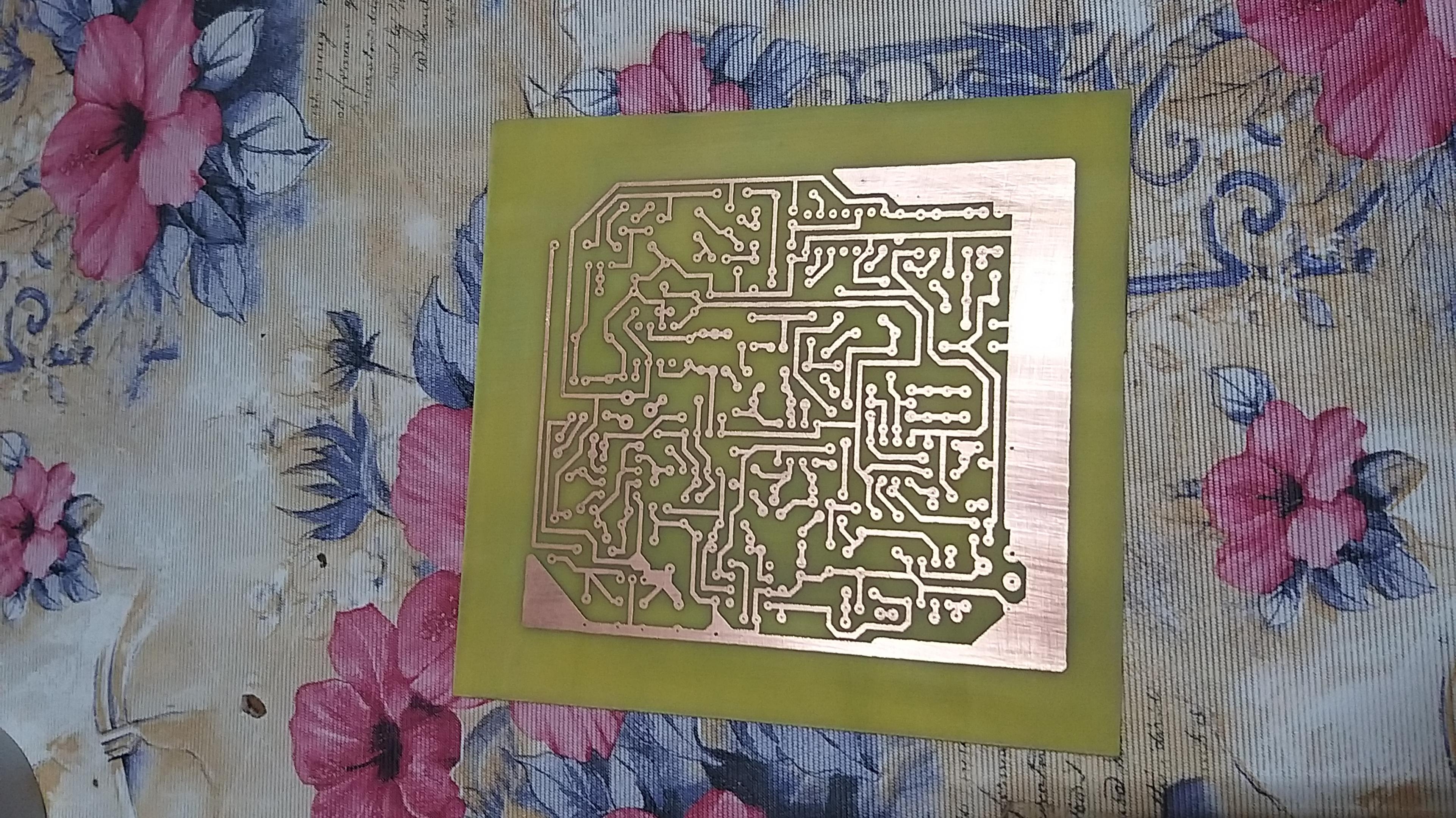

      Hello everyone..well I'm really upset cuz I don't have much time for this project..I will take it slowly, anyway so far I have finished the pcd only and bought all the components..well wish me a good luck
        PCB look good. Take your time building and checking stages as you build.
        The TGSL 101 pdf is pretty good to help show what each section does.

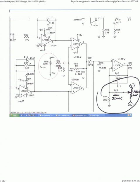

                            Anyone know how to add gain pot connection? Need to reduce gain for high mineralised soil... Beeping everywhere

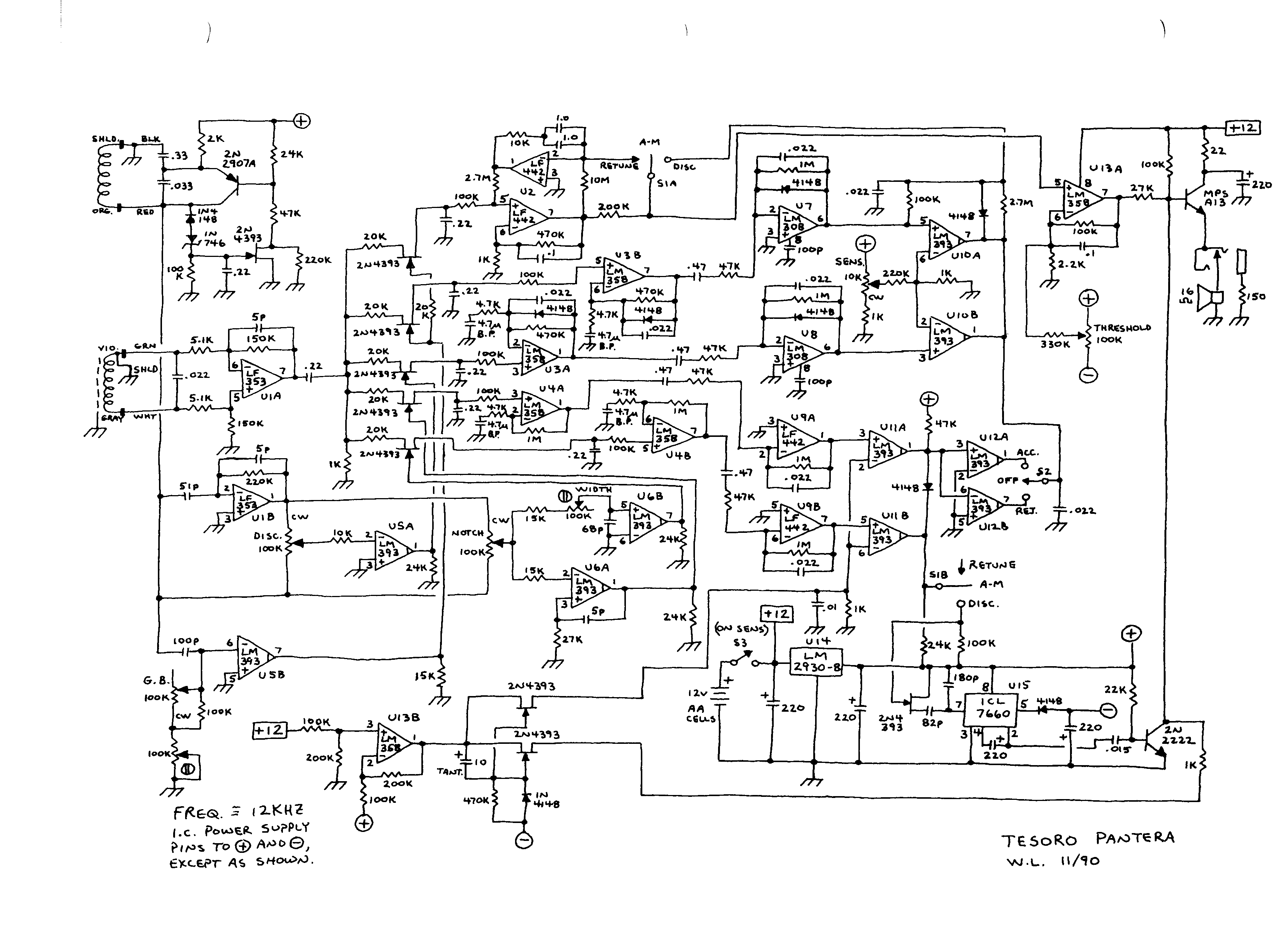

                              Yes. You can put threshold pot here as in pic. I did this mod and it worked very well. I had more control over the sensitivity. It is just the same with the pantera and silver sabre schemes. So now the first pot is called SENS and the new pot is called THRESH.
                                Thanks a lot dbanner
                                Will add to the neglected board.
