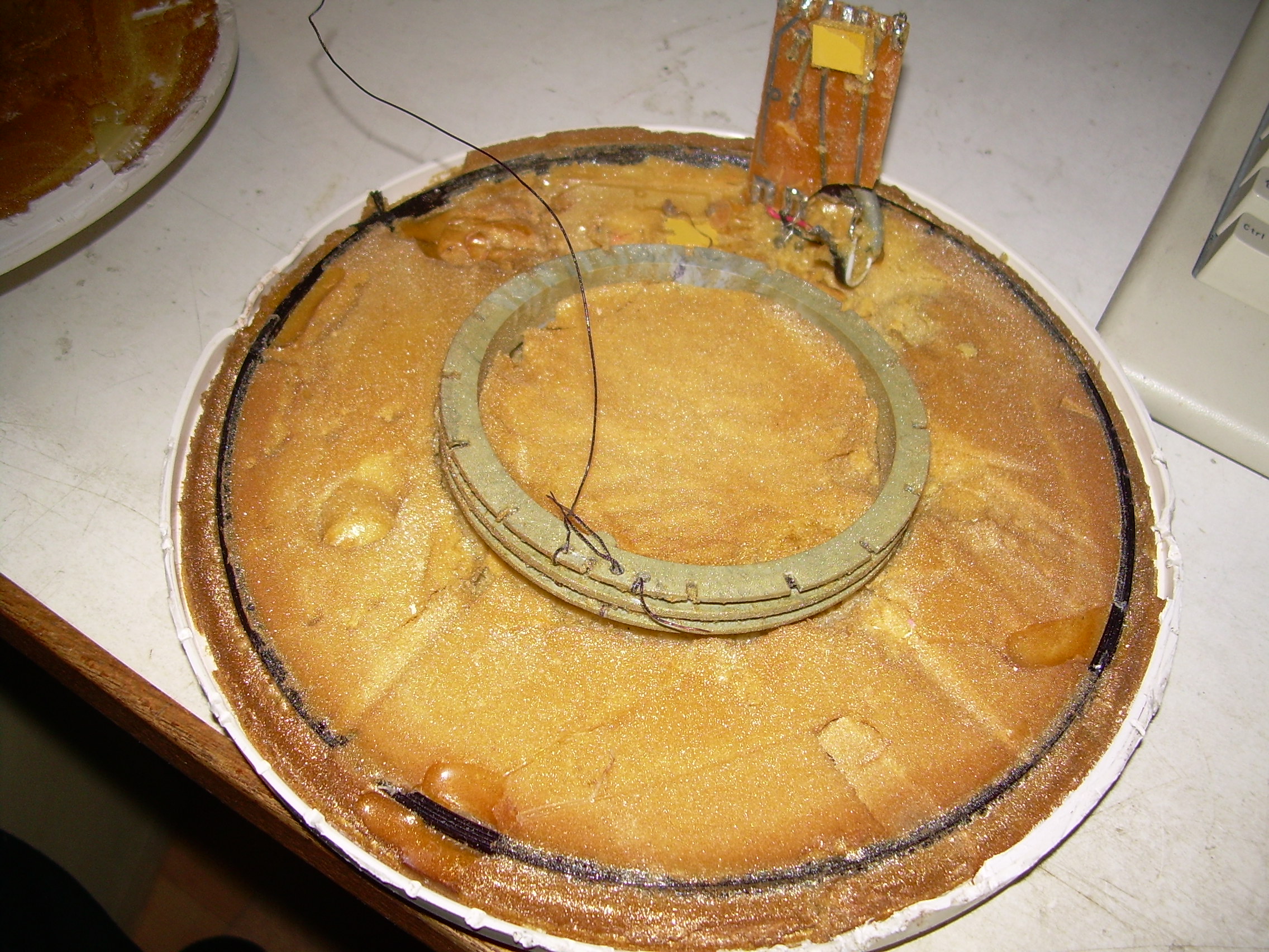

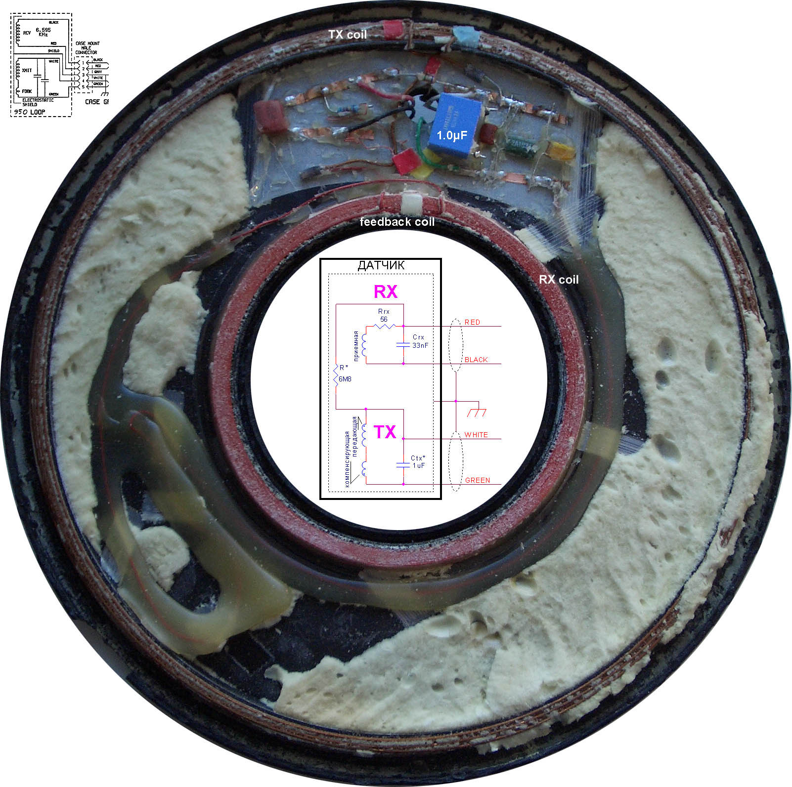

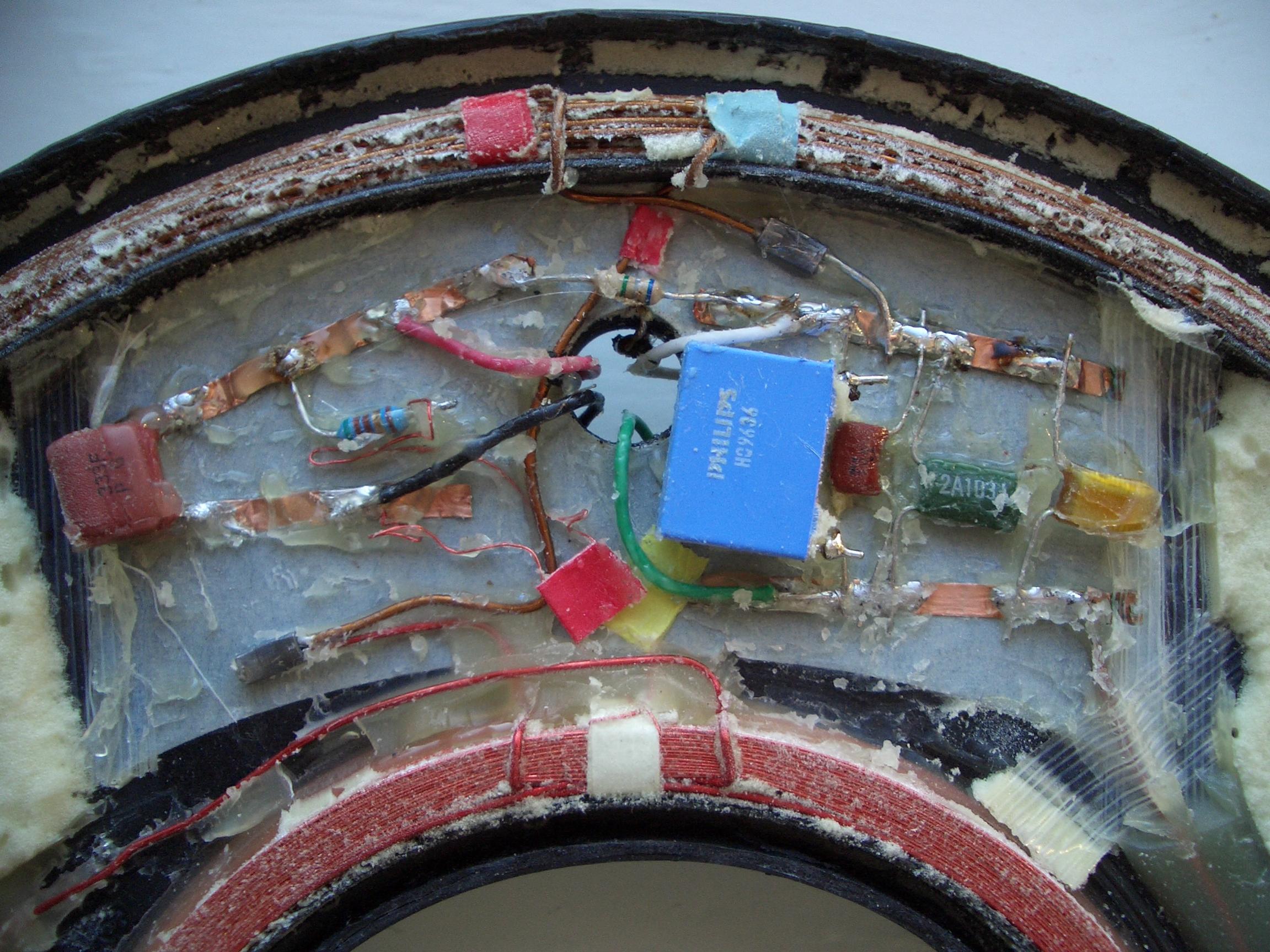

                        • #72
                          try to learn my pics done much years ago.

                            • #74
                              Thanks for sharing,but what would I achieve by doing this circuit?, it look to me that you can adjust the resonance and the resistance of the wire right?
