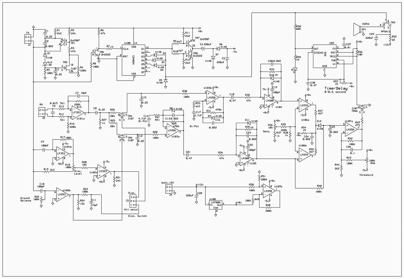

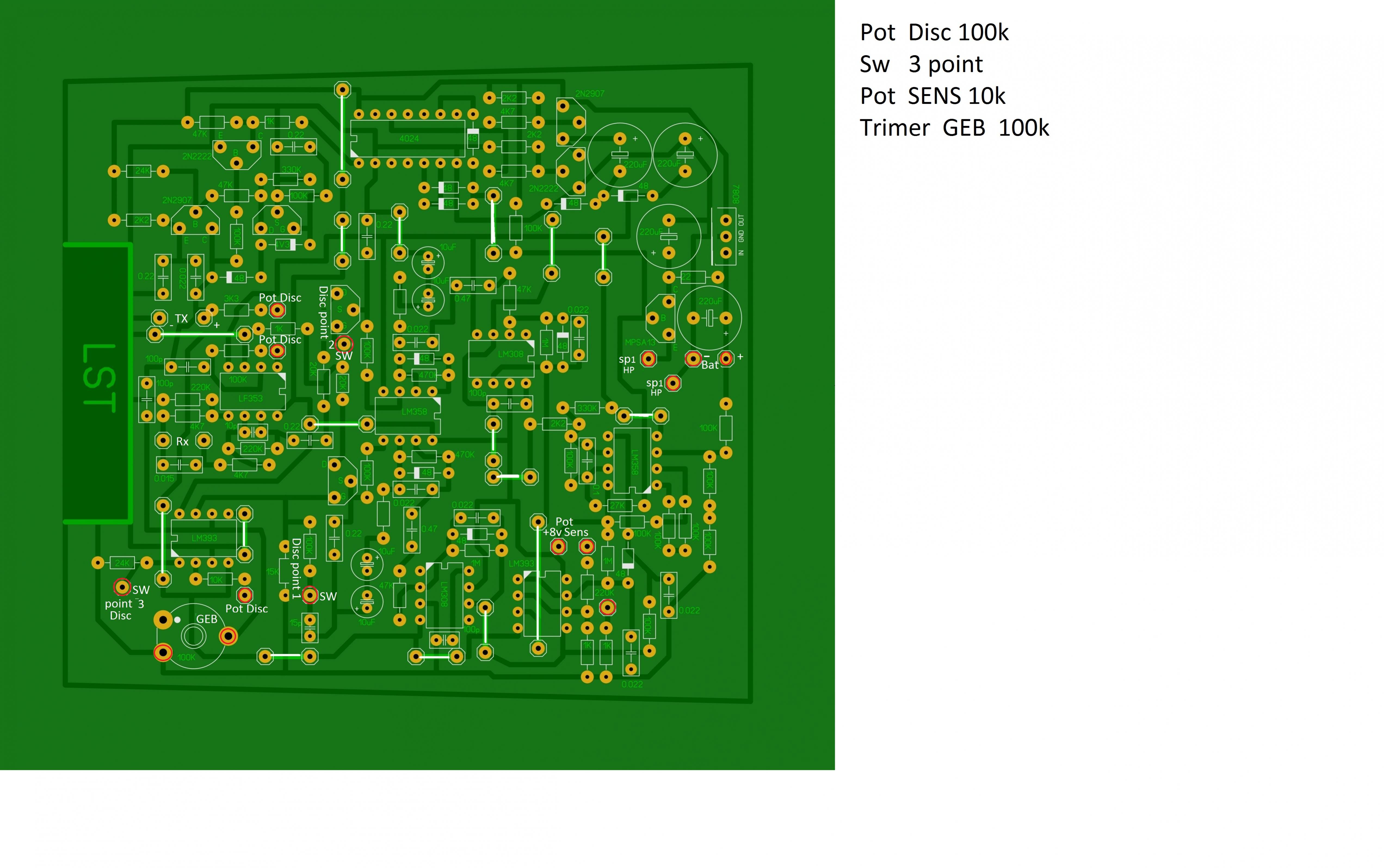

    Hello ,
    I just finished my project,
    on the card I have there is a 4V3 diode
    in addition to the 7808 regulator and a transistor in addition ect ...
    I soldered all the components! I put the circuit
    powered on and it doesn't work!
    do you have any suggestions?

    I attach the diagram and the card model.

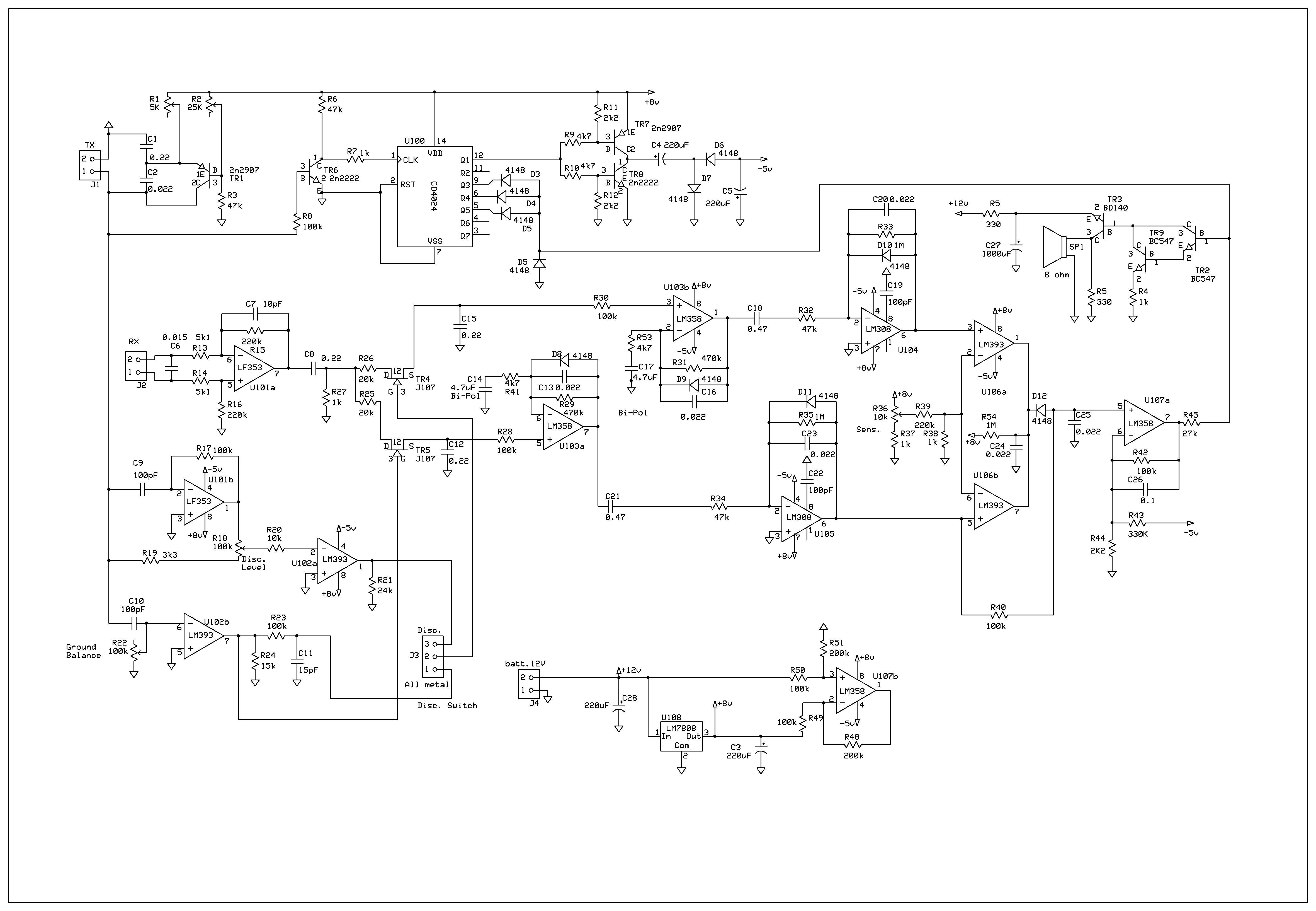

    I got the wrong diagrams! here is the good!Click image for larger version
Name:	circuit TGSL avec diode  zener  4V3.JPG
    Oscillator not working?
      Yes, is it oscillating?
      Check on the TX Coil with your O'scope.
      You do have the TX coil connected, right?

        Yes, something else! I was going to forget about the map that I have, there is
        more components and a 4V3 Zener diode, why?
        what is this diode for? Thank you .
          You have to see why its not working. The oscillator is the heart of this circuit, the 4,3V zenner is for amplitude stabilization.

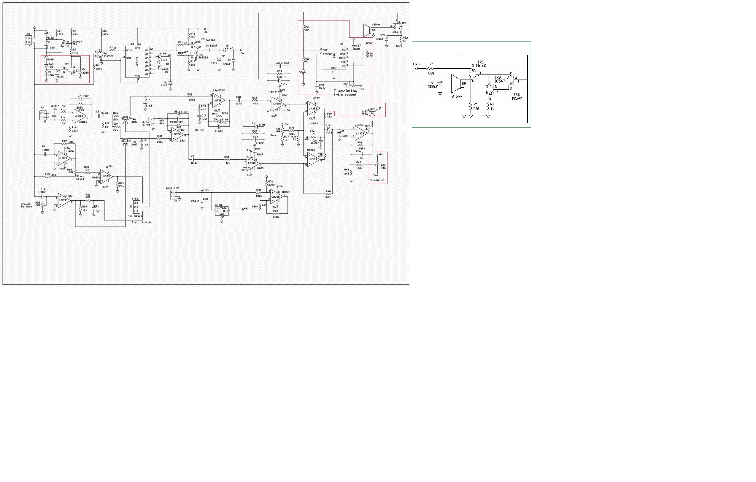

            Hello, Nandor,
            I have deleted the parts in red on the map! ( see Attachment )
            on the other hand for the moment, I left the sp1 wiring
            when powering up I have a continuous sound !!
            I will soon rewire sp1 (green color )Click image for larger version
Name:	circuit TGSL avec diode  zener  4V3 modifier.jpg
            for the modifications I used the diagrams of the final tgsl rev 3
              There is no negative voltage thats the reason for the continous sound, check the oscillator.
