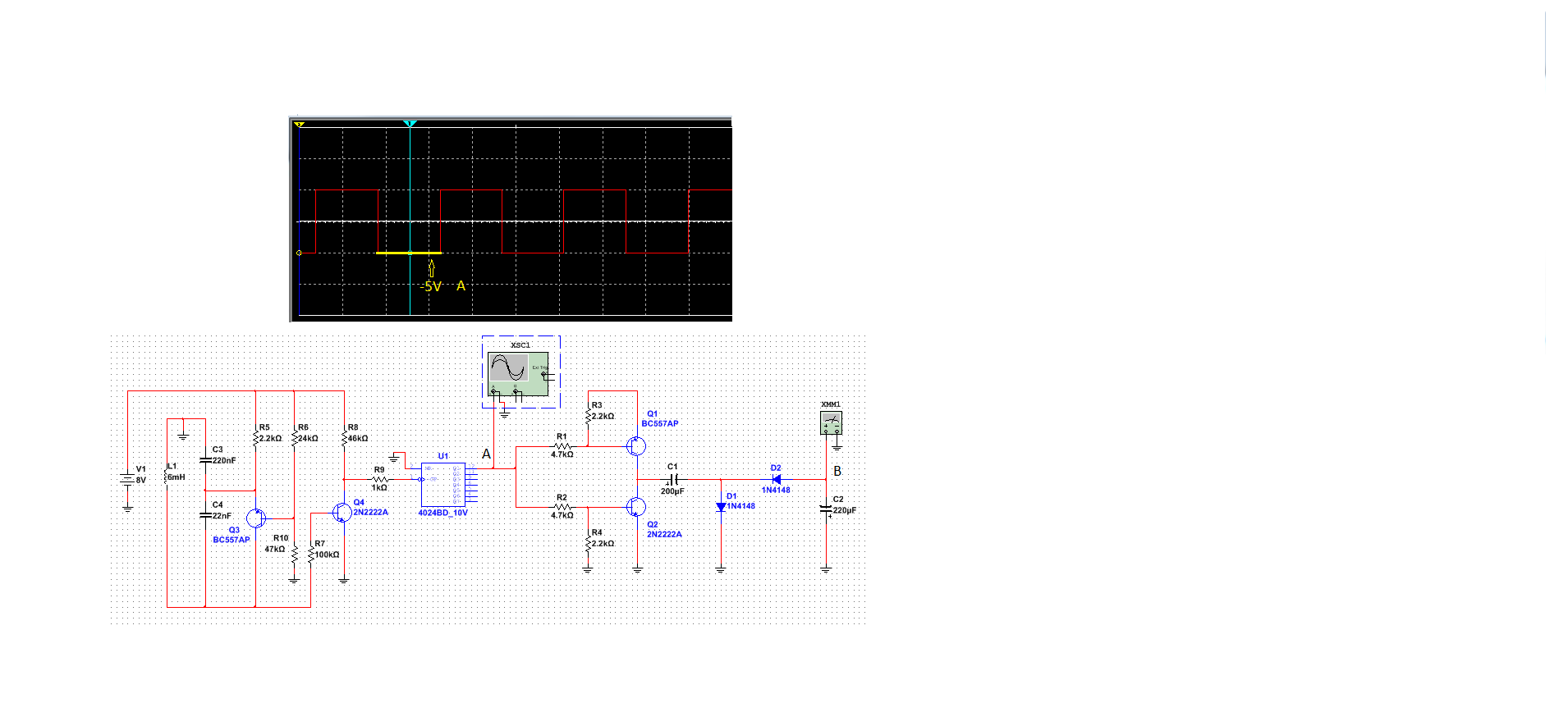

      Thank you for the answer, I downloaded the doc TGSL_101_part1.pdf but there is something that escapes me!!!
      I did a simulation with Multtisim, on the point ( A )
      noted with the voltmeter +5V if I measure the same point with the oscilloscope, since the signal varies I can actually assume that it has -5V. Now if I take the measurement on point B no voltage value !! so I assume that the measurement is done
      well in point (A)? .
      see attachments.

        Point A should have a square wave of 0V to +8V. Is power connected to U1, the divider chip?
        Point A needs to be measured with a scope NOT a Voltmeter since it is not DC.
        Point B should be rectified and filtered -5V (so so) DC.

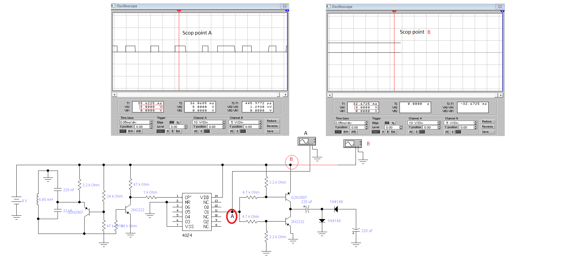

          Good evening, I made a new analysis with electronics Workbench,
          see jpg attachment. at point A +5V at point B + 8V
          is the simulation correct?
            No, point A should have an amplitude of 8V. As it is, the PNP will never turn off. MultiSim may be simulating the 4024 with a digital model set for 5V. You either need to figure out a way to tell it to use 8V, or reduce the battery from 8V to 5V.

              in the last message Carl told you, MultiSim can simulate the 4024 provided you find a way to set the voltage of this circuit, I have been looking for a while in the multisim settings to find how to change the voltage of the 4024 cmos circuit , but I can't find it! even by going on google !!
                Then just set the battery voltage to 5V, then everything will run at 5V and it should work. The inverter voltage will be a little less than -5V.
