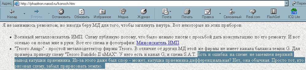

    Below is one of many Older Messages, that Claim that the TX Coil does not connect to ground and others Post say that even the manufacturers schematics, Purposely show it connected to ground, But those schematics are wrong.
    My Question is: If the TX Coil does not connect to ground, Where Should it Connect?
    Is it Possible it connects to the Minus Supply to get a Higher voltage, that also results in a Higher Transmit Signal?
    Does Anyone Here, Know for Sure?
    Take care..........Gary

    Re: A Question about the Bandido
    Hi Gary,
    It was a mistake... understand RX (not TX) !
    Sorry
      if RX... sorry then I repeat again. that Ivan Kostin HAS NOTED AT HIS WEB SITE COUPLE YEARS AGO.
      'RX COIL HAS A CONTACT TO GROUND. SOME PEOPLE THINK IT DOES HAVE NOT. BUT THEY ARE DEEPLY MISTAKED' (C) IVAN
      P.S. ... but you have FULL RIGHT to do ANYWAY )))
      P.P.S. look another MD schematics - you will be able see all are _classic_ non-inverting OP AMP in the circuit.
