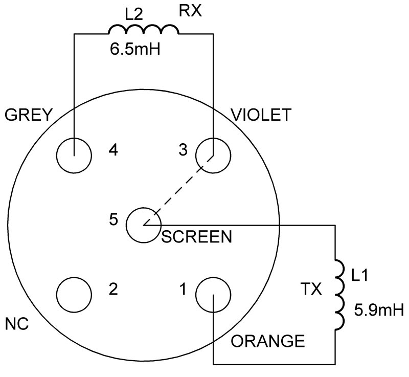

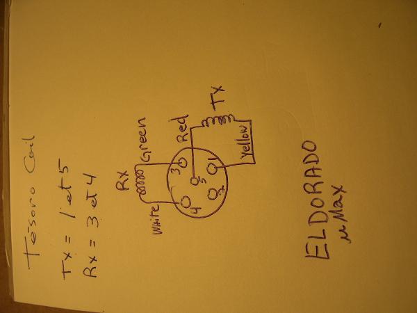

      Connections in the controle box:
      Dont forget ,pins 3 and 5 are common (connected in coil).
      That's important for connecting the TX.
      JF

          Tesoro coil winding details
          Sometimes the wiring colours can be different.
