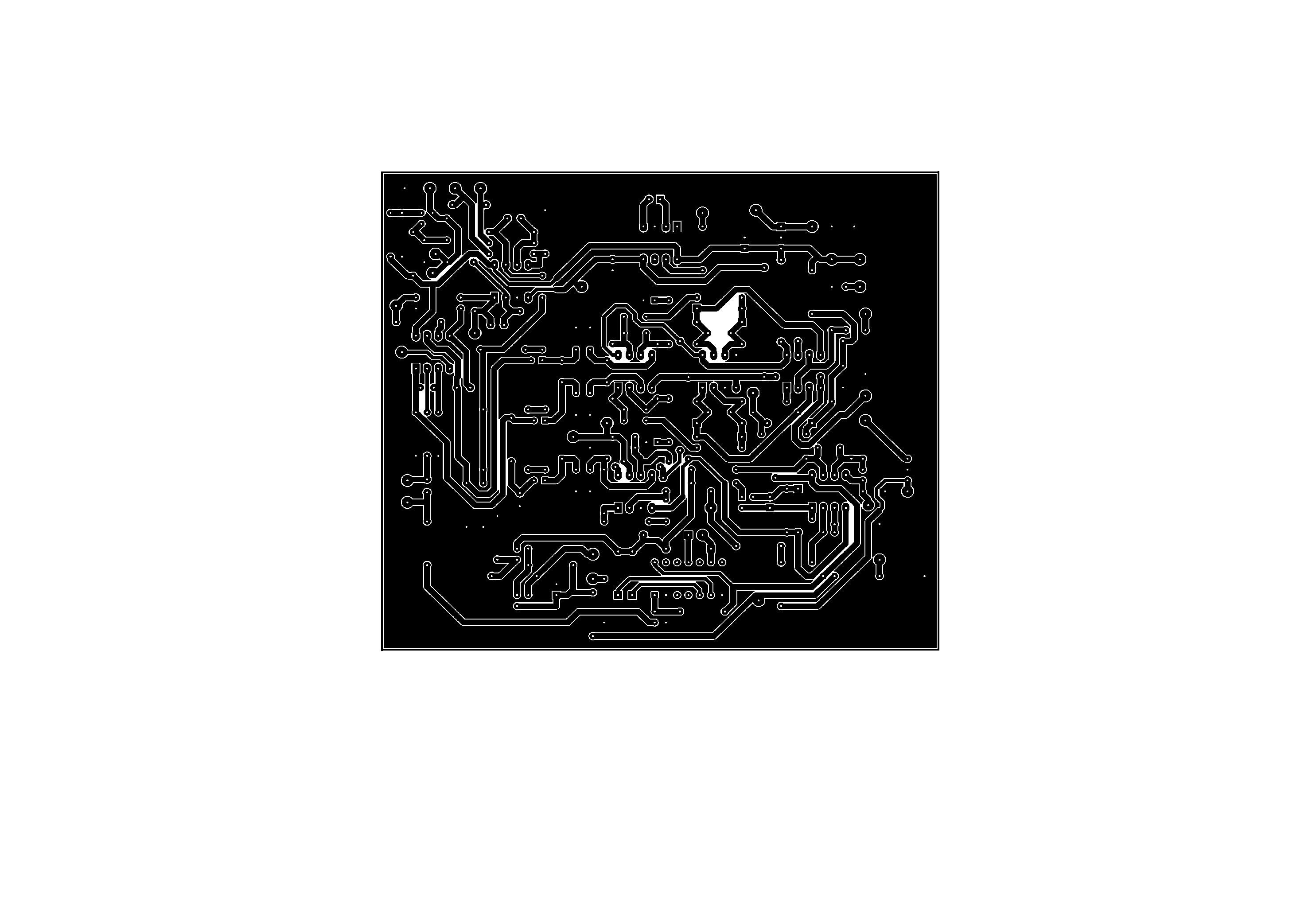

      hello merc
      is it possible to post the black white image of your pcb
      or isnĀ“t it available at the moment
      maybe you have sprint layout or eagle files?
      would be nice
      • #78
        I am working on the black and white image. I created layout in Kicad so I cannot export in Sprint or Eagle format. Not that I know of anyway.
        Merc
        • #79
          Here is a black and white layout image without mounting holes.
          Merc
          • #80
            yes right many many thanks
            • #81

                  • #84
                    Merc, what layout package are you using? Would you be prepared to let me have a copy of the Gerber file? I have a CNC available to me and would like to duplicate your experiences.
                    • #85

                      • #86
                        I do the PCB layout with Kicad. Within kicad I export a Gerber file. I then use a piece of software called DeskPCB that takes in the Gerber file and does the trace isolation for me and outputs the G-Code which my V90 uses directly. Here are the original Gerber files and the G-Code which is tweaked for my machine. Since I had to zip everything, I stuck some other files in there as well.
                        Merc
                        • #87
                          FYI, I just noticed a slight possible discrepancy between the Gerber the layout and the Gerber files. After I had milled and assembled my board, I decided to move the speaker ground to place it closer to the regulator ground.
                          Merc
                          • #88
                            You are a star, Merc. I was just going to see if our PCB man could do anything with just the black and white image of the copper. Now I will present him with these! Thanks.
