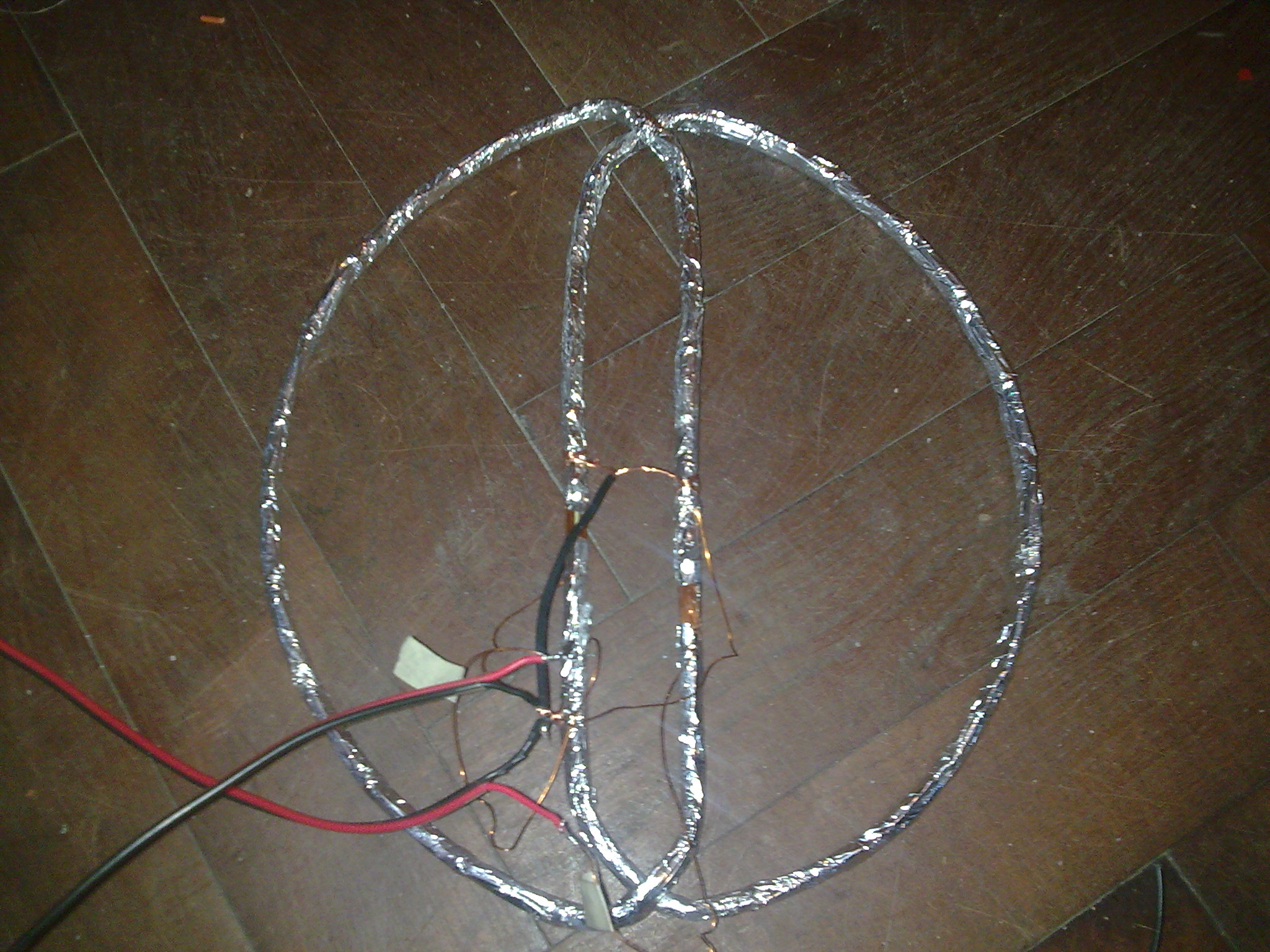

    Hi all I read in another post that tgsl reaches 30cm and 10cm I reached coils may be problems in electronics hobbyists as I am strictly follow the steps in the construction of this I can measure some tension with my tester and I need an oscilloscope to find the fault.
    coils constructed as mentioned 0.25mm enamelled wire and 107 turns and 98 one another.
    Greetings to all and thanks
    PS: In the attachment is a picture of my coil
    Firstly, your shields ar touching each other. Use some tape to isolate them.
    Then your cable looks wrong - use shielded one.
    You need to provide more info: frequency, null voltage, waveforms would be ideal.

      Well you say that isolates the shield between coils but also the two must be grounded. and condolences to the cables if I have the tab shielded cable with nothing else so I started to try but did not think it affected both the depth but it would have unwanted noise

        We have found that EMI noise and vibrational noise with coils that are not "fixed" (glued in a case) can cause poor depth. So to test, you must find an area that is away from electrical wires, etc. Maybe down in a basement.
        Also, you must get a good null with your coils to start with. In addition, the coils must be held down very solidly away from any vibrations.
        Then get an oscilloscope if you want to really understand and tune your MD.

            .40mm wire is too thick and will probably cause difficulties -- I don't recommend it to solve this problem. I think .25mm can get good results if everything is built correctly.
            I don't understand your question about the null. I was just saying that you must "null" your coils using the normal procedure, and then somehow fix the coils solidly so they cannot vibrate.

                          Tell more - Inductances of coils, your tx frequency, how you ballanced the coils, how you connected it to PCB, do you have scope, what is you test object and other info
                          On bench it doest make big difference if coil is shielded or not. Maby little worse due to increased min quiscent null signal with shields added...

                            If you have a lot of EMI noise in the area, 20 cm may be expected even with good coil. You have to test in some place far from EMI to be sure (not always so easy...)
