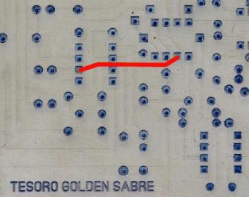

      Addendum : I forgot to mention that a link is needed under the main PCB in case of use of the standalone mod.
      A link must be done between Pin 6 (or 2) U106 and Pin 2 U107. (Ref. sens. voltage).
      In case of use of the piggyback PCB, the link is already done on it.
      @satdaveuk : The piggyback PCB will be available soon into Silverdog's Web Shop. Ask him.

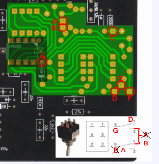

              2 tones wiring
              I've found a mistake in my wiring explanations.
              For the piggyback board, points A & B must be reversed on the switch.
              Moreover, I want to repeat that the G point is located on the MAIN board, not on the addon board. A friend of mine makes the mistake and it really but really don't work well.
              Hugo

                  Originally posted by hugo View Post
                  Hello,
                  Two more photos about the mod.
                  The first one shows components to be removed.
                  And the second one, the wiring between the PCB, the piggyback board and the DPDT switch.
                  Note : The G point (don't laugh ! Unwanted joke !) is hidden on the main PCB (1N4148 Anode) under the piggyback board.
                  Have fun,
                  Hugo
                  Hi Hugo,
                  My board is nicely soldered and would be a sin to start pulling parts off it.
                  I am about to order the 2 Tone board from Silverdog. I just had a quick read through of this whole thread and have two questions.
                  Is the board from Silverdog a piggy back onto the existing TGSL-EDU?
                  Do I need to remove all those (9?)components marked "X" and a jumper wire on the bottom?

                    @gsignal888 :
                    Three words : Yes, yes, no ...
                    Yes, you have to remove some components.
                    Yes, the PCB from Silverdog is a piggyback board for the TGSL-EDU kit.
                    No, with this add-on, you don't need to add a link on the bottom (only with the standalone version).
                    My son , what is your worst sin; Remove some parts or stay without 2 tones discrimination ?

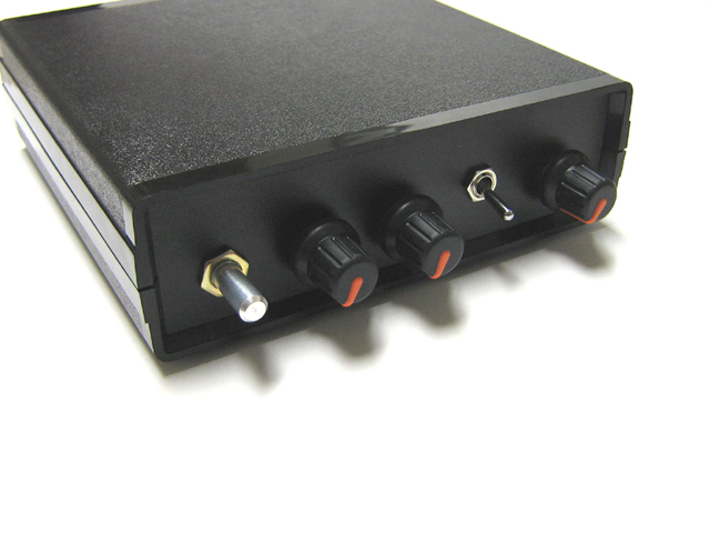

                          Silverdog,
                          The order finally went through for the 2 tone board and parts.
                          Here is a pic of my case. The first pot is a temporary until you send the 16mm splined 100K version (same as the 100K disc.level pot in the kit) and the orange knobs so everything will match. Just need to label all the controls next.
                          Thanks for all your help.
