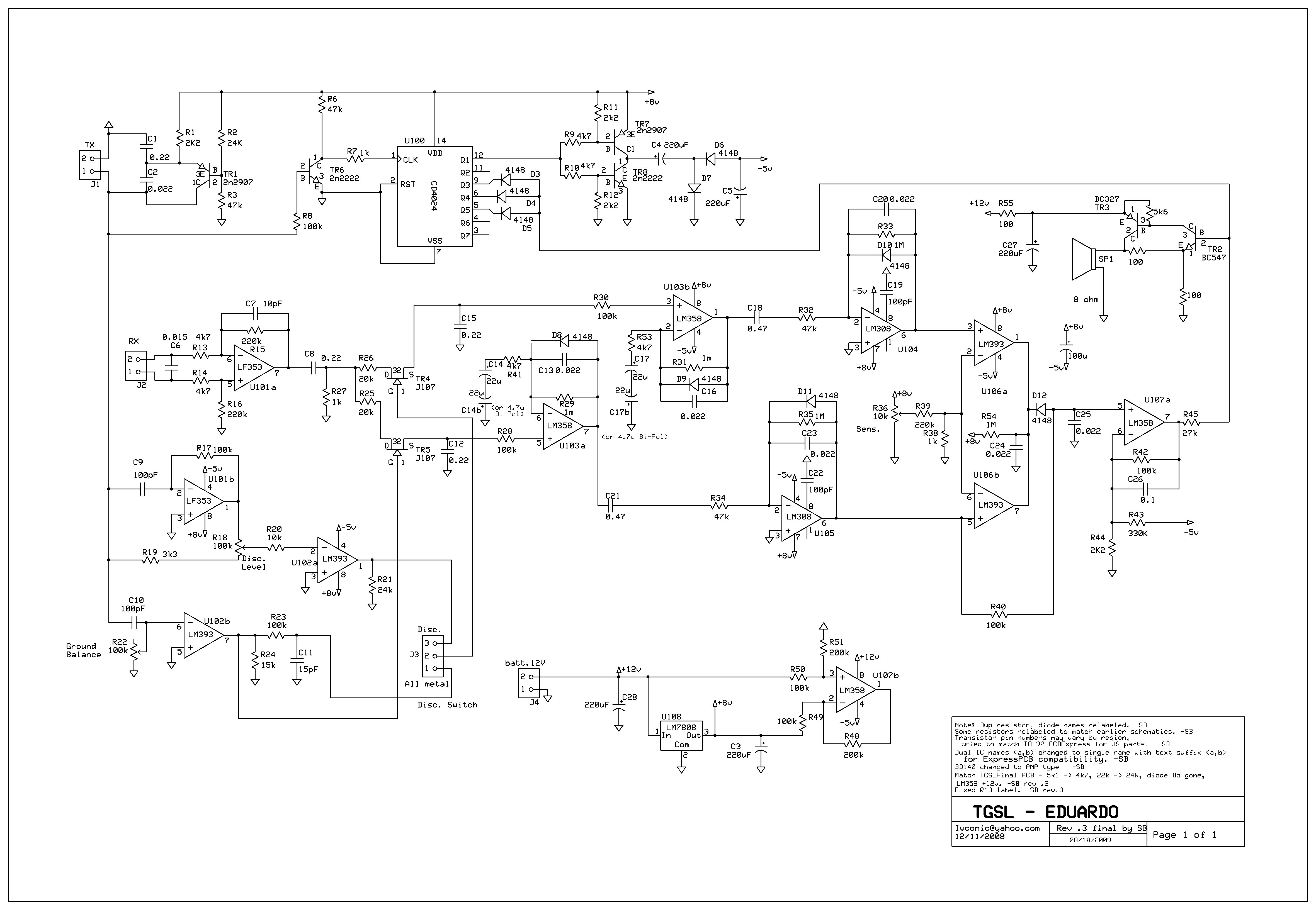

    Hello,
    I was looking at Tesoro Vaquero, but after finding about this forum would rather build my own MD.
    I do have an electronics background so this could be the best route.
    I need reasonable depth and sensitivity, mostly dry ground and some wet sands. Which PCB kit should I order?
    My targets would be mainly coins and gold/silver.
    Thank you.

      Depends on what features you want. For the simplicity, the TGSL Eduardo version from Silverdog is a good place to start. The kits are easy but the challenge will be building your coil. It's much more rewarding building your own! You can probably get away with building a TGSL for just over $100.00 USD.
      Just as a comparison, I have a Cibola. It does go a bit deeper than the TGSL in actual ground conditions (maybe an inch..). The Cibola/Vaquero is a bit more powerful and the coil geometry is different than what most of us have been building here though. The strong point of the TGSL is it's excellent discrimination. Depth is very acceptable if the coil is made correctly.
      For wet sand, you are better off with a PI machine, like the Baracuda or Surf PI from Silverdog.
      Don

            I was at Silverdog's website and looking at the schematics for the TGSL and see IGSL /TGSL sharing the same parts and schematic.
            Were these were two separate projects?
              Different projects
              The ones on my shop are IGSL-TGSL version (i.e. IGSL with Tesoro coil)
              I don't thin I have added TGSL docs yet, here they are

                  Is a oscilloscope needed in case I need to do some troubleshooting if the board does not fire up the first time?
                  If I do need one. How about this one. http://www.geotech1.com/forums/showp...7&postcount=11
                              If you build both the coil and detector then a scope would be a great help if things don't fire straight up. Otherwise you want know if be problem is the coil or detector.
                              2 channel is useful but not essential.
                              20mhz or faster
                              Good chance if you are careful it will fire up fine first go.
